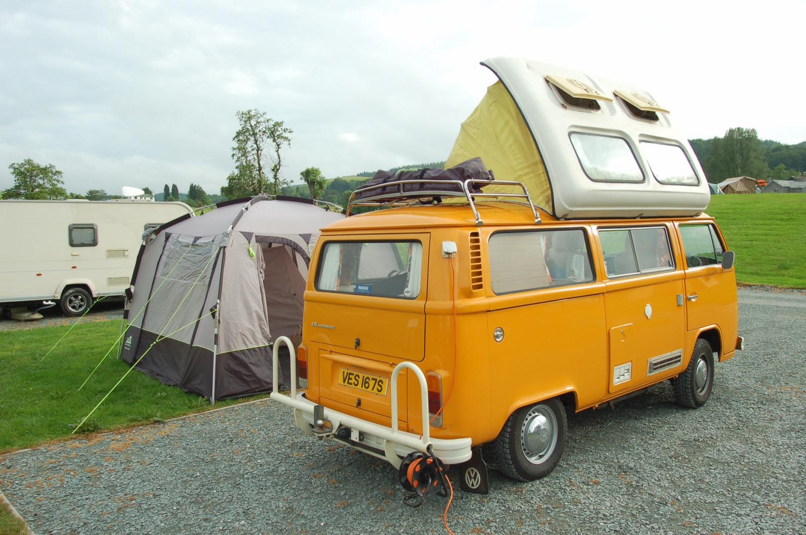

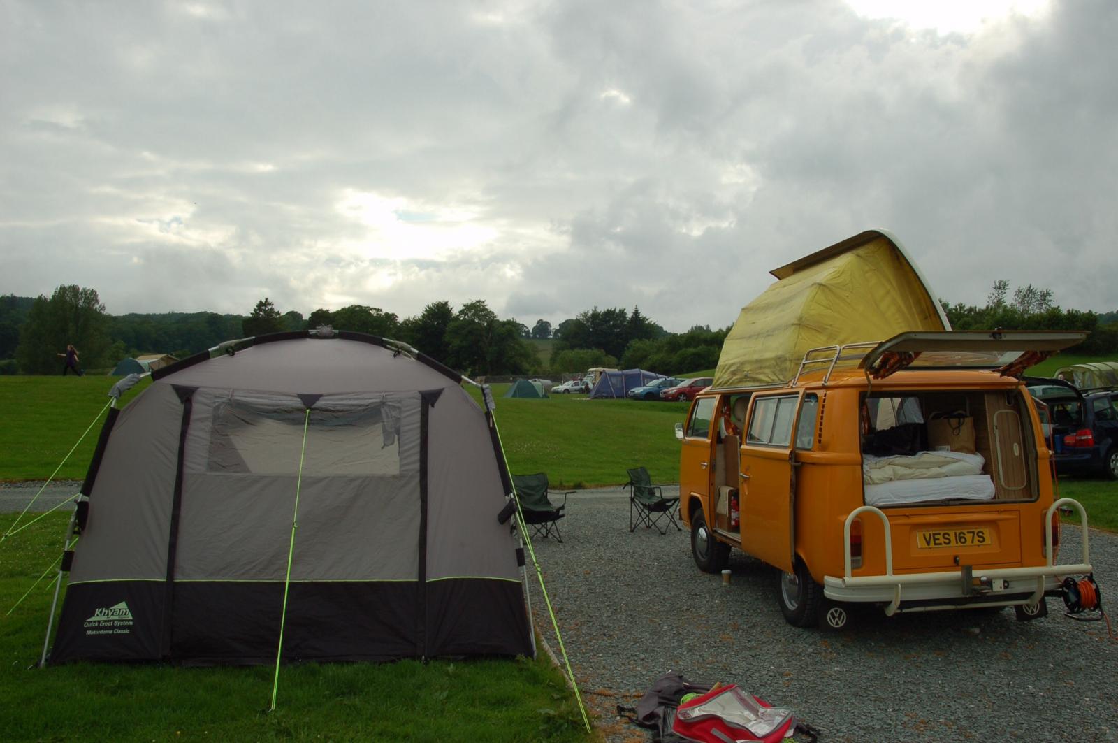

We arrived Friday evening at our little campsite near Ambleside on Lake Windermere. It was so cold that we could hardly believe it was late June! Cars of friends arrived from all directions until there were twelve of us, including kids. The biting midges were out in force, but it didn't dampen our spirits and we all sat up chatting outside until it got dark (about 11.15pm! Very Happy )

Some pics of the comfy living setup we have inside the Kombi, the stunning Lake District scenery (there is a Karmann Ghia tee shirt in shot, but the photo might not stay in the gallery! Wink )
The weather closed in later in the day, and we ended up with a couple of inches of 'liquid sunshine'! The bonus was that I got a pic of a fading rainbow behind the Kombi.

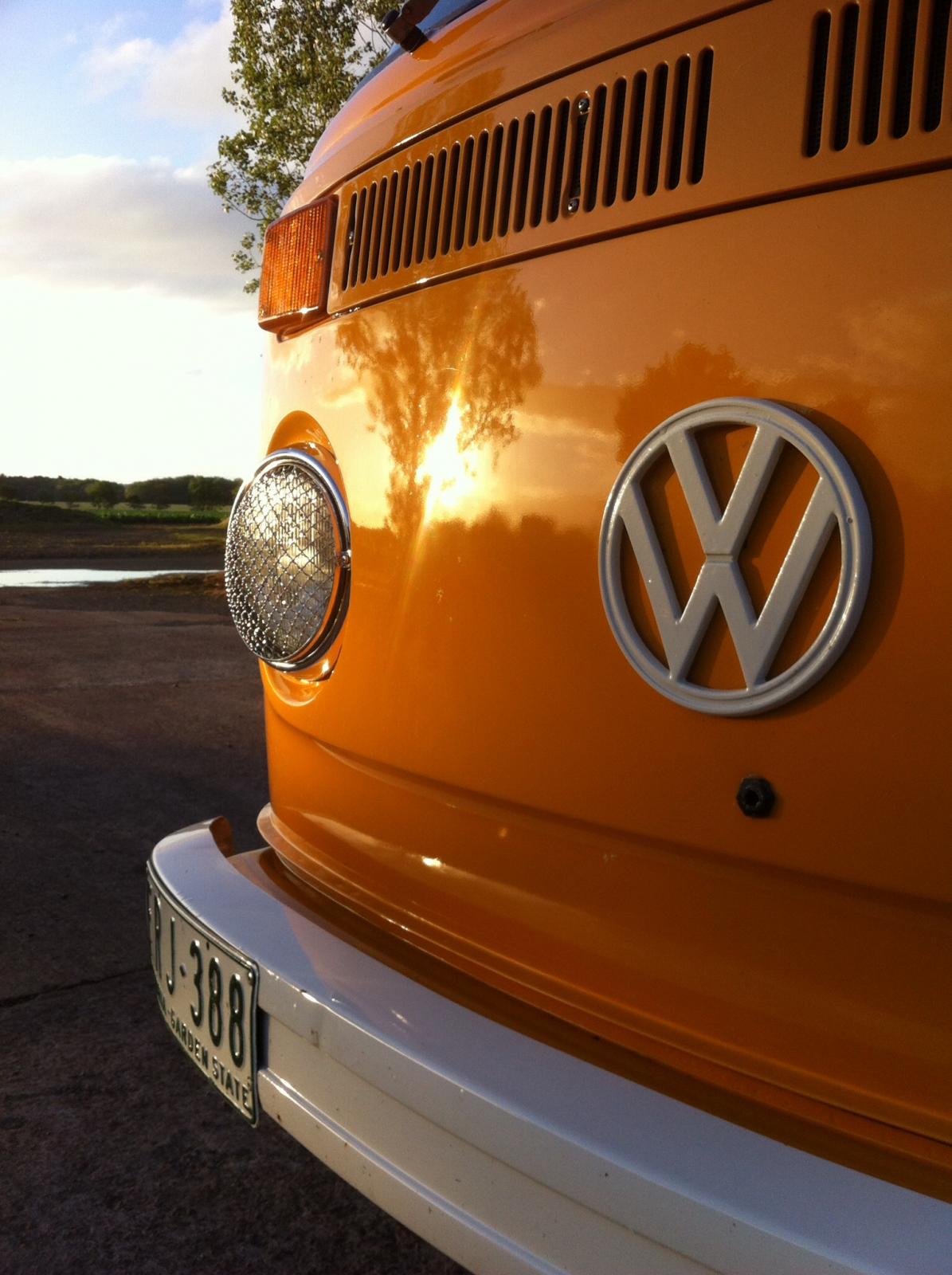

Finally...
My favourite pictures from the weekend.
Couple of the cat, couple of the 'van, and one of Shona doing a handstand (National handstand day, apparently!? Rolling Eyes )
