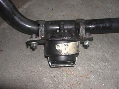

Here is a picture that I used as a reference. You can just make out the part number.
Here is a listing on Amazon with the years. They were a bit pricey, but comparable in price to the OE diesel mounts. There is cheaper rubber Saab mount, but I opted for the hydraulic ones.
http://www.amazon.com/85-94-Engine-Support-Hydraulic-REIN/dp/B00U11LHB4

Awesome! I really want to update the mounts, esp if I'm doing everything else for the conversion. You're various posts here and vwdiesel got me optimistic Very Happy

Glad to help if I have. I spent about a day staring at the original carrier bars trying to figure out how I would modify the stock bracket to support the Saab mount. I just could not get it right in my head and decided to cut off the factory brackets and fabricate my own mount cups. I don't believe the Saab mount is designed to be hung by the ears only. It probably worked for the original person above, but not for me. Good luck.
