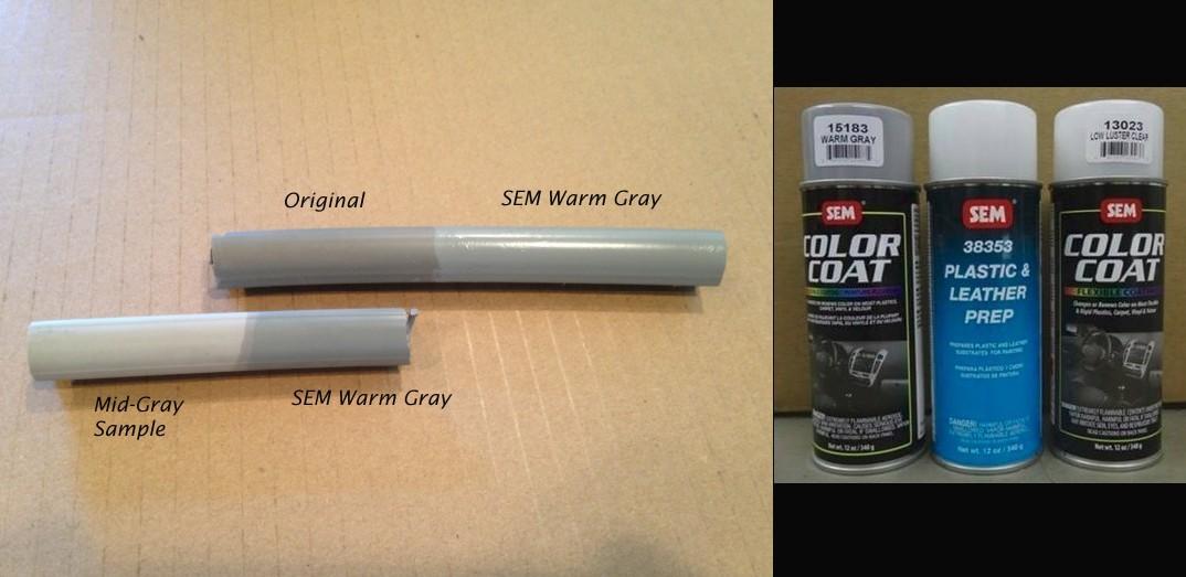

The title of this thread should be 50 Shades of Grey!
I have looked at samples from Reimo and Gunzl and none of them match the US Grey trim color. Whatever was used back then is not in production as far as I have looked.
One option is to use a vinyl paint and I purchased some on a recommendation of another poster. That grey is not correct either but I am looking for a closer match.
The trim I have sourced samples of in the picture attached are given row by row.
Row 1: GoWesty T-Trim/Gunzl Dark Grey Door Trim/Reimo Dark Grey
Row 2: Reimo Mid Grey/ Original Westfalia Trim/Gunzl Dark Grey T-Trim
Row 3: Gunzl Grey/Reimo Silver
The Silver color was pretty close but has a metal flake mixed in. What Gunzl calls "Dark Grey" in it's door edge trim is closer yet to the original but is not available as other trim types. It is also the wrong plate width, 13mm only where the original plate width is 17mm. The Dark Grey samples from Reimo and Gunzl of the T type trim are much too dark and the mid grey samples are all too light.
The paint options are from SEM and include a cleaner, color and clear coat. The colors shown here did not work but the flexibility and adherence of the paint were very good. I am ordering other colors to try and match better.

Well that seems to be getting closer now.
