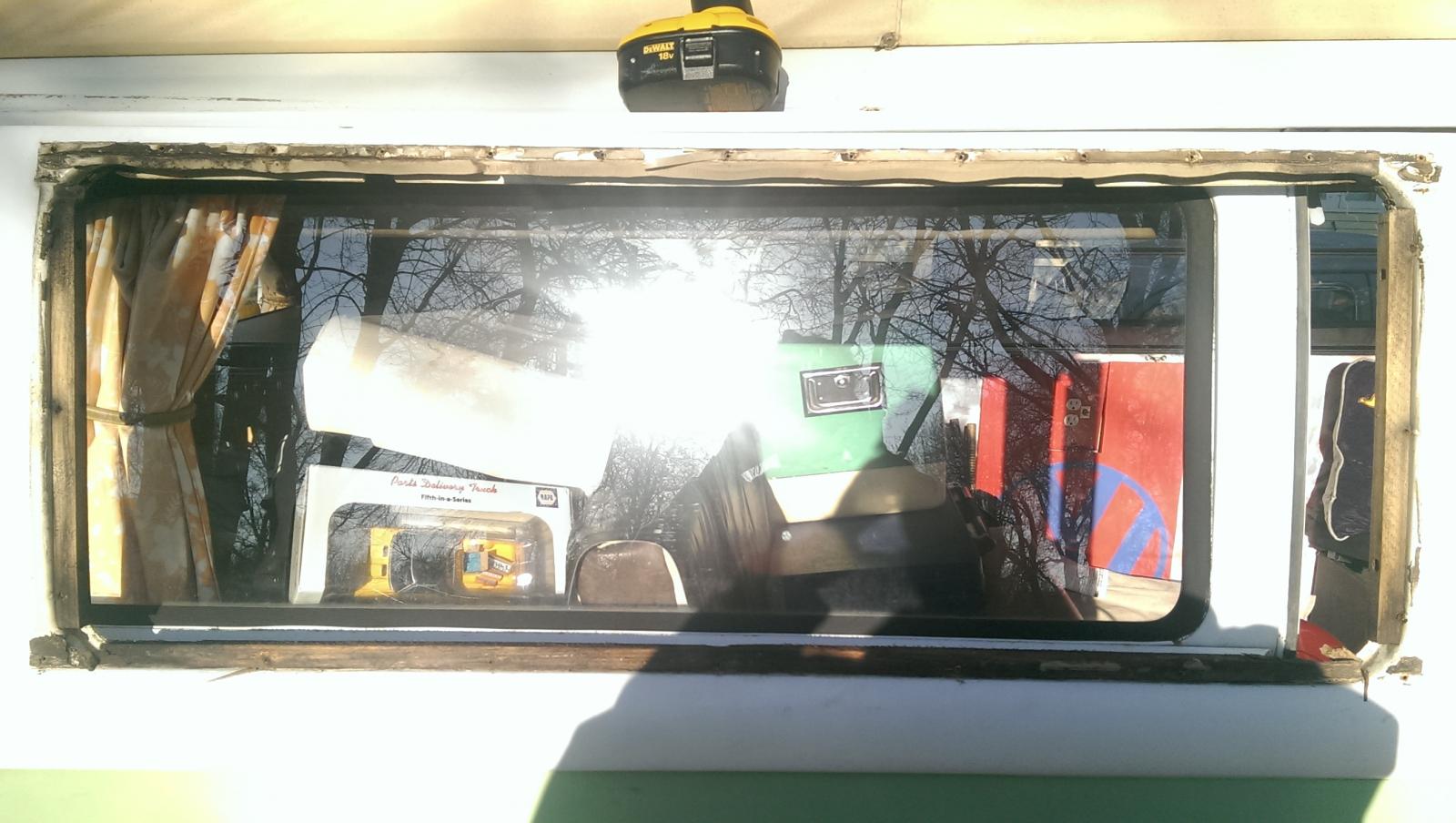

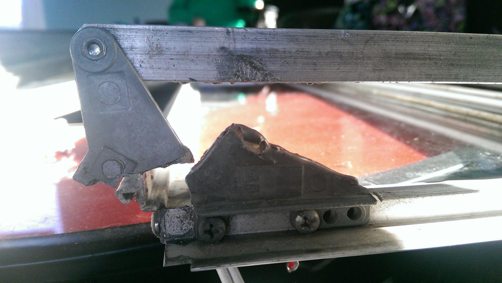

One small but important thing I did was rebuilding the jalousies, which were held in by rotten wood and caulk.
Not a good scene..
Plus they didn’t work, found a parts supplier online.
Surprisingly, there was NO rust!
FUNCTIONAL!!, Not to mention all shined up, new screws, and I did get new flap seals further down the road to really finish them off.

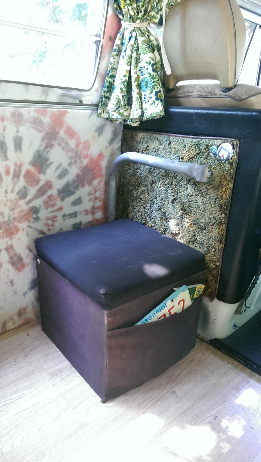

Like I said, I’ve done lots of small stuff – but that’s boring, let’s get down to some good stuff. I needed an awning.
I put out a wanted ad for a Trans-awn 2000, or similar, and got a response from a lady that said she had something like it.. In the car I went. Turns out she had a brand new 10 ft Catalina 2500 awning that had literally been set up once, she was alone, it got windy, she got scared, so she cut the fabric out of it. She said her husband was impressed… So I bought the awning-less awning and even the rain gutter mounts for next to nothing.
I then happened to be in a Jo-Ann’s fabric in St. Louis and came across this Sunbrella material. I googled the awning’s dimensions (had never set it up as the fabric is what holds it together, plus it was a few states away) and estimated a bit smaller, because I’m cheap and didn’t want to buy extra material.
I then sewed it together myself, in St. Louis, and carried it in my carryon back to Iowa. Several hours, 10 bloody fingers, and every curse word possible, I got it threaded back onto the awning frame. For those wondering, that was one of the worst thing I have ever had to do. But I think the results speak for themselves, worth it. I then set it up. It pulled out to full extension, clicked in to the “I’m all the way out” grooves and I then realized that somehow guessing how much fabric I needed based on 3 different Google dimensions, then buying less than any of them, folding the ends in 3 inches each, doing some cutting, etc. made it EXACTLY THE RIGHT SIZE?!?!?! A million dollars says I couldn’t do that again if I tried.
Yes it stands up straight, I just put it down for the picture so you could see everything. No it isn’t stretched tight yet in that picture. And no it wasn’t real waterproof yet. I then coated it with several coats of 303 fabric guard. That stuff is amazing. Water runs off it now like a duck’s back. I’m still amazed by that product.

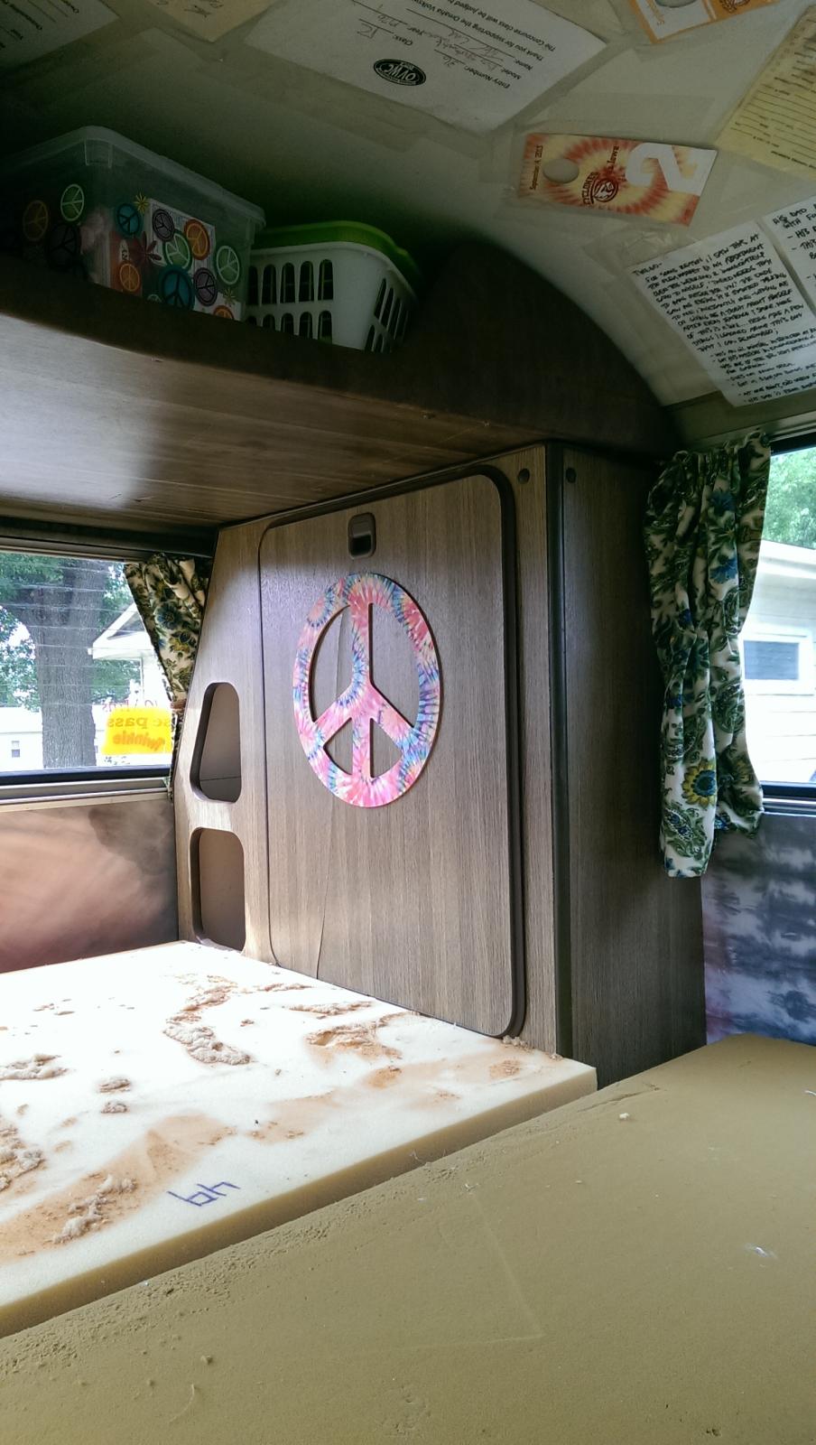

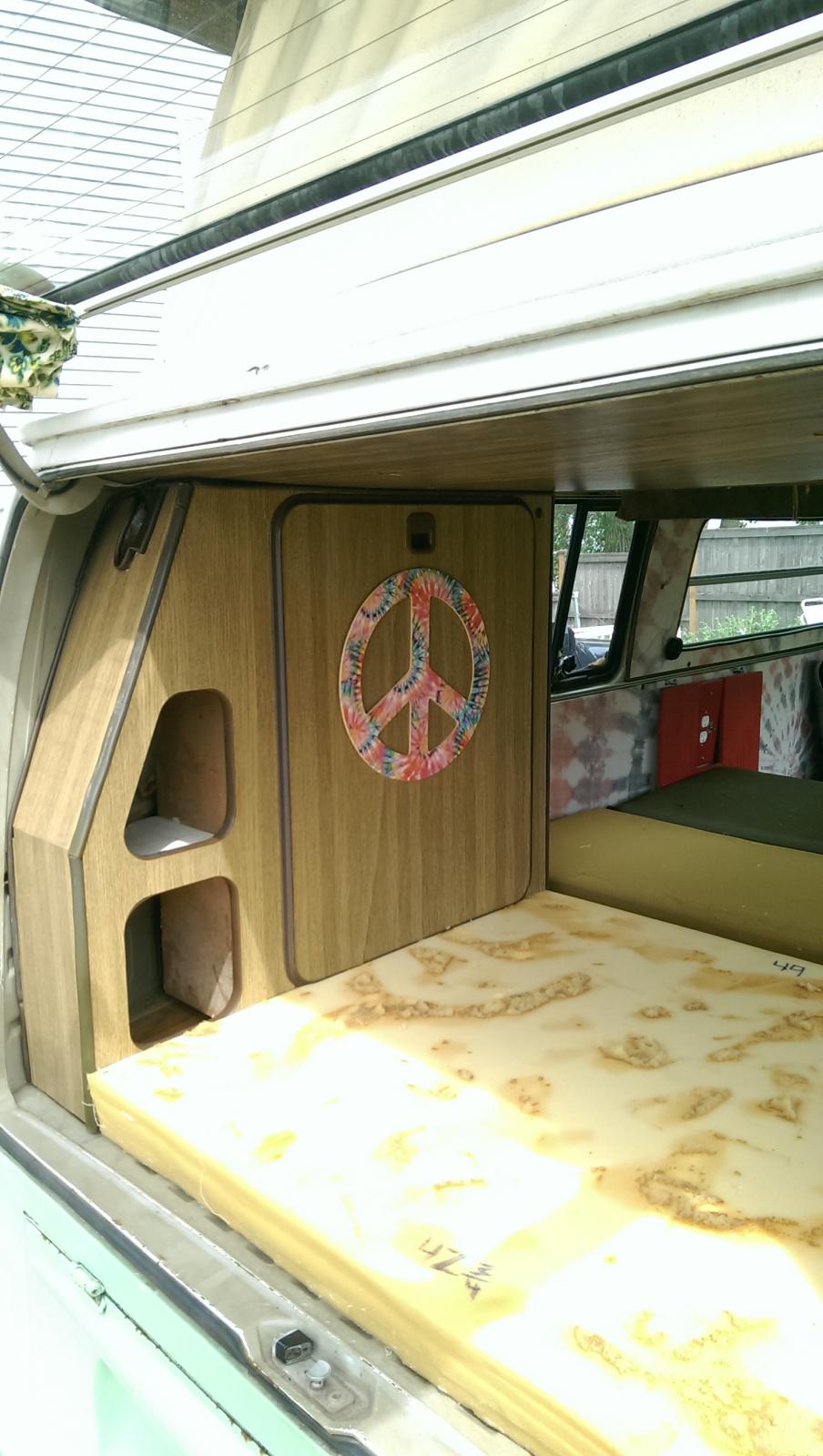

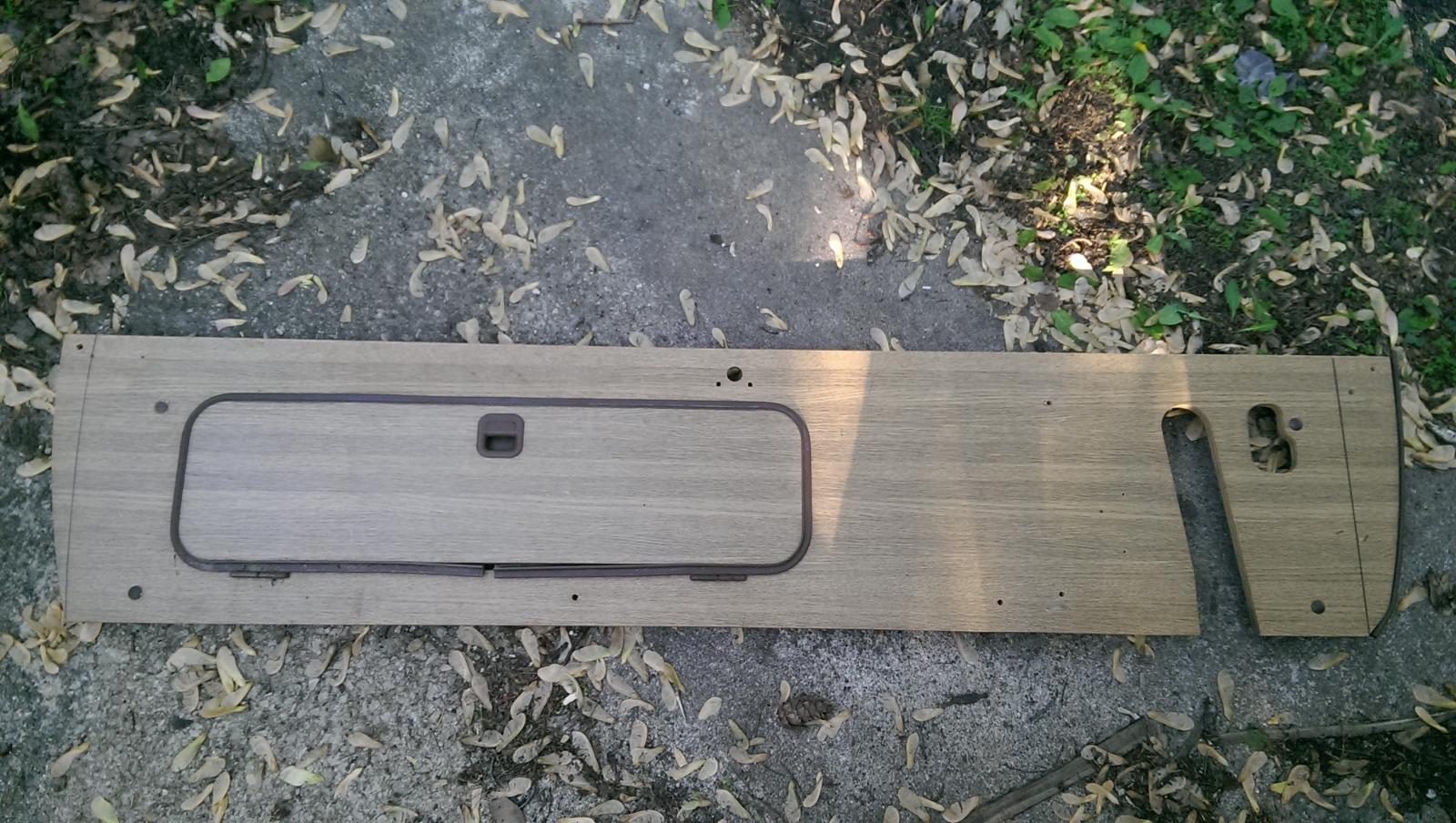

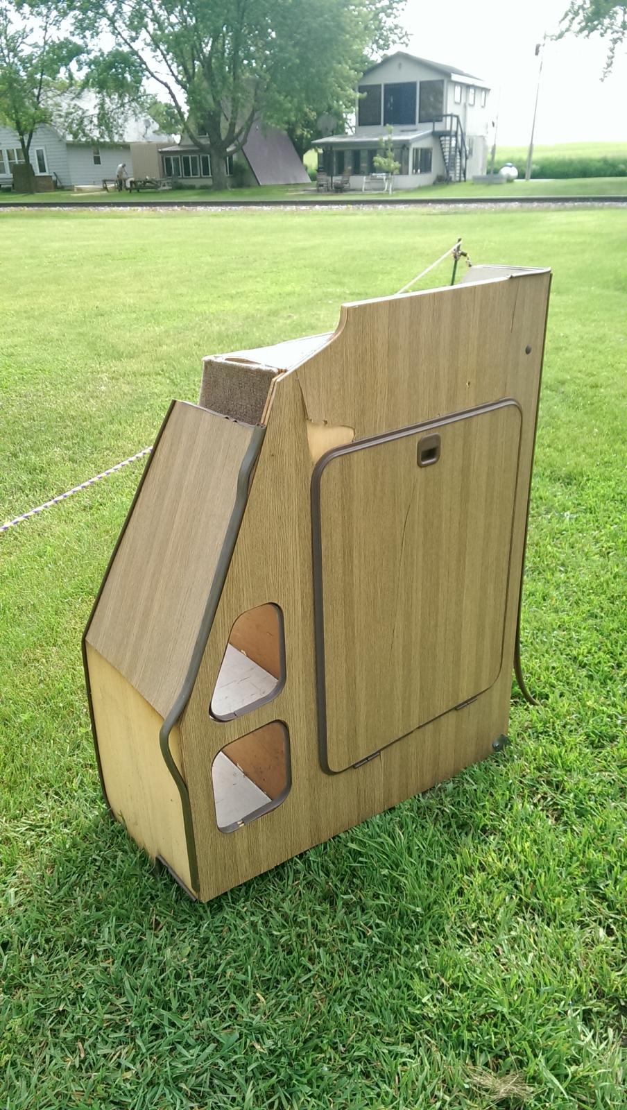

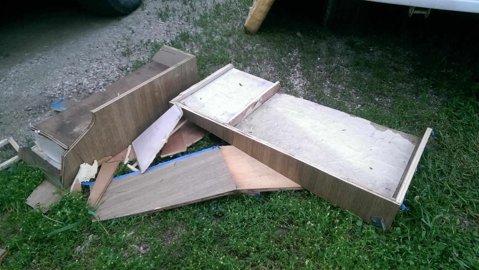

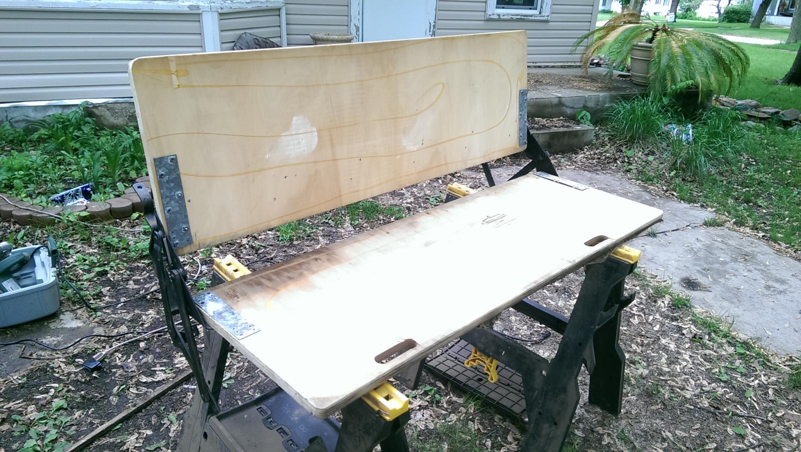

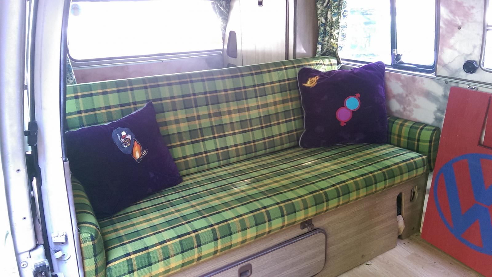

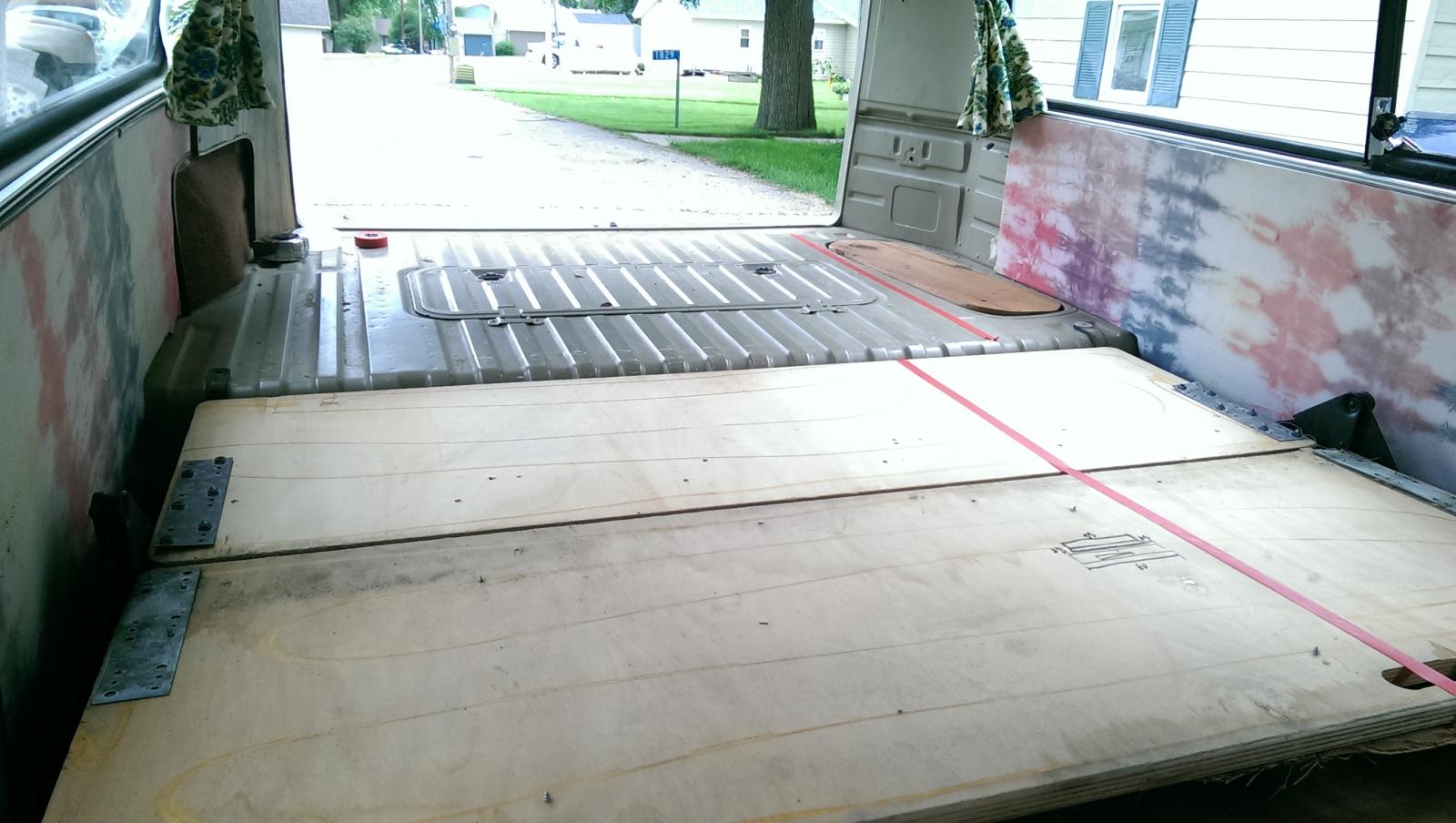

Ok now here comes a really meaty post… installing a Vanagon Westy interior into a bay.
Yes it can be done! No it isn’t easy.
Here is what I’ve been rocking with for the last few years..
Then I came across a Westy Vanagon in a junk yard, and the work began.
PS – nothing fits right in any shape or form. Dirty pizza box templates are the only way to go.
Lines are where to cut..
And it fit, so screw it, let’s really start hacking stuff up. Out comes the old bench, out comes the floor, out come the saws, and away we go.
Of course not even the backrest support was in the right place
More lines, more cuts
Had to modify the brackets so I didn’t have to drill more holes in the floor..
Bay Westy hinges installed, because of course the Vanagon ones made it the wrong height… and it works!
And fits! The tape line in the first pic is where the current closet would sit, that’s not gonna fly, I want it more like the second pic, let’s do some more cutting.
Closet before..
More lines, more places to cut
Test fit, height’s right, let’s get it a little shallower
There we go
Carnage..
Time to fix some laminate
All better!

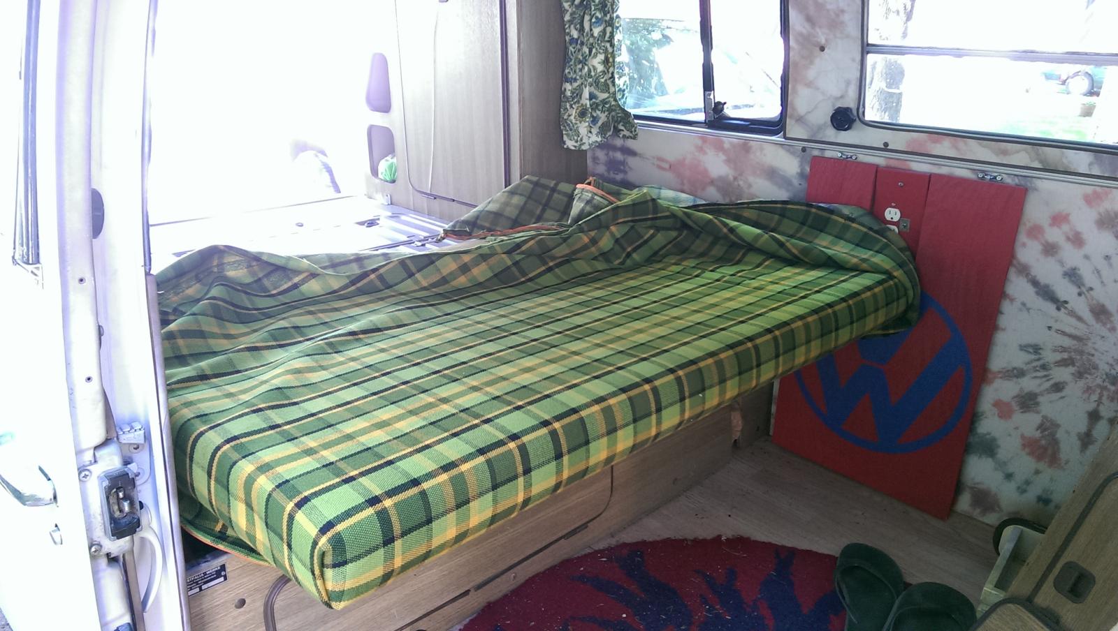

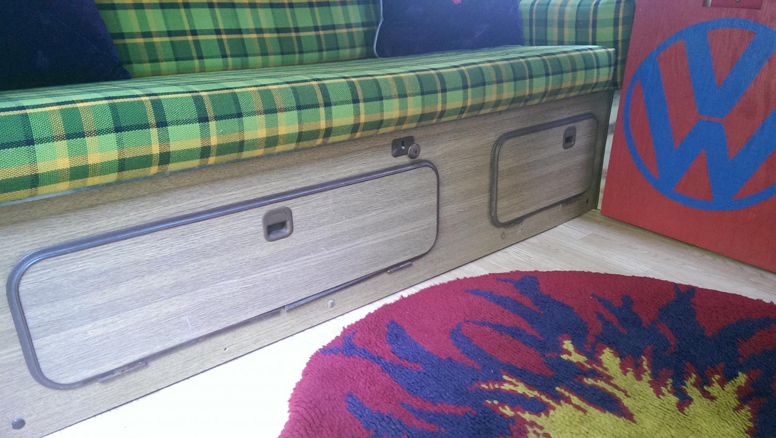

Now for the really good stuff. The Bay I got the hinges from, also happened to have some of the cleanest plaid ever. I used the top cushion plaid to do my seats, as I don’t think it has ever even seen the sun… the rear cushion received the almost-as-nice og cover from the same bus
I’m anal, I hate that Westfalia never lined the plaid lines up. Well I did.
Oh and about those pesky holes in the front..
Time consuming. But worth every second to me! I love my new storage, I love my full width bench and bed, and I love that its just a bit different than everyone elses. This probably could have been a costly adventure, but luckily my 2 junkyards I go to are insanely cheap (like 10 bucks for my dash clock cheap) and I actually paid less for everything, meaning plaid, closets, bench cabinet, etc, than I sold my old bench for. And I only sold it for 200!

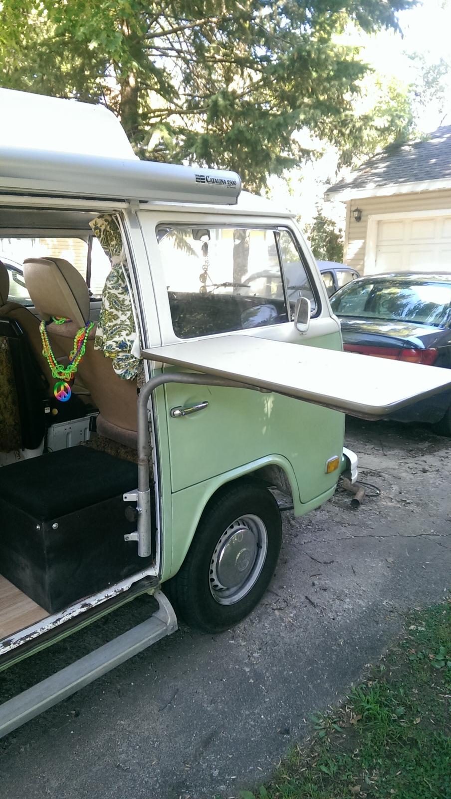

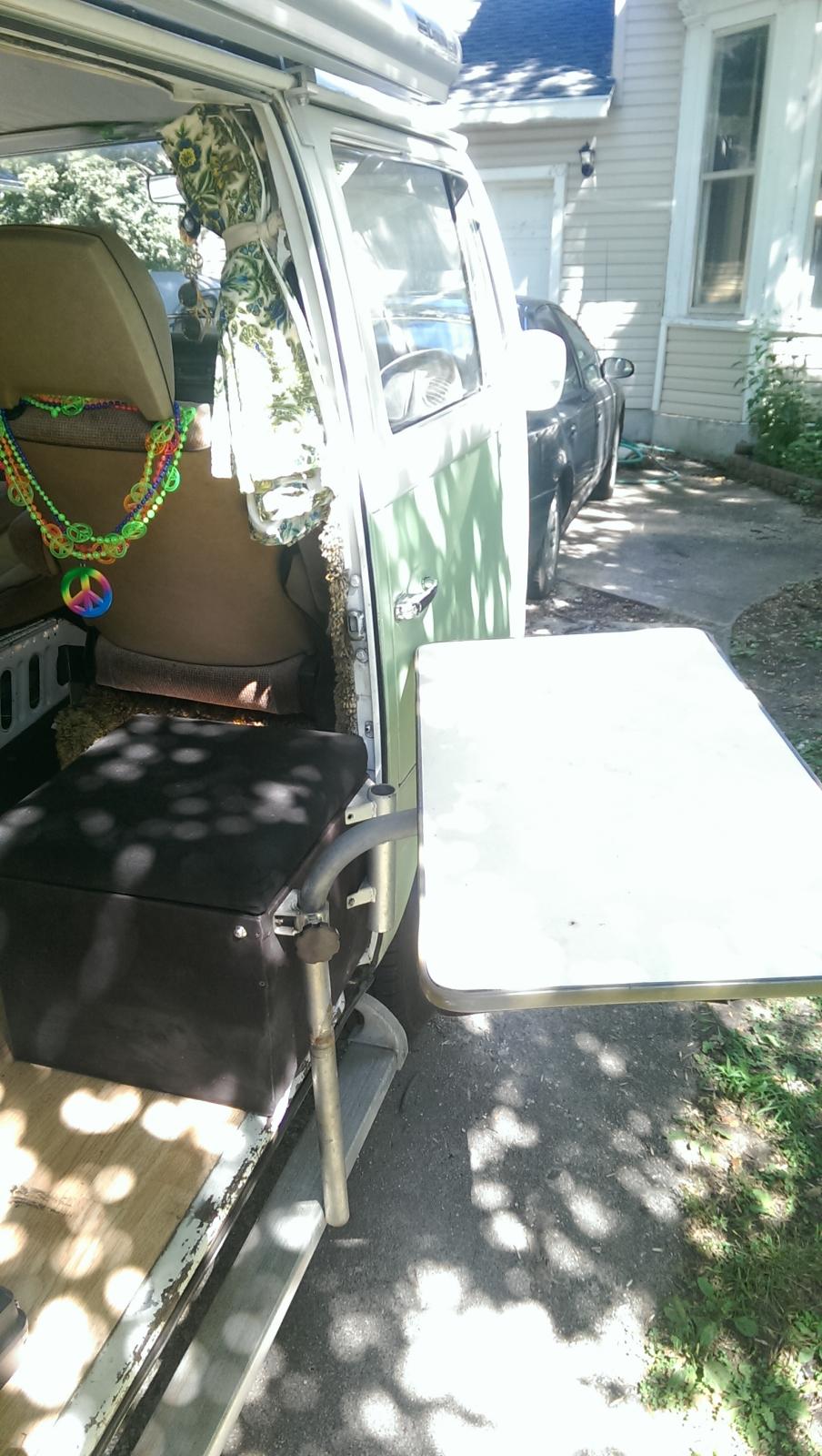

Since I have an original side step, my jack points are occupado.. But I wanted an outside the bus table like all the cool kids. So I threw this together.. I have a handful of table mounts and parts from junkyard excursions, so I reinforced the corners of my jump seat box and threw them on there. Surprisingly it really is stable and not that tippy at all, as I store all my spare parts in there, and I arranged them so the heavy stuff is on the backside… I kinda like it, now to fix up that table laminate..
adjustable mount for whatever height table I may want
High mount for a tailgating/bbq/drinking/party bar (picture taken before the other mount was mounted..)
all put away

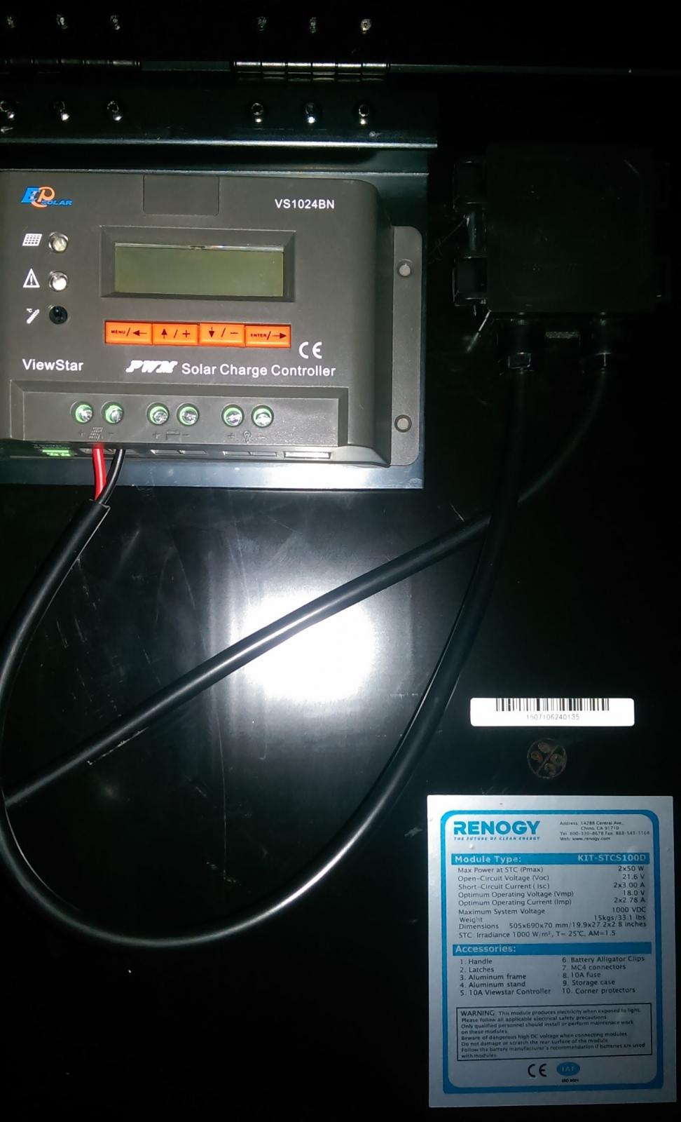

A Renogy 100 Watt Solar Suitcase, this thing is Sweet! It is fully height/angle ajustable, comes with a very nice and easy to use charge controller (with over charge protection, heat sensors, and all those necessary bells and whistles), and 10 foot cables with clips on the ends to simply clip on to your battery for off the grid charging. Easy set up, easy tear down, easy to move around and put in the sun without the hassle of moving the bus, like you would with a rooftop mounted panel.
Yes it is angled towards the sun, yes it is in the sun, yes I stood in the sun to make a shadow for a better picture... My battery was low, but not completely depleted, and the solar panel topped it off and kept it fully charged while I had all the lights, radio, etc. on inside. Love it!

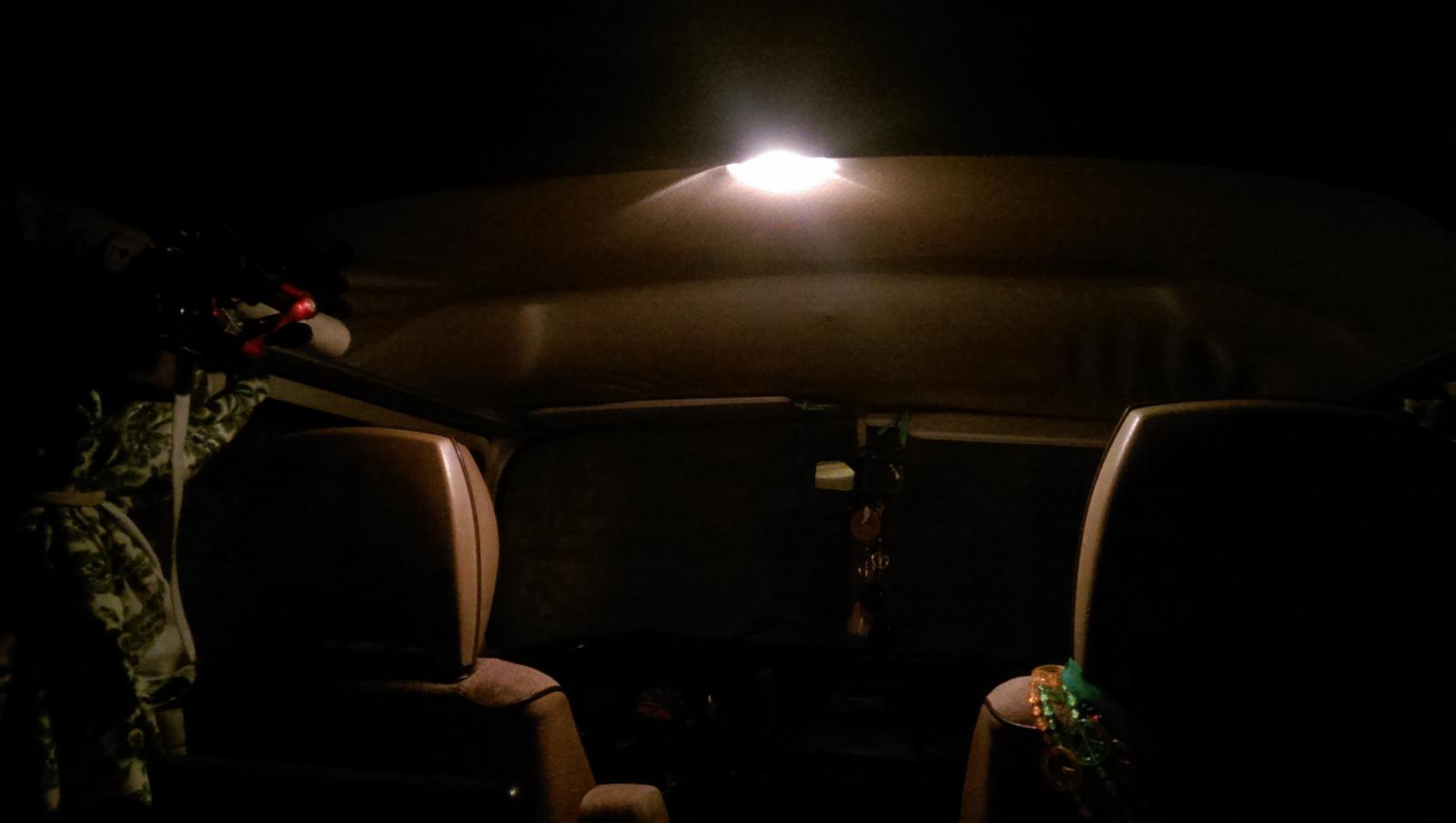

If you haven't gone to LEDs... Do it. Now I can actually see, and I'm not sucking any power doing it. The old girl turned the big 4-0 on January 7th, so I bought her some cheap light bulbs. Holy crap did they make a difference.
16 LED direct replacement bulbs
Before
After
This is how much brighter it is in there with just one bulb swapped, I still have the pop top light and a rear light to do, but they will take a bit of modification. I should be able to tan in there when they're all lit up... For now I'll just let this be my motivation to tighten up that headliner...

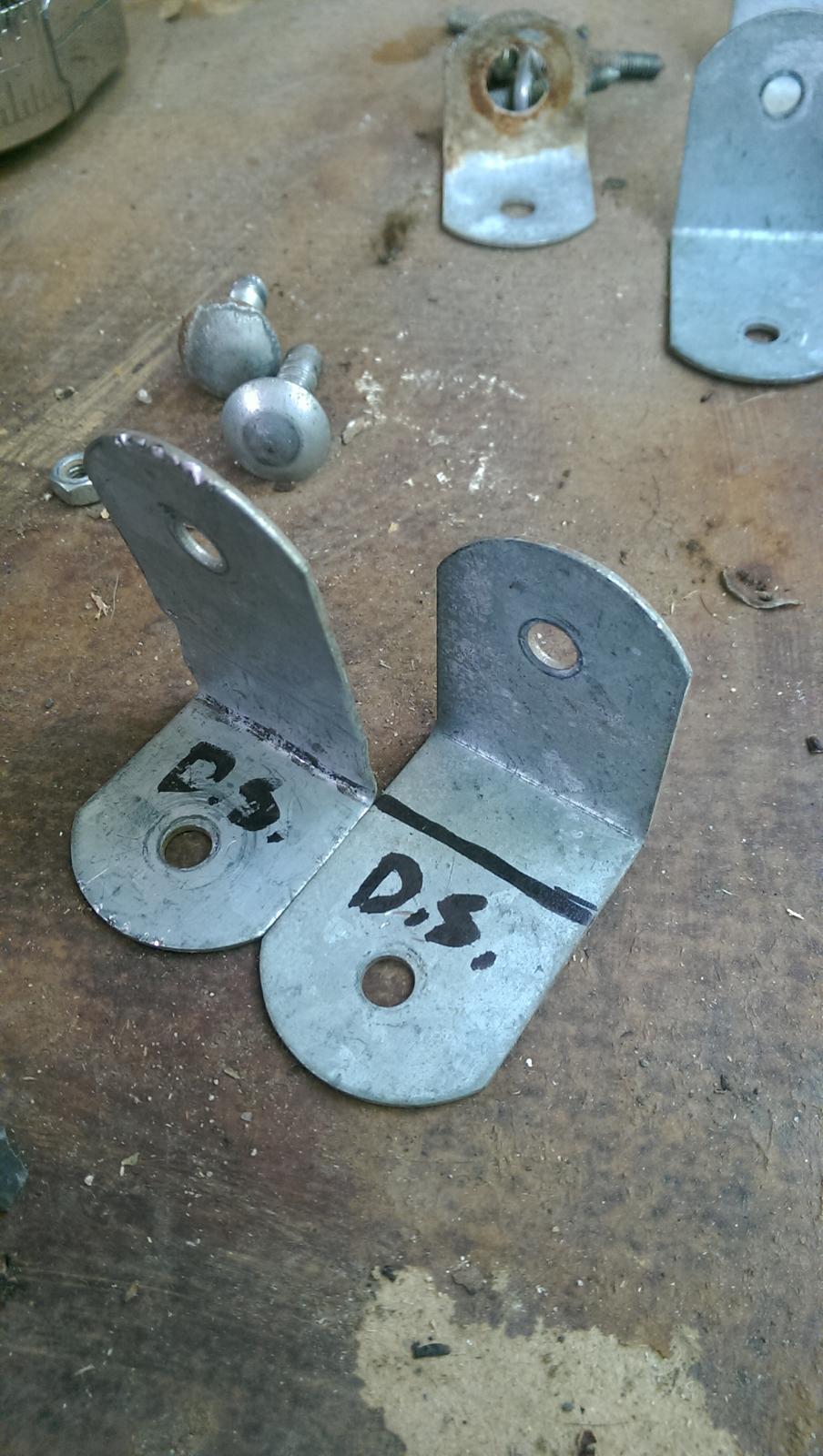

I've had a set of 4 Quick N Easy clamps sitting around for a few years and my idea was to use them, build a metal frame, put wood slats on it, and then bolt this rack to that, kind of a Westy/Sportsmobile rack mash up.
Then the other night while finalizing my design, I noticed that when mounted, the clamp measurements from hole to hole were very similar to the outside measurements of the rack… For shits and giggles I took the 2 outside legs off, and put the clamps where they were, using same holes, and threw it up on the bus to see how far off everything would be..
And the magic happened.. Not only did it fit perfectly side to side, but the height was perfect too?! How?! My mind is blown, but I now have a roof rack.
Now I plan to put a nice gasket on the bottom of the remaining feet and let them just act as stabilizers.
