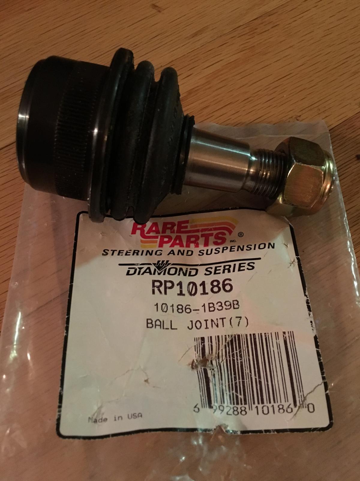

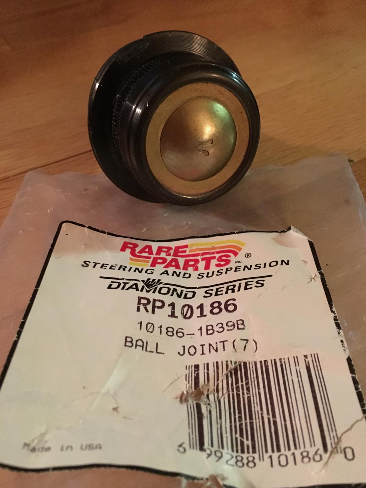

One vendor I get from Autozone and Advance search on VW ball joints.
Rare Parts out of LA.
http://rareparts.com/manufacturing
Granted they are not cheap at $50 per unit, looks like they build according to time tested manufacturing practices.
http://m.autozone.com/suspension-steering-tire-and...?location=
Any comments or experiences on them?

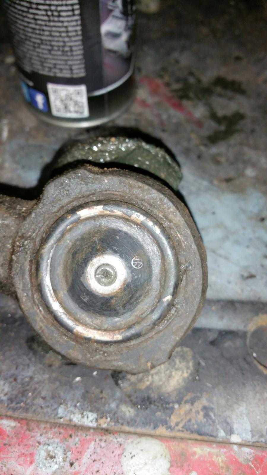

Here's an original VW ball joint out of a 70' bus. You can see the VW logo on it.
The Samba member since 2004.

This is VERY interesting. If and I mean IF this ball joint is as good as the original VW ball joints installed when our VW's were new, it would be worth every bit of $50 each.
To be able to install a ball joint w/out worry's of it being too tight or lasting only a few thousand miles would be terribly refreshing..
I hope someone has tried these and reports back.

And the plastic plugs for zerk fittings, only seen on early early bays. A great way to keep your original parts alive. Sadly, most POs ignore ripped boots so long that even the freshest grease can't save them. My zerks got me out of a bind, once, pardon the pun. After a long desert crossing with huge sandy side winds, every right turn was met with grinding and stiffness. A few pumps of grease and it was better than ever…

Rare parts does pretty good work with the joint itself...but look carefully at bracketing For instance...they make a ball joint for the 411/412....which the joint itself is excellent...but the surrounding mount is far too weak and bends easily. It can be fixed with a strengthening ring for about $10 and some time....but.....
That sectioned ball jjoint you have in your picture appears to be made the old TRW way...no spring...nylon alloy packing...and swaged until the turning torque is correct.
The really important thing to do is remove the boot and find out what family of grease is in it if you can. Mixing the greases over time will causes corrosion due to metal polarity differences in the grease...but more importantly....it can eat the nylon cup if you mix greases. Ray

Hey folks here's the Rare Parts Inc ball joints.
Looks of decent build quality, least they are made in the USA.
You can move the spindle, so I would not say they are super tight.
The boot looks ok, some protective coating on rubber.
Took week to deliver and cost ~$180 for four.

Let us know how the press fit interference is? Also, stop by this thread every few months to let us know how they're doing. They're the most expensive options out there right now, but they're CHEAP if the metal and boots last in the grand scheme of things.
