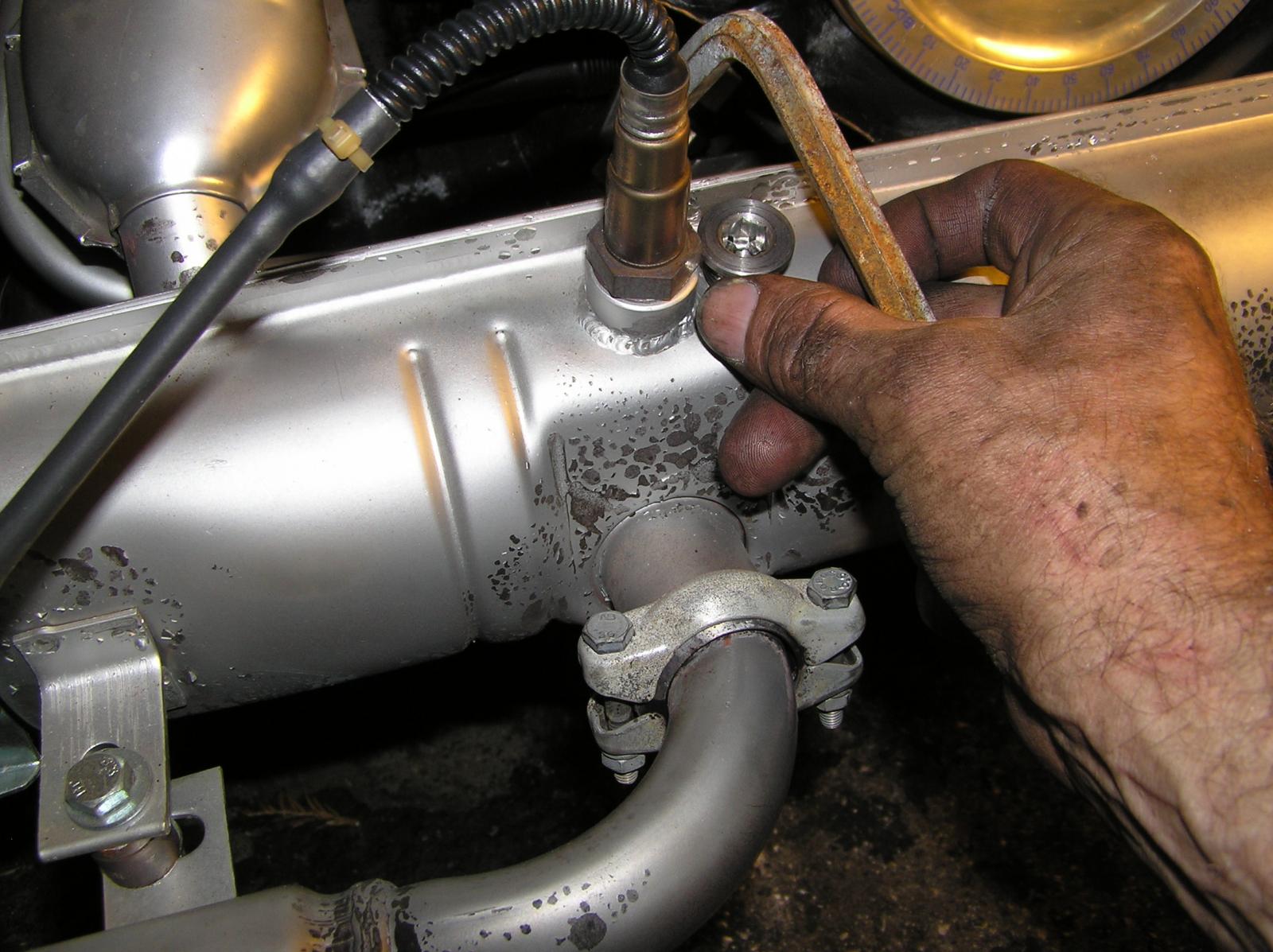

IMO you are wasting your time trying to tune it without an Air Fuel ratio meter, the reason most people have problems with their T1 engines not idling is incorrect jetting, and/or not functioning properly manifold preheat(if it buns the heat paint where they come out of the manifolds, its working…)
For around $230 + Tax and shipping and $20-$30 for someone to weld the O2 bung into your muffler your carb problems will be solved! (Because your will know if it is really rich or lean, and by how much)
Or you could spend the rest of your life trying to get the A/F correct on your carb…
In CA with Alcohol in the fuels my experimentations showed me there is no way in hell to get the A/F where it needs to be using the lean idle drop method in the vw manual!
When I did as directed by the Factory Manual and watched my O2 A/F Gauge; the A/F was way too lean, i.e. I could not get it to idle worth an expletive… The O2 A/F Gauge explained why I had never been happy with my idles hot/cold. (in my Case way too lean)
With the A/F gauge, I was able to figure that the source of my problems was the idle jet, it was too small, after going with a two size bigger idle jet, and using the A/F gauge to adjust the idle and Fuel mixture screws, my hot and cold idling problems were solved :0)
https://www.cbperformance.com/ProductDetails.asp?ProductCode=2926 (ask about extending the wire for use in a T2 Bus)

The problem with using a standard jet number someone else has had success with is that there are so many factors that affect A/F which makes most ACVW T1 engines unique… to get an engine to run well on the stock jets, IMO, the engine/fuel needs to be at least to 95% OEM spec:
In CA having 10% Ethanol in the fuel puts the stock carb jets out of spec just with the blend…
It won’t hurt to get the timing right, but to do that you have to get a TDC tool and verify your “0” TDC, you can get the 14mm ones for about $15, hard to set your timing accurately without one, too many possible chances for errors unless you are 100% sure the pulley on your engine is the one it was indexed to at the factory/crank, case, pulley...
And to time it properly it helps to have it idling well ;0), with a 009 most just adjust Max tinning and use the A/F mixture to make it idle well… proper use of a vacuum gauge can help in getting the best timing for a particular engine.
It’s a fact that some have more time, experience and/or natural carb tuning skill than others, but for the average T2 DIY mechanic it will solve the most complex tuning piece of the puzzle, once you see you have a good AF numbers it’s pretty simple to track down other problems… that is why all modern mass produced vehicles have O2 sensor without O2 sensors modern cars would be several orders of magnitude less drivable/reliable
If you have more than one car that needs AF trouble shooting then I would go with the Innovate LM2 but that setup is more pricy…
I like having a dedicated A/F gauge on the dash of my T2, when driving and the power/idle feels wrong all I have to do is look at the A/F gauge and 9/10 times the A/F number sais it all :0)
