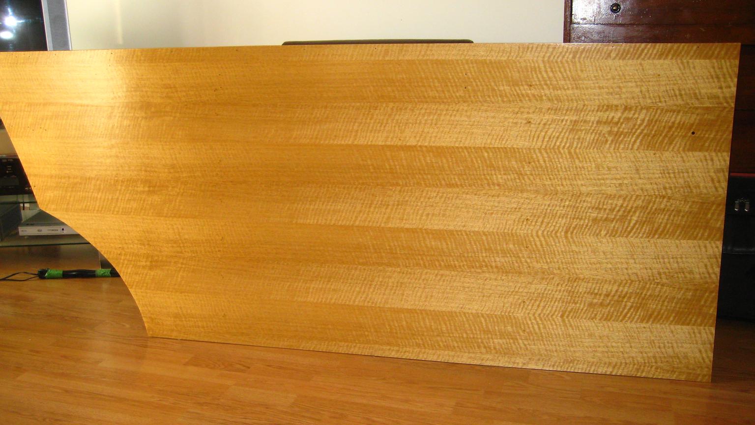

PostPosted: Wed Aug 31, 2016 7:02 am    Post subject: Re: SO23 Westy - Interior Limba wood restoration - roof / panels Reply with quote
perello wrote:
Just wanted to thank grailoc to encourage me on reproducing the westy side panel. Never did wood working before, and I enjoyed very much doing this.
Happy that my hold thread helped/motivated others to resurrect those SO23 interiors.
this the side panel I did back in the time. I did it horizontal for mine.
