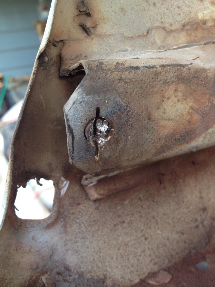

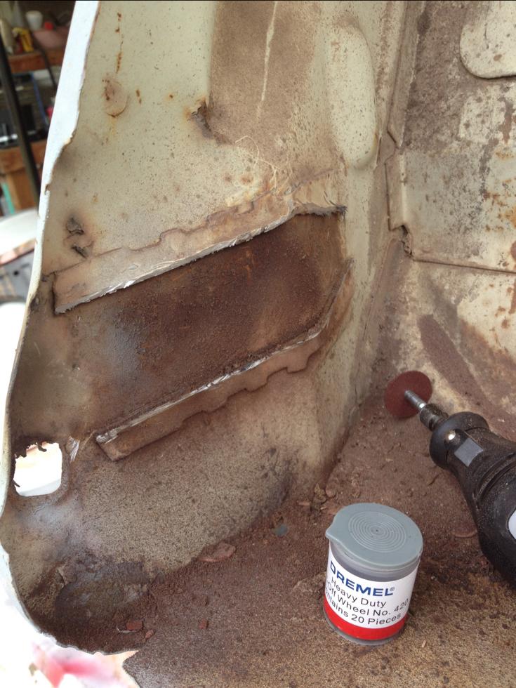

Decided to try extracting the broken bolt on my right front bumper mount while I have the apron removed. What a pain in the ass that has been! I drilled a hole through the bolt piece, got a "heavy duty" screw extractor in place, (mind you, I soaked the bolt with penetrating oil several times ahead of time) and proceeded to try unscrewing it with a crescent wrench, and POP! The freaking extractor now broke off inside!! If any one hasn't ever tried drilling through an extractor - don't bother trying. I resorted to cutting a slit into the bolt with my Dremel to see if I could get a heavy duty screw driver to get it out. No dice. I even applied lots of heat to it.
Instead of messing with the spot welds, I decided to cut the mount off with the Dremel.
I'll come back with a flap disk on my angle grinder and grind it smooth.

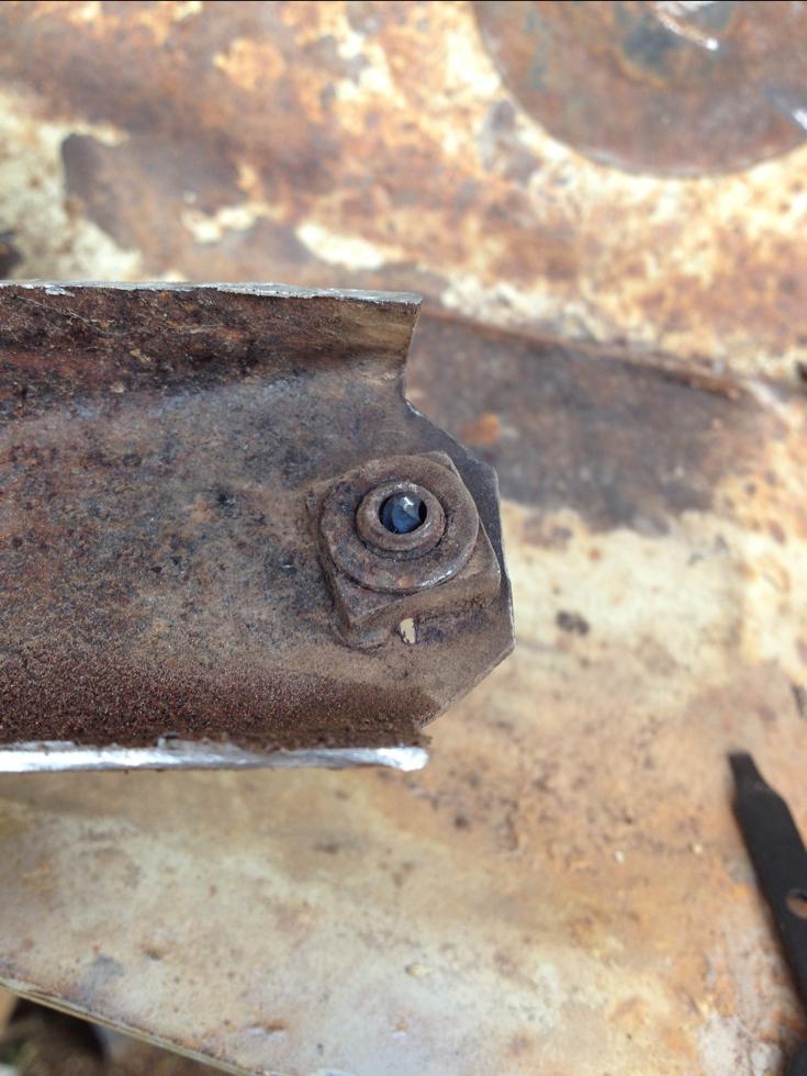

Here's the inside part of the mount with the extractor still stuck inside.

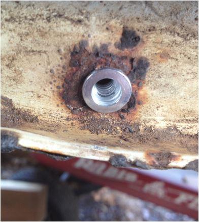

So while I'm still waiting for my motor rebuild to be completed, I decided to try fixing my running board/broken bolts issue. From other threads, I guess I was lucky that only 3 of my 8 running board bolts snapped off when removing the old running boards. I tried the screw extractor idea, and that didn't work at all. If I put too much pressure on them, they'd snap off inside the hole I had drilled, and removing a broken "easy out" was just about impossible. So after researching some threads, I found out about rivnuts (or nutserts), which were the best thing I could have hoped for.
I drilled out the existing bolt holes with a 3/8" drill bit.
(the rusty areas are just surface rust, mainly from sitting after spraying penetrating oil).
Here's a shot of the rivnut and the bolt & washer.
...and the rivnut tool.
These things fit in so snug and perfectly that I'd definitely recommend this method over using oversized wood or sheet metal screws like some people recommend.

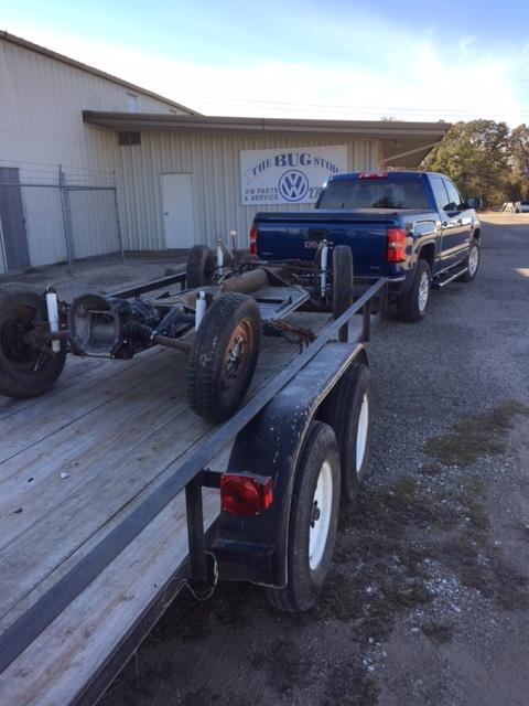

5 1/2 months later and I finally get the call that my motor is ready. Very Happy
I had them install a 12V flywheel to get the conversion done properly and decided to take my chassis in to have them grind out the transmission bell housing to accommodate the larger flywheel, and button up a few other details. Because of how busy they are, I don't think it'll be ready for pickup until after New Years...

Hiya, John - progress has been slow. Can't believe I haven't posted anything in almost 6 months! Most of what I've done hadn't really been noteworthy. I did get out and do a little today!
I finally got my chassis and rebuilt motor back. My only complaint was after my 2 hour drive home, I noticed they had removed the voltage regulator and never reinstalled it! Not sure what the thinking was there.
