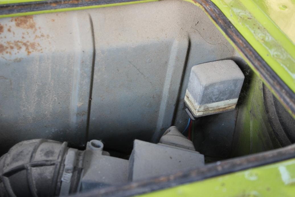

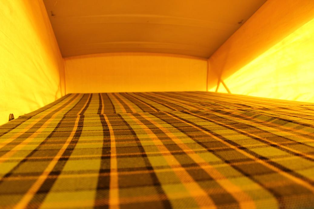

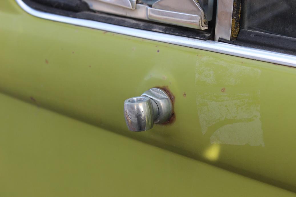

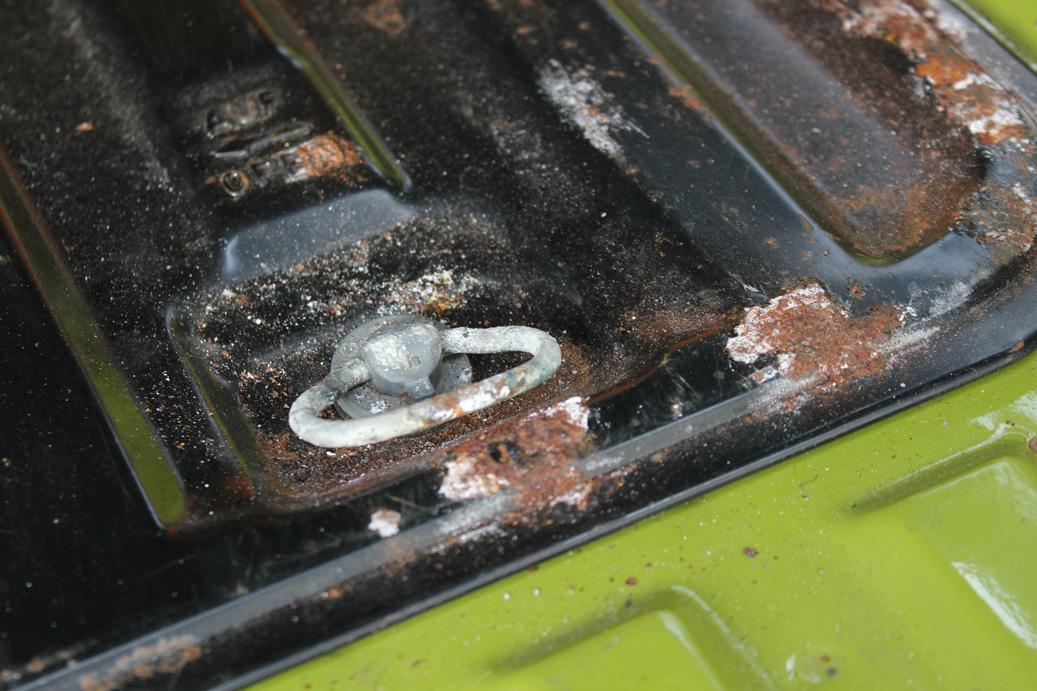

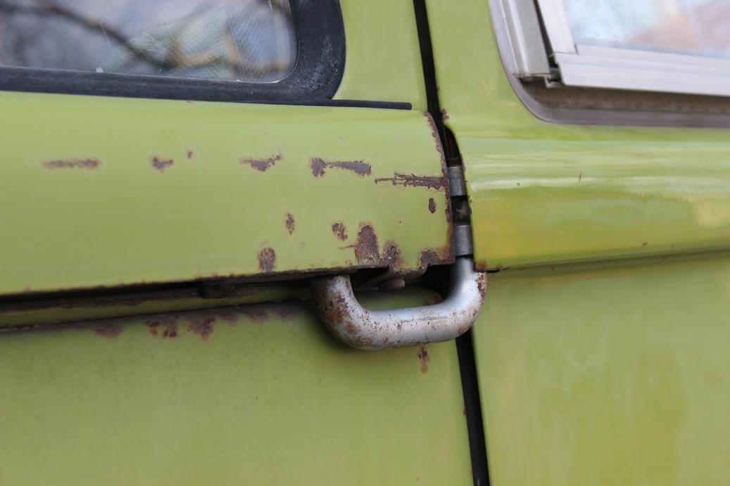

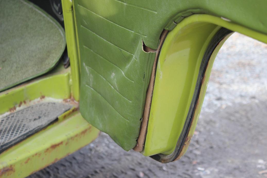

PostPosted: Thu May 05, 2016 6:42 pm    Post subject: Re: Olivia: 1976 Pop-Top Camper Reply with quote

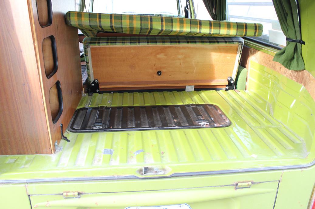

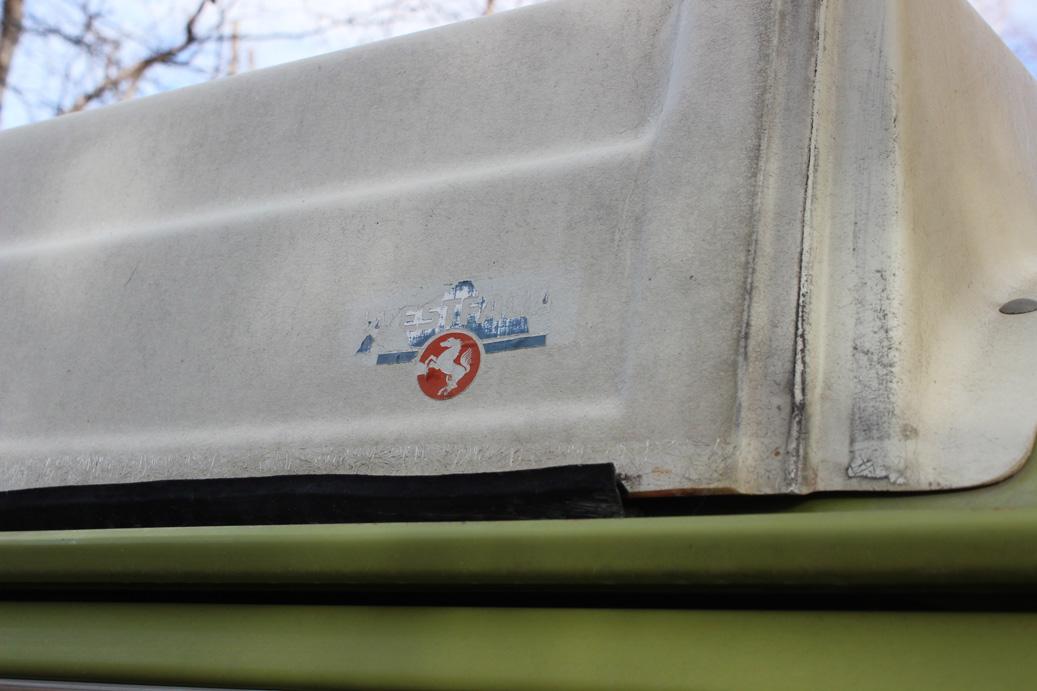

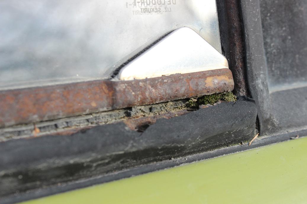

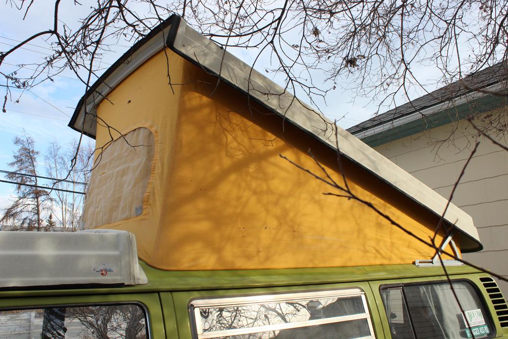

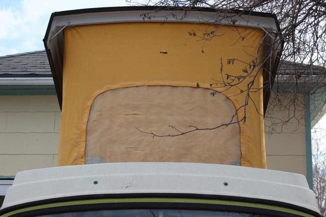

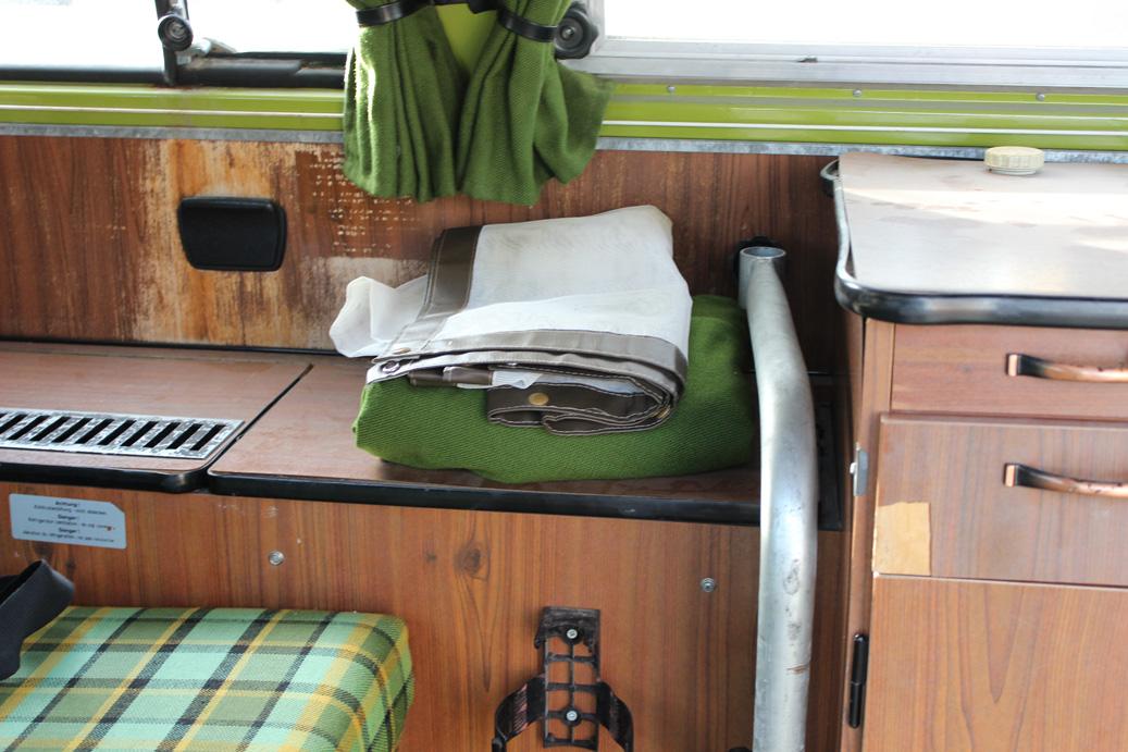

Here's a photo dump for your enjoyment!
I also took photos of all the inventory. I won't post, but it's amazing what came with this bus. I have the parts for every obvious repair I've seen, including a new (orange) engine hatch. There's even a muffler putty kit, though I think I need a little more than putty...
On with the repairs!!
[EDIT - photos are now uploaded to TheSamba's gallery per Tcash's request]
-Ben

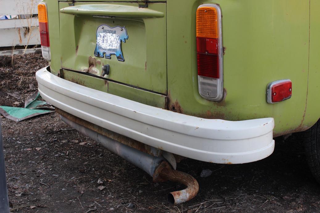

The first repairs are the obvious ones:
    Driver side mirror
    Easy, thanks to the replacement mirror ready-to-go. I should've saved this one for later when I was feeling defeated...
    Front seats(see photos above)
    They're fully worn - a lot of cushioning is lost, and the springs and hardware are biting at my ass and tearing up the upholstery. The seat covers are also fairly damaged and will only get worse under any use. While part of me wants to try to salvage as much as possible, it may be easier to order new covers and keep the old ones in storage for the next owner to cherish.
    Turn signal switch
    My first injury and lesson learned: use the right tool! I tried removing the steering wheel nut with an adjustable wrench and nearly ripped off my fingers. I slapped on a few bandages, cleaned up the, err, mess, and headed to the hardware store for a large ratchet and 24mm socket. Then two more problems arose: A plastic part and metal part on the new switch disagree on the location of a screw hole (so no fourth screw on the assembly), and the windshield washer hoses disintegrated on contact. Fix one thing, break another...

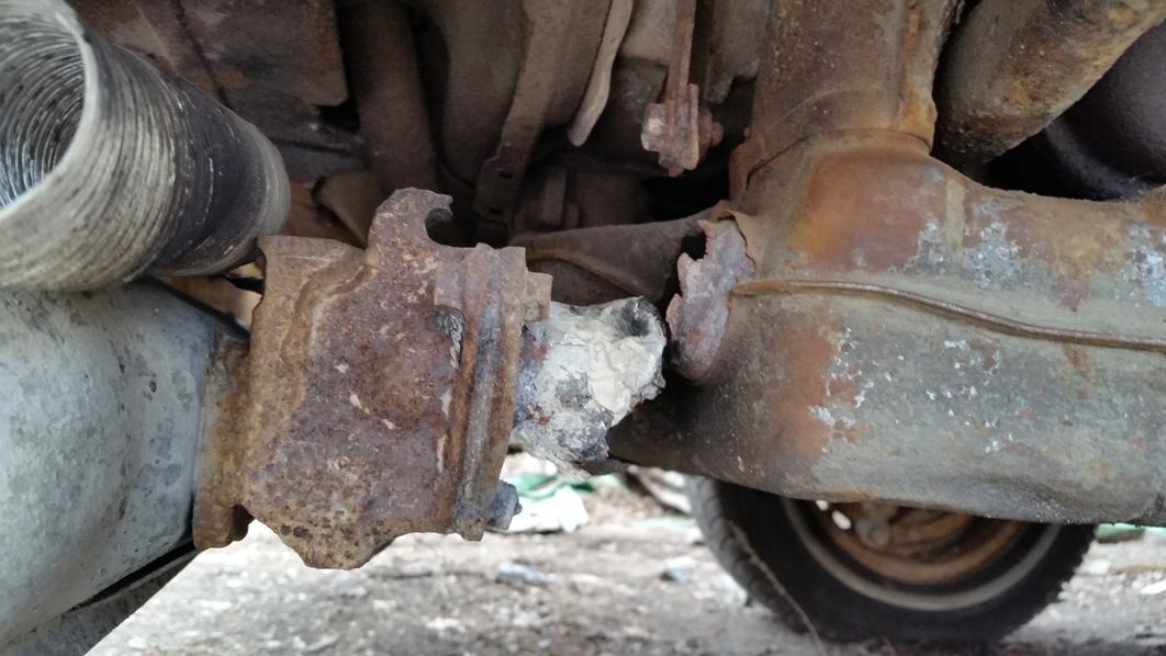

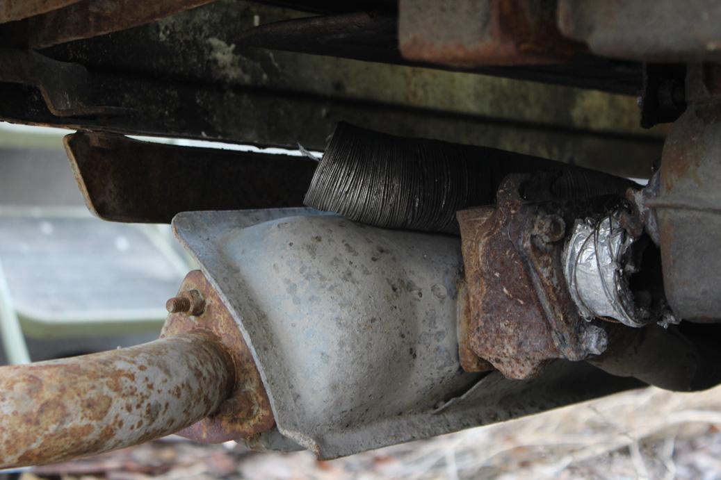

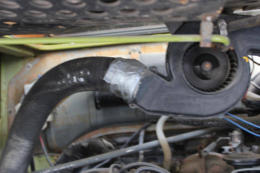

    Muffler/Heat Exchange
    The most obvious engine fix is the torn apart heat exchange unit. The previous "fix" (photo somewhere above) was a wrap of insulated foil tape and wire. A full replacement costs over $300 (!), so I'm going to figure out a band-aid for now and see if I can get the existing part repaired.
Once I was under the bus, I noticed a fair amount of oil on the underside of the engine and heat exchanger. Next is to do a full engine bay clean up and surface repair (wire organization, repositioning exhausts, etc), then seeing what's actually happening with the drive train.
Back to work...
-Ben

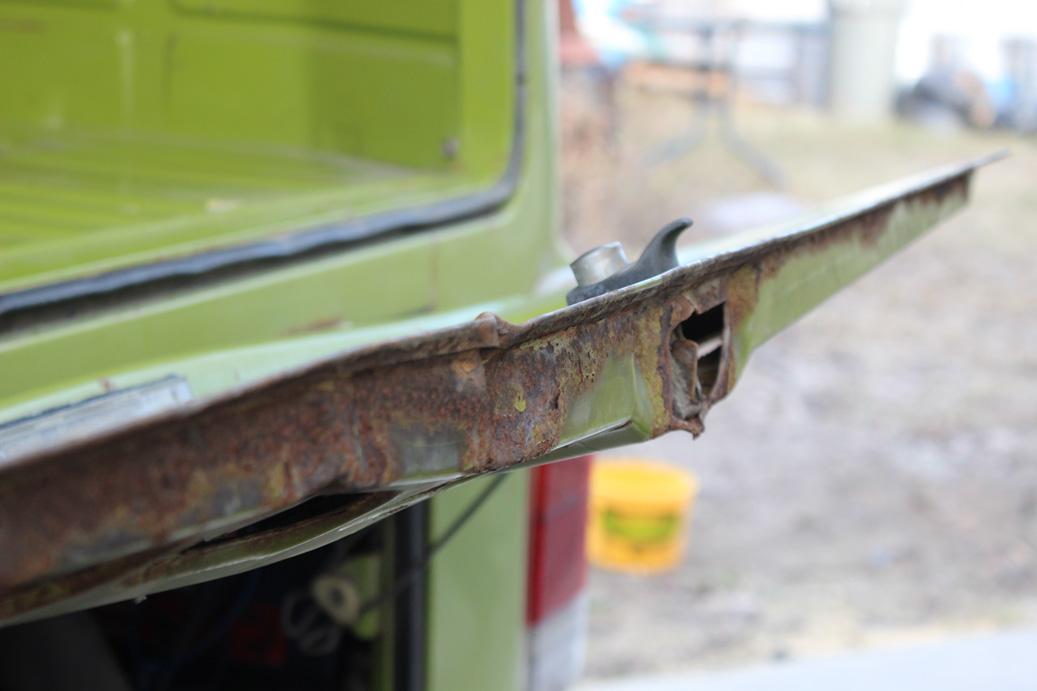

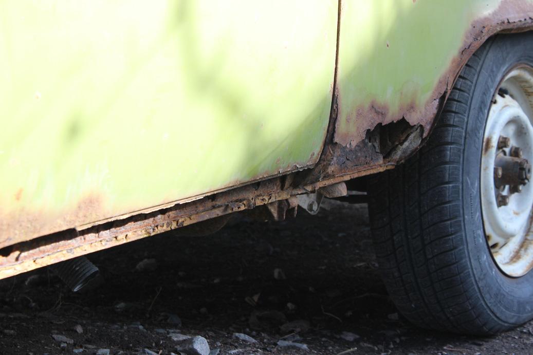

Very nice (other than the rust). You seem to have gotten practically every accessory with it! Anything inside that camping box between the front seats? Very Happy

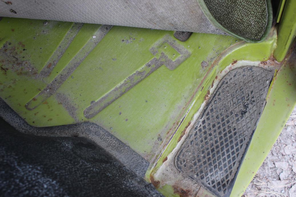

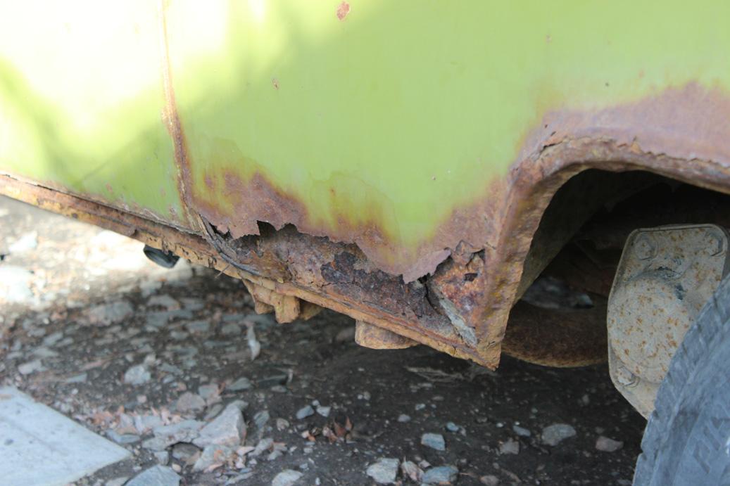

Rust Repair

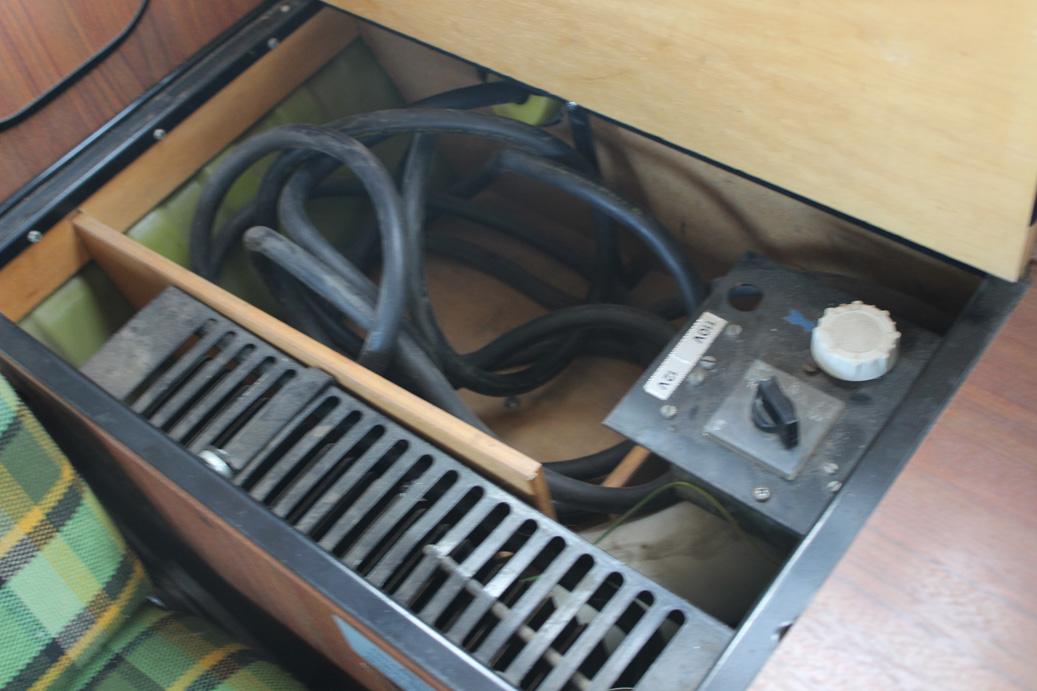

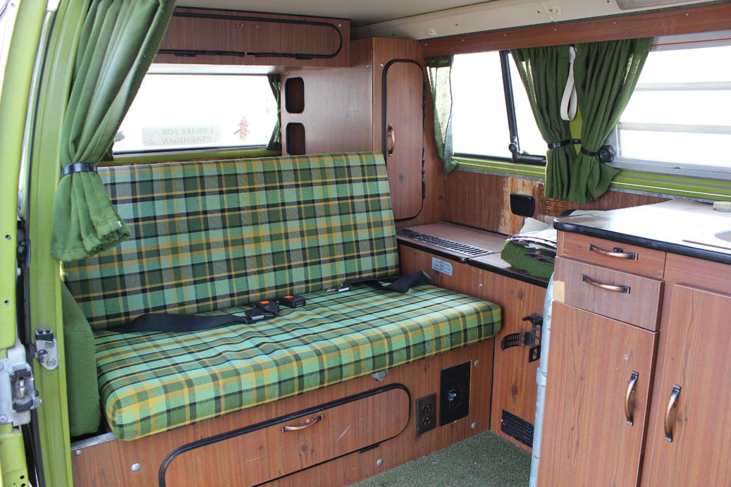

Is it just me or is it strange to have a refrigerator but no stove? I thought that if it was the "Green" Deluxe it would have both. Or is it a Canadian version? (Just noticed OP is in NT)

Bala - I need to add to that "things in my bus" thread. There was a bunch of cassettes and a couple of postcards in the stool/box. Top prizes were the fishing rod under the bench and the hatchet above the bench.
Thanks Tcash - I'm going to try CLR on the body. I've seen good results on other classics. And Yellowknife has a very dry climate and limited use of salt on roads, so rust is slow enough to manage once it's under control. The chassis and parts do need a good once-over with steel wool and undercoat. How I spent my summer...
kerian159 - My understanding is this bus is a "standard" Westfalia with an icebox, as opposed to a "deluxe" with a full fridge and stove. And yes, according to the m-plate, she originally came from New Brunswick.

Does the M-Plate list it as P22 or P27?

She's a P31: Westfalia SO 70/2 with pop top roof (1971-1979)
Amelia is also a P31, apparently, but she has a sunroof setup and was converted to a high-top in Montreal.
Is this a Canadian thing? Razz

Looks like a Canadian deluxe to me.
Table brackets on the dash as well as the table (nice score!).

PostPosted: Mon May 09, 2016 12:07 pm    Post subject: Re: Olivia: 1976 Pop-Top Camper Reply with quote
Rip the entire interior out, put it aside, bleach the entire inside. Replace the sub floor, carpet, clean any interior rust. Put everything back.
If you're lucky you may get away with a few mouse turds. Otherwise there's probably all sorts of funky mold under the sub floor and carpet..and all measures of dirt and gunk in every corner.
That's where I starred with both my buses. Reasoning is at least I could camp in a clean bus in my driveway, while I'm working on all the other stuff Smile
Even replacing the top canvas I found all types of rodent turds up there...gross stuff but par for an old bus.
Oh yea when the interior is out do all the window seals as you'll have unimpeded access to every window.
