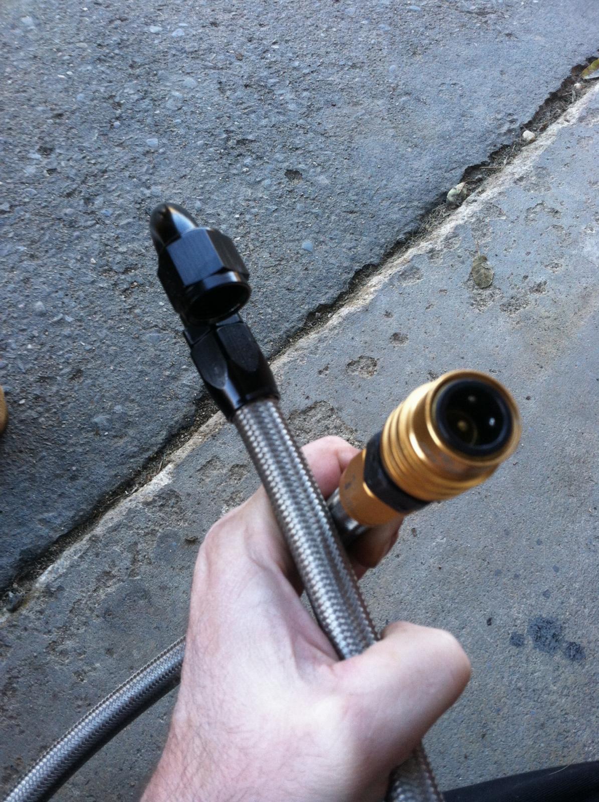

PostPosted: Tue Dec 15, 2015 3:00 pm    Post subject: Re: 60 Single Cab Build-Pics Reply with quote
Oil lines are ready to go. The gold fittings are quick disconnects. I made sure to offset the hose lengths so the in and outs can't be mixed up. Wether you are taking the engine out, removing the filter or just need to get the hoses out of the way they are handy. As soon as you unhook them, the flow is stopped and keeps from drizzling oil everywhere and keeps less air out of the system.

PostPosted: Tue Dec 15, 2015 8:19 pm    Post subject: Re: 60 Single Cab Build-Pics Reply with quote
That's a nice practical and professional-looking setup! Cool

Thanks! I had the hose and some of the fittings kicking around for a while from other projects I didn't finish. Years ago I saw the quick connect fittings for race cars and wondered why you don't see them on more of our full flow setups. Well, it's because they are pricey!! Buy when you look real close at the design you have to admit they are nice and shouldn't expect them to be $4 a piece.
