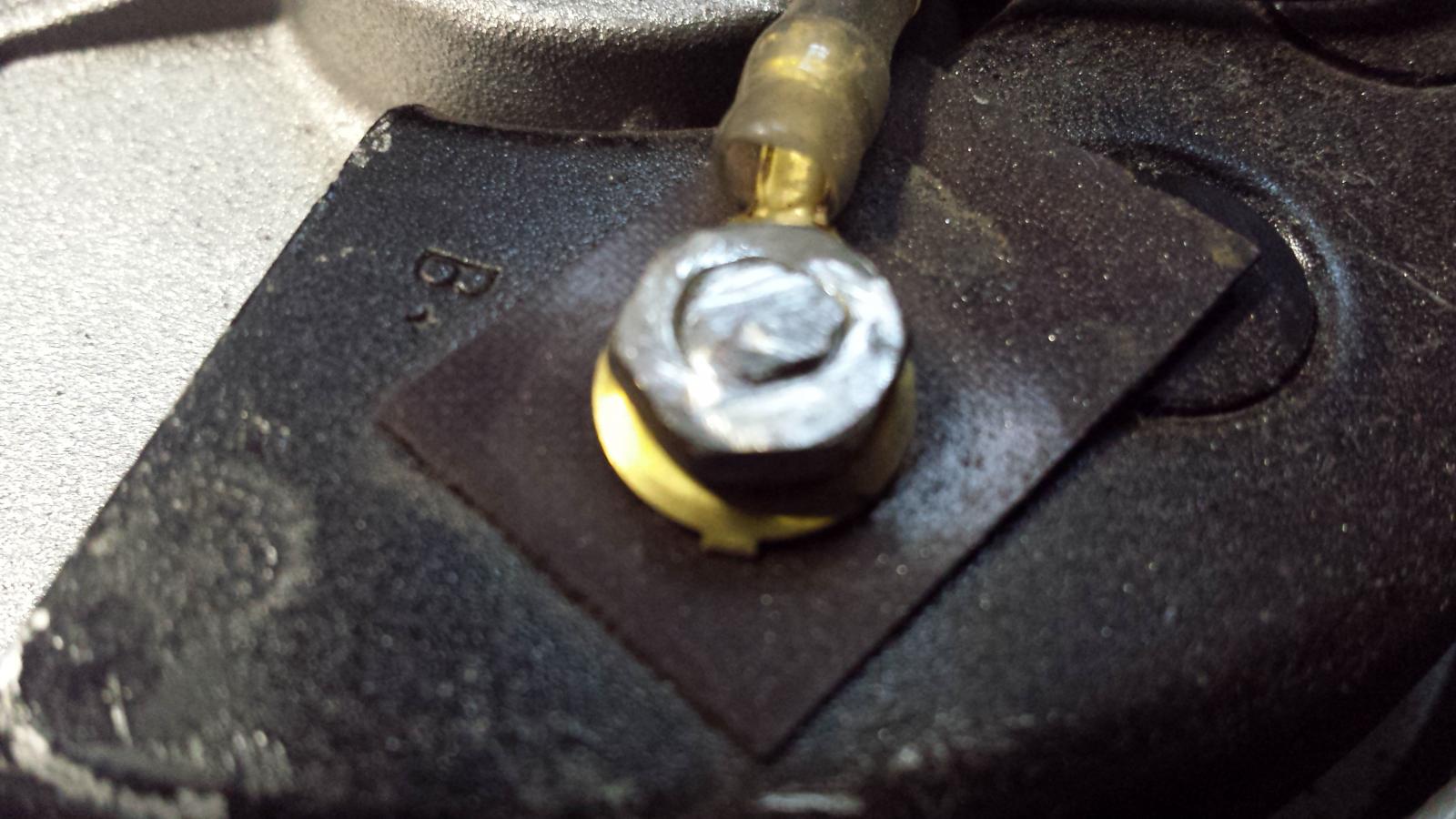

Well I just got the engine apart to inspect the alternator and sure enough the back cover shorted out on the wide washer… It wasn't even the long stud which I had trimmed… So whoever said wide washer, you win! Now I just need to figure out what I'm gonna do with this alternator…

PostPosted: Tue May 24, 2016 7:36 pm    Post subject: Re: $&@&$ Alternator Terminal :-( Reply with quote
Note: fiberglass rectangled shaped insulator pad under wire connection.

PostPosted: Wed May 25, 2016 12:11 am    Post subject: Re: $&@&$ Alternator Terminal :-( Reply with quote
Looks like I fixed it (knock on wood). I created a new wiring harness (the retro ones from BD are back ordered) and reinstalled the same alternator and regulator that were in there when the short occurred. Started it up and had 14V at idle like before. I couldn't take it for a drive as it was late but I'm hopeful. I removed the wide washers and created a double gasket between the alternator and cooling tin. Looking through the duct hole it looks like I have good clearance between the tin and terminals.
