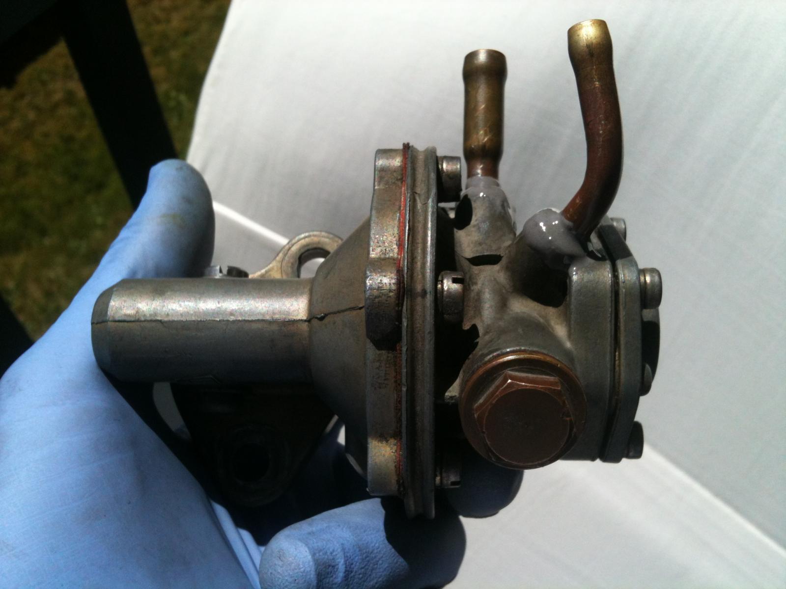

If mechanical it's possible the pump diaphragm has ruptured and is leaking into the case. Slim given the fuel pump has a drain tube to prevent this. But not entirely impossible if it's plugged.
Pump looks like...
