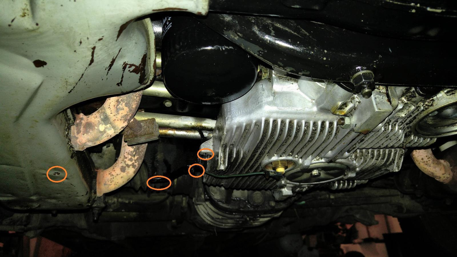

PostPosted: Wed Oct 12, 2016 7:55 am    Post subject: Re: Trouble finding a place that sells cooling tins Reply with quote
Here's an old pic from under the bus...dont mind the old oil leaks, those have been taken care of!
The oranges circles show where my cooling tin would mount.

PostPosted: Wed Oct 12, 2016 8:08 am    Post subject: Re: Trouble finding a place that sells cooling tins Reply with quote
You need the 72-74 style, like the ones in the first link. The ones with the valley in the middle won't work.

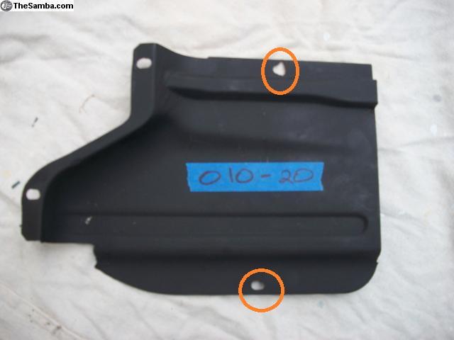

PostPosted: Wed Oct 12, 2016 8:25 am    Post subject: Re: Trouble finding a place that sells cooling tins Reply with quote
So this one?

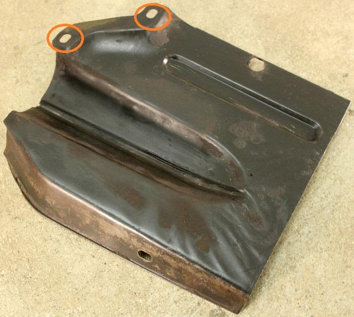

PostPosted: Wed Oct 12, 2016 8:41 am    Post subject: Re: Trouble finding a place that sells cooling tins Reply with quote
I swear my current setup looks like I need this one for two holes
and this one for two holes because they are a little closer together

PostPosted: Wed Oct 12, 2016 9:43 am    Post subject: Re: Trouble finding a place that sells cooling tins Reply with quote
Partially correct, whoever swapped the early exhaust on there left the late forward tin in place, you'll need those as well.
That one VWEd posted will work but you'll still need the early forward curved plates.

PostPosted: Wed Oct 12, 2016 12:12 pm    Post subject: Re: Trouble finding a place that sells cooling tins Reply with quote
Ok thanks, so these wouldn't work right?

PostPosted: Fri Nov 04, 2016 2:17 pm    Post subject: Re: Trouble finding a place that sells cooling tins Reply with quote
Alright, found my tins. Ended up having to install an older model forward tin that connects to my bottom sled piece, as suggested..
77 bus with 72-74 lower tins. go figure! Thanks for all the help fellas
