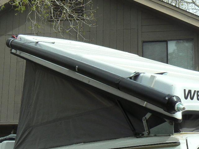

This was a failed attempt at a simple solar shower.
It sucked so I removed the details on it. It doesn't get hot, it is inconvenient to use, it looks stupid, and now I have 2 new holes in my poptop to show for my trouble.

Spring and plunger inside so its pressurized? It would need to be a really long spring with a low spring rate such that hose pressure could compress it or even simpler some surgical tubing inside the tube? I'm inspired to try one myself. What a luxury after being in the ocean!

nice work Dave. I may add that to my van. my Zodi's pump went kaput on our last trip. what about adding a Schrader valve,and putting a couple of lbs of pressure behind it?

Ya I would be thinking about that as well, the problem is you would need a fairly large accumulator on the pneumatic side. I was thinking about a small tube running along side the upper that was tied at the top solely for the purpose of providing pneumatic pressure on the larger tube.
The problem is that even if you had another tube up there the same diameter to provide pressure, by the time your water is half gone your pressure has dropped in half.
It would be better really just to have an electric pump and sink style hose sprayer like some other people have used, coupled to this solar heater.

I also love the simplicity. A hunk of styrofoam cut with a hole saw the exact diameter of the pipe with a hole drill out to pull the surgical tubing through and knot it. The buoyancy force would help a lot I think keeping the plunger where you want it above the fluid being pulled by the outstretched tubing. This would be an easy add Smile. Poor mans hydraulics! Hose pressure through a simple ball and socket valve could easily stretch pretty stout tubing and the valve would allow hose removal without water loss.

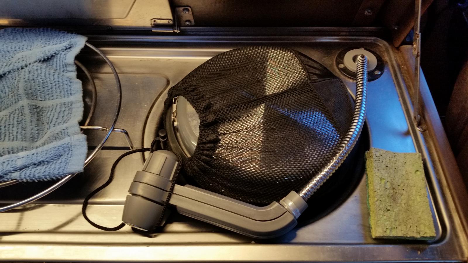

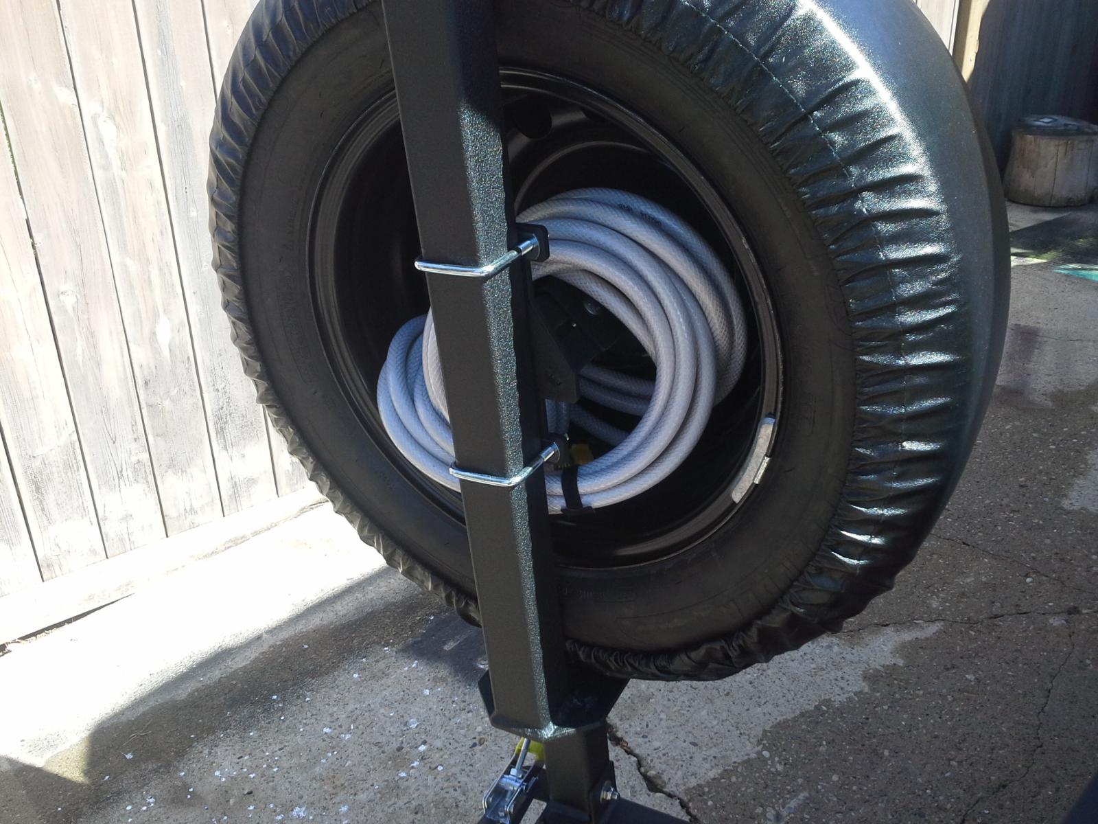

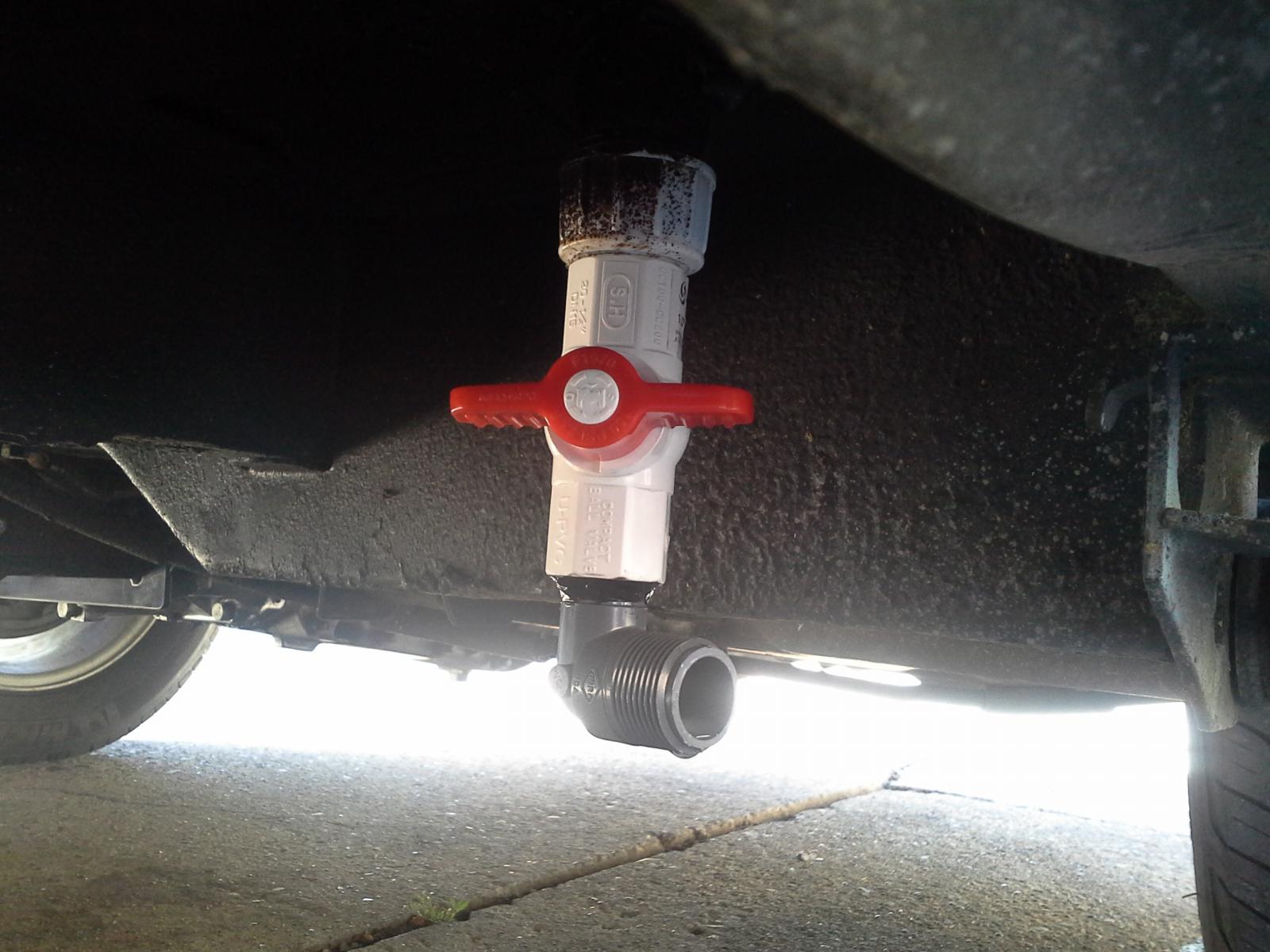

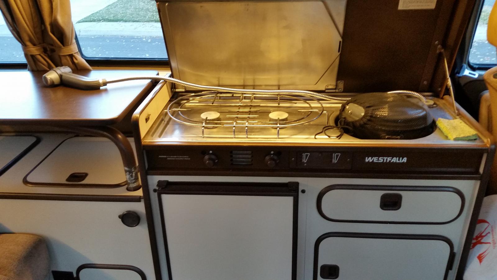

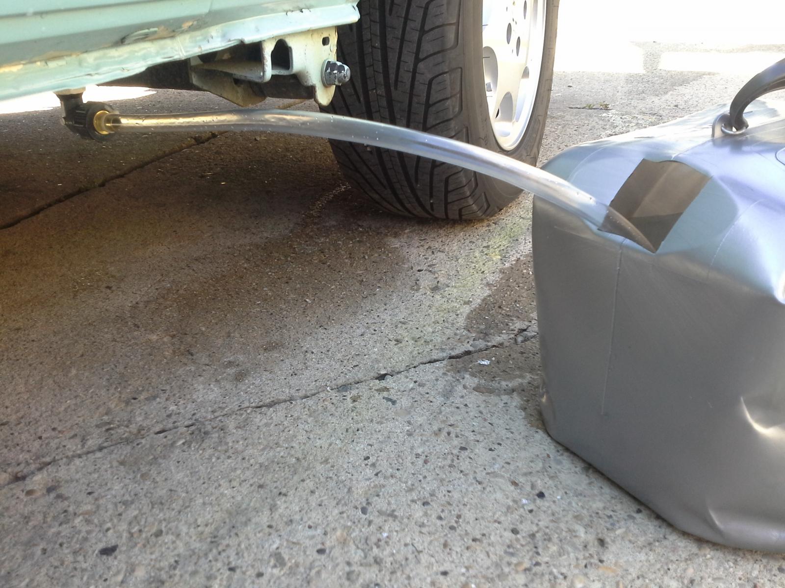

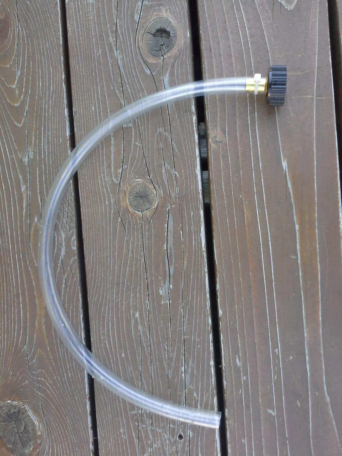

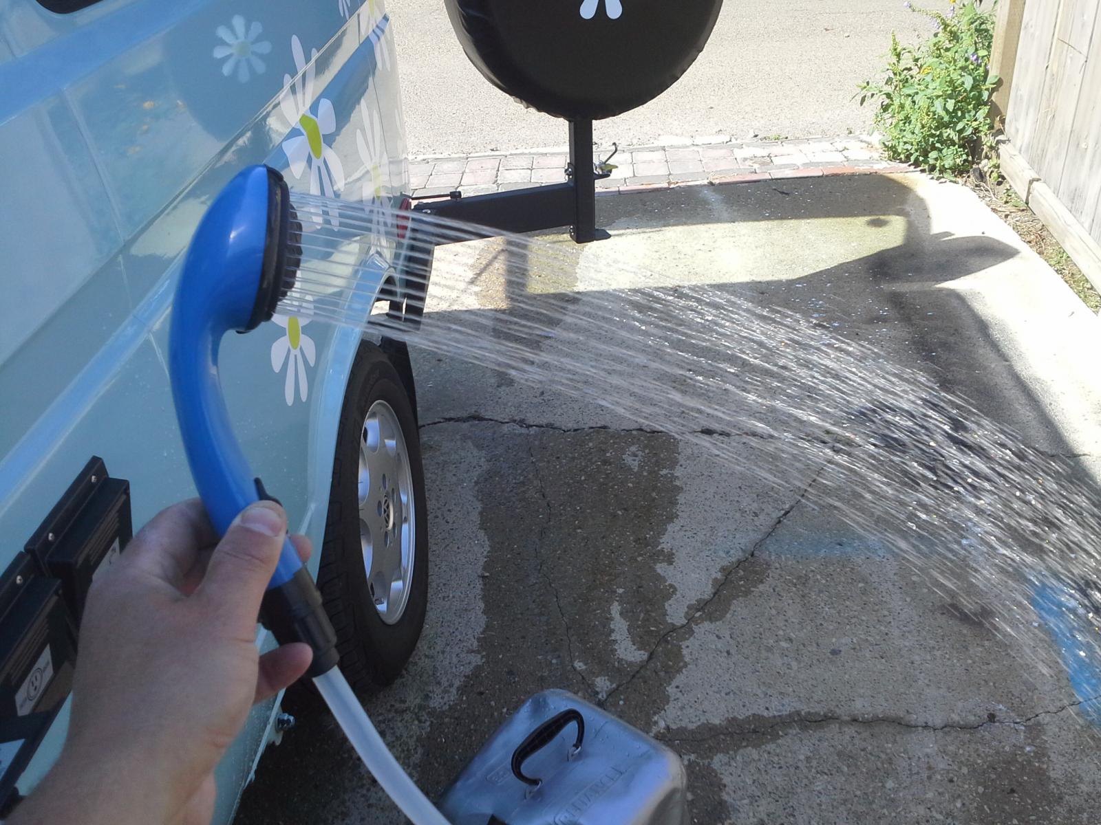

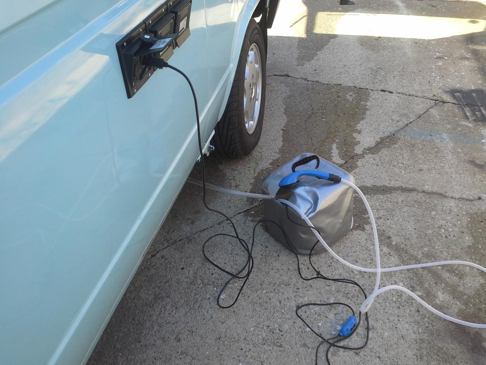

Not sure if this is of interest, but here is what I use.
Modified the fresh water tank to allow it to be used to fill the shower bucket. Avoids hauling water to the campsite, and can have longer showers. Can fill the shower bag with a short fill hose or the water hose used to fill the tank...which is stored in the spare tire. Current shower bag is an old grey water bag. Have ordered a 40L / 10G solar bag to allow for warmish showers
Changed the city water hook up to a solar plug in and 12 volt plug...provides power to the camp shower. Also allows the ability to move to a more private place to shower...will reach the back of the van too.
In my perfect world I figure out a way to build a new water tank that is insulated and can be heated via the engine...but thats a bucket list item
[/img]
