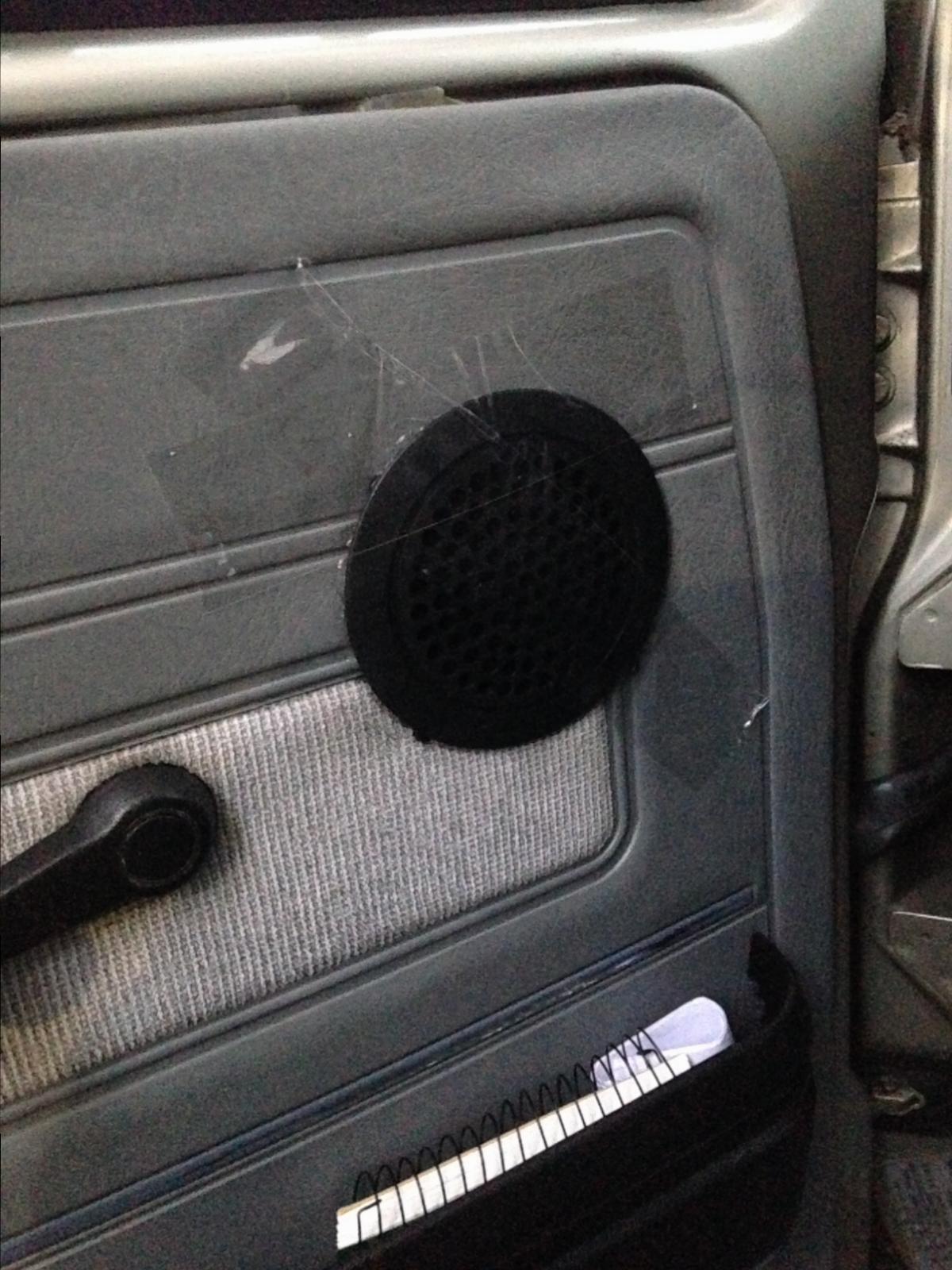

I then replaced all incandescent interior bulbs with LEDs and wired a new Blaupunkt radio with the toggle switch on my own. Pretty proud of myself!

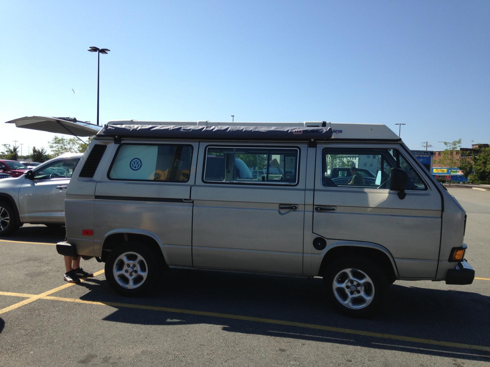

We decided to go with a Subaru engine since we love our Impreza and contacted Hans at Vanaru. The van was delivered to him in Florida at the end of January (in the middle of a snow storm). In February our garage nearly collapsed so we had to rebuilt it (more tapping into our home equity line of credit Crying or Very sad ) We told Hans to take his time. That he did (which was perfectly fine with us since it gave us time to save for the engine and work on the garage).

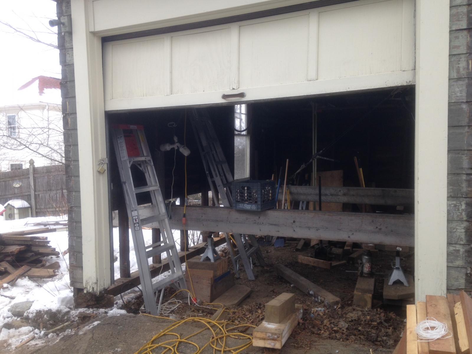

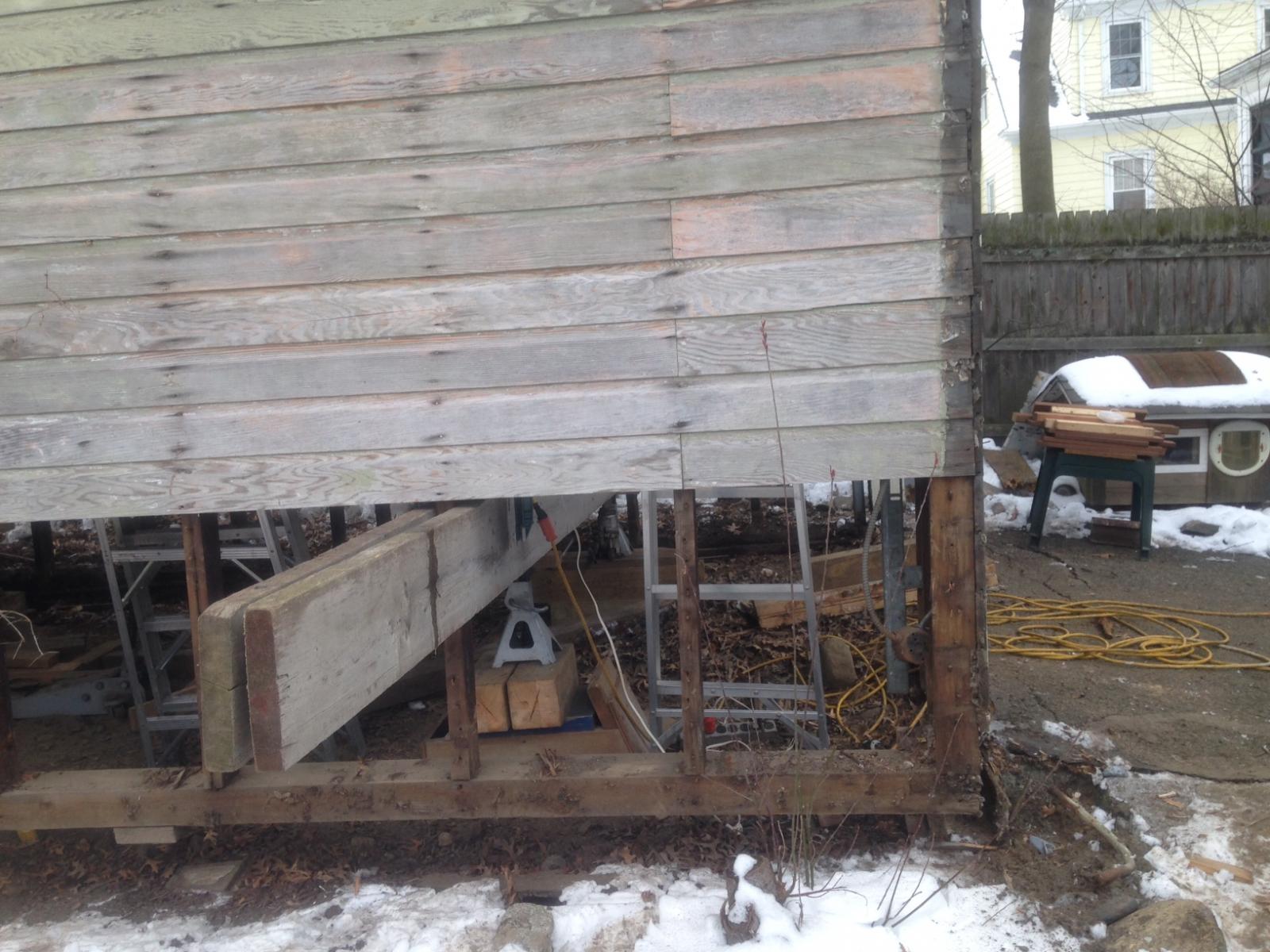

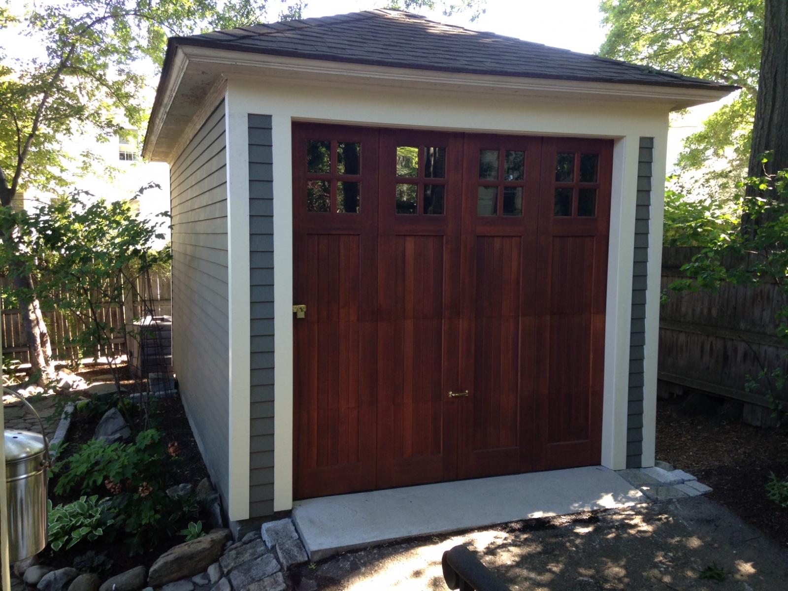

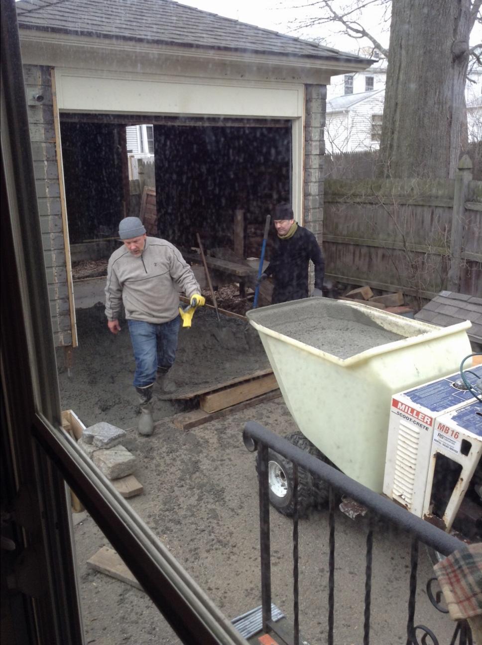

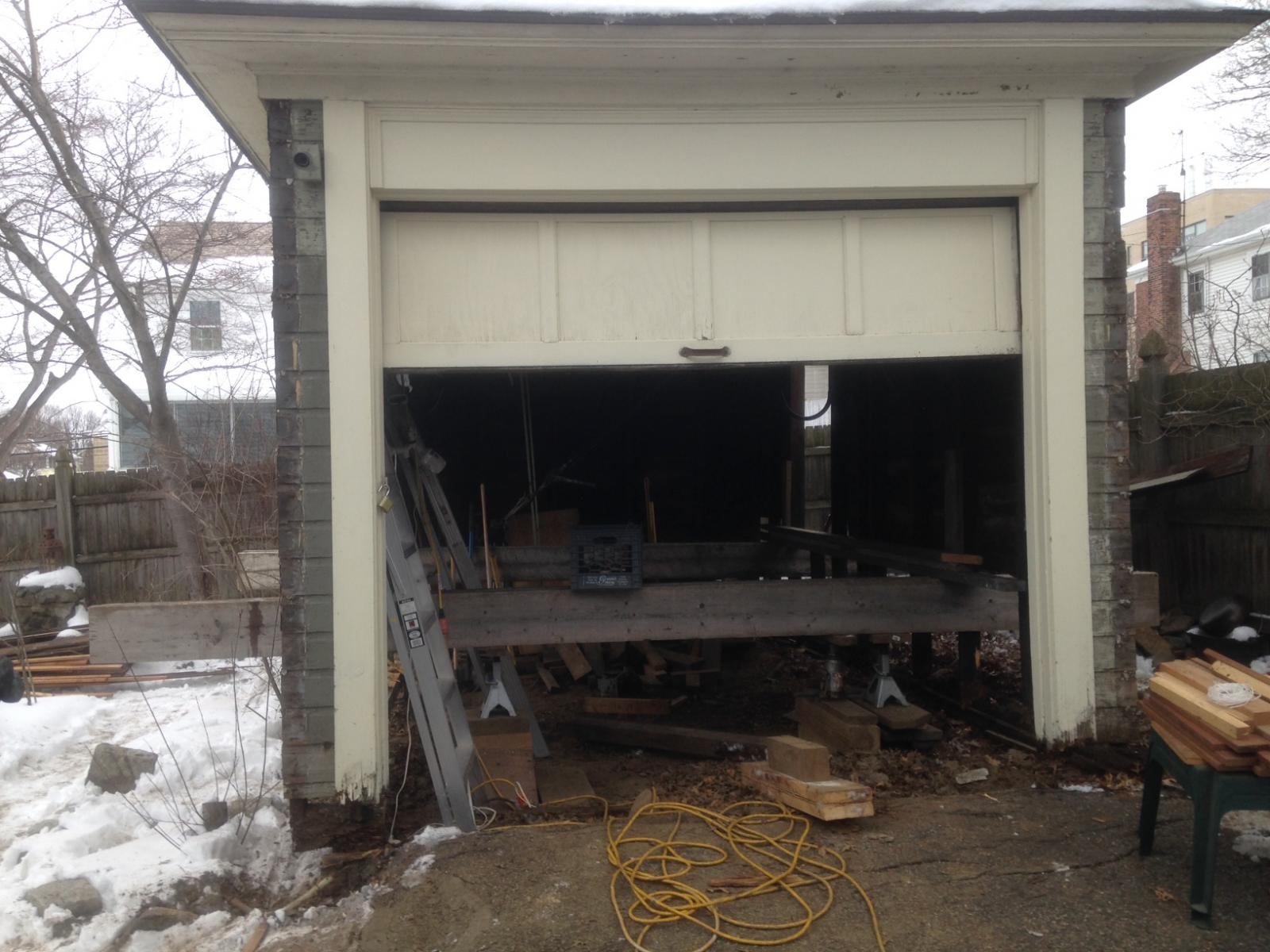

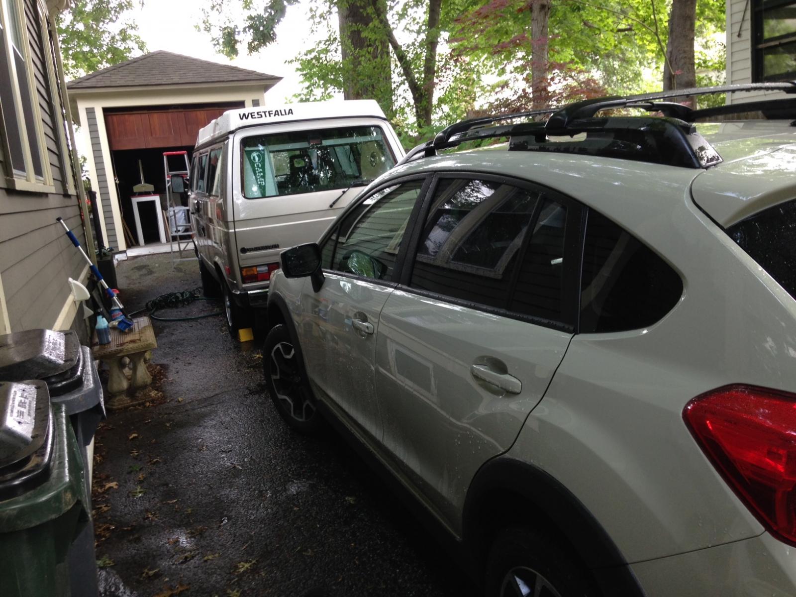

It was a blessing in disguise since our garage could not really fit the Westy. When we fixed it (removed rotted wooden floor and base) we laid a cement floor, raised the wooden structure and purchased a solid 8' x 8' cedar door Cool
The garage was finished more of less in April (some of the trim needs paint) and the van was still in Florida. We finally got the van in July and picked it up in Virginia where Hans decided to do the conversion. It worked out well since the guys at Complete Auto Repair in Staunton were able to do some more work beyond the engine (like a new A/C system, reglaze the square headlights and new LEDS in instrument cluster).

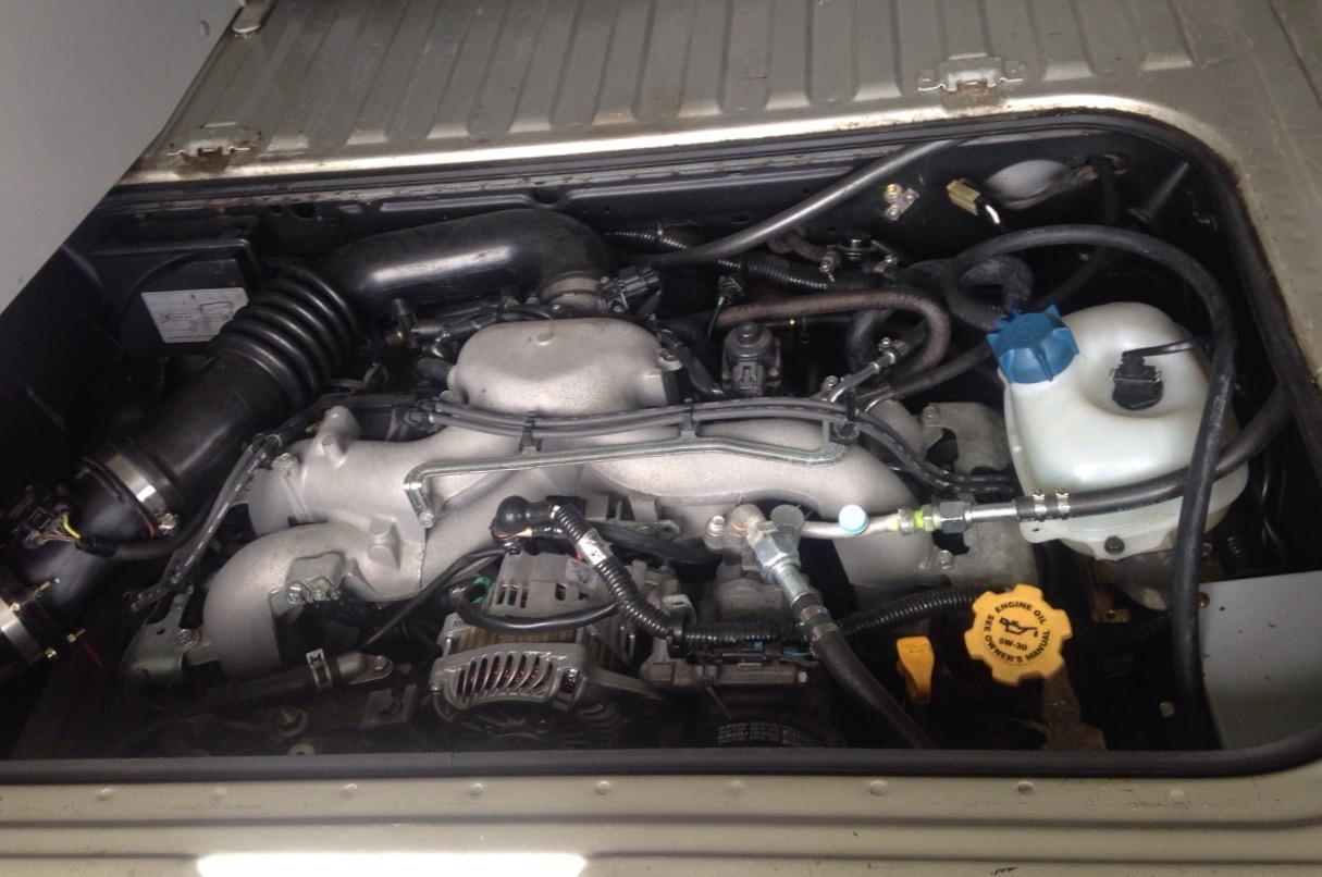

Here is the 2011 Subaru Impreza engine (38K miles with power steering pump). We also had our transmission rebuilt by AA Transaxle and got a new clutch.

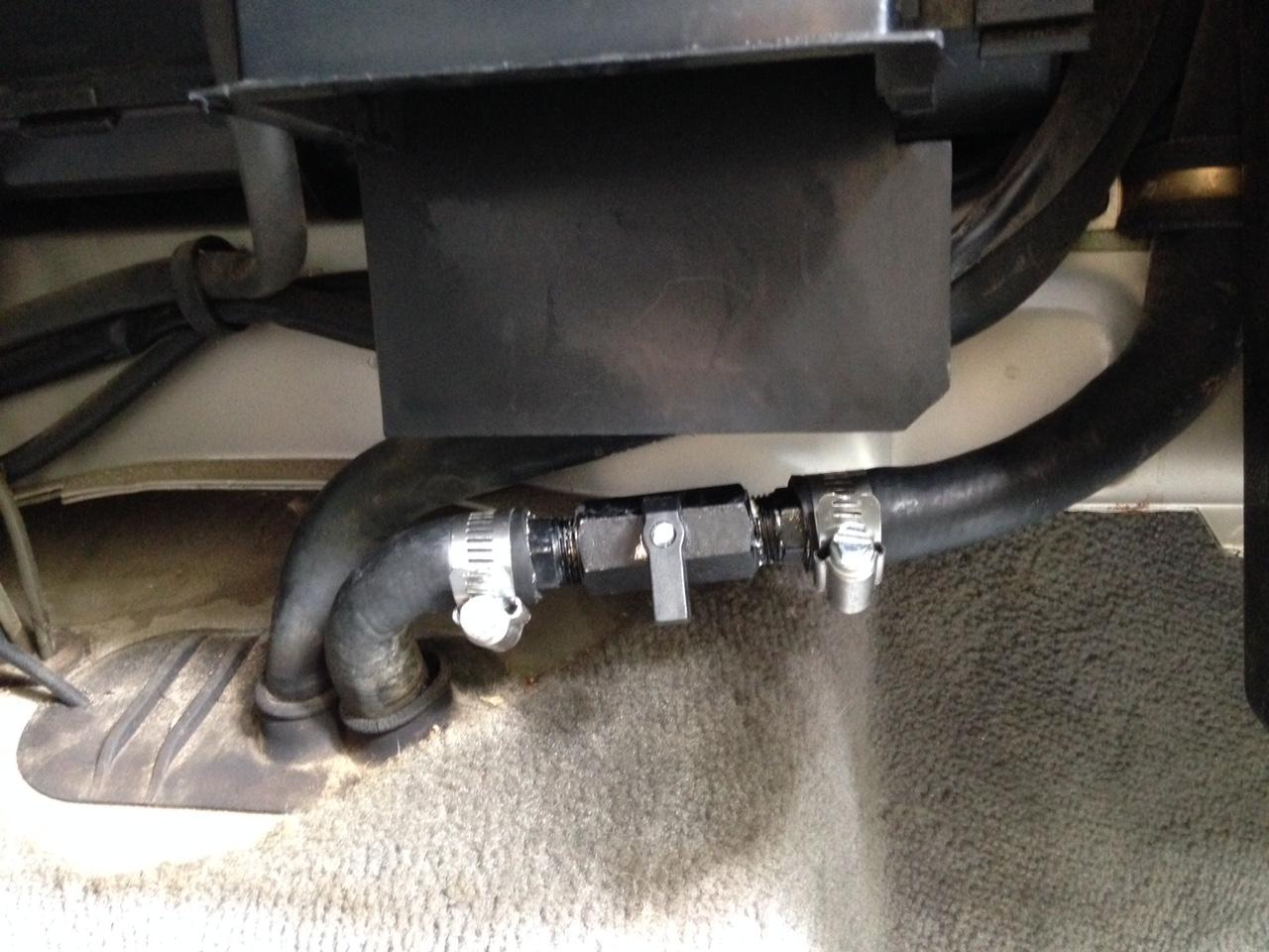

Driving back from Virginia to Rhode Island (12 hours) we realized that we had to fix the hot air blowing from the front footwell vents. I bought a shut off valve from Terry Kay and had it installed in 15 minutes the following weekend. One of the best mods to date aside from the engine conversion! Removing the console took me almost an hour though! Rolling Eyes
The valve is off in the summer and will be on once it gets cold out. You can read more about the Vanagon hot foot syndrome in this thread, it's a common problem:

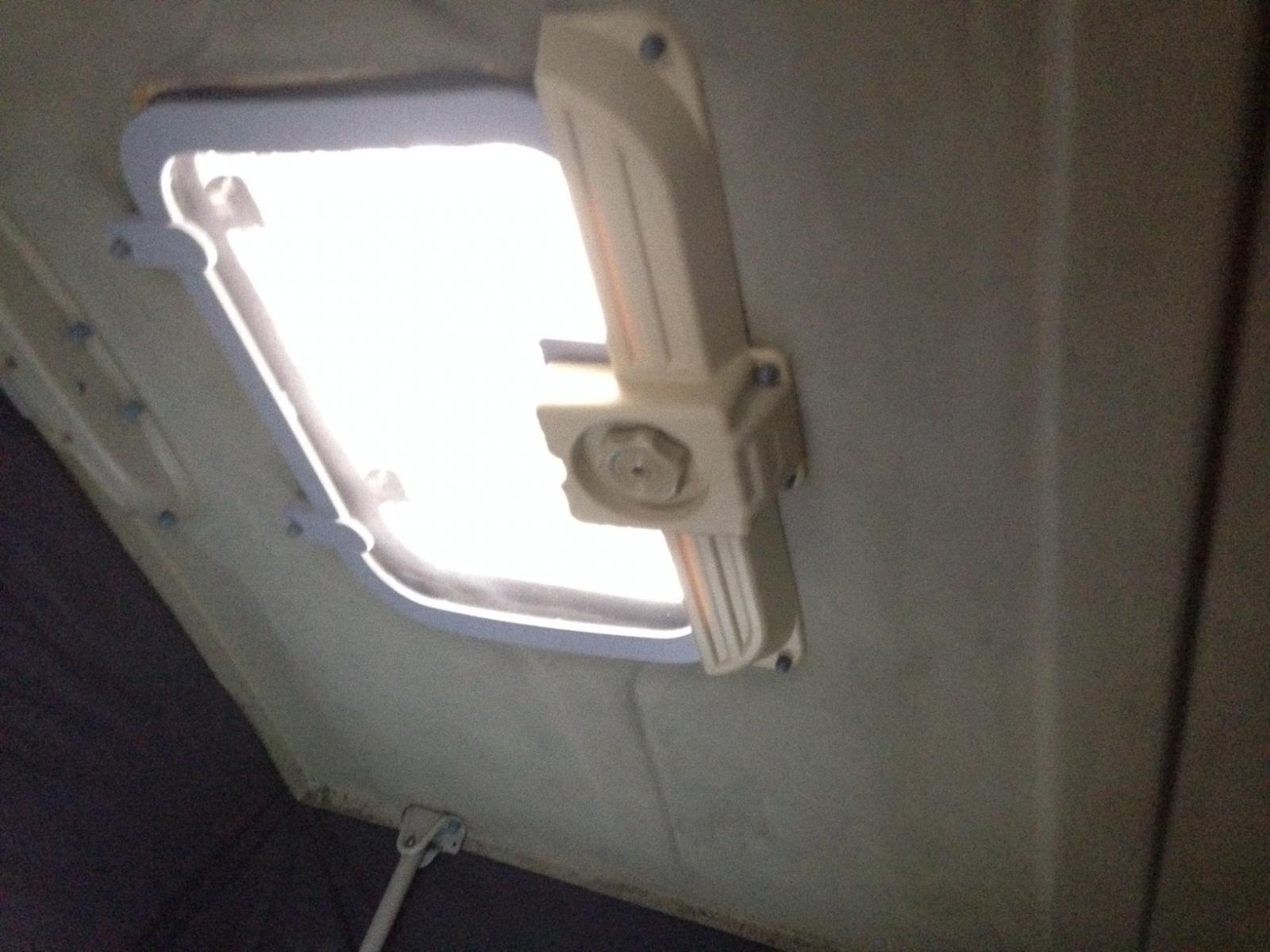

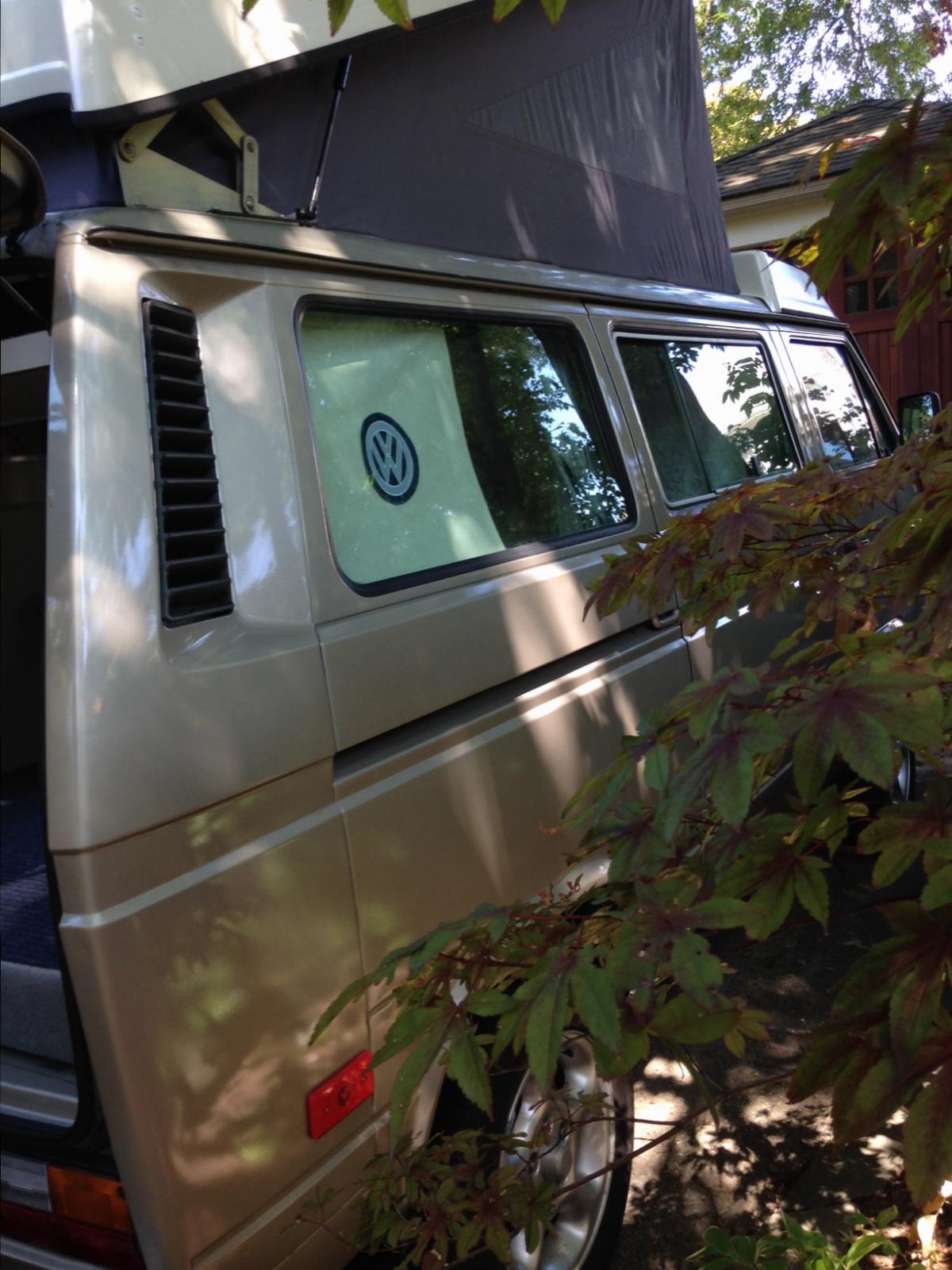

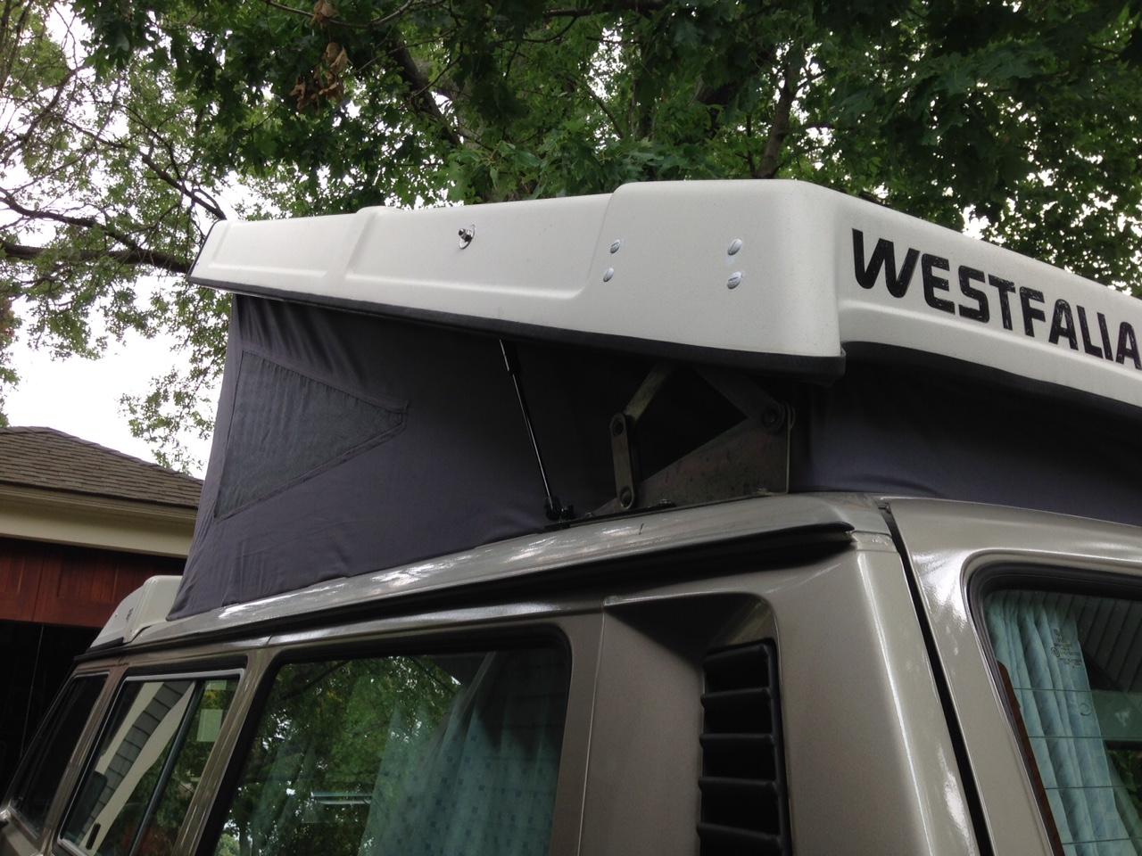

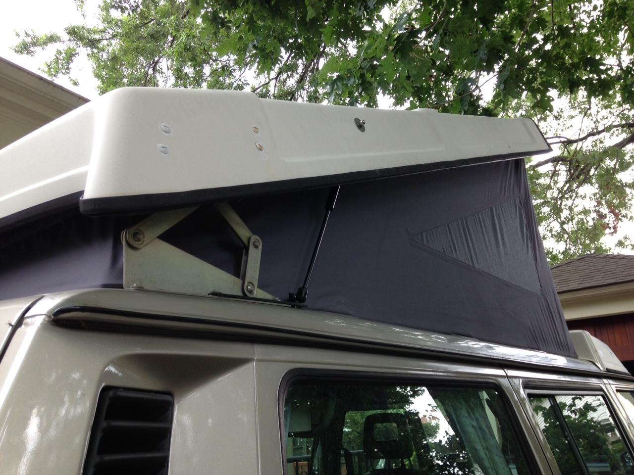

The following weekend I installed Jack Bombay's standard pop top struts. Another amazing mod. Took no time. I love it. I can now open the pop top by myself. Cool

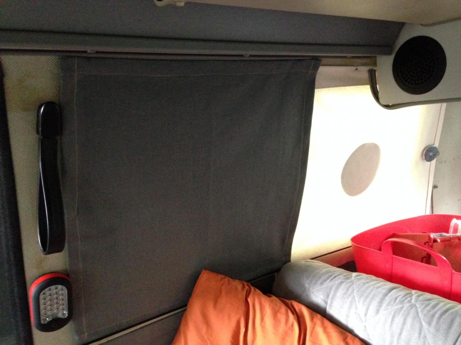

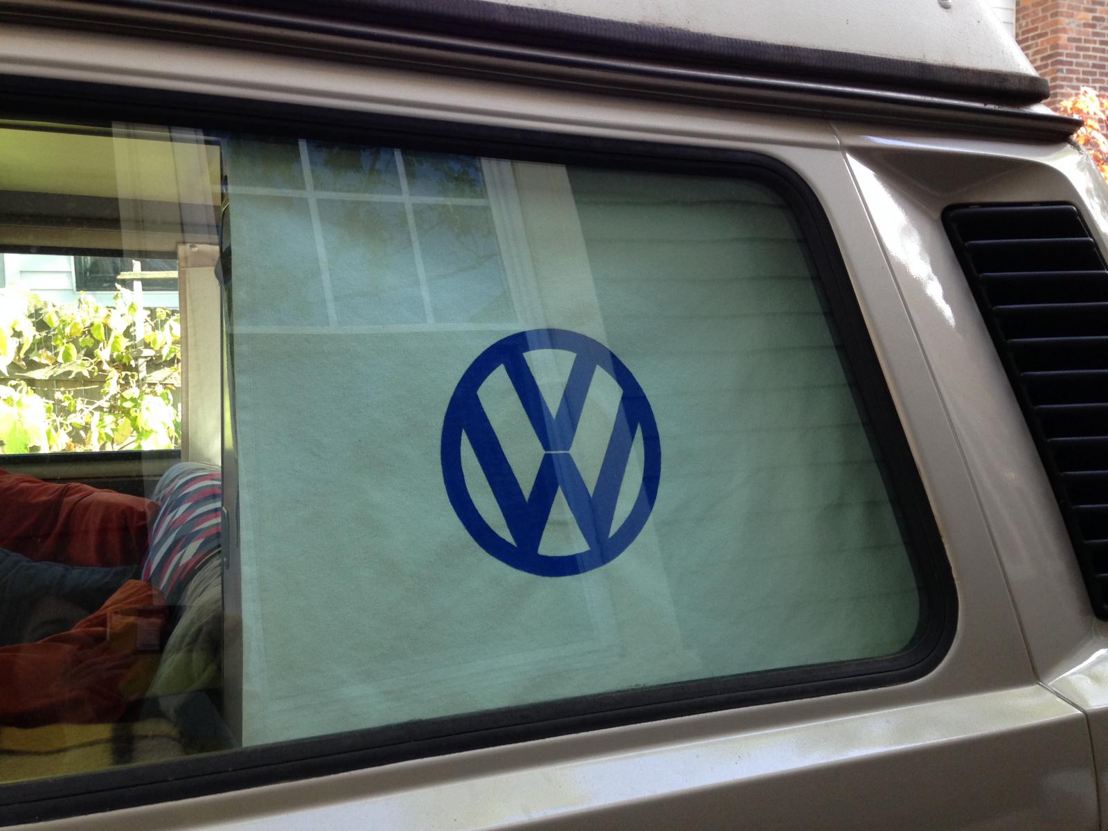

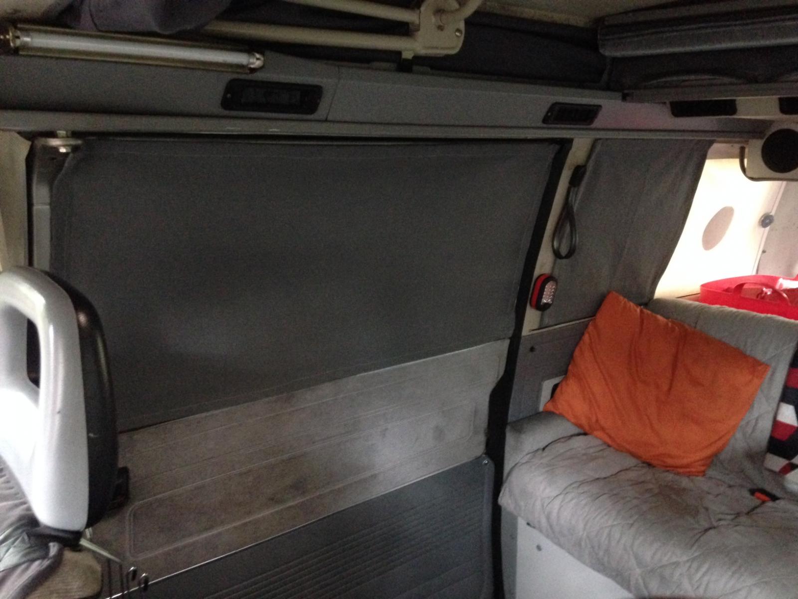

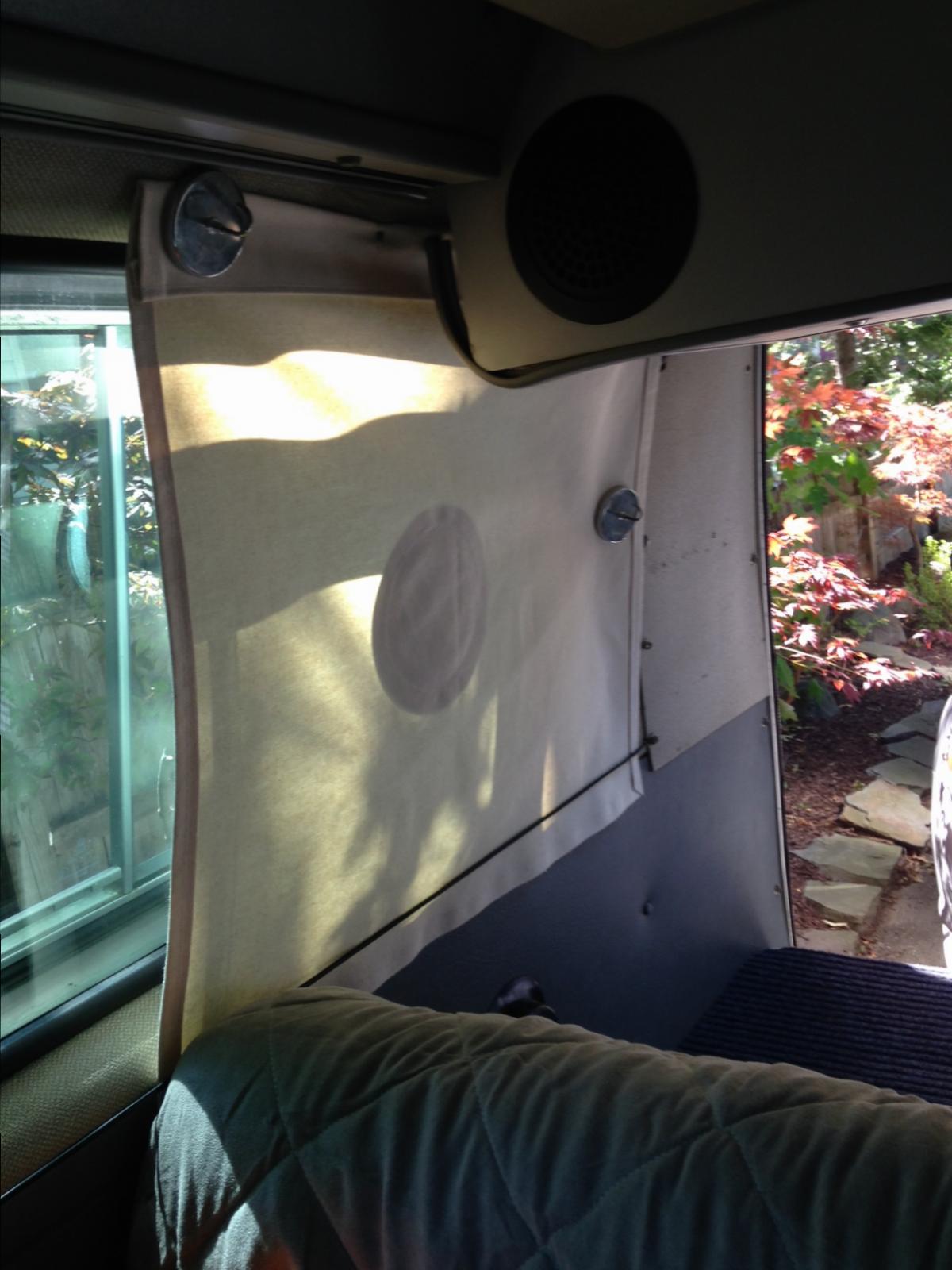

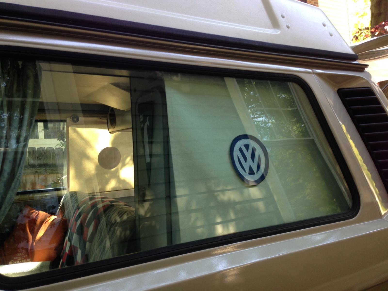

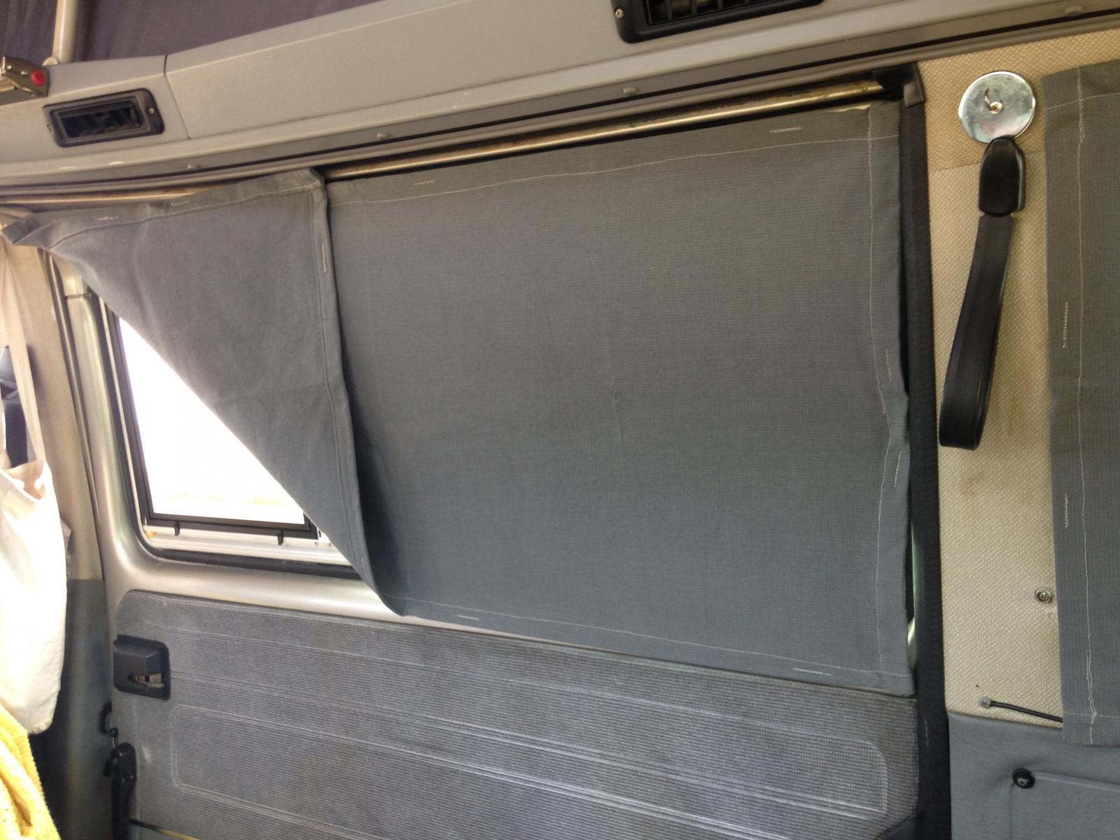

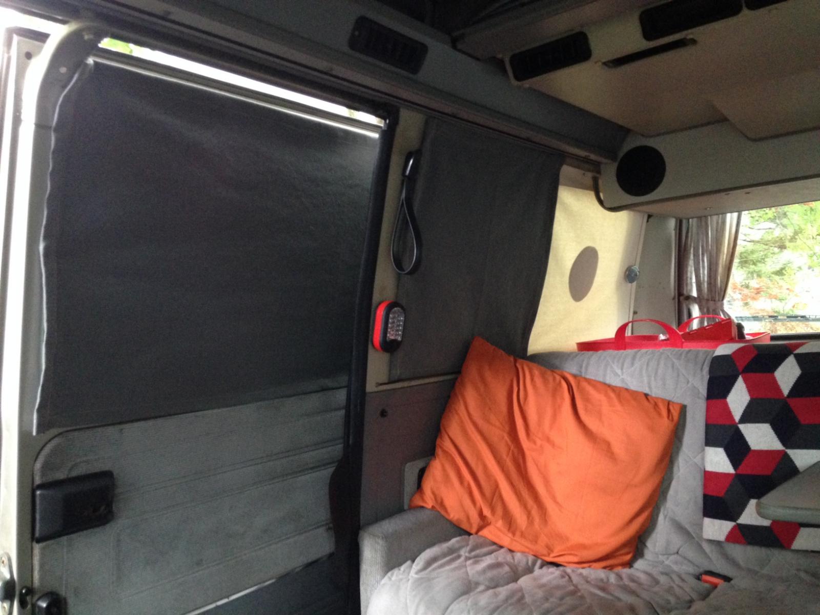

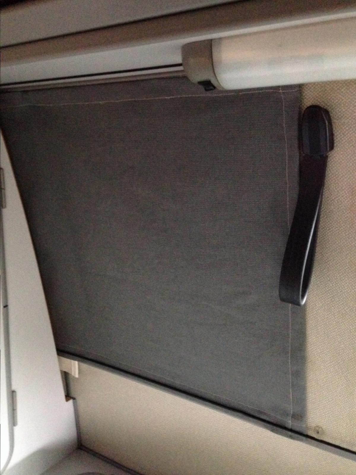

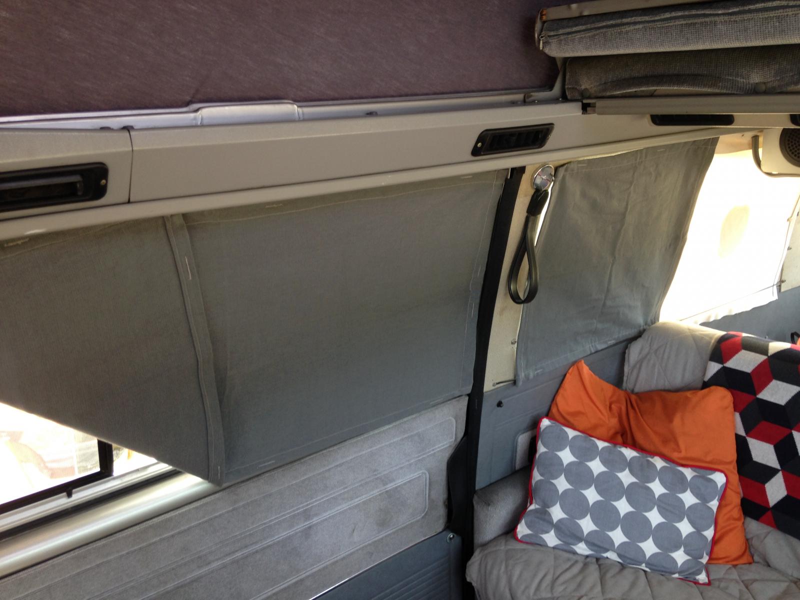

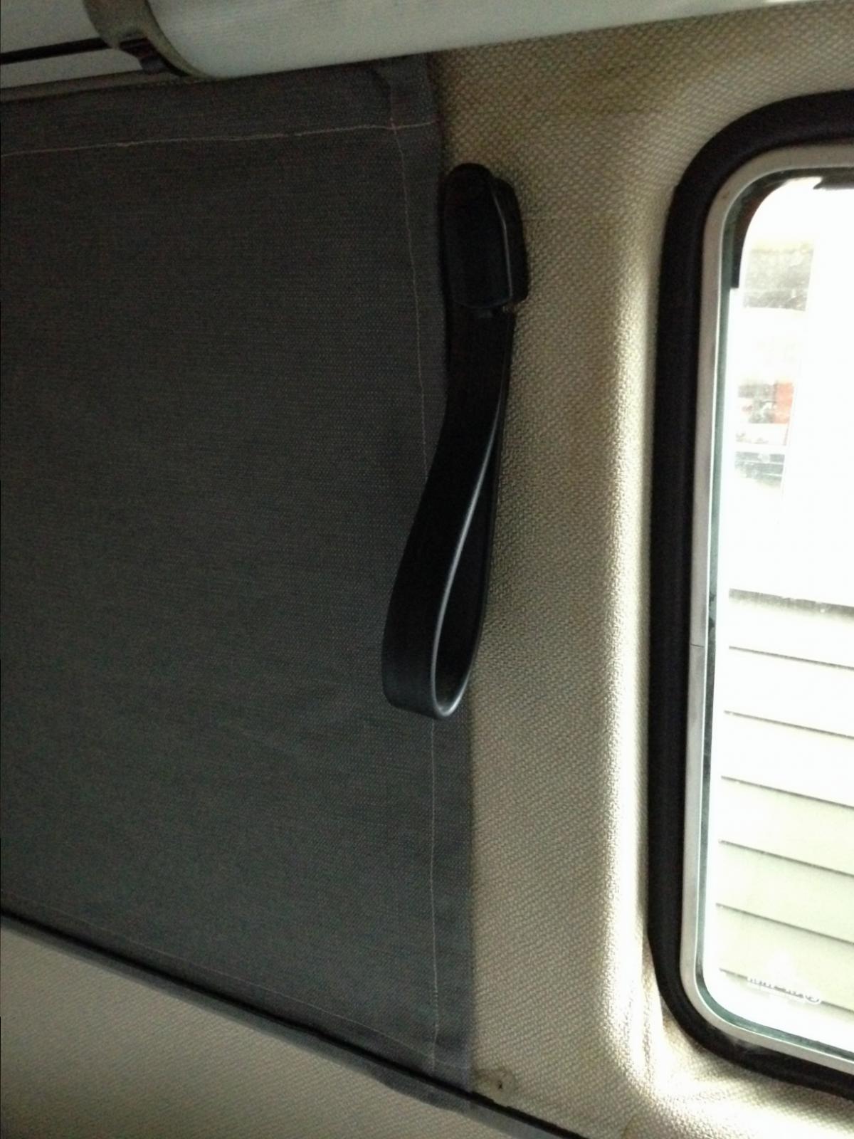

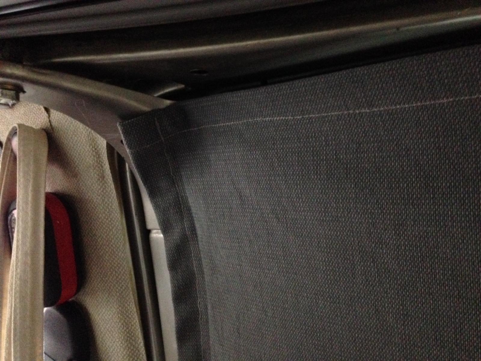

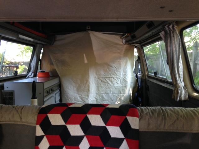

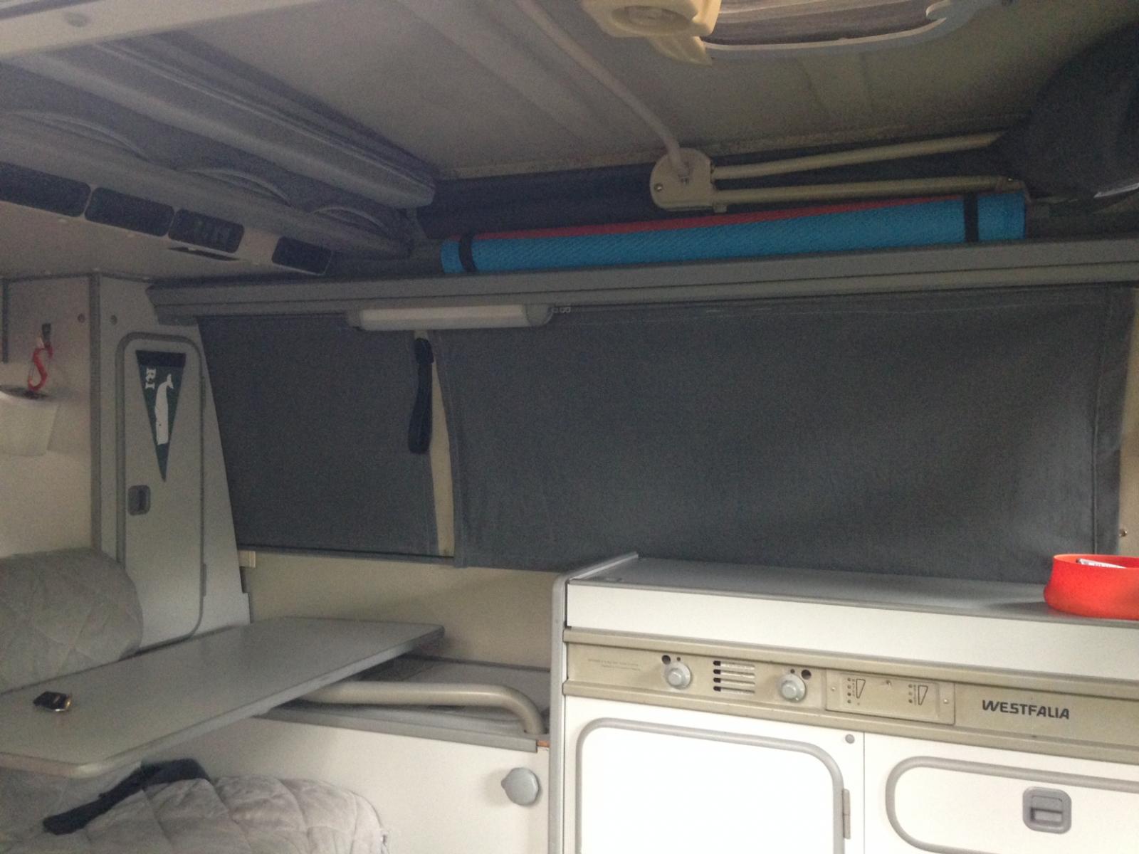

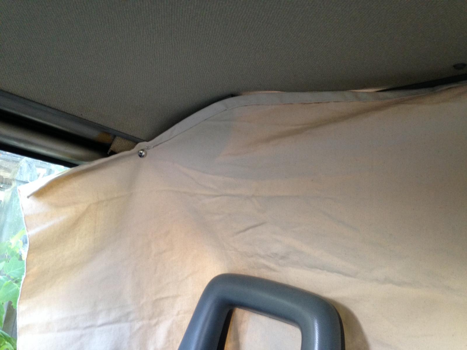

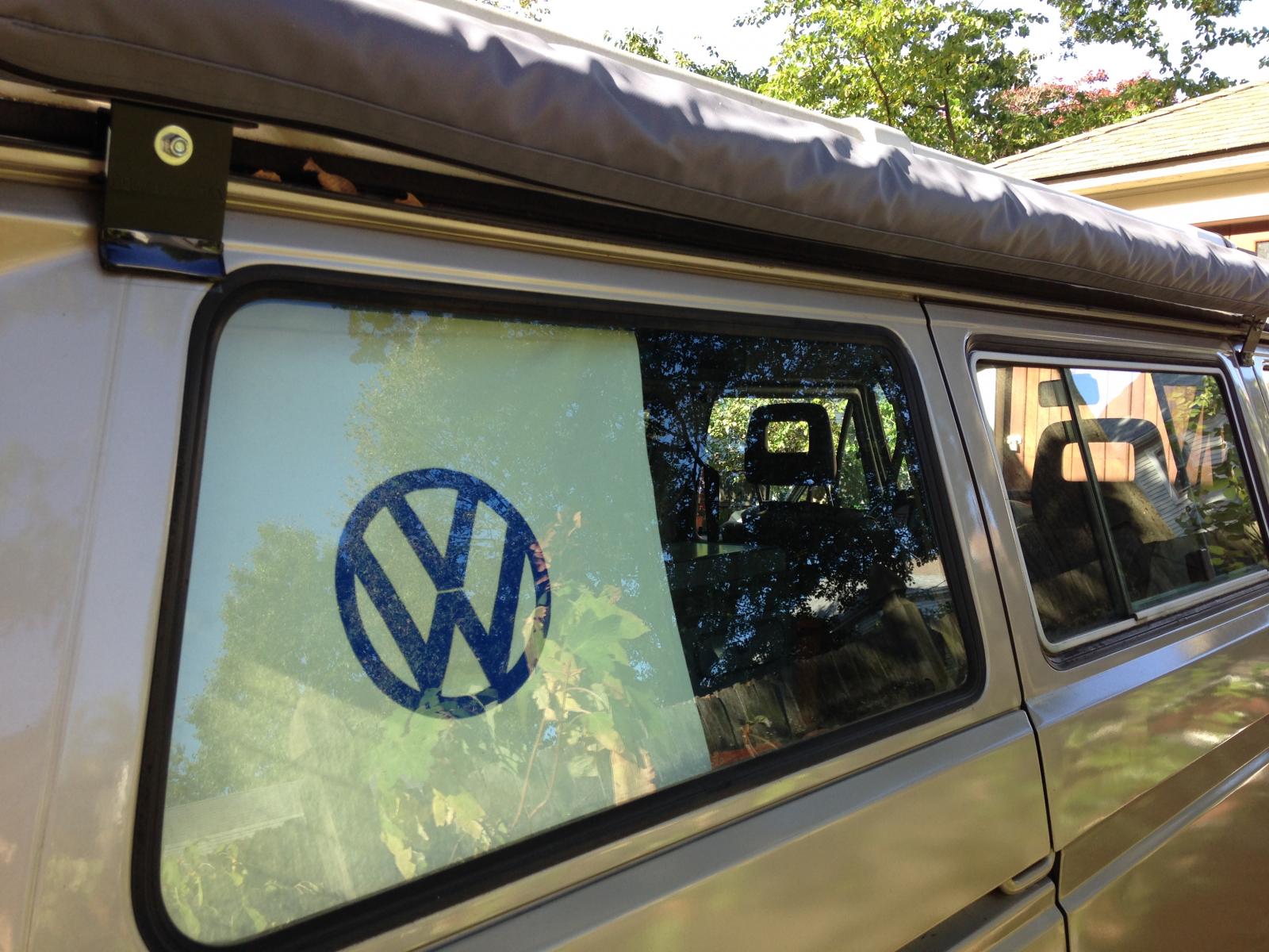

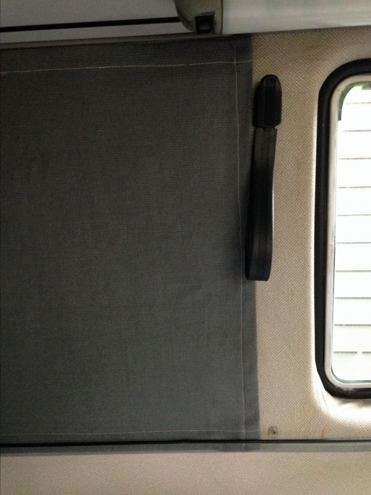

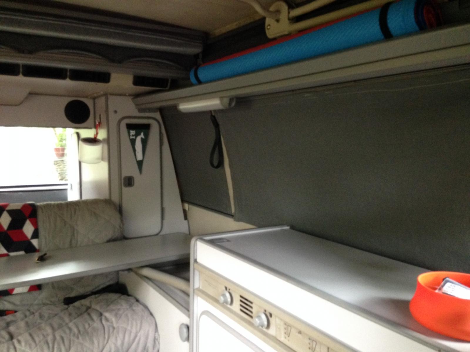

Today I installed the new back side curtains/panels I made for the van (I had to use those VW patches somehow!). They are permanent, in other words, I don't plan on moving them back to allow more light in the passenger side. I used the original hardware and added a couple of magnets for the passenger ones (I will get smaller rare earth magnets later, these are just temporary).

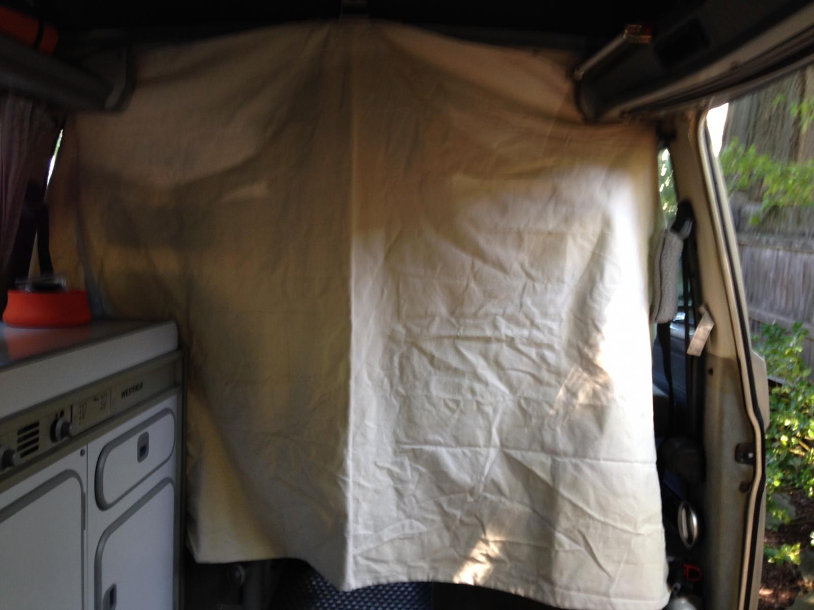

I also finished my new privacy screen made of the same canvas material and using the original snaps provided for the large front curtain. I only had to punch a couple of new female snaps on the canvas. The middle part gets hooked on the pop top latch.

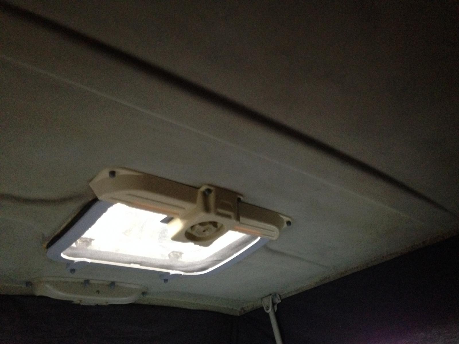

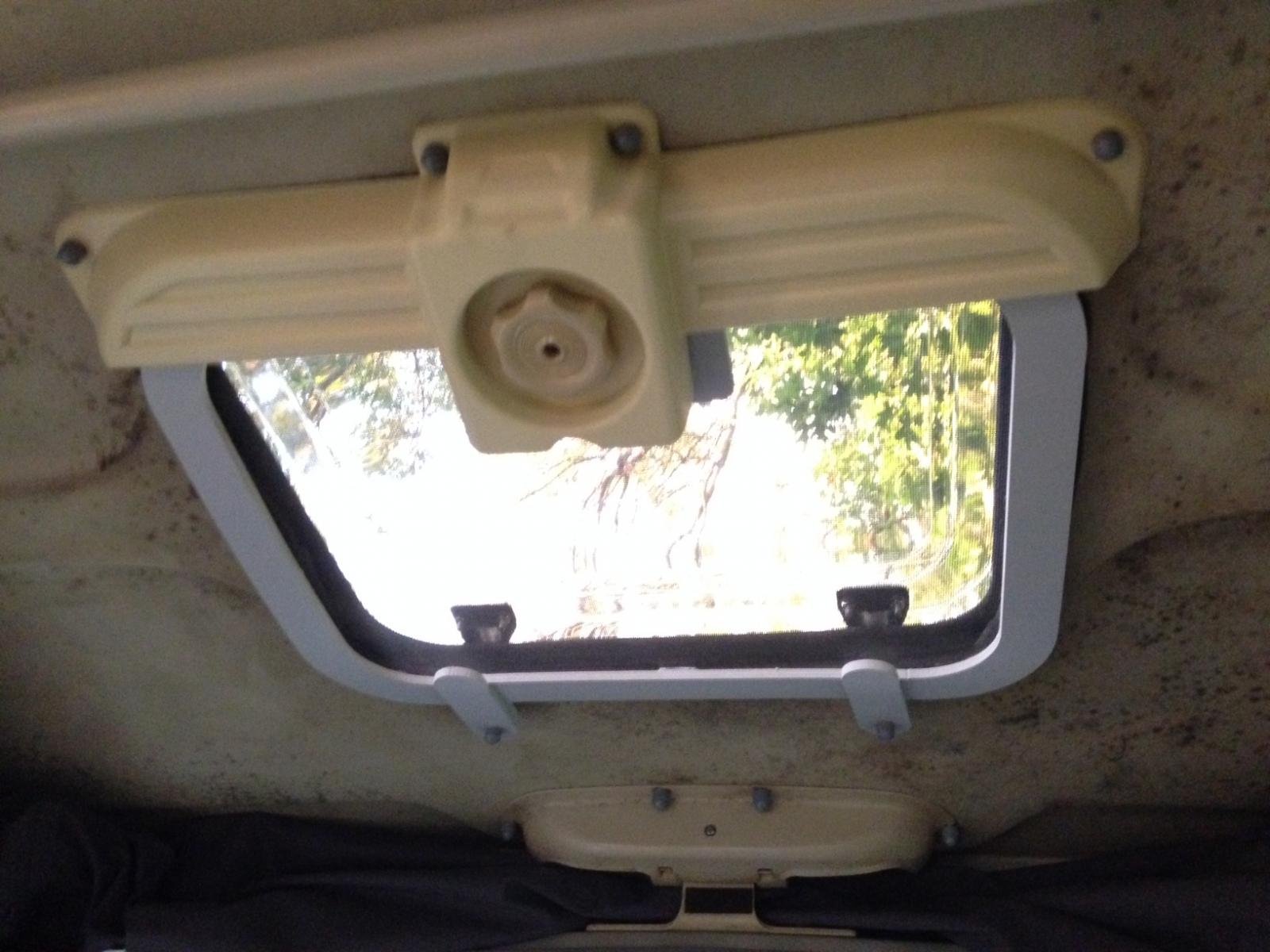

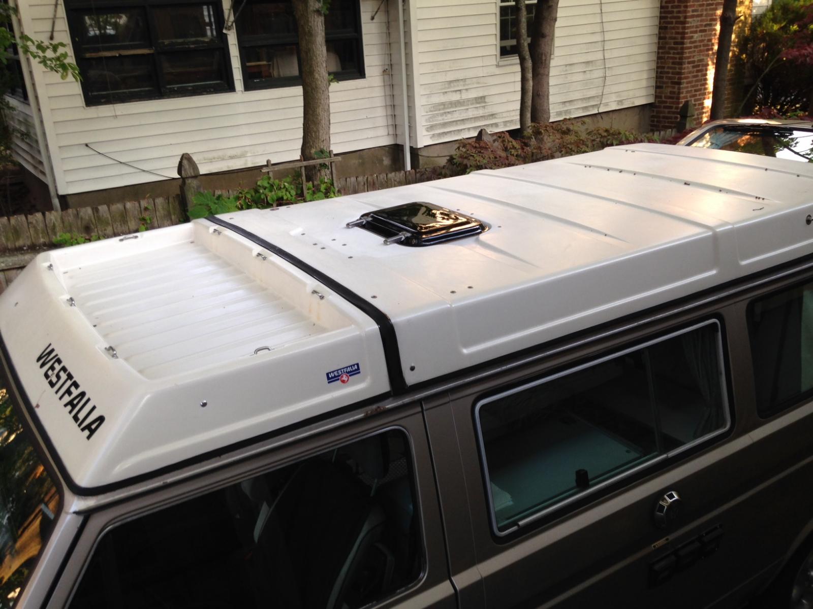

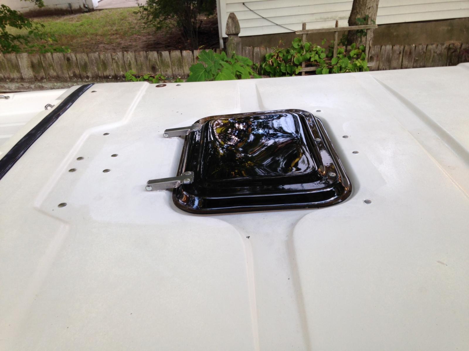

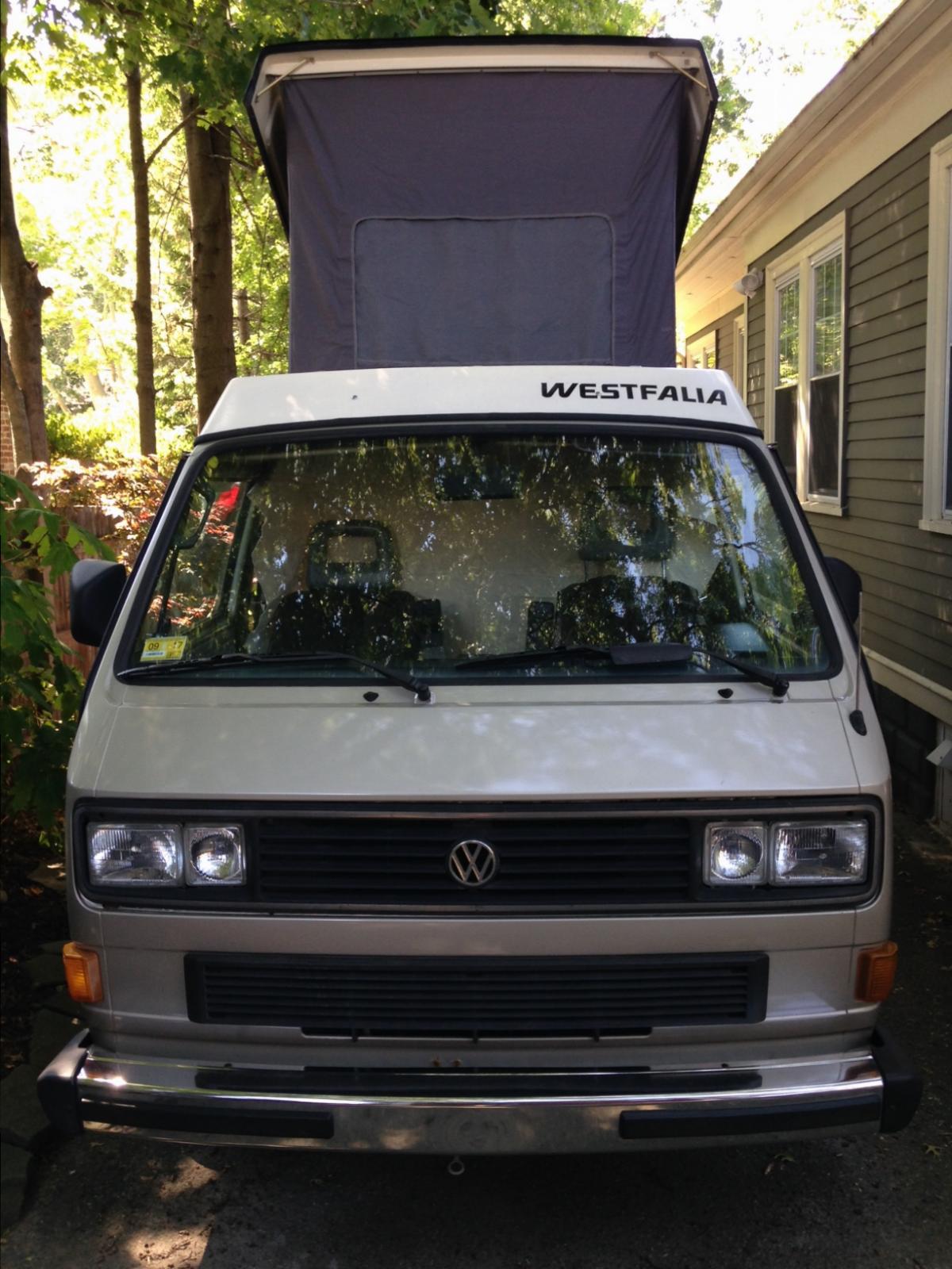

I had a busy afternoon today. First I cleaned the pop top with Bartender's Friend (rinsed it asap) and Simple Green and applied Penetrol to it. Nice!
Then I installed all new stainless steel hardware for the skylight, new skylight seal, skylight screen by Gerald (Backyard CNC) and finished installing other stainless steel pop top hardware I didn't get to a month ago. All except the hardware of the pop top hinge, I'm leaving that as is.
The cargo cleats are new too. I did that in the fall. Cool

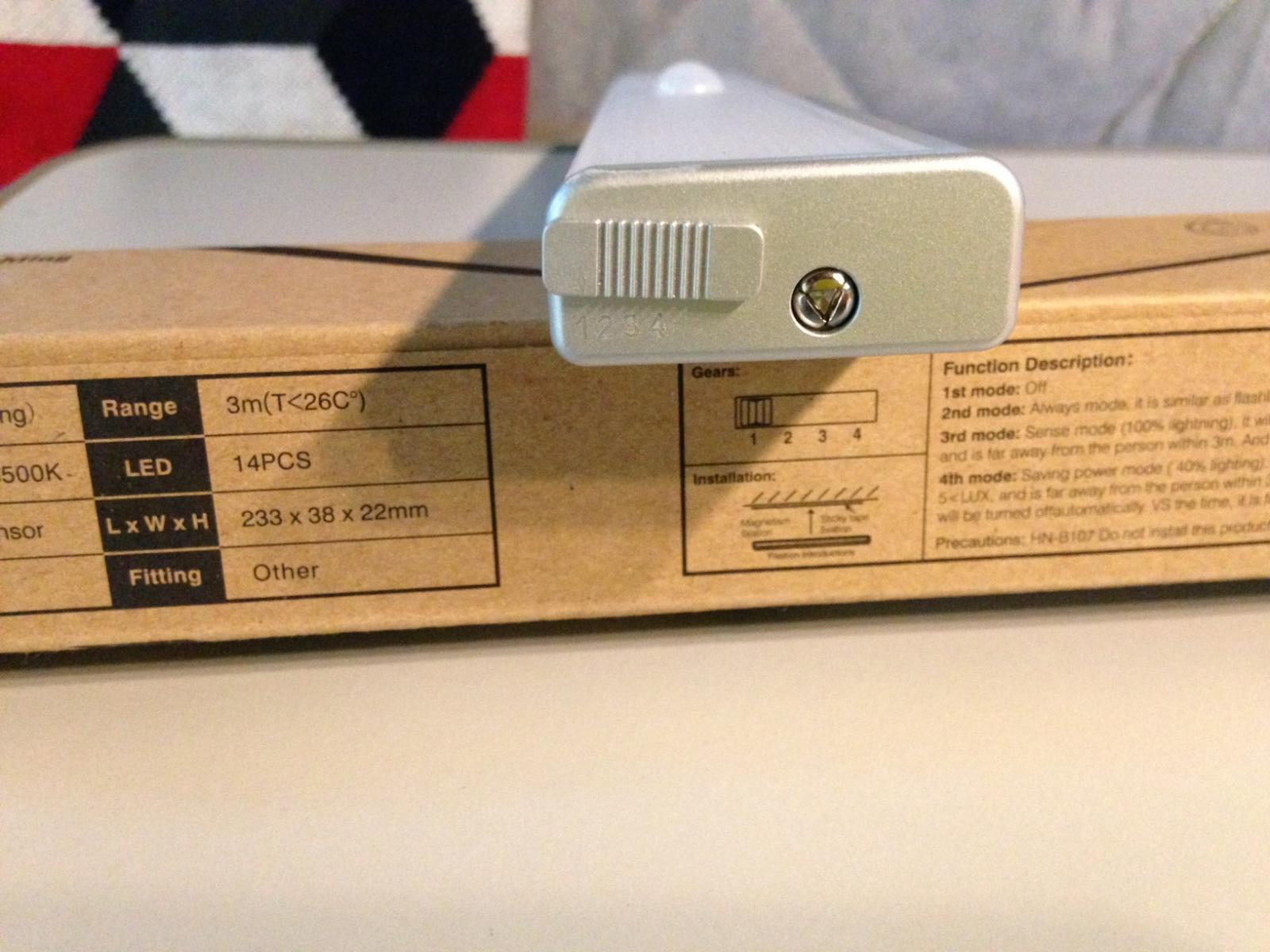

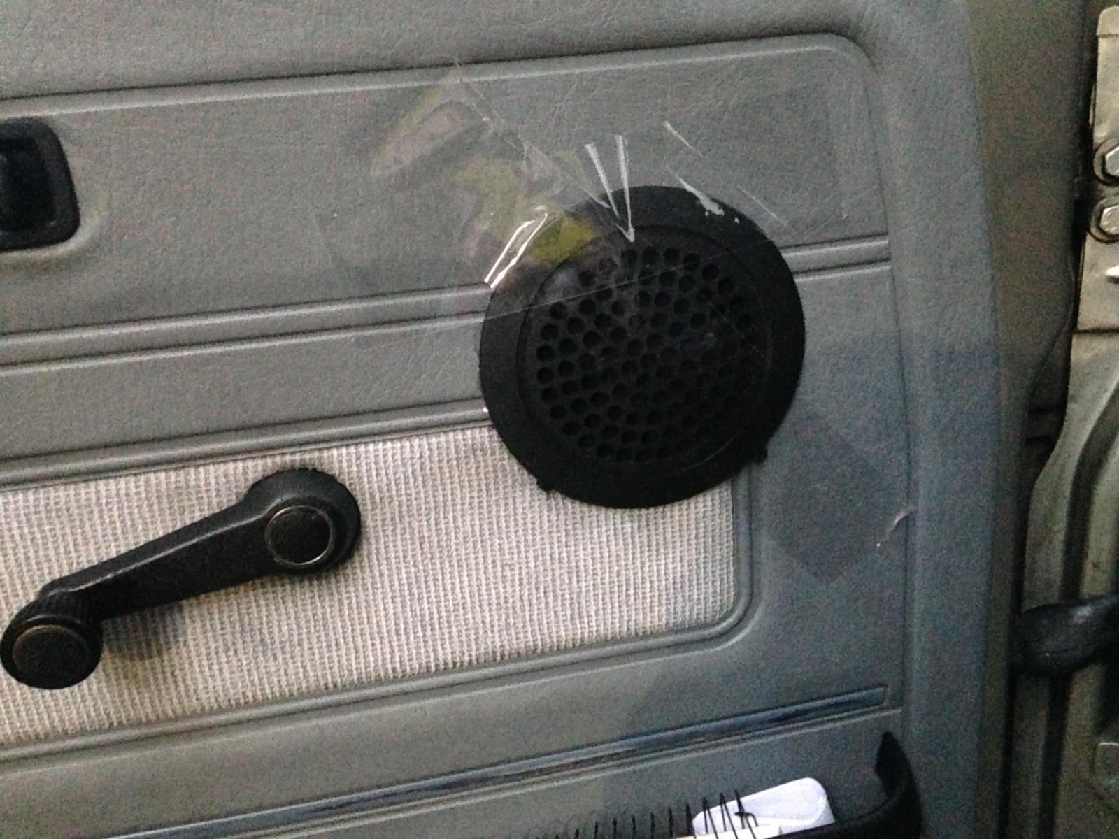

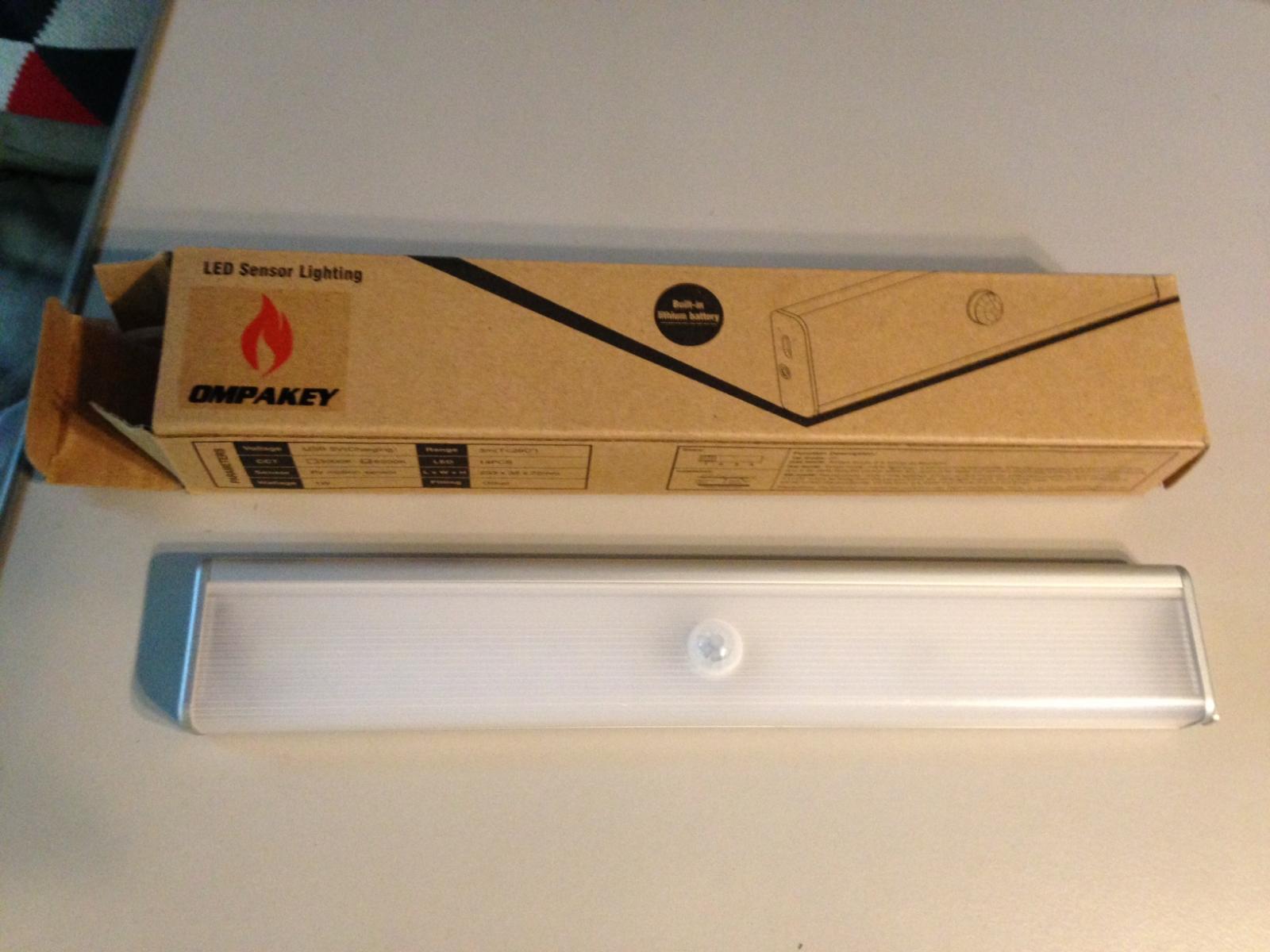

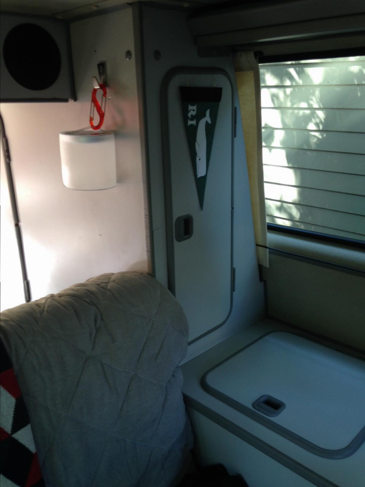

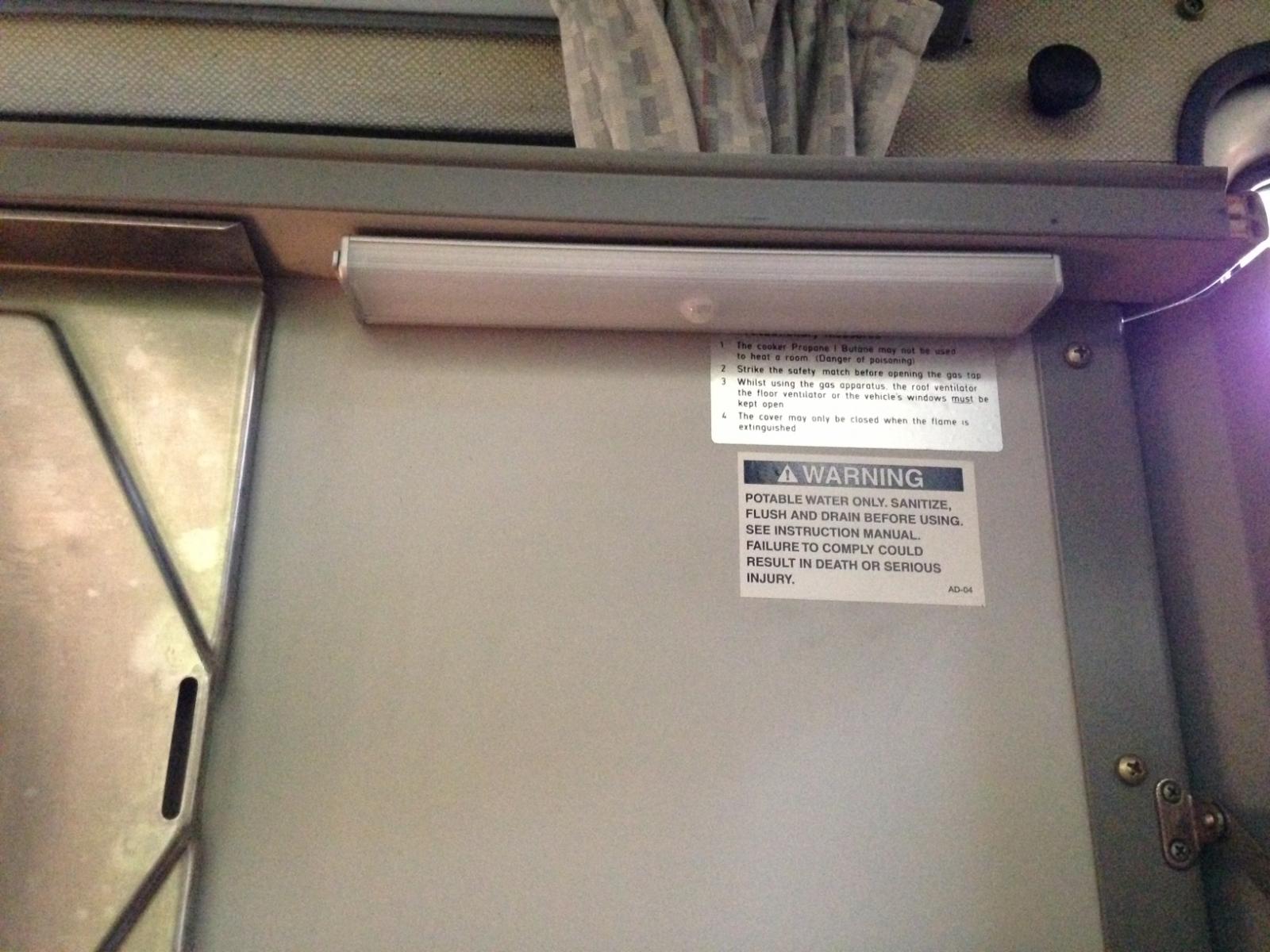

Another favorite mod is the new LED sensor light I installed above the sink. I did't have to wire it since it's rechargeable (comes with USB cable). It attaches to the stove/sink cover with a magnetized tape so it is easy to remove and charge when necessary. You don't see the magnet at all, it's hidden under the lip of the cover. The light lasts about four hours if you leave it on. It has four settings:
- always off
- always on
- motion sensor full power
- motion sensor half power
It's very cheap and I got it from Amazon. I hope it lasts.
https://www.amazon.com/Ompakey-Rechargeable-Anywhe...mpakey+led
I purchased a longer rechargeable sensor light for the closet but I haven't installed it yet. I will post pics when done.

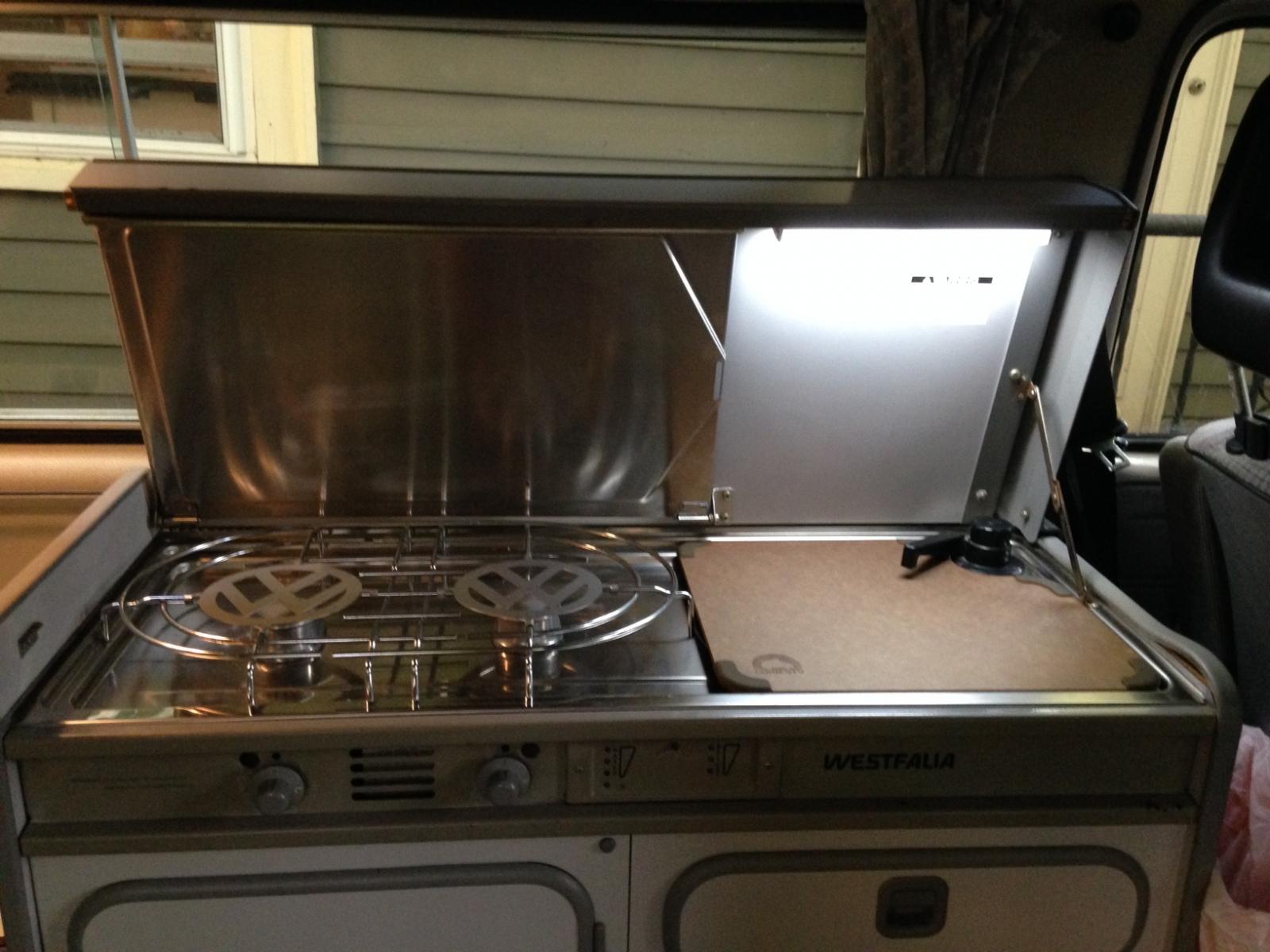

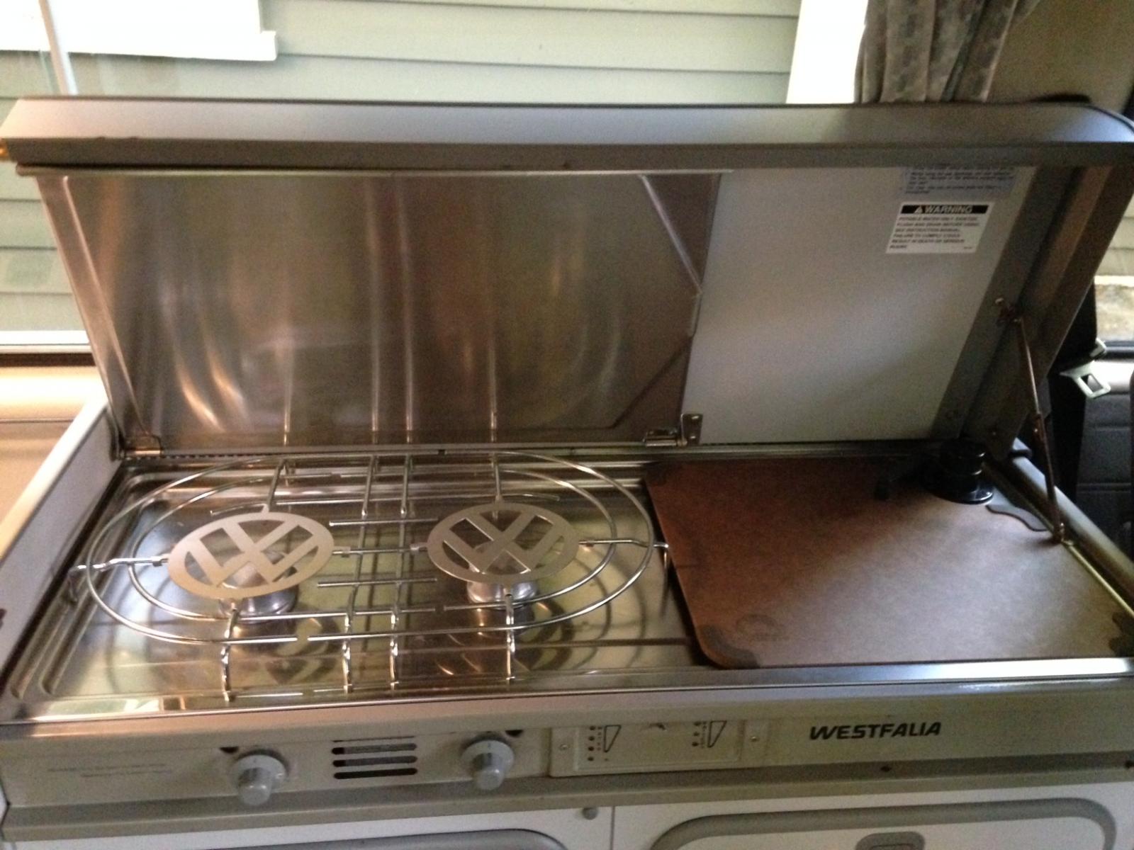

I installed the Frank Condelli VW grills a while back and got a cutting board for the sink. I like the added space.

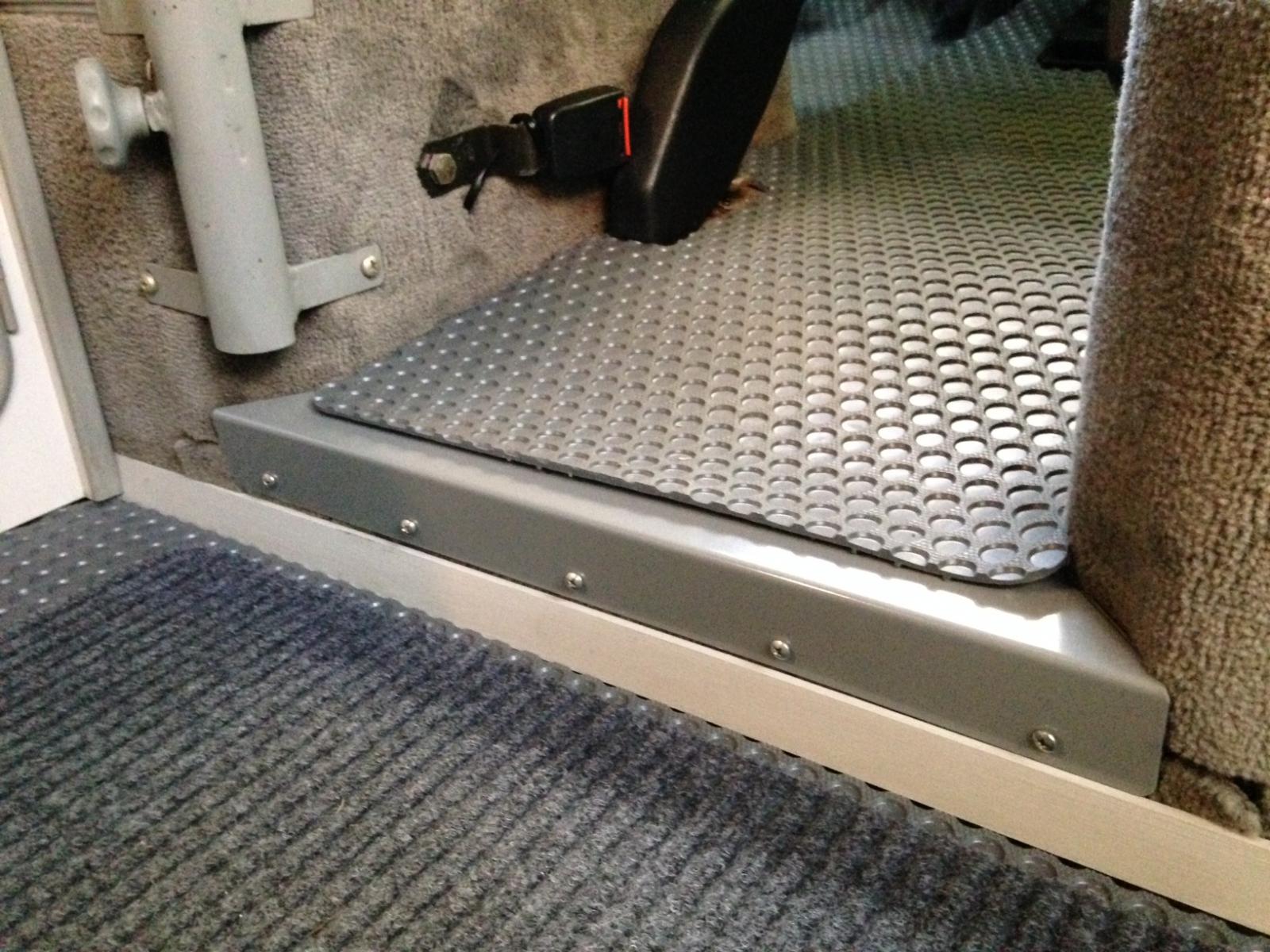

Another necessary mod in the aesthetic realm was the GW aisle trim. Mine was completely shot.
http://www.gowesty.com/product-details.php?v=&id=23957

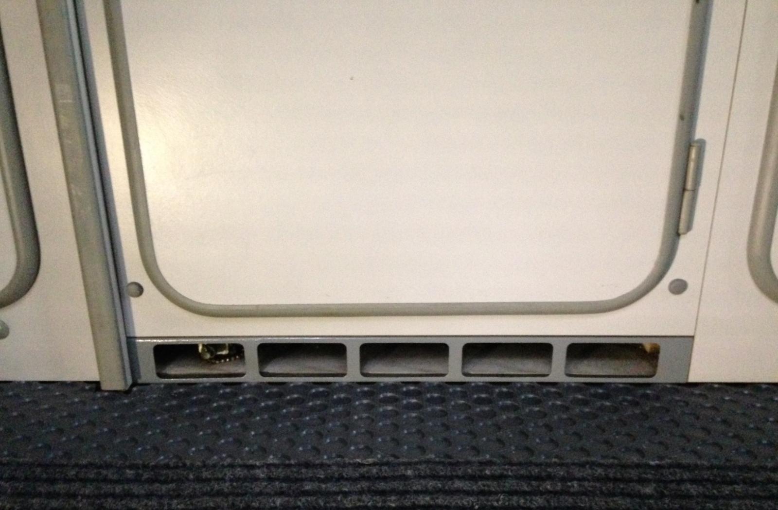

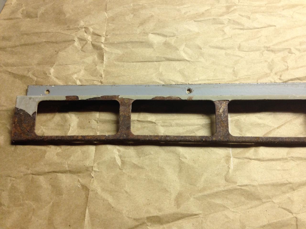

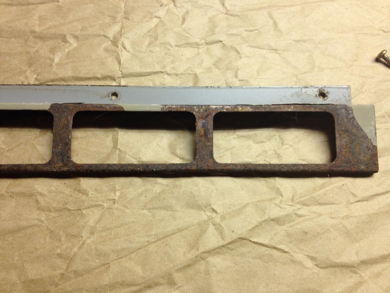

Next I need to get rid of that rust in the bottom grill of the fridge. I figured out how to detach that piece which is part of the fridge face plate (all one piece).

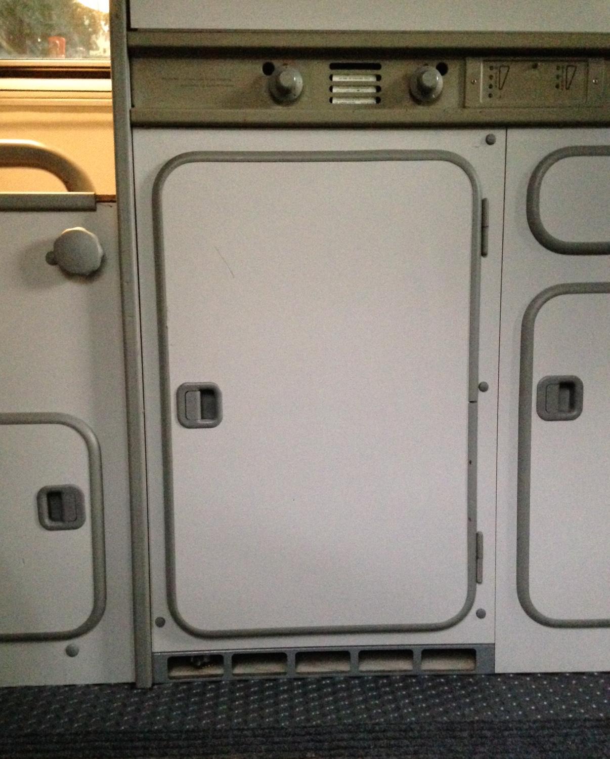

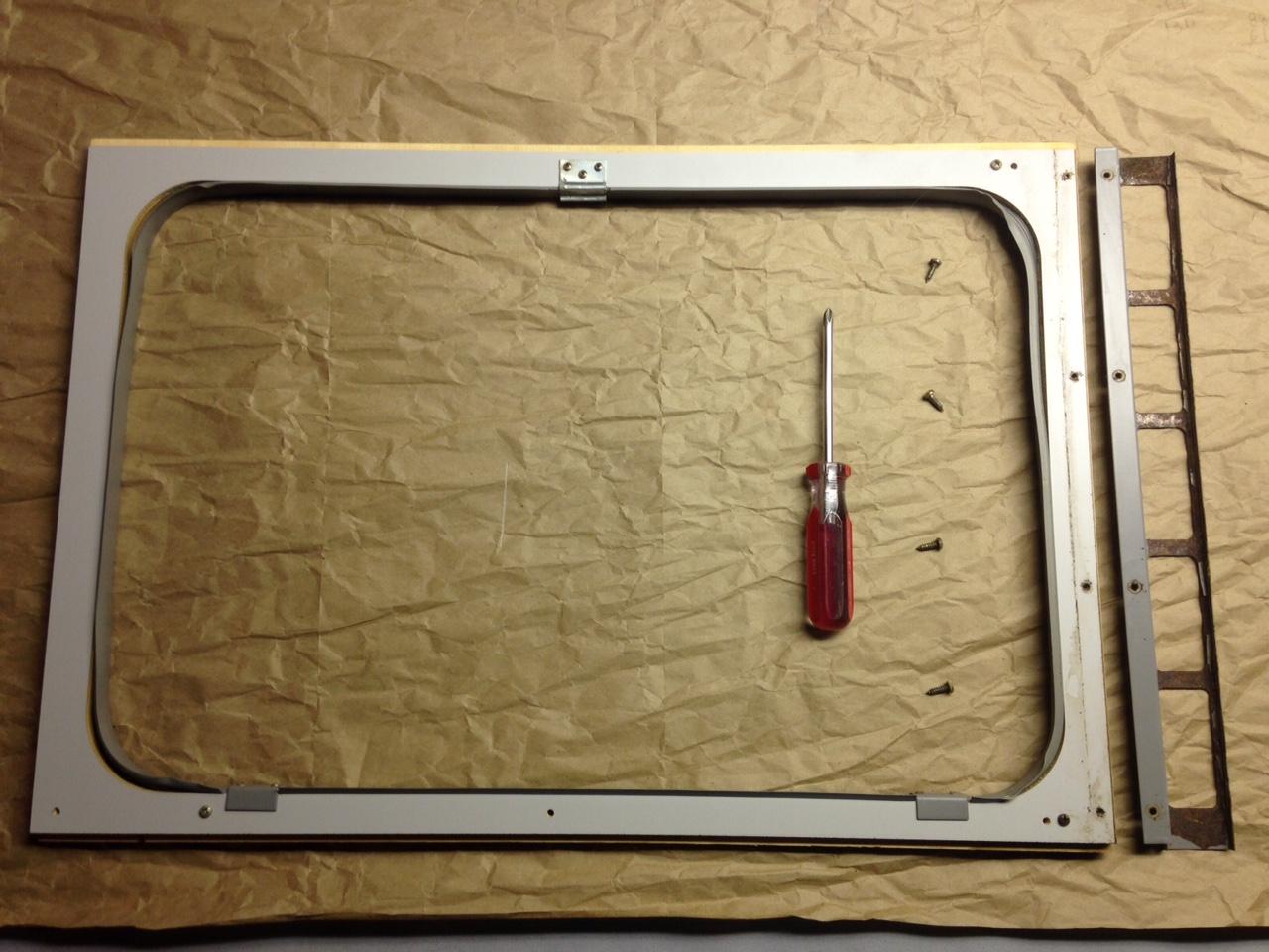

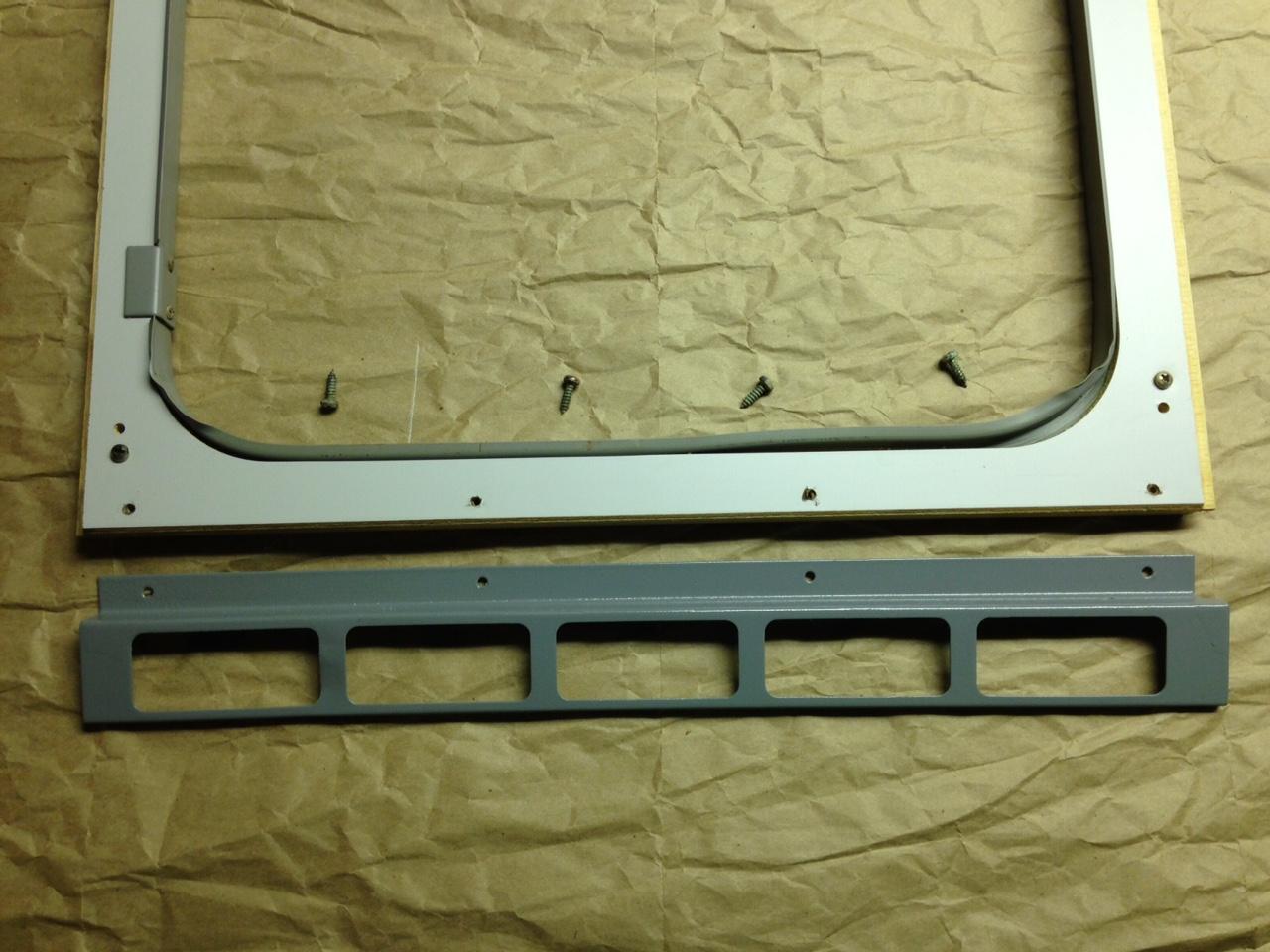

Continuing down my non-essential project list, I have now removed the rust from the bottom grill connected to the fridge trim. It was very rusty. Given the condition of the grill, the thought of the rust that may lay behind that fridge scares the hell out of me, but I'm determined to enjoy my summer and fall camping season and tackle major rust removal at a later date. That's a biggie.
So here is what it looked like:
And this is what I did:
Removed the fridge door (it lifts right out of the hinges), took the screws out of the fridge trim and popped it out in one piece, then unscrewed the bottom grill part.
I sanded by hand the rusted grill. That took about 20 minutes and all rust was gone, then sprayed on a Rust-Oleum primer for rusted items (though this item had no rust left, but just in case), let it dry overnight, then sprayed Rust-Oleum 7587838 Professional High Performance Enamel Spray Paint, Dark Machine Gray (two coats with drying time in between).
It came out nice and the color matches the gray interior quite well.
UPDATE:
This is what it looks like installed in the van.
-- PF

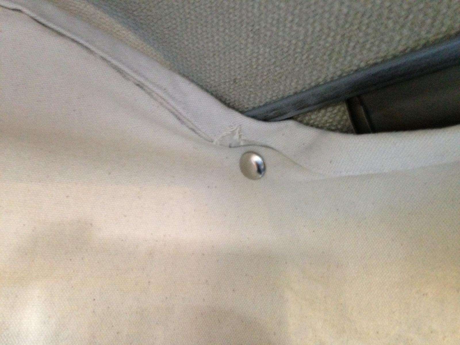

This past weekend I finally removed most of the mold in the fuzzy liner of the pop top. I used a mixture of half water half bleach and it worked well. I will carefully work on the edge (lip) of the pop top where it meets the canvas, probably using a Q-Tip as to not bleach the gray canvas. That edge is pretty nasty with mold.
Before near skylight:
After:

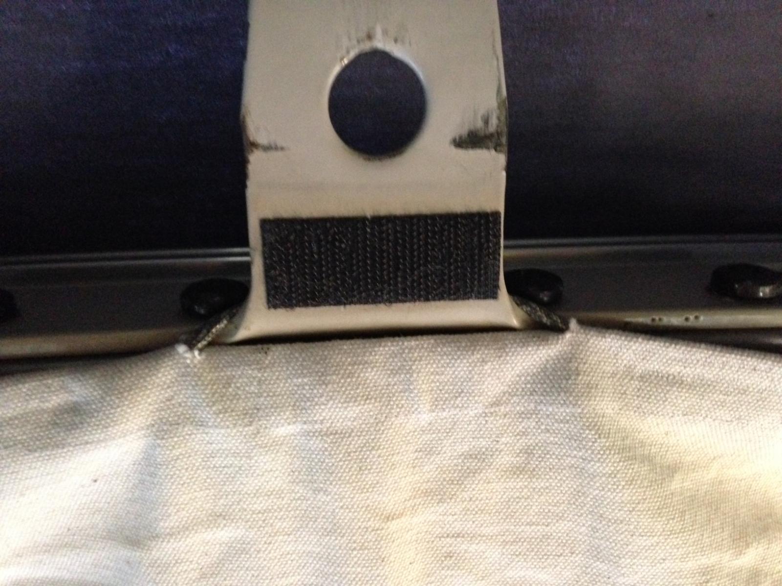

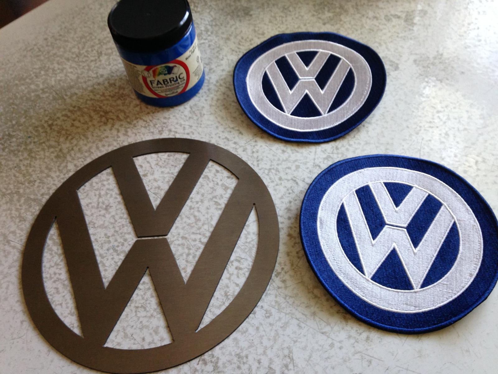

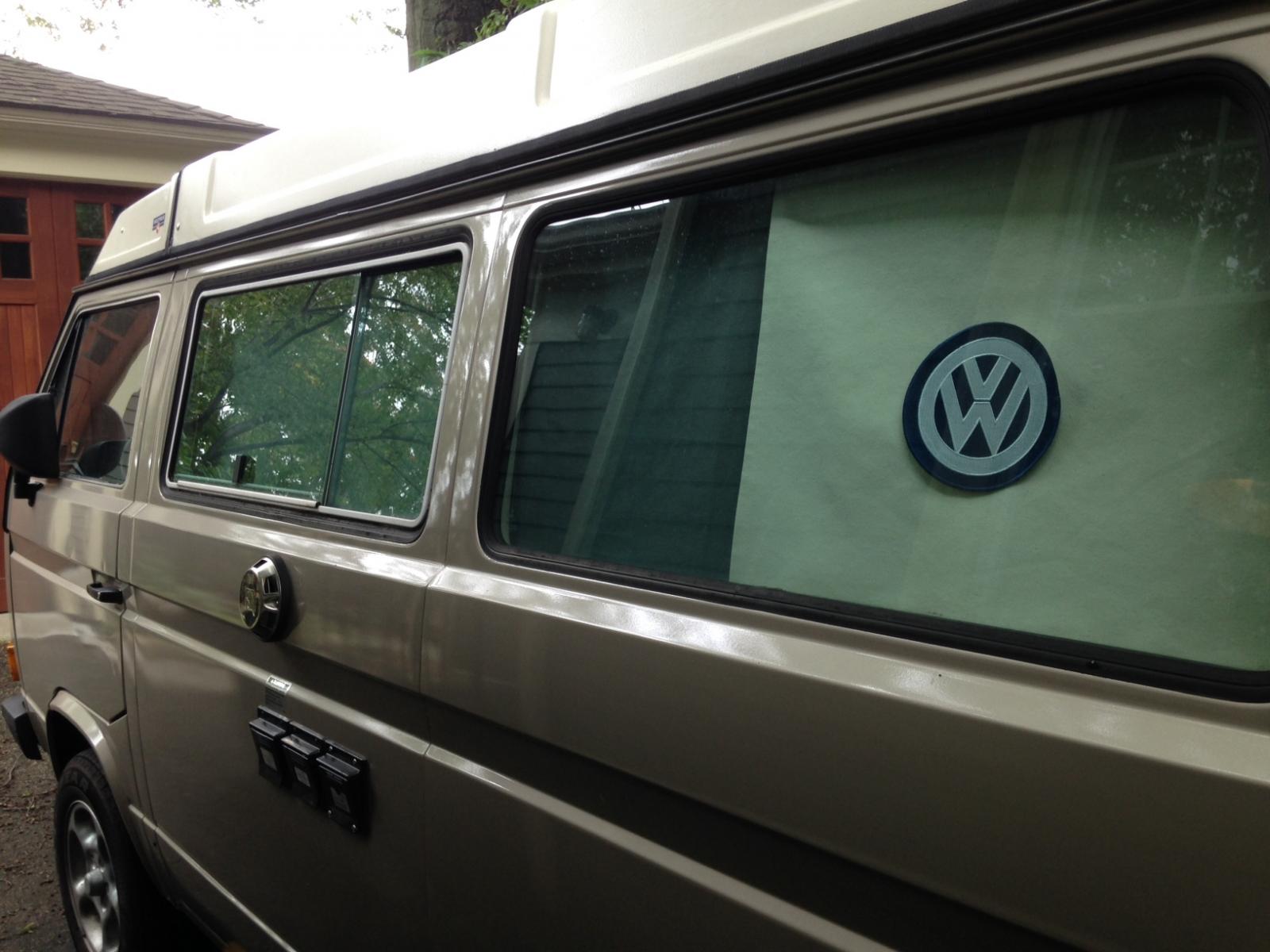

I also received over the weekend my rare earth magnets and I have been working away on the gray curtains for the most of the sides and back (not the front). I will post images this evening. These magnets are VERY powerful and I highly recommend them. I wouldn't want them any weaker or stronger. They are sawn into the seams of the curtains.
I got them here, pack of 25:
https://www.etsy.com/listing/191336657/12-x-14-inch-127-x-64-mm-powerful

Did you need any modification of the van to allow the magnets something to stick too or do they attract to the van well enough through the wall?
figborg
Joined: August 24, 2015
Posts: 338
Location: Northeast
figborg is offline
PostPosted: Tue Sep 06, 2016 11:04 am    Post subject: Re: Minor and major improvements to my 86.5 Westy Reply with quote
I have enough metal around the windows. They stick with force. You really need to pull the curtains to move/remove them.

Dave, thanks for the mold advise. I plan on going over it at a later date when it's less humid outside. I'm also wondering if bleach would react (meaning discolor) my gray canvas even if the liner is now dry. I didn't rinse it well, just made sure it was bone dry before shutting the top.

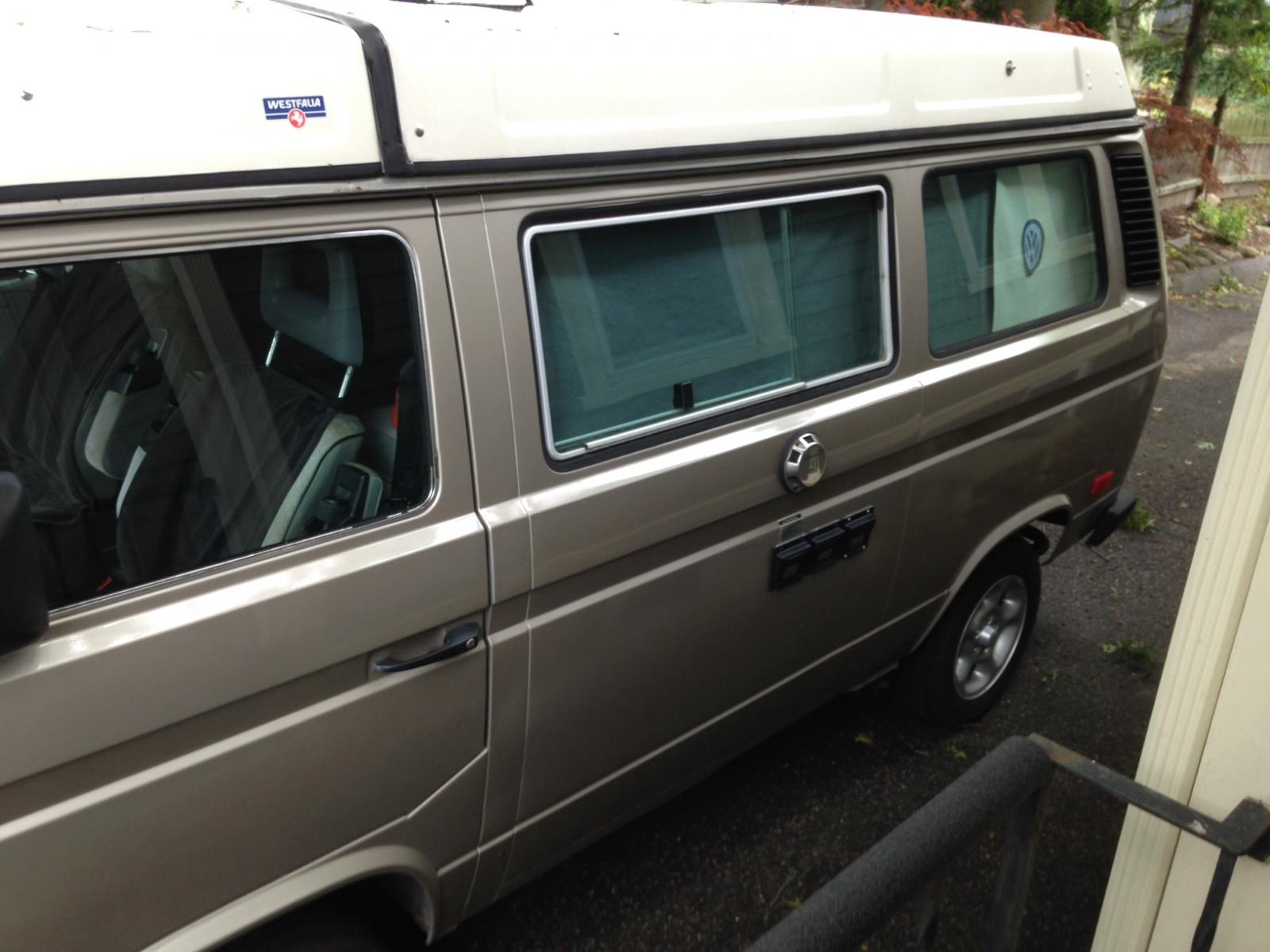

Curtains with magnets:
Here are the rare earth magnets I used. I like the size and strength. They fit inside the seam of the curtains. Beware that if the magnets come to close contact inside the seam they will snap together and be practically impossible to detach, they are that strong. This is why I made sure I sewed a bit around them, to prevent them from moving closer to each other. The larger panels (sliding windows) have 8 magnets and the smaller back panel have five.
Also, keep in mind that the magnets are so strong that they will attach to the inside of a washing machine or to an ironing board or to the table legs of the Westy or the stove face plate... the sewing machine... Laughing (what a PITA that was!) But once they are in place covering the windows they will not more.
I love the curtains this way though. I much rather deal with magnets that snaps. I did leave the original snaps from the curtain straps in place in case I want to attach anything to them in the future such as flashlights or pouches.
The materials makes the inside of the van dark enough but not pitch black. I like that.
I still have to sew the back hatch curtain. I ran out of magnets so I'm getting two more packs (I want them for other projects as well). I plan on making two curtains with screens for the front windows (passenger and driver), similar to the ones GoWesty sells.

Love the curtains. I sort of had the same idea. How will you ultimately put them away without creating another thing to store in the van? Will the magnets make that difficult? That is my only hold up at the moment.
