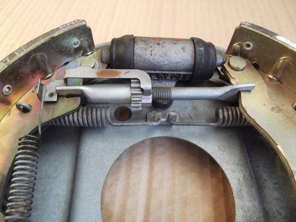

PostPosted: Sat Mar 04, 2017 5:47 am    Post subject: Re: ss brake hoses Reply with quote
do you have a pic of a correctly installed brake pads and springs? the springs seem to interfere with the movement of the adjusters a little.

crazyvwvanman
Joined: January 28, 2008
Posts: 10379
Location: Orbiting San Diego
crazyvwvanman is offline
PostPosted: Sat Mar 04, 2017 6:01 am    Post subject: Re: ss brake hoses Reply with quote
Those main return spring should look like this. There are 2 different springs on each side of the van. If you mix up the springs the long hook end blocks the adjuster.
DRIVER SIDE PHOTO
PASSENGER SIDE PHOTO

PostPosted: Sat Mar 04, 2017 9:14 am    Post subject: Re: ss brake hoses Reply with quote
great pics thanks! i think i might have hooked mine up wrong i think i will have to check that again. plus after reading many other pages of post i think my adjusters are bad the pawls seem to be worn to almost non existence compared to new ones. i found some pics of the pawls on another thread. so it looks like i will have to order some new adjusters. i should have researched this more and i didnt think i would have to replace all this stuff. i thought it would be only shoes. i should have gone with the 14" disc brake/rotors and calipers that the guy advertises in the classifieds here on thesamba (for $125 for everything brackets, calipers, etc). next time for sure ( if there is a next time). snowing here today will have to wait to continue this since i am working outside in a gravel driveway, tomorrow suppose to be in the high 50's. more time to read other post.
