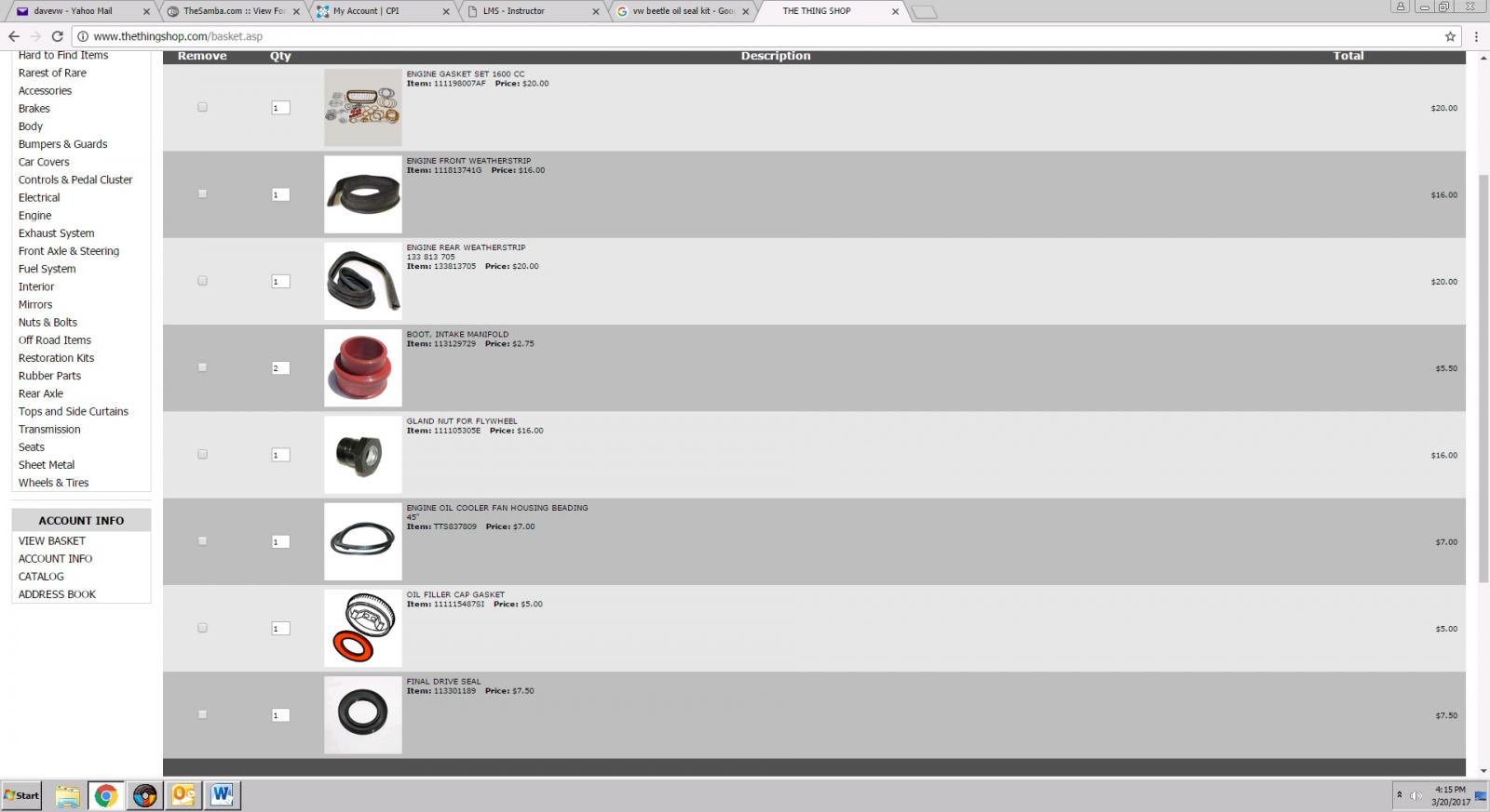

So I think for now, I'm going to just drop the engine and reseal it. Maybe I'll get lucky and find that torquing down the heads after doing the pushrod tube seals will bump up my compression on the one cylinder.
However, unless I find something really ugly, I will just seal up the motor and call it good for the summer. It is leaking way too much to be able to drive it this summer without risking further damage. For now, I want to just get it to where I can drive around town in the summer and not worry about that.
It has been a while since I've done much of anything with a Type 1 motor, so I want to make sure I've got everything coming.
I want to drop the motor and replace every oil seal I can without splitting the case. Also will replace the input shaft seal on the transmission.
If I remember my T1s correctly, I'll have to remove the gland nut to do the seals on the flywheel, and the gland nut will have to be replaced, right? It looks like from the pic that the needle bearing is a part of the gland nut. Is that correct?
Does this look like a good shopping list? Is there anything not included in the 1600 oil seal kit I would need? Did I accidentally add anything that IS in the 1600 kit?
Here is my shopping cart so far. Looking for any other suggestions of "while you're in there" stuff I didn't think of. I will add a clutch kit.

I dont see the seal on the transmission shaft the seal that you have listed is the final drive seal under the cv joints

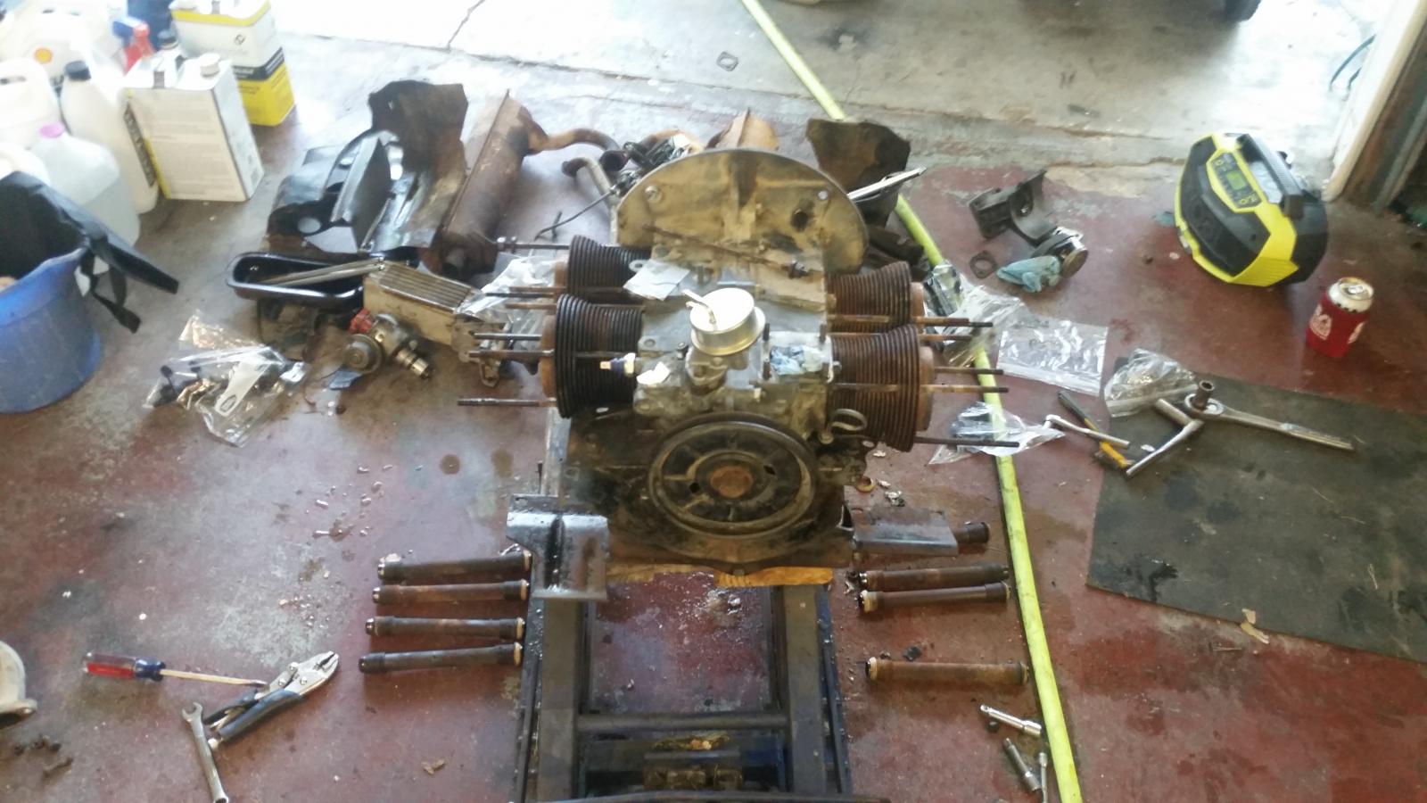

I finally got to working on resealing this engine today. Poor Thing has been sitting in my driveway incapacitated for a few weeks now. (Also needs front end work.)
Anyway, got the motor out and largely torn apart this afternoon. Now I have a few questions.

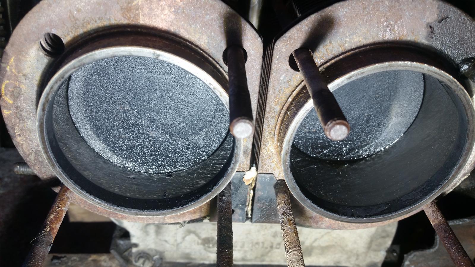

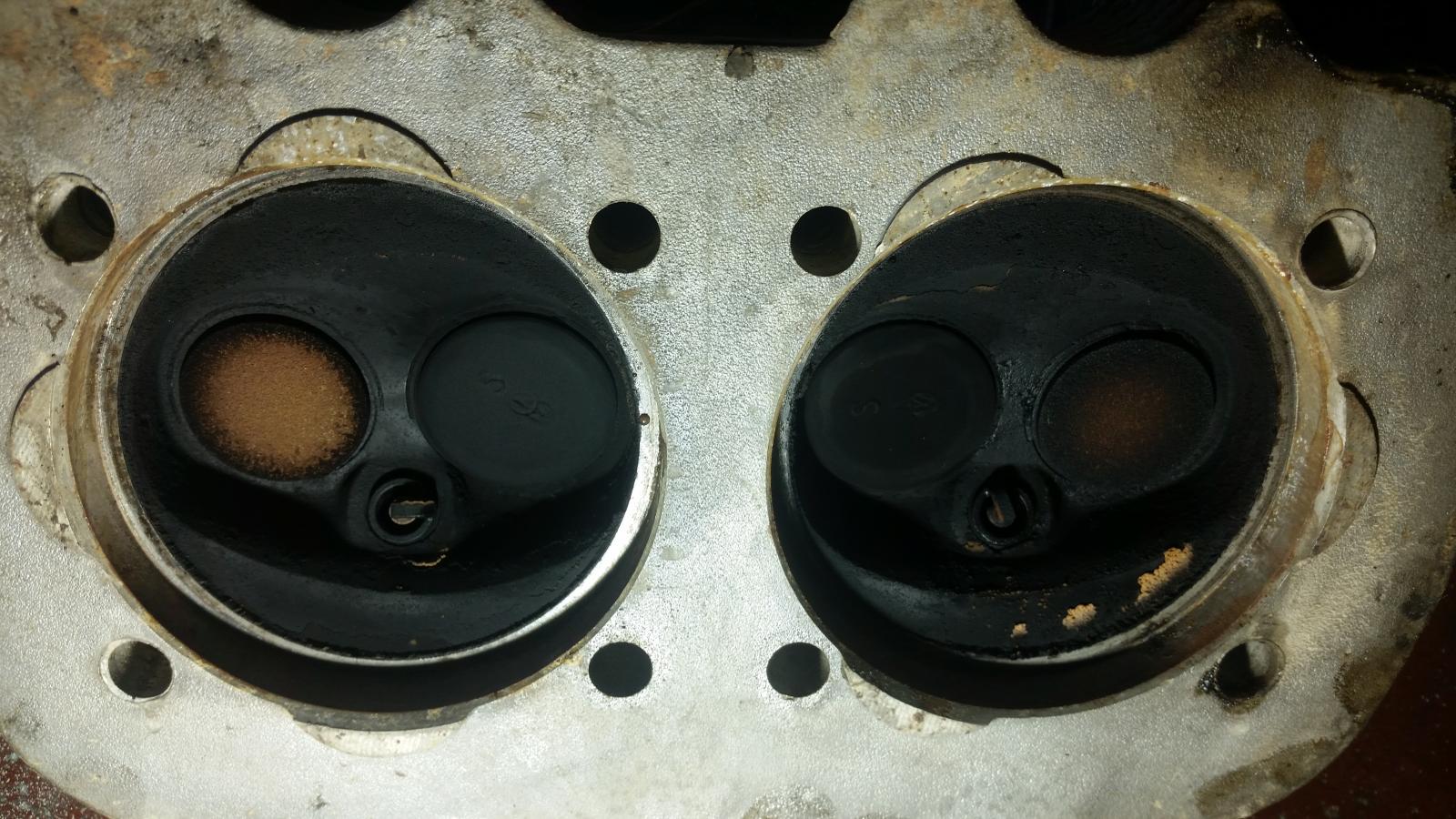

Finally, do you see anything concerning with the following head or jug pics?
Note the large puddle and general mess. This was the impetus for the whole project.
Driver Side
Passenger Side
How it sits in my garage at the moment.

Shocked thats a satisfying pile of parts. you might want to bag that oil cooler as contamination there is just as bad as your engine block holes.
soak those PR tubes over night in gas - then run a brush thru them- I put my thumb over one end an blow in the other to see if they have cracks.
First cylinder to head sealing in an old motor I ve seen in a long time. As far as the h studs go- put some sealer on them and screw them back in.

Thanks! I guess you're saying that the cylinders look to have been sealing well to the heads. Yes, I was happy to see that there wasn't any leaking/damage there.
Are those $150 pistons and cylinders any good? How about rings? I did have a little bit of low compression on one cylinder before taking it apart...
