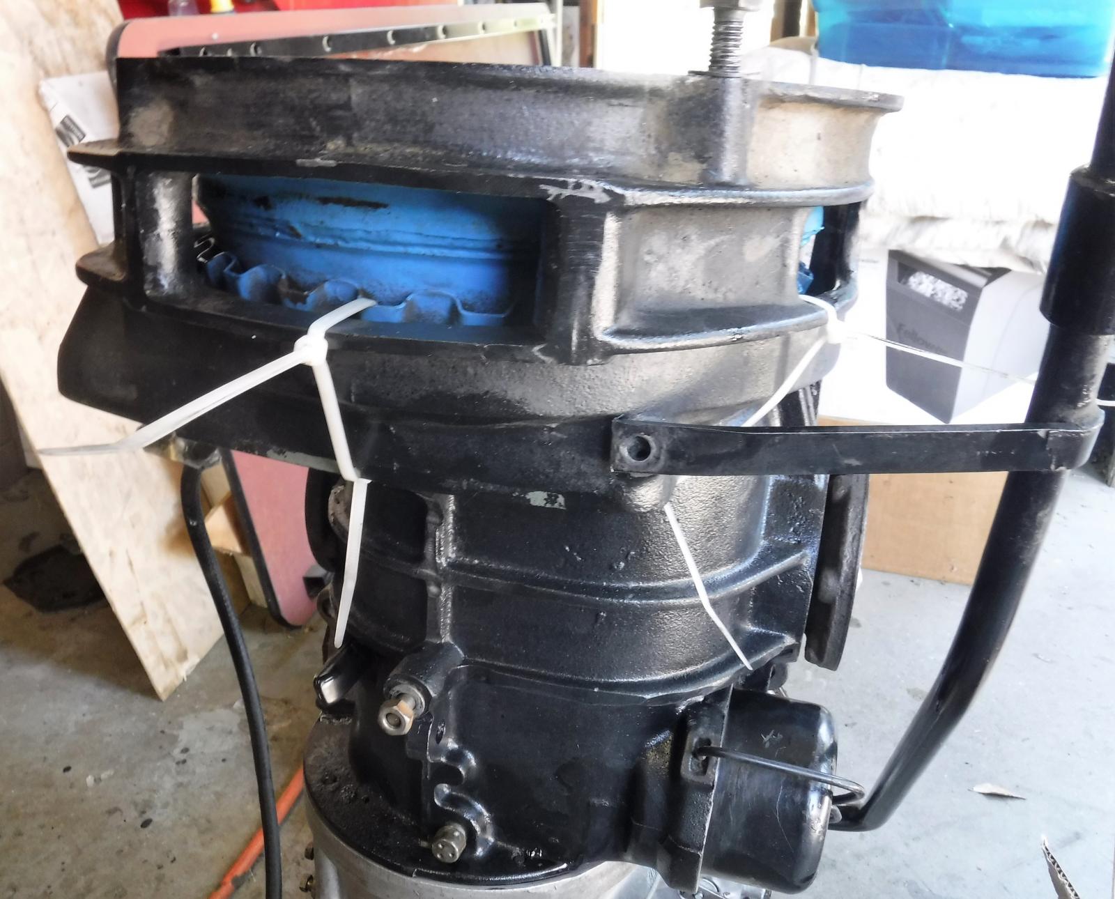

1) With transmission separated from engine, place transmission horizontal. Ensure Turbine driveshaft is seated into transmission. Next, insert Oil Pump driveshaft into the Turbine Driveshaft. It will need to index into the pump. You will know it is incorrectly seated if you can twist it with your finger tips and it just rolls around. It will also stick out of the of the Turbine Driveshaft far enough for you to get a good grip.
It is correctly seated when you can only grip it with your fingertips and you can feel smooth resistance as you twist it. You are driving the Oil Pump now with your fingertips. I have a bunch of pictures of all this... somewhere.
Exclamation These two shafts MUST REMAIN SEATED or you will suffer my fate.
2) With both shafts properly seated, rotate entire transmission vertical. I used a small furniture dolly to support it. It's easier than you think. Thanks to Wildthings for this idea!
I did not want to install the drive shaft when the unit was vertical for fear of letting the driveshaft slip out of my oily fingers, and punch a new hole in the impeller.
3) Place Torque Converter on top of the shafts. It will not magically seat itself; you will rotate it back and forth as it nests into each shaft. There will be two distinct thunks as it does this, one for each shaft. You will find this somewhat difficult to do. This is because there is no room for your fingers to hold the damn thing as it nests inside the transmission case/bell. I used some scrap wire around the lugs of the Torque Convert to suspend it with one hand. Made it much more manageable. The TC will be properly seated when A) you feel the two distinct thunks, B) when the noticeable wobble is nearly all gone, and C) when the TC is below then end of the bell, not sticking out at all. Not sure if it is? Start over and do it again. Make sure you get this right! I suspect the damage I did to the Oil Pump could easily be replicated in the Torque Converter.
4) Now, a very important step (again, thanks to Wildthings!)... WIRE OR ZIP TIE the Torque Converter to the transmission case. Do this in a way that keeps them from interfering with mating the case to the engine. DO NOT let it slide forward or off the shafts! Evil or Very Mad The TC holds the drive shaft captive in its seats. Letting it slide forward will allow the driveshaft to misbehave.
5) Re-position the transmission horizontal and mate to engine/flex/drive plate. Mate engine and transmission together, LEAVING TORQUE CONVERTER ZIP-TIED TO THE CASE. Don't cut those off yet. Bolt the engine to the transmission, leaving the starter off. That will get in your way later if you put it on now.
6) Once you have the transmission and engine mated up (two bottom studs and one top bolt on driver's side) then you can cut loose the Torque Converter because it is now captive. It cannot possibly slide too far forward and off the shafts. In fact, it is now time to mate the TC to the Flex/Drive plate. Rotate the engine to do this.
7) Reinstall power train into bus.
Arrow DO NOT leave Torque Converter attached to engine's Flex/Drive plate and try to mate up transmission to that, thinking the drive shafts will stay put. They probably won't.

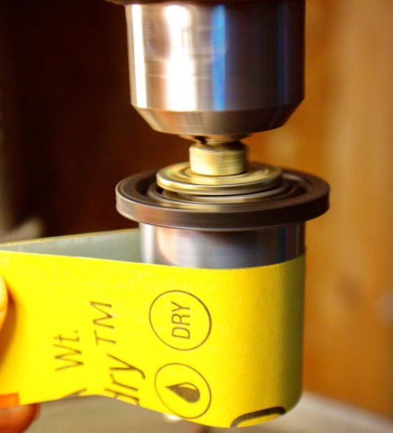

Check my caliper rebuild thread for piston polishing:
https://www.thesamba.com/vw/forum/viewtopic.php?t=658176
Some highlight pictures:
A rubber expansion plug as a piston holder
The plug installed tight in the piston.
Piston and mount chucked in drill press. A hand drill held in a clamp will work.
Polishing....300-500 rpm IIRC. Do this wet or dry.
I cannot remember if I mentioned in the how-to...but really you should visit the body shop section or Mcmaster carr...and use 3000 grit for the best polish on un-altered pistons.
The stock pistons while they look to be chromed...most are actually I have recently found out...nickel plated. I stripped the plating from mine for plating crack/rust issues....which I will not do again. The bare steel pistons polish fine with 2000.
On your still nickel plated pistons 3000 grit will be much nicer. It only takes a couple of minutes per piston.
Treat the rust in pits and scratches with a dilute solution of phosphoric acid...slightly diluted Ospho will work fine.
Do this rust neutralization BEFORE polishing.
The reason for this?
Its the same reason(s) I now know they are nickel plated and not chrome (they may be chrome from some mfgs...but likely not)
1. If these were zinc plated (does not polish well) or even zinc nickel (the ultimate in rust proof and sacrificial anode plating)....everywhere there is a pit or a scratch...the steel underneath...would NOT rust. This is because Zinc acts as a sacrificial anode. It absorbs the electrolytic charge and breaks down the zinc instead of allowing the steel to rust.
2. While chrome is an active sacrificial anode to steel....it also needs a "seed" layer to adhere well, have few pits and be polish-able. Either a double layer like copper strike layer and top plated with chrome.....or copper strike....nickel over that (the only way to keep the chrome solution from eating the nickel as the copper is the anode for the nickel) ....and these pistons have no copper plating.
But....as noted.....since chrome is an active anode.....if it were chrome plated you would... NOT....see the TYPE of rust that caliper pistons have. You see this type of corrosion with NICKEL plating.
With nickel plating.....when a pit or scratch rusts, it first blooms outward. You do not get to see this as the rust bloom is wept away by piston movement and fluid.
In the next stages...the rust causes the steel surface to recede away from the outer plating surface and grow/spread. It forms cavities and the plating flakes away.
Its a very distinctive corrosion pattern.
The reason you need to treat the rust in the pits and scratches is that unless you do...it will keep rusting and get worse...causing plating to flake off
The reason nickel is used in the first place....is because it does not require a seed layer and nickel is a far more rust proof, harder and easier to polish metal. Nickel itself....will never rust or corrode unless its attacked by a very strong acid or caustic.
BUT...it has no sacrificial anode protection. The rust pits you get in the pistons (aside from grit abrasions or previous owners scratching the plating)....are actually caused by thin spots in the nickel electroplating.
A much better, more uniform and more modern way to prevent this is to plate them with electroless nickel. I will soon be replating the pistons I stripped in that how-to. Ray

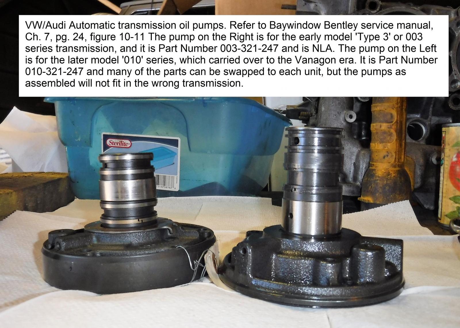

Here is the donor pump from an 010 transmission, next to my 003 damaged pump:
These are both of those pumps opened up... it seems like the pump internals are isnterchangeable, but the pump bodies themselves are different.
Close-up view of the part that got ruined. Seems like it is just cast iron or cast steel. Not a forging or billet machined part. That heavy steel driveshaft nests in those splines and transmits the driving energy that the oil pump needs from the Torque Converter. This is a relatively fragile part, in my opinion.

Best way: While transmission is horizontal, I inserted the driveshaft. I did not want to risk having the driveshaft slip out of my fingers and land on that small part deep down in there and have it break through it. After that, I did like Wildthings noted and inverted the transmission. I stabilized it on a small furniture dolly.
Then, I made a wire bundle to help me gently place the Torque Converter onto the transmission. Care must also be exercised at this point: You need to index the TC onto the Turbine Driveshaft and the Oil Pump Driveshaft and it is done by rotating clockwise/counter-clockwise while gently allowing the TC to 'fall' down onto the shafts as the splines index. You'll feel distinct 'thunks' as this happens. It is properly seated when you feel them, and the TC is recessed into the bell housing, and when very little axial play can be felt. Spin the TC back and forth at any step of the way, and you will notice distinct differences in how it sets.
Then, zip tie that sucker so it won't move off those shafts! I don't need to really explain the importance of this again, right?! Laughing
Then mate it up to the engine. I just put the starter on there for pictorial reference. Don't install the starter yet, it will just get in the way when you hang the powertrain under the bus. At this point, the TC is captive and won't slide far enough off the shafts to cause a problem. When the transmission is snug to the engine and you have the bottom two nuts and one of the top bolts tight, cut off the zip ties. Rotate the TC up to where one of the anchor bolts can be accessed through the engine case. I used red Lock-tight and torqued each down. The torque spec is in the Bentley. Then, hand crank the engine over to rotate the TC around to finish the work.

Figured it out, the converter that came with the trans was pooched.
Input shaft won't drop in the converter splines more than ~1/4", if that.
The vanagon converter ~fell in place in after a few twists and wiggles as expected.
That 30 second job took hours and a lot of violent cussing due to some PO or idiot mechanic.
The flex plate bolt pads on the converter should be appx 1/2" in from the trans flange face.
That's the go/no go measurement to be concerned with.
(amazingly happens to be about the same distance the flex plate sticks out from the engine flange)
Noticed the late Vanagon (090) pump shaft projects a touch more and is... pointed, and the splines taper down to the end to center/engage very easy.
The early 003 pump shaft just has a small bevel to center.
The input shaft should be ~even with the stator (outer) spline bit that doesn't move on the trans, and the pump shaft should stick out a bit less than 1/2", and you should be able to feel it engage, slide in a bit and feel it turning the pump when its engaged.
(resistance, but smooth, feels-like-turning-an-oil-pump resistance)
Closer inspection of the bad converter revealed the circular shaft centering bit around the splines was oval shaped like someidiot had been using a prybar in it.
The shaft seems to have been hanging up where the bearing area starts, wouldn't go fully in the hole as the sides had been pulled in.
I'm guessing It had probably been hammered in previously.
I need to straighten it out a bit tomorrow to put it on the Vanagon trans to keep it sealed up.
Considering drilling the converter for two drain plugs 180 out so I can drain/flush it etc.
(drill/tap, short ~6/32 or so button head screws with good anerobic sealant, should be fine)
If its thick enough for those thick fillet welds for the flexplate tabs, its plenty thick enough for plugs, maybe even NPT.
(some converters have a drain plug from the factory, just not VWs, seems stupid not to be able to drain/flush a converter)
I'll try it on the bad converter first.

I edited my post above... I forgot to include the picture of what it is supposed to look like with the shafts properly seated. It's now included!
As far as using a hammer on any of this... I would think the need to do that would indicate problems.
Arrow Can you provide a source for that drive piece? My local parts house shows it NLA and I would like to replace the one from my 010

That seal is in backwards. It's on the lower pressure return side, but still...
Jeff Fields (transaxleengineering at gmail.com) Transaxle Engineering has the CrMo versions, mandatory in their hipo 090s with higher line pressures/manual valve bodies. May have a line on the stock bit too.
ECS tuning and a lot of other online vendors list the stock 003 321 273 part, which just means it still exists in some distributors inventory. Audi used it in several models up to the 200.
Might be the cheapest Porsche part ever, although I cannot think of what Porsche used a 010 variant...
https://www.ecstuning.com/b-genuine-porsche-parts/oil-pump-carrier/003321273~por/

I used the old seal for that. The original style white silicone seals could pop out, the new seals are metal body with a thin sealant covering. silicone doesn't stick to silicone too well...
Those seals are for the return flow from the tq converter. (pressure feed is via the center of the input shaft, return passes back around its OD inside the output shaft)
The seals that will puke ATF into the diff are on either end of the output shaft (pinion shaft) and the governor seal. The inner seal for the output shaft requires the input shaft/pinion removal, but it fits inside the rear pinion bearing race so at least that doesn't have to come out. Its not that hard, just a time suck.
The governor seal CAN be driven through the hole to the inside, the inner "stop" won't much past hand pressure. (ask how I know, had to go fishing)
My governor shaft had some obnoxious scratches ~at the seal location, they polished out but as the seals were all supple and in good shape I assume that's why my diff was full of ATF mix (but apparently not driven like that, as the R&P etc were perfect)
A 13mm socket I had went through the stop as well, so I used it and extension for a driver, by hand. I'm thinking about pulling it again and installing it with locktite or something as it has to hold some pressure, and the stop doesn't resist much.
