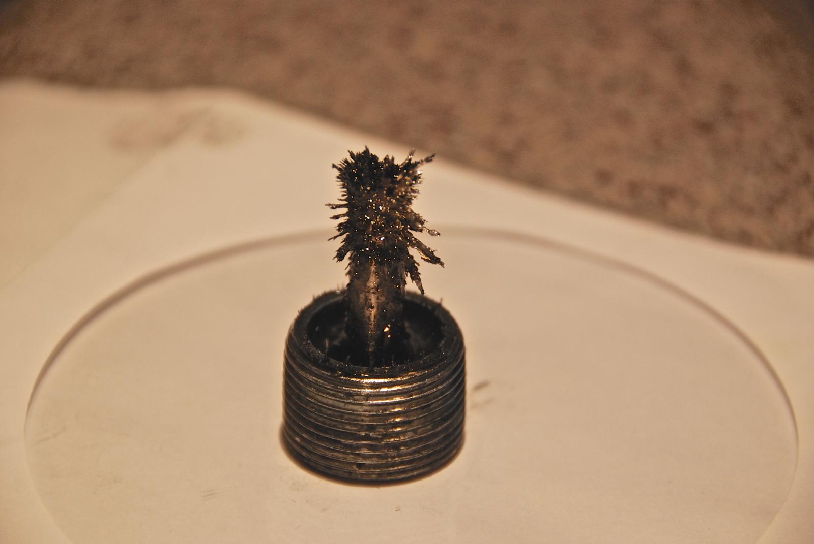

It was suggested I post a pic of my rebuilt transaxle drain plug after first oil change. Apologies for the crappy image. Used my phone camera.
Nothing unusual (only small bits of metal) but then I've only ever looked at two other transaxle drain plugs.
Oil changed at just over 1000 miles.
Neil.

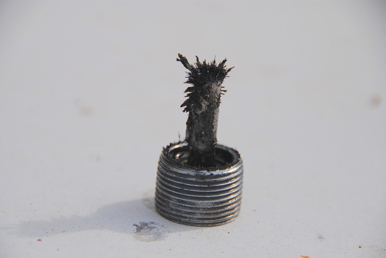

Below is what my tranny oil drain plug looked like after 20k miles using regular spec dino oil. I re-filled it with regular dino oil again. After the 10k mile trip to Alaska this month, I will change again using synthetic.
DK tranny with the 4.57 R&P.
The tranny had all bearings replaced, except the pinion bearing.
I also installed a new 3rd and 4th gear (taller), new reverse gear, all new brass syncro rings, a new 3rd/4th shifting fork, and a new 3rd/4th hub.

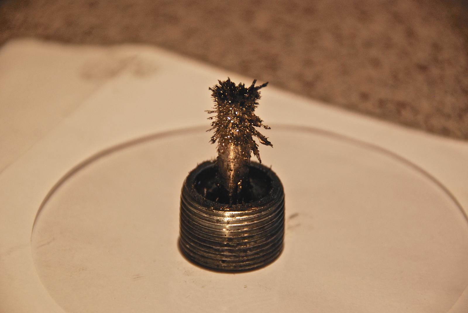

Here are some photos of my transaxle magnet with about 20k miles on the rebuild. The last oil fluid change was at 6000 miles, so this magnet has a little over 13k miles.
This is my yearly or 10k mile gear oil change that I plan to keep records of.
I am a little over my mileage and under my yearly by a couple months.
I rotated the drain plug to get pics of each side. The one side is fairly clean. Possibly when pulling the plug with oil running on it?
I am again running Mobil Delvac 75/90.

remove them to filter paper, flush with a solvent and you will find that the particles are actually quite small in size - they look larger due to magnetism holding them together
the only time to worry is when you find a huge accumulation or some large chunks of metal

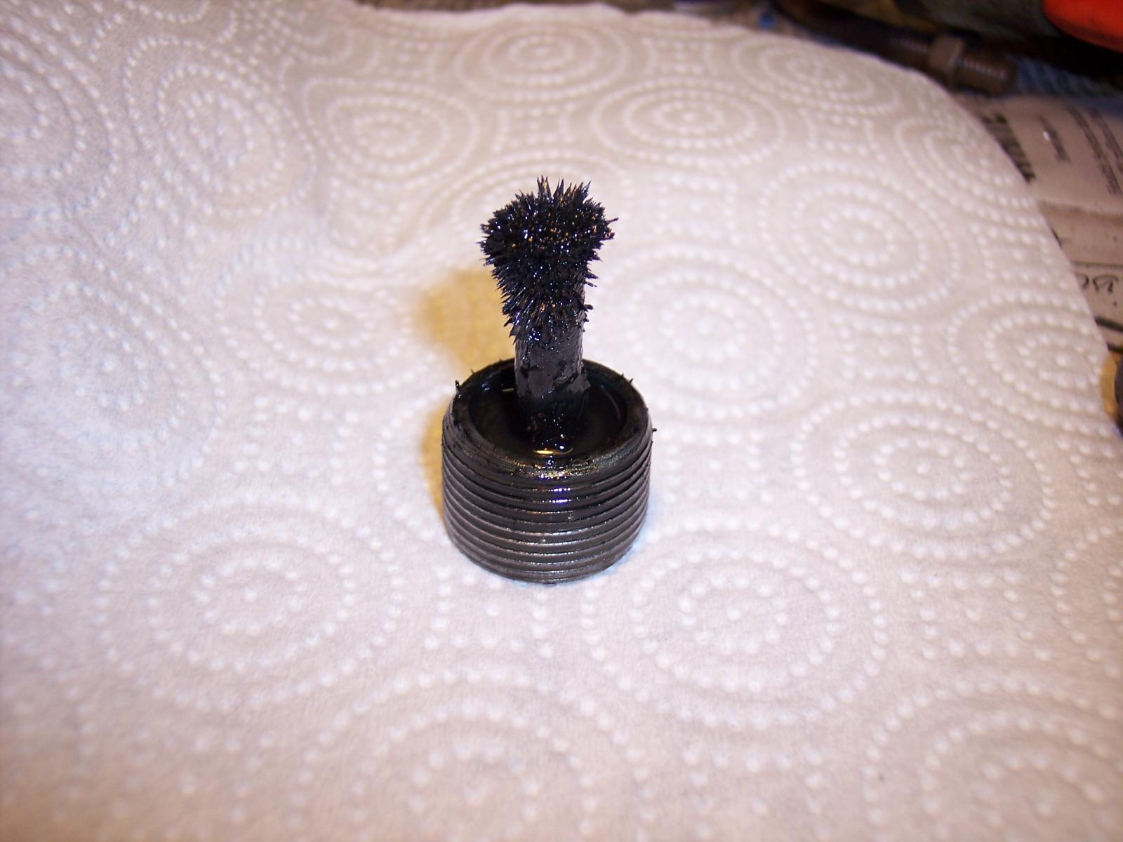

Here's my magnet after 9,000 miles since rebuild. I found that the last rebuilder put in a USED pinion bearing, which nobody would expect to last very long especially with a 173 HP engine. It was worn to have 1/4 INCH of endplay. The amount of steel that rolled off this bearing is probably a strip 6 inches long, 1/2" wide and 1/16" thick. The magnet is MAXED, and displays only a TINY fraction of the metal volume known to be in my oil. It makes me cringe. I had to replace lots of stuff, both shafts, R&P. Here's a link to pics of the USED bearing.
This is a shorter magnetic plug from a Smallcar bellhousing. Also, oil was drained "cold".
I wonder ---- if ALL the drainplugs shown are approaching MAX capacity.

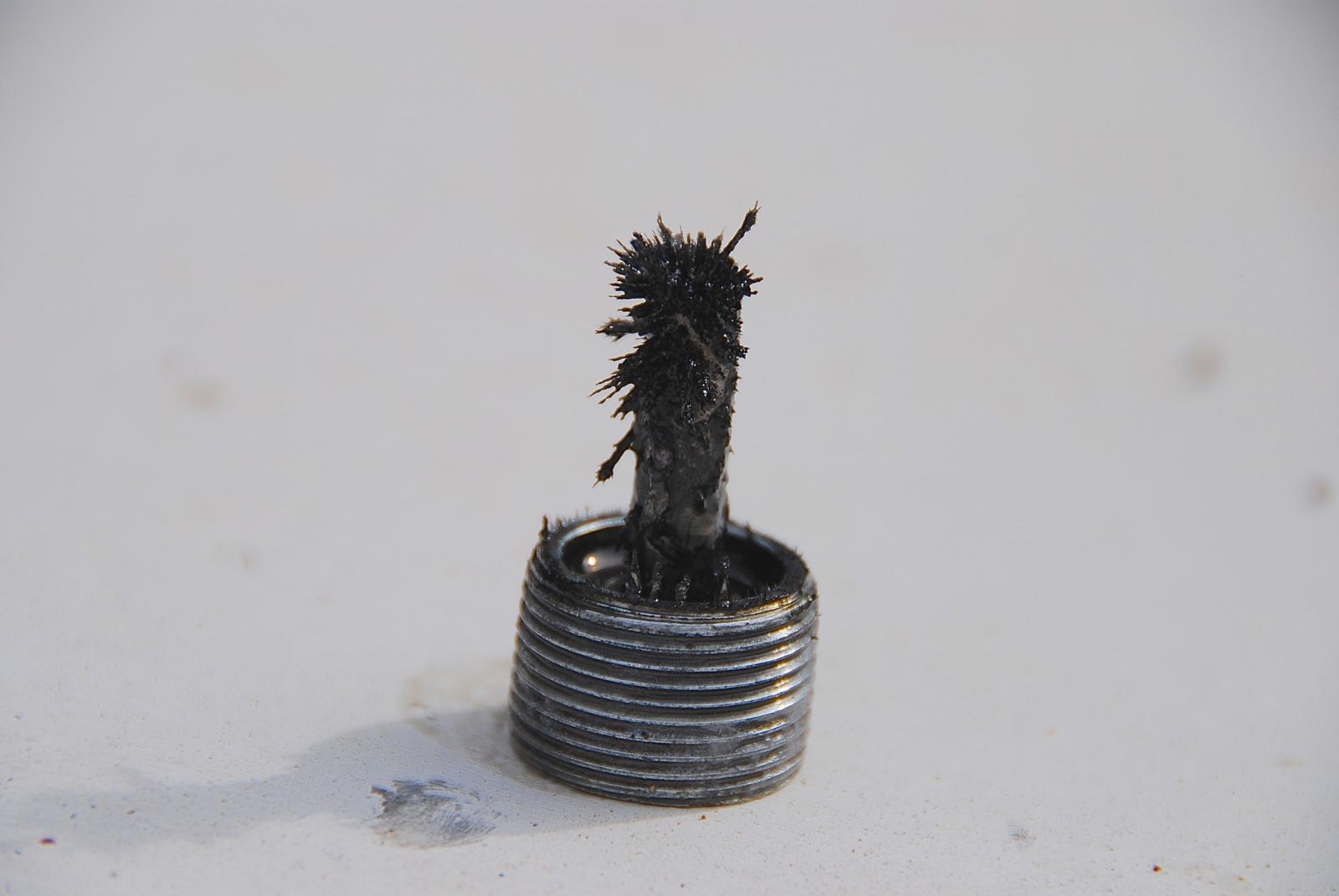

This is the second oil change on my AA rebuild with a peloquin and stock gearing which pushes around a 2wd Westy. The first oil change I ran Valvoline 75w-90 dino oil and replaced it with Valvoline 75w-90 SYN Power full synthetic. During this interval I've tweaked the engine a little bit with a 2200 piston kit from Rocky and a few other minor adjustments which probably net an additional whopping 5hp. I am looking at about 18,000 miles on this change which probably included about 3,000 miles of towing trailers with weights between 500-2,000 pounds. Most of the miles have been with 27x8.5 Grabber AT tires. When travelling on trips which is where all my miles come from we tip the scales between 4,750-5,000 pounds.
In a few of the pictures posted it appears that metal seems to collect on one side of the magnet and in this change mine shows that too.
It looks like minimal wear so I'll probably stretch the next change out a little to a 20k interval. Note to self that will be at 133k Smile

Hate to tellya but that's not really "minimal wear". I can say that any MORE than that would be alarming. It ain't good to be on the cusp of alarming. At your stage of rebuild (a couple changes in) you should be running very very little swarf in 15,000 miles. And very little swarf for the next 60k miles, the trans should be running clean, in it's heyday. Smooth running. If you want to run that oil another 20k miles (for whatever reason) you should at least LOOK at the plug at 5k. If it's clean, then maybe look again at 15k before going onward to 20.
I don't know what the goal is, in saving oil, but it's a false economy. You're far better off dumping the metal out of your trans as often as you can tolerate it. I do understand changing transaxle oil is no fun but its much easier (and cheaper) than yanking out your trans.
These vans are no longer the expendable grocery getter they were the 1st 100k miles. A good used trans no longer "exists" out there, like they did back in the '90s. They are now valuable antiques, and transmission parts are either NLA, perhaps substandard, and skyrocketing in cost.
You're trans is somewhat 'lucky' you gave it a sensible motor.
One thing to keep in mind. TheSamba's general concensus that a fuzzy magnet is "OK" ..... is because everybody's tranny is old, full of 200, 300k mile parts and they are shedding a lot of metal (grenading). Your magnet looking like theirs is not genuine comfort. They need to get that metal out of their trans more often, as it "compounds", makes more metal.
Your 18,000 mile magnet should be clean(er). At least there are no big parts. Maybe thats some of the break-in swarf. If the next check is cleaner, then that's good news.
