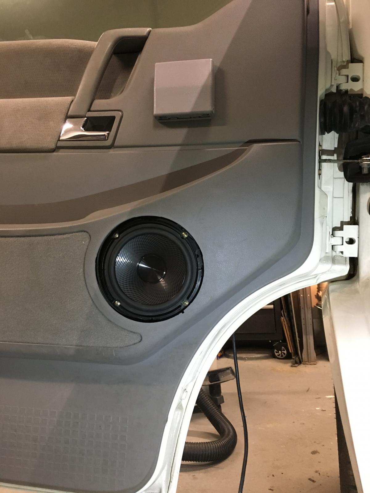

I just installed a SONY XAV-AX100 head unit (see that thread here) and a Kenwood KAC-M3004 amplifier so the next step was speakers.
I am a fan of the Kenwood KFC Pro series components although the 6.5" KFC-P710PS was nearly a 1/4" deeper than a few comparable 6.5" speakers such as the Fosgate and a few other yet Crutchfield said they fit (even with the factory grills) so I went for it and sure as sh!t, they were right, with about 1mm to spare. I used the adapters that came with the speakers which were about .25" thick stacked with a set of Scosche SAC656 speaker adapters.

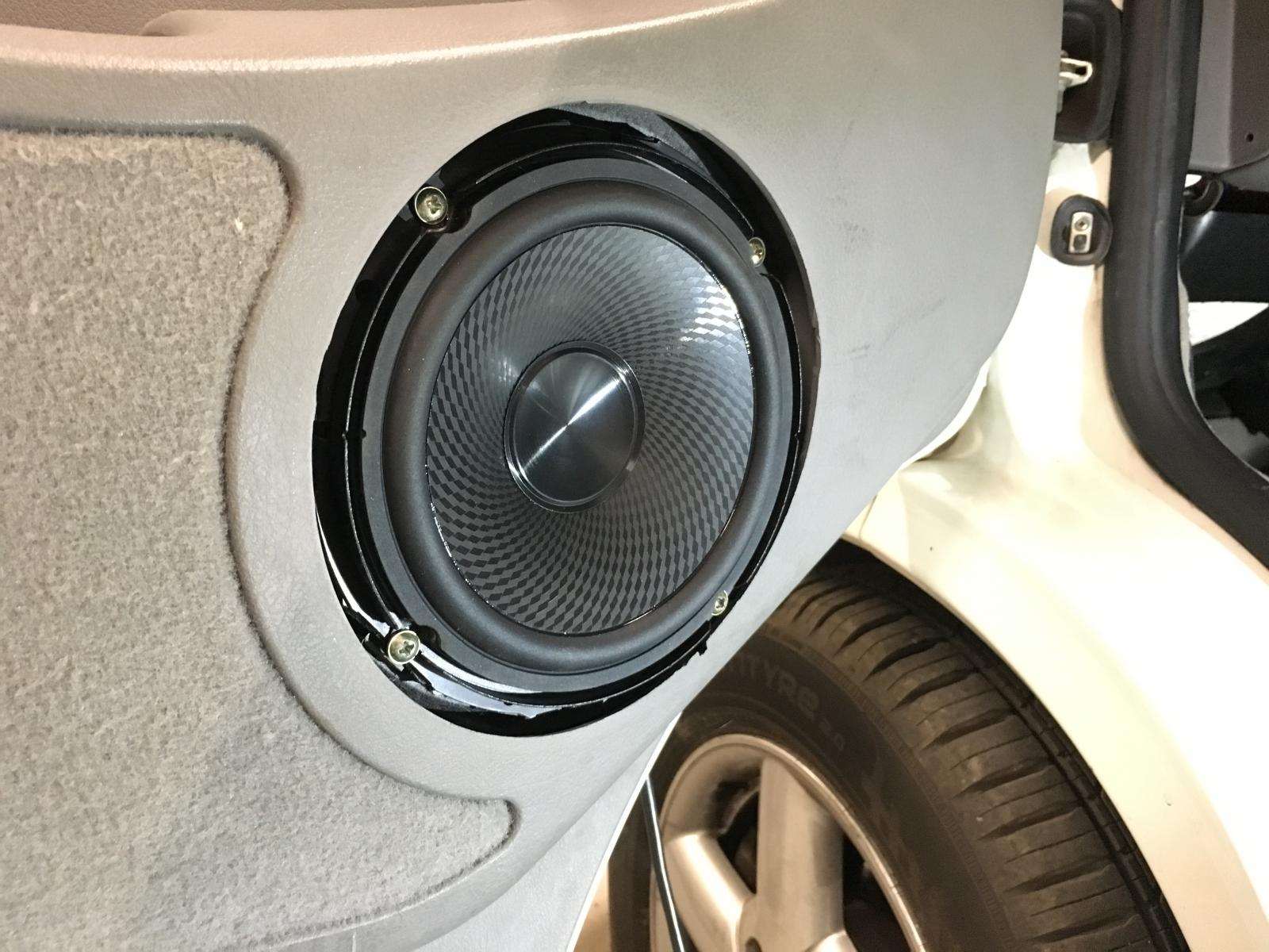

Install was straight forward:
Pop off factory grill ( be careful not to break the retaining tabs)
Unscrew and remove speaker
Cut the factory connector off and splice on tradition speaker spade connectors
Cut the protruding tabs off of the door's speaker mounting surface
Cut all excess plastic off the speaker adapter plates
Stack up adapters and screw it in with factory screws (I installed the schoshe spacer, then the kenwood adapter because the kenwood was a bit smaller diameter and less interference with the factory grill. Also had to file a new locating slot in the door card so I could slightly rotate the factor speaker grill because one of the tabs was lined up with one of the speaker screws.
Replace stock speaker grill
Here's a few pictures:
I haven't installed the tweeters yet since there are some form of mid/tweet in the dash. I'll have to look a bit closer to see what's going on there.
These Kenwood drivers don't have as much mids/highs as the factory speaker although they are tighter and can handle more power without breaking up or farting like the stock speakers.
So next is to figure out what to do with the tweeters and then put some fosgate 4" R14x2 in the rear which takes a fair amount of customizing to the rear speaker housings.

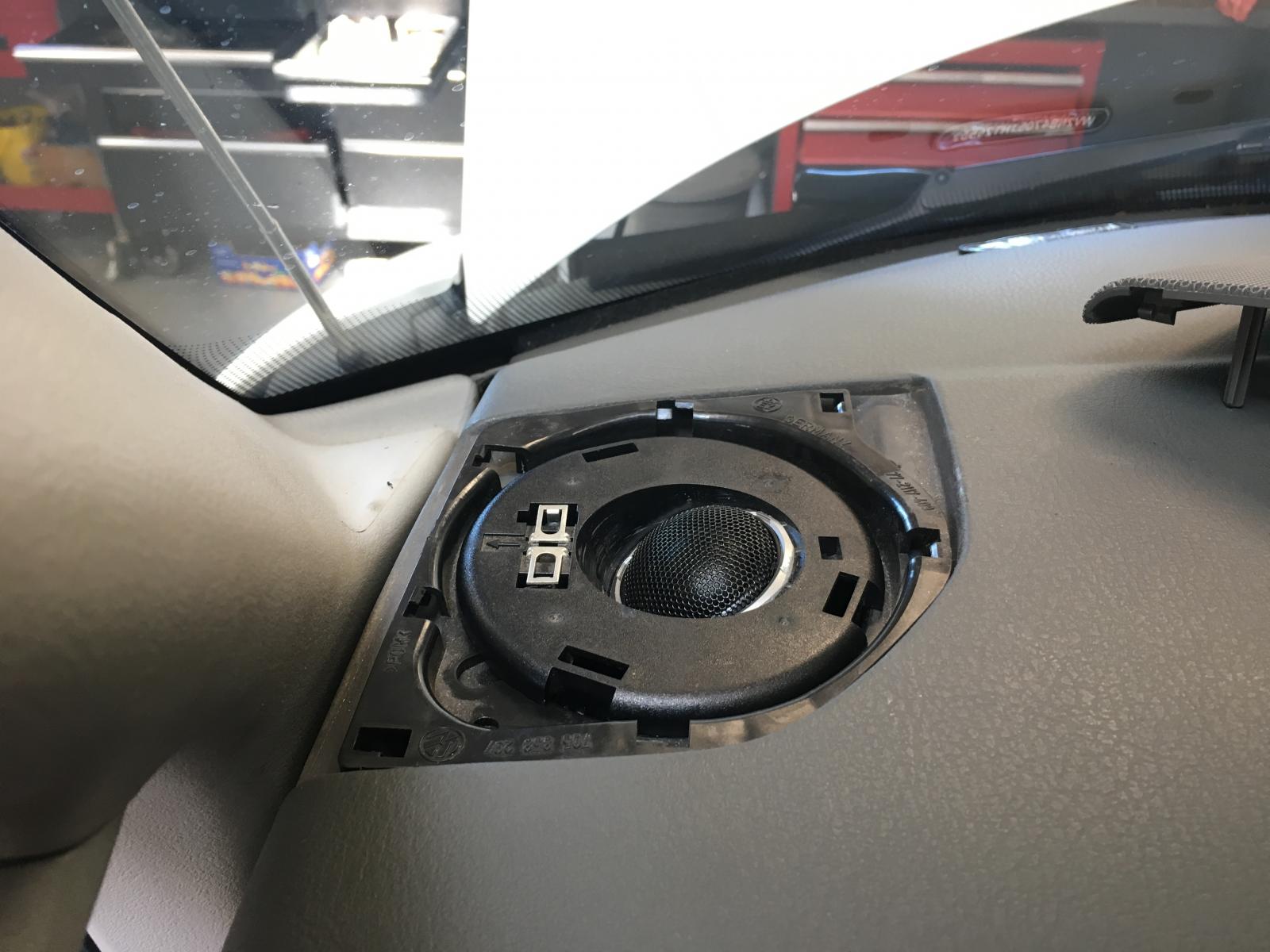

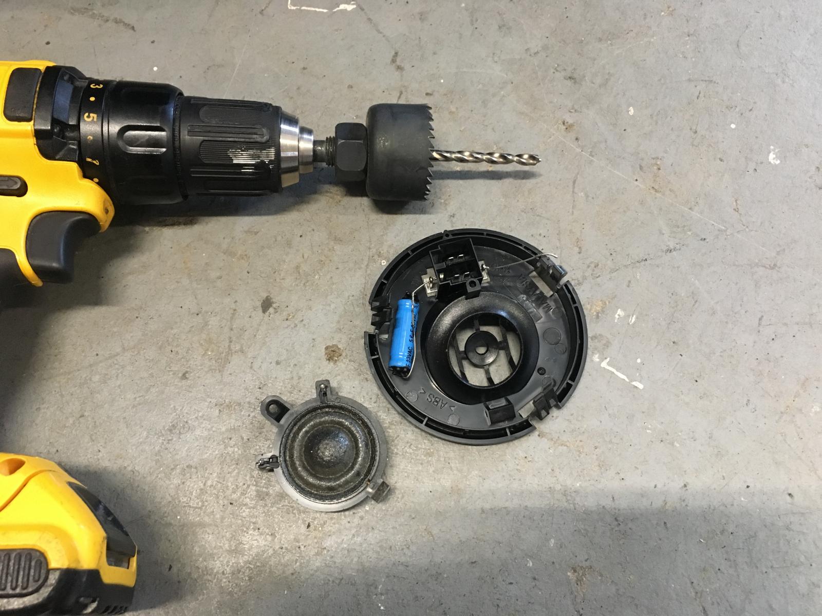

I got around to installing the tweeters that came as part of this Kenwood component kit. I installed them in the dash in place of the stock tweeters and they are much brighter than the stock tweeters.
Here's the how to:
*Gently pry the grill off using a screwdriver
*Pry the speaker chassis out using a screwdriver
*Unplug speaker connectors
*Remove stock tweeter
*Drill out the frame (I think it was 1-7/8") and I had to cut the flange of the tweeter off flush:
*A little hot glue to secure it in place:
*I un-soldered the stock capacitor and connected the Kenwood crossover harness to the poles:
*Put it all back together using the factory plugs/harness
