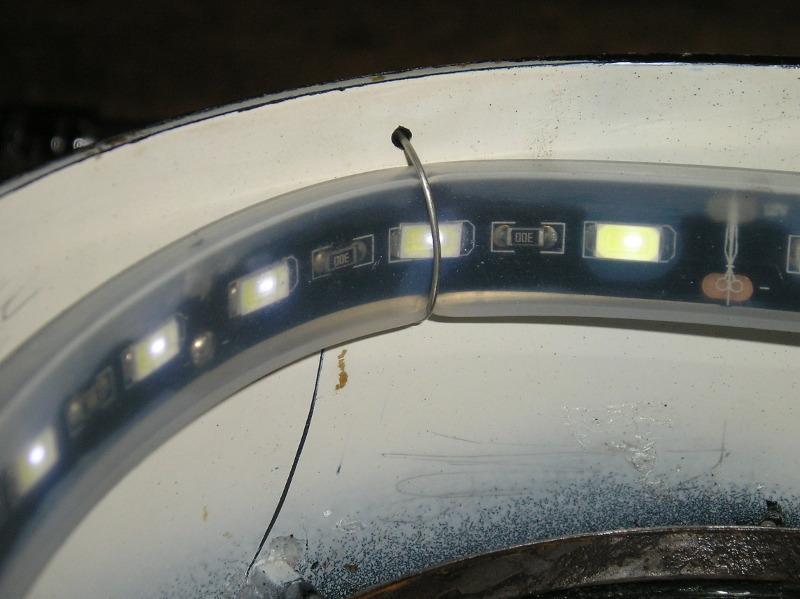

Am working on a LED upgrade for the dash instruments. I used Pilot CZ-3143W flexible LED strips (2 to a package, only 1 needed, Pep Boys, etc.). These are silicone rubber encased 12 inch LED strip lights rated for 12 volts. For testing, a junk instrument cluster (courtesy AeroMech) was modified.
Unlit:
Lit up:
Inside:
Details:
Small holes were drilled into the plastic case, and tie wire was used to secure the LED strip. The strip clears the instruments. A little juggling is needed to get them back into the case.
Am working on a dimmer module which uses the original headlight switch dimmer control as a control input. It's working nicely, so far - adjustable from dark to full brightness. Need to do some packaging and in-the-vehicle testing.

Looks nice telford! I did something similar with my cluster using a strip of red led lights. I suggest putting a little dab of silicone onto the holes where the wires go through to hold your LED strips in place. This will keep out the dust.

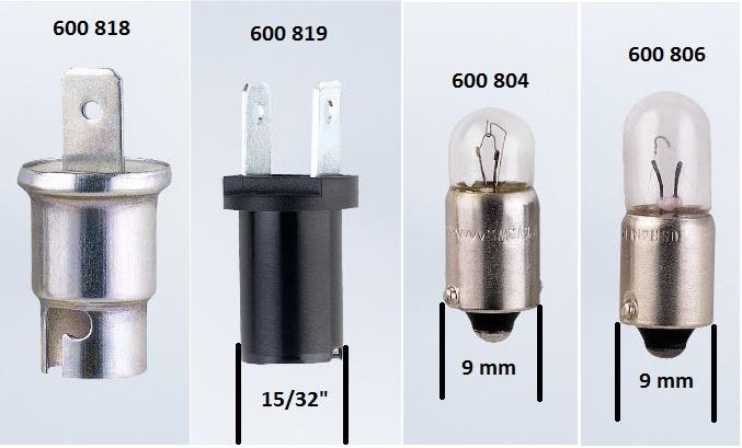

PostPosted: Wed Sep 06, 2017 11:45 am    Post subject: VDO LED Bulb Upgrade Reply with quote
To link to this post copy and paste
Code:
[url=https://www.thesamba.com/vw/forum/viewtopic.php?p=8550630#8550630]VDO LED Bulb Upgrade[/url]
https://www.vdo-instruments.com/accessories/led-bulb-upgrade.html
VDO 600 840 Type E Plastic Bulb Socket
VDO 600 815 Type E Wedge Based Bulb, 12V 3.4W
VDO 600 886 Type E LED Upgrade, White
| White 600 886 |Red 600 878 | Green 600 879 | Blue 600 880 | Amber 600 881 |
LED Cross 158 168 194
VDO 600 818 Type B Steel Bulb Socket 11/32" (9MM) Bulb
VDO 600 819 Type B Plastic Bulb Socket 11/32" (9MM) Bulb 15/32" Socket Base
VDO 600 804 Type B 11/32" (9mm) Metal Base Bulb, 12V, 2W
VDO 600 806 Type B 11/32" (9mm) Metal Base Bulb, 12V, 2W
LED Cross BA9s

As far as the instrument panel goes, I have a few comments...
1) If you change the indicator lamps to LED.. after a few night drives, you'll really regret it. They are uncomfortably bright. I'm talking specifically about the high beam lamp and both blinkers.
2) the ambient lighting in the cluster itself is a great LED upgrade, with flexible LED strips. You get much better illumination. However, the stock dimmer rheostat may not work well with LEDs, so adding a PWM controller is a good standby option.
3) you will get uneven illumination of the gauges if you wrap the LED tape around the inner oval area. The outside edges are all illuminated directly, but the inside edges only get whatever ambient light is bouncing around the cluster. There is a noticeable light falloff.
I put a center strip on the metal backing plate but it is an imperfect solution:
