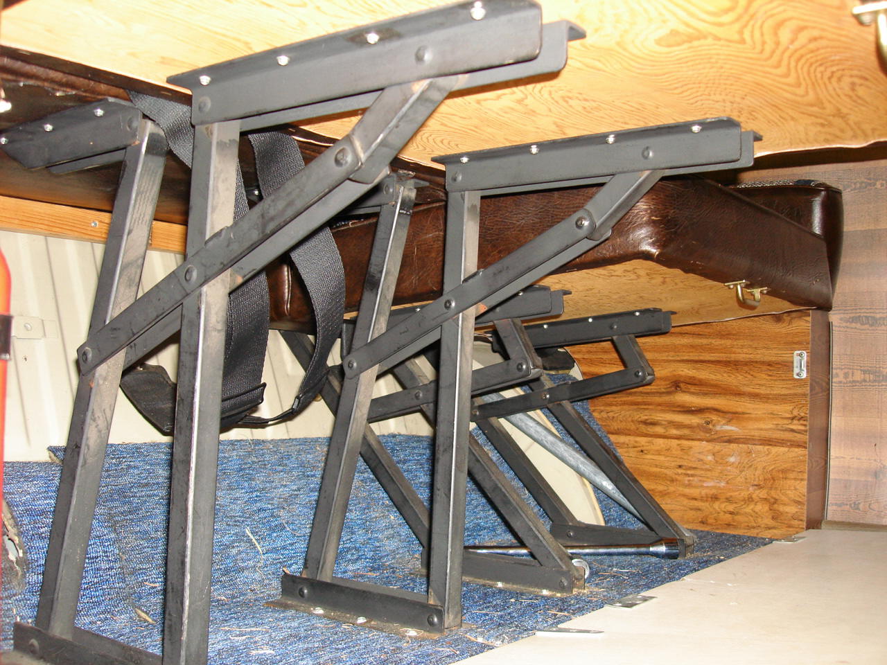

One of the potential changes is to make the bed slightly larger (and more rectangular). We are toying with the idea of a split middle bench seat. I am looking for a little information on this type of seat - specifically the hinge mechanisms. I have seen it on Riviera's but I cannot find any real information on this setup.
Here is a photo of what we are thinking - borrowed from the Gallery (thanks Tcash)
I am hoping that someone can point me in the proper direction. Mostly, does this need 4 hinges? If we have to have a set of hinges that bisect the storage area below, it may be a deal breaker for this idea.

to have a dual split rear bed/bench yes you would need 4 of the seat brackets.
and that will use up any usable under seat storage..
https://www.thesamba.com/vw/forum/viewtopic.php?p=4650724
danfromsyr wrote:
images from the gallery searched = Zbed
this is a split design, that I don't favoe but ASI offered for some.
Traditional spacing
Search =Riviera Bed
and finally showing the wood backing on the trans hump (in a Bay, but you should get the idea)
Again in a Bay, but same idea.. they use 4 to hold more weight on the bed w/o bending/breaking the base board while owner steps/sits weight on it.

Andrew, I have this couch/futon thing. It has hinges that might work for your application. When you pull the back part of the futon forward it releases the latch to fold flat into a bed. Pull the back up again and it's locks up to form the couch. If Interested I can email you some pics. Or shoot me your phone # again and I'll send you a video. This thing was a temporary bed and was only $170 at Walmart. You could cut one up and modify to work as you'd like. Then recover with material. There probably similar futon setups you could modify as well
Found it.
https://www.walmart.com/ip/Mainstays-Morgan-Faux-L...isitor_id=

it is not a Z-bed. This is a Z-bed. It converts a standard rear bus seat to a bed. The other ones are sometimes called that but they are not. Kind of like the difference between a purebred dog and a pooch. They are both loveable and family pets, but only one comes with AKC papers.
https://www.thesamba.com/vw/classifieds/detail.php?id=2100259

Xevin - I think you r concept is good - but I would worry too much about safety in that sort of retrofit. Especially since we'd have to add something to allow the seat to slide forward to make it into a bed. After all - this is my daughter we're talking about.
SGKent - The hinges we currently have are rock and roll hinges... not that we couldn't replace those with something else.
Having just a wider bed without a divided back is not necessarily a bad thing. We just want to explore all the options.

What about something like two cut down westy beds right next to each other? Then you could end up with two smaller boxes side by side underneath.
Those hinges are just screwed to sheets of plywood, so no reason you couldn't do something like that.
