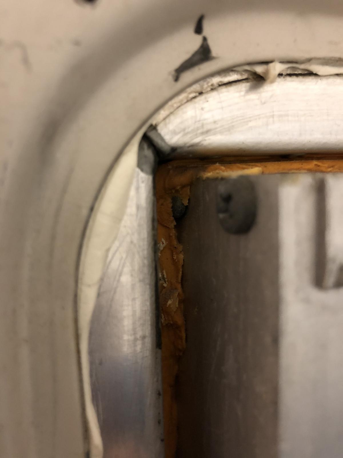

Currently I‘m trying to remove my Hehr windows. I got all out beside of one. This one was glued into the frame (yellow glue, soft).
Also all the frames were glued in with some other stuff (white glue, quite hard).
Direct force was not working Razz. Next up is 1) a heat gun or 2) some nitro thinner or 3) a freezing spray. If someone had a similar issue or knows the stuff, I‘m open to helpful tips of cause Smile.

PostPosted: Fri Jan 19, 2018 7:09 pm    Post subject: Re: Swiss cheese - 1967 westy Reply with quote
Somebody really wanted those to stay in. Smile
The correct stuff used to seal them was called 'dum dum' and is now called 'Mortite' at Home Depot:
http://www.homedepot.com/p/Frost-King-E-O-90-ft-Grey-Weather-Strip-and-Caulking-Cord-B2/100152937
The Jalousie thread is a weath of info on everything jalousie:
https://www.thesamba.com/vw/forum/viewtopic.php?p=7709073&highlight=dum+dum#7709073
Heat gun would be my first tool of choice. Take your time, be patient, don't force anything.

Also all the frames were glued in with some other stuff (white glue, quite hard)....If someone had a similar issue or knows the stuff, I‘m open to helpful tips of cause Smile.
Barf. It looks like latex caulking. That stuff is a pain to get free. Doesn't look like a razor knife can get in there but maybe a hand held stiff-back razor blade or try to pound on a stiff-back razor all around by hitting it with a little hammer and a small hardwood block.

It is time to do an anthem on my newly bought heat gun. That was my favorite tool in the past weeks Smile. I bought the Bosch PHG 630, which has three airflow stages and variable temperature setting from 50 - 630°C (around 1166 F). It was the solution for most of my problems and helped me removing the window frames. I normally don't do marketing for a product nor am I working for them, but I'm really happy with it.
This is me (not anonymous anymore *shock*) happy posing with the first frame out. It took me about an hour for the first, but I was getting faster Smile
With the help of the heat gun, I could remove all camper window frames and the last window which was stuck completely. It also helped my getting the window seals soft to remove the front, rear and the one stationary side glass. Another issue it helped with, was the passenger side door remote lock screw. I did soak it in penetration oil and used an impact screwdriver, but it won't move. Well, my heat gun did the job. The paint is now brown around the screw, but as I will paint it new anyway, I don't bother.

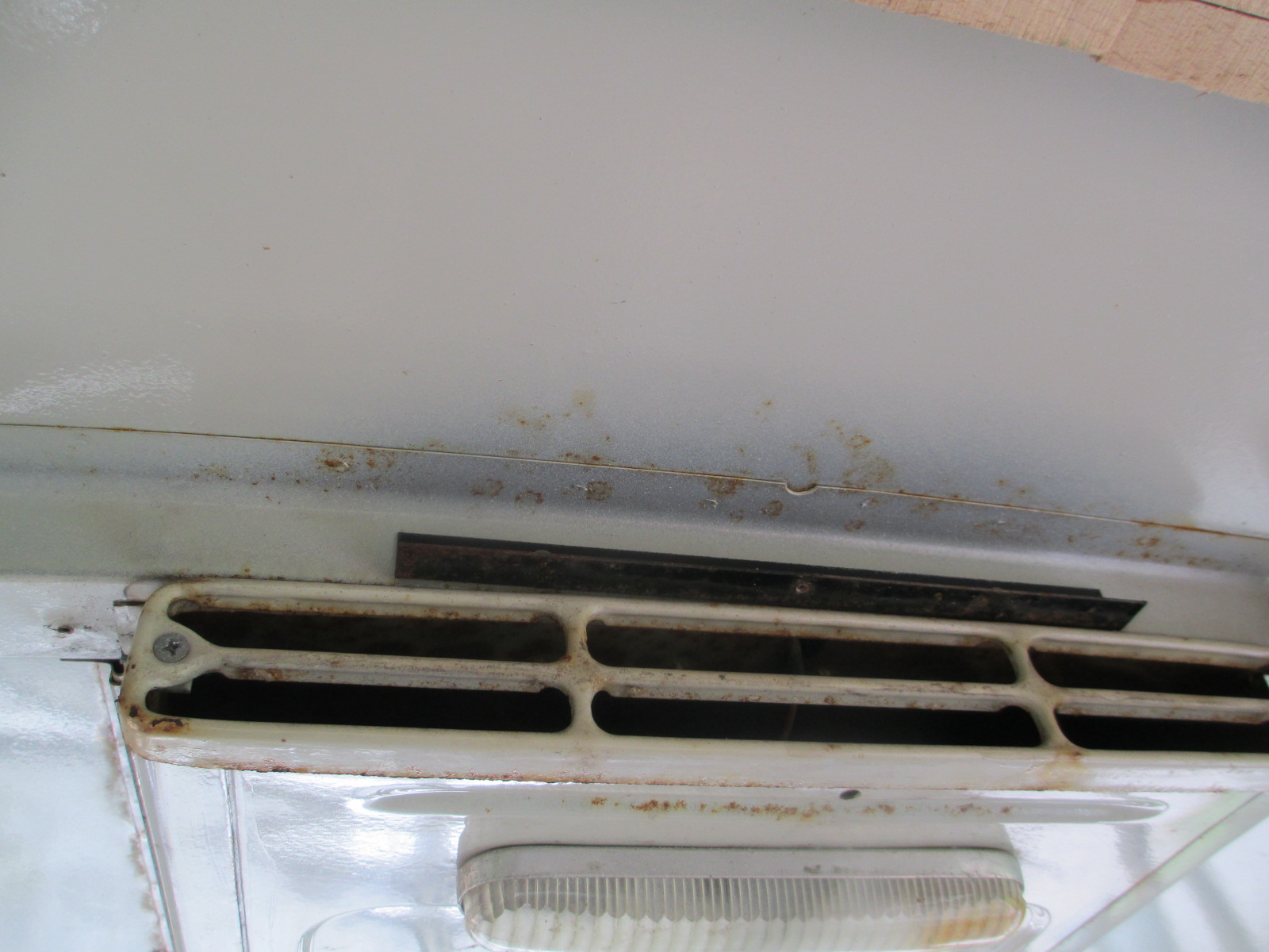

I did remove the wood roof support for the poptop. Mine was held in place by the screws which goes down from the metal springs of the poptop. Which I think it is the correct way. It had only 3 screws each side, but there is a place for a 4th. Was this used normally?
I wasn‘t able to remove the wood support, until I figured out, there are more screws. This is the moment I realized, someone in the past did a massive bondo job here. The carves done by my wire wheel are only through the layers of bondo/paint to find the additional screws. I think they are wrong?
You can see the red through the carves and that must be the original paint. I‘m so happy, that I was able to buy an original touch-up paint stick with liquid in it. Now, I can ask the painter for a perfect match!
Last, but not least, there is a metal support riveted to the fresh airbox. I didn‘t see it in the SO42 manuals. Does somebody know, if this was an addition from the factory to hold the wood panel in place?

I don't remember seeing that when I re did the roof in my '65 SO42. There should be a wood bow but not that close to the air box.

I did some research and another previous 67 owner has confirmed he had this part too. It supports the roof panels.
I found an old thread (https://www.thesamba.com/vw/forum/viewtopic.php?t=146337), where it is pictured as well:
What I don't understand yet. In the partslist for SO-42 there is mentioned, that another woodbow is on the roof (number 4). I don't have it, but I also do not know, where there could be any place for it...

The small bracket above the air box is correct, may be a later poptop addon piece to help secure roof panel. Also seen here:
I don't believe these other screws are original, probably added to secure bows if original screws broke off in wood.
