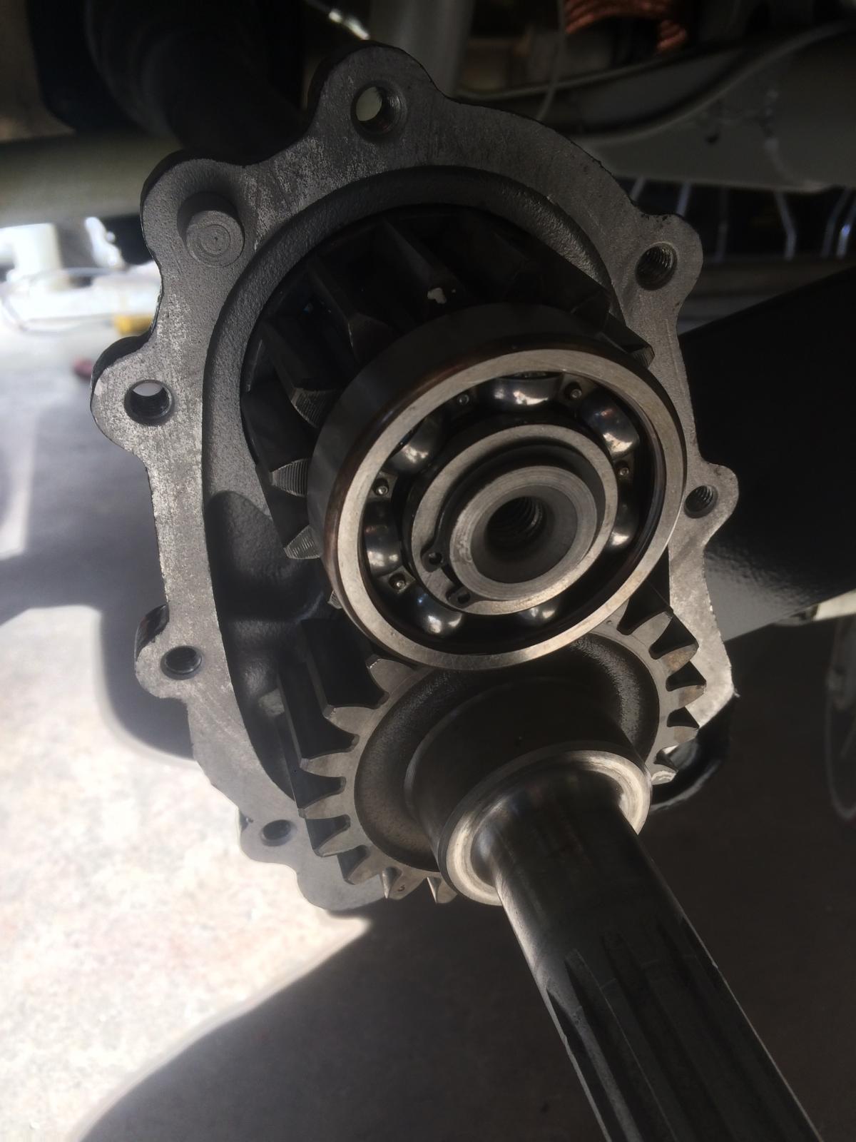

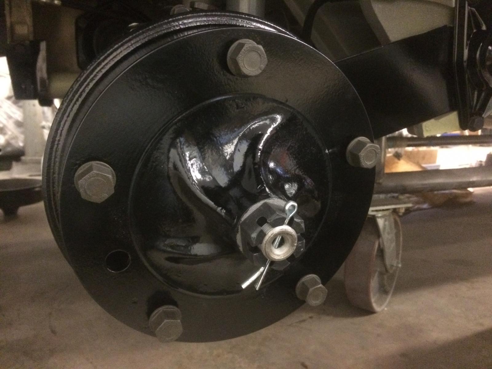

Time to finish off the reduction boxes.
I had collected a full set of NOS reduction box bearings - FAG - all marked "Germany" on the bearings themselves - not sure it matters in the big picture but whatever.
Bearing puller tool.

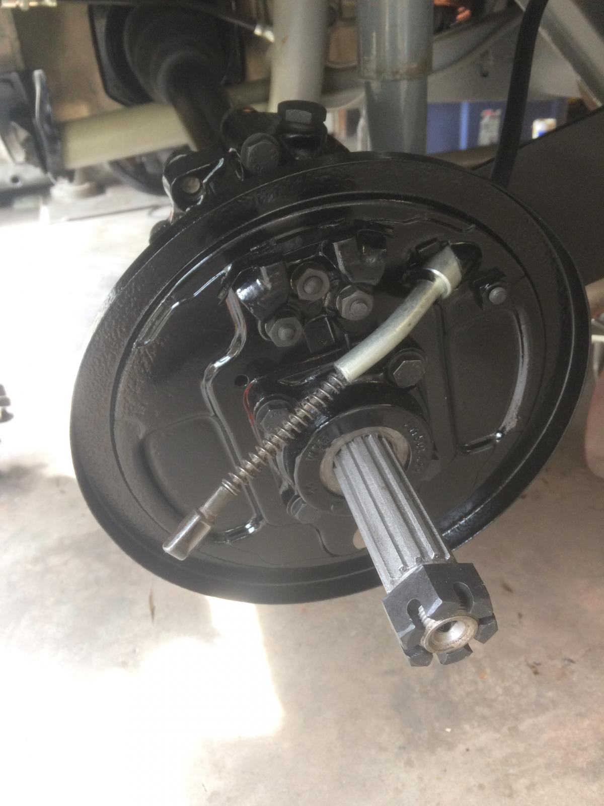

Backing plates & axle seals.
I decided to leave the shocks factory paint. These are NOS rears dated 3/62.
I also torqued down the reduction box bolts and the rear cradle bolts.

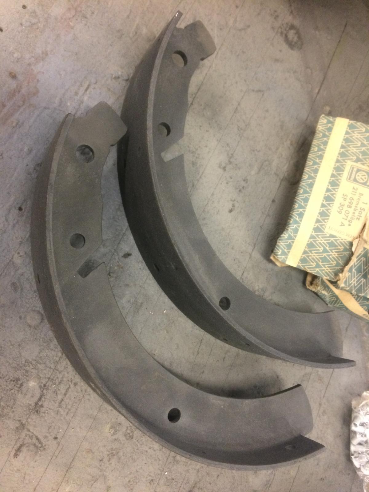

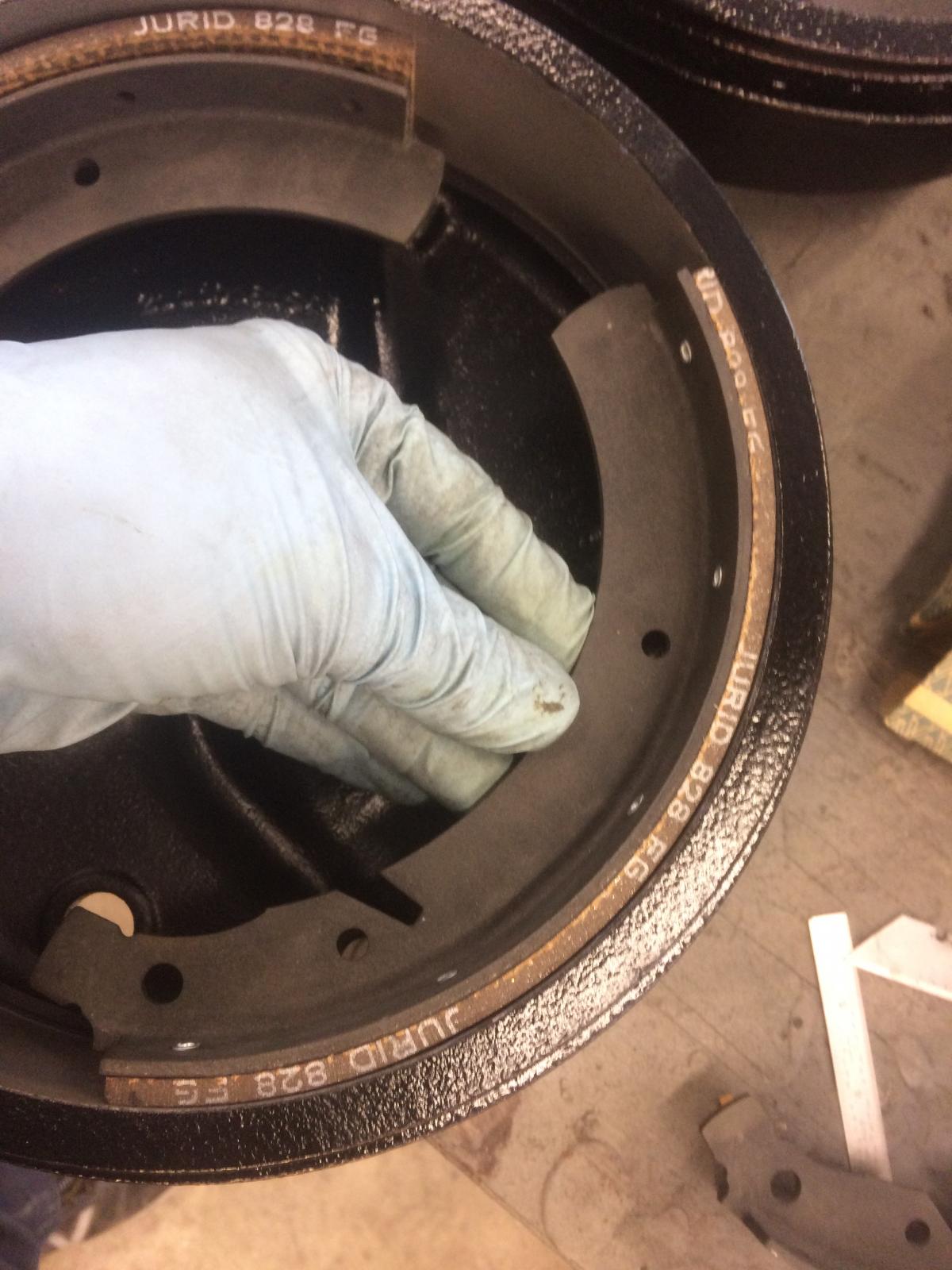

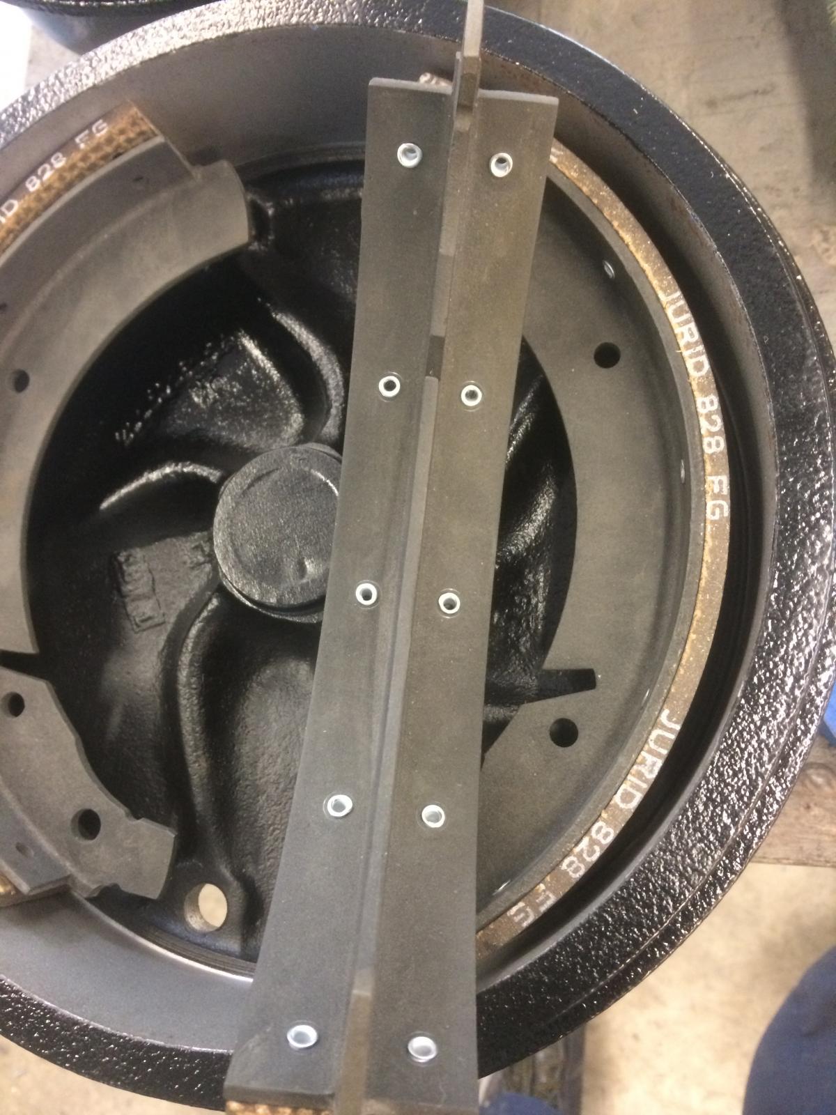

On to the brakes - I picked up these "oversized" shoes from the VW parts museum in Germany 2003 and figured it would be nice to use them on this project.
I have never riveted brake shoes on before so if someone notices an issue they think might be unsafe feel free to post it up. The process seems pretty straight forward - the shoes came with the rivets. The rivets are steel but they are easy to install. I modified an old arbor press and a punch die. Seemed to work fine.
They seem to fit the drums well, which were also turned.
I probably should put on a mask and chamfer the ends before I install them.

PostPosted: Wed Mar 14, 2018 6:56 pm    Post subject: Re: Yellow & Tan '56 Subhatch Westy - 20-147419 Reply with quote
Looks totally factory to me even like you arced the shoes to match.

The workshop manual says to use oversized shoes when you turn it to the first cut. It seems like they line up pretty nicely with the drums.

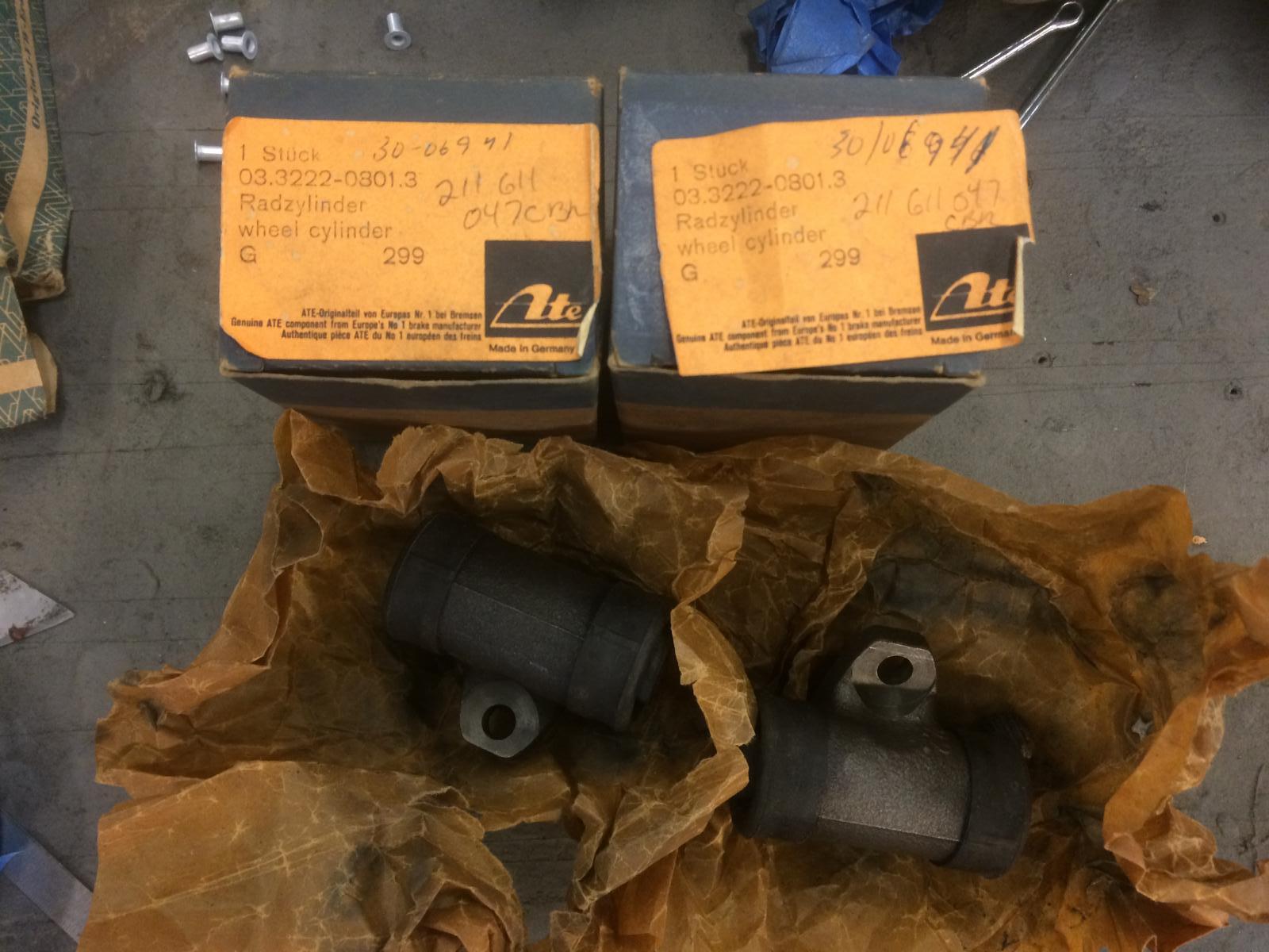

New German wheel cylinders:
I knocked them apart and cleaned them out and regreased them.
They went back together a little easier than I'm used to, but I've never used that grease before. Hopefully they seal up nice and last a long time.
One side is done.
29 part # lug bolts.
If this is what i think it is, ATE blue brake paste, then they should be just fine. The VW guys i trusted 30 years ago swore by it.

Just as a side note, the brake pads you are using do have asbestos. In my bus I also wanted to use rivets and was strongly discouraged to do so as highly unsafe.
Are these split case specific lug bolts?
Oil Capital Air Cooled
55 Wolfsburg Kombi
60 Walkthrough Kombi
62 Single Cab
66 21window
67 so42
76 Westy
64 Karmann Ghia
derRHDmeister
Joined: June 22, 2004
Posts: 569
Location: worldwide
derRHDmeister is offline
PostPosted: Thu Mar 15, 2018 6:21 am    Post subject: Re: Yellow & Tan '56 Subhatch Westy - 20-147419 Reply with quote
Okie Adam wrote:
#29 signifies barndooor/wolfsburg production line (pre 55)
Ask not what your bus can do for you, but ask what you can do for your bus.
unclespanky wrote:

PostPosted: Thu Mar 15, 2018 6:25 am    Post subject: Re: Yellow & Tan '56 Subhatch Westy - 20-147419 Reply with quote
derRHDmeister wrote:
Okie Adam wrote:
As soon as I read your response it made perfect sense. I knew I'd heard of 29 part numbers before!

PostPosted: Thu Mar 15, 2018 6:39 am    Post subject: Re: Yellow & Tan '56 Subhatch Westy - 20-147419 Reply with quote
perello wrote:
As usual in Greg you are doing a fantastic resto!
Thanks!
Why did your guy feel riveted brake shoes were unsafe?
I would trust 10 mechanical fasteners over any type of glue any day.
I think the advantage of bonded shoes over riveted shoes is that they are faster to install and you can make use of the entire pad thickness before you experience any metal on metal contact.
I've heard that riveted shoes dissipate heat better, wonder if it's true?
I can't count the number of times I've seen where a bonded shoe has failed when I've needed to pull the drum on a bus which has sat out in the woods for a number of years.
I wonder if the old asbestos linings will stop better than the low carb version you can buy today from various parts suppliers?
campingbox Premium Member
Joined: November 14, 2000
Posts: 10252
Location: Petaluma, CA
campingbox is offline
PostPosted: Thu Mar 15, 2018 6:46 am    Post subject: Re: Yellow & Tan '56 Subhatch Westy - 20-147419 Reply with quote
Okie Adam wrote:
I'm not sure how late those lug bolts went. I think they might have been fazed out around the end of '55. I don't think they made it to the end of the Wolfsburg run.
There was a very low km (8000 km's?) neon green singlecab found in Canada a few years back which was dated 1/56 and had a full set of 29 lug bolts. Our 1/56 bus had 10 of them on the front too. I've seen a number of similar date buses with the flat lug bolts with only a vw logo on it. Easy item to change, but an 8000 km singlecab painted lime green with matching lime green lug bolts was enough to convince me.

I have a set of those Jurid (cough cough Smile asbestos brakes but have no stell rivets. If you have any spares could you please post up what they look like or some measurements?
Many thanks!
