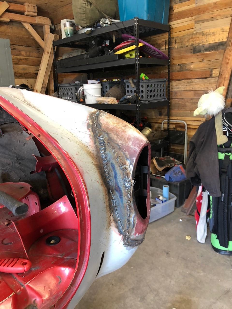

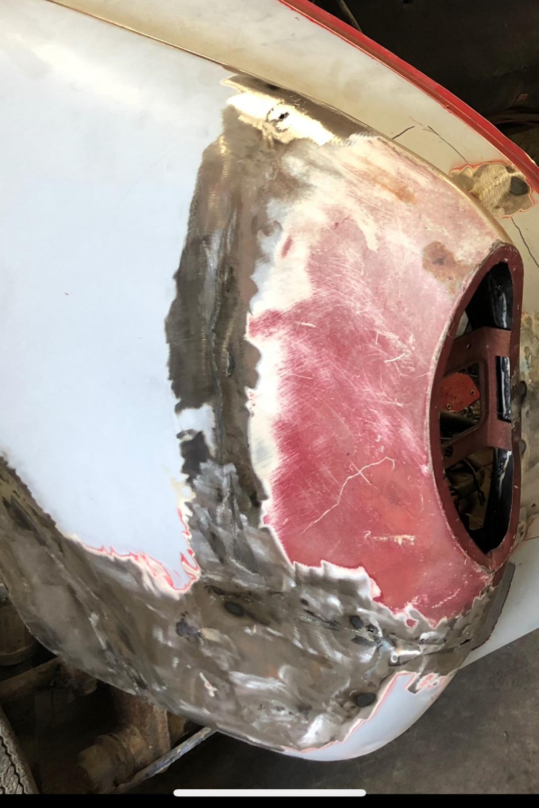

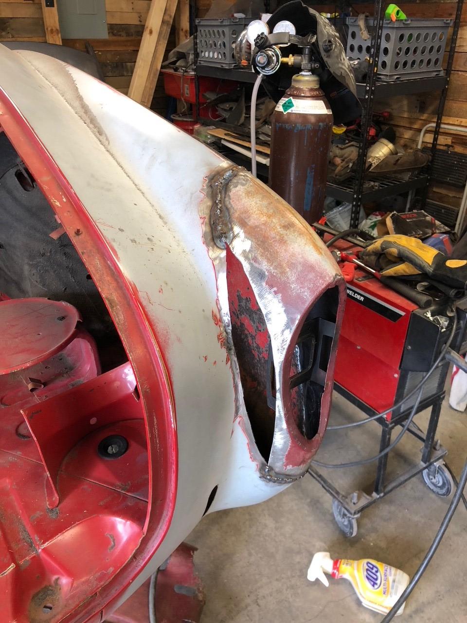

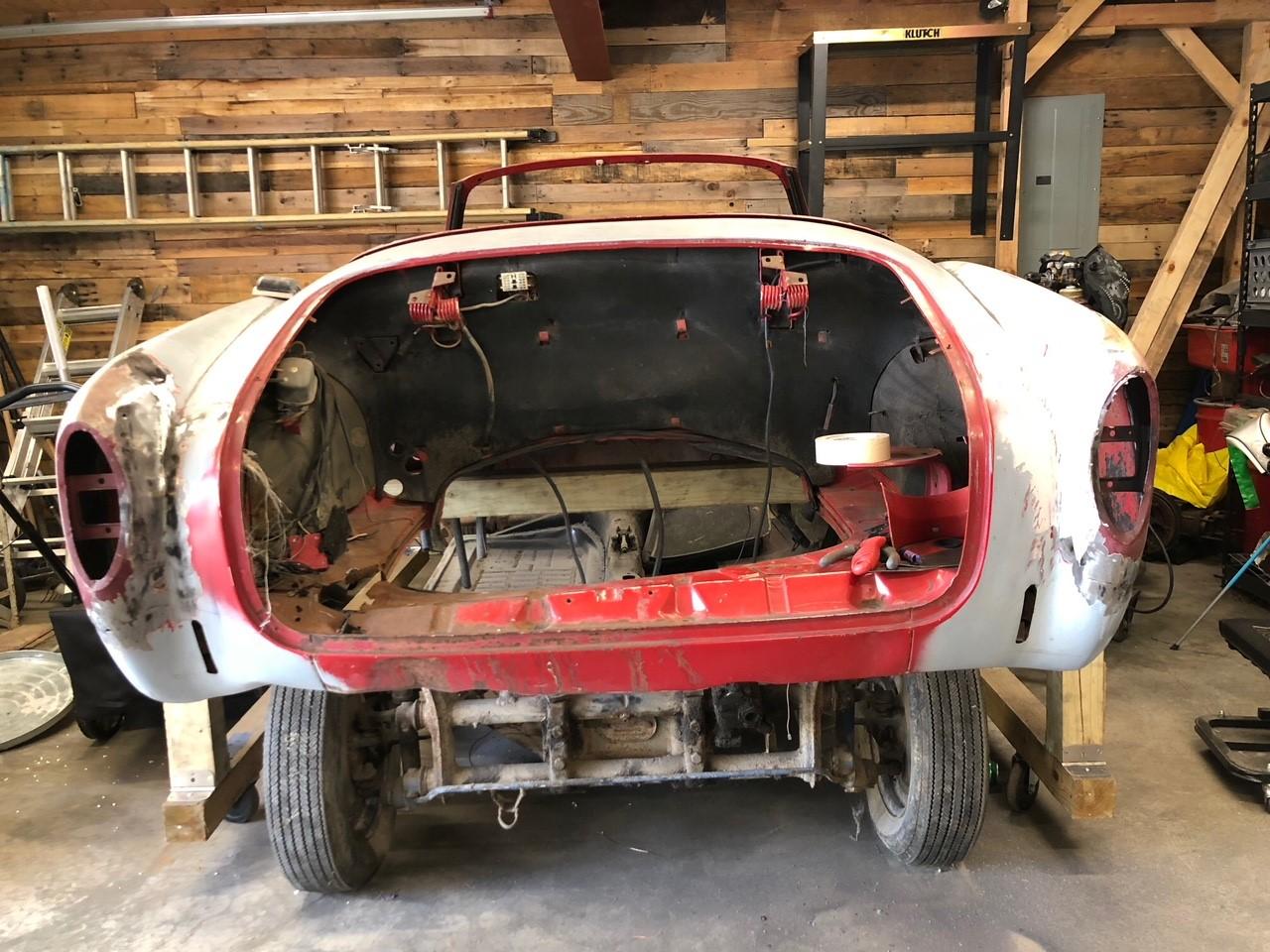

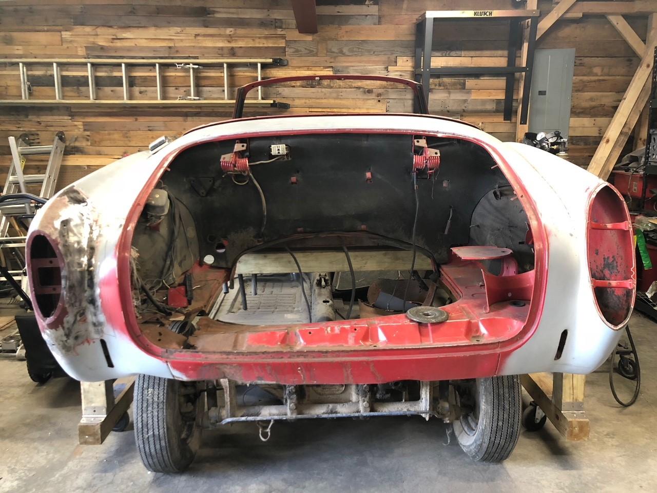

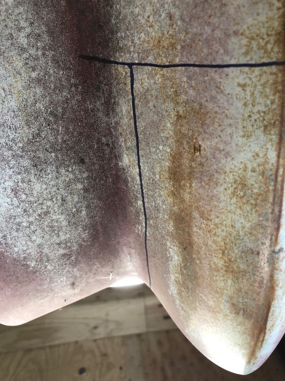

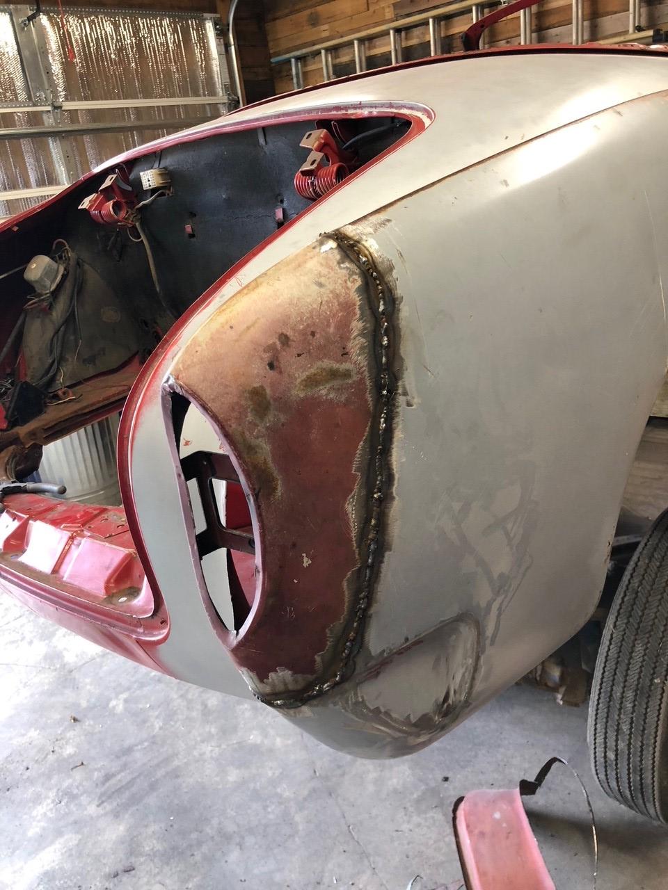

I couldn't find a detailed how to guide when I did my tail light conversion on my 72, so I wanted to provide a step by step write up. Overall, it wasn't a difficult process, but it can be nerve wracking cutting up a "perfectly good" fender. I figured this post would help others not feel so anxious about doing it. It took me about 3 hours per side (not including filler and body work). You can probably get it done in less time if you are better at panel fitting and welding than I am (not hard to be better than I am Very Happy ).

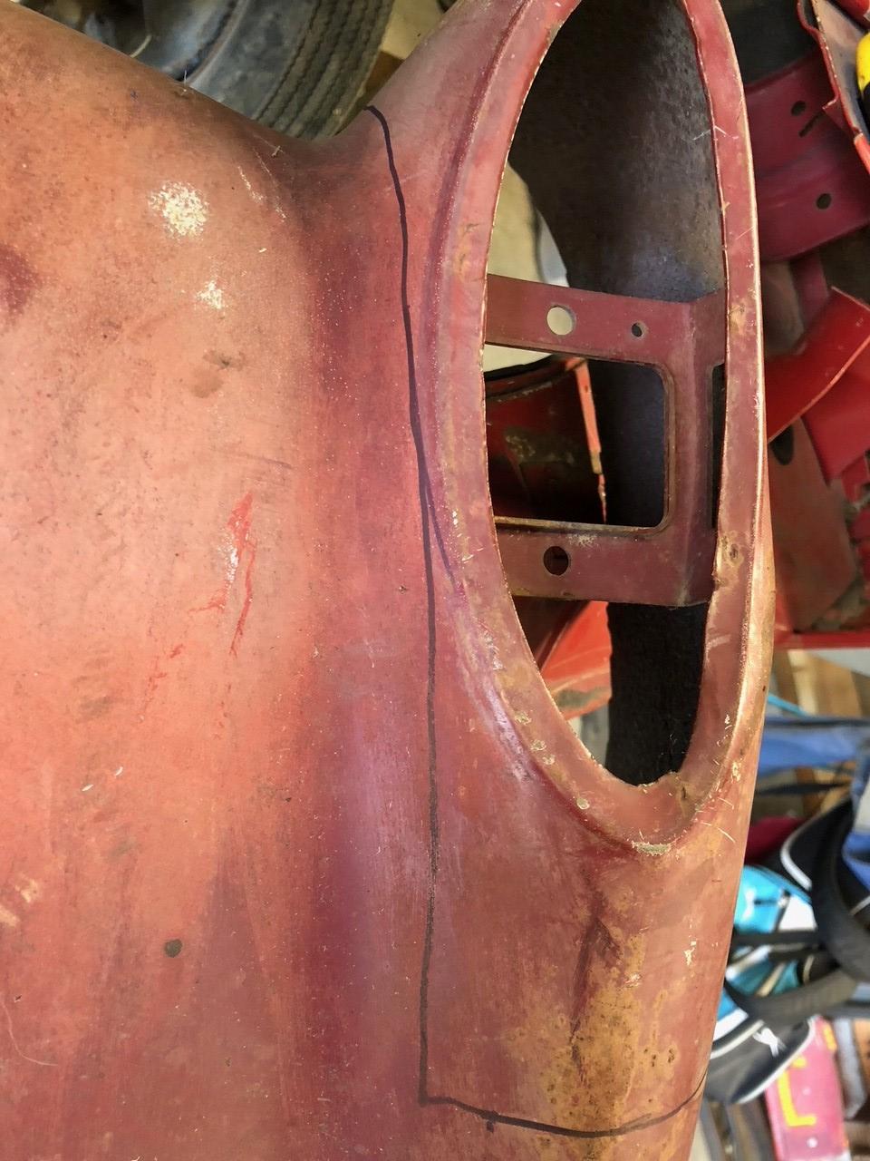

One of the first things to note is that the curve from the tail light to the engine compartment is different on later cars, so I had to be careful to cut out the entire transition.
Since you now need to maintain the stock transition area, make sure you cut out as little as possible from the old tail light.
From here, test fit your new piece and put a level across the vertical points. Mark on the fender where the level point is.
Cut the fender, test fit again, weld in place.
Now make a patch panel for the inside section.
Finished!

I just used where the fender and the bottom of the tail light section meet as a reference point. It pivots from here when you test fit to get it level.
Circled here.

It would appear that to conform to the later model fender structure that the new hybrid tail light protrudes rearward another 1"-2", that's really gonna screw with folks later on.
Are you going to fill the bumper reliefs?

PostPosted: Wed Aug 01, 2018 4:00 pm    Post subject: Re: How to: Tail Light Conversion - Late to Early Reply with quote
I filled the bumper refliefs, not the best pic but you get the idea.

The artwork on the bus in the background of pic 1, Now that looks awesome. Very Happy
