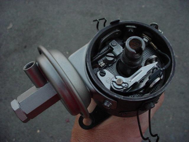

Hey there everybody! Since I have referred to these distributors off and on, and want to avoid pulling other threads off topic posting details regarding their use, I figured it was time to make a reference thread for those of us that have had success using them on our engines. I plan for this to be a general reference thread of sorts regarding currently available parts, and some easy modifications.
Previous threads for reference-
https://www.thesamba.com/vw//forum/viewtopic.php?p=8381132
https://www.thesamba.com/vw/forum/viewtopic.php?t=678638
This is meant to be a general primer for the everyday guy that may not have ever done much more than static-time a Chinese 009, so bear with me if it's a bit too basic for some Smile
The original application was for 36HP Type 1 engines, and was paired to the 28PCI carb, starting August of 1954. Seeing as this is a very versatile distributor, this will be a series of posts outlining some details regarding their use. I find that they work very well in place of other SVDA types of distributors, and I have successfully used them with ICTs, Kadrons, IDFs, and even the 34PICT-3. The preload is adjustable on the vacuum can, so it can (to an extent) be dialed in to work well with many different setups. It may not be a good choice on engines with very lopey cams, but since I've only ever gone fairly conservative with my builds, I'll go ahead and say that it is a good choice on a mild performance engine. The mechanical advance is the nearly identical to the "019" distributor, so if a 019 works well for you, and your carbs have the necessary port for vacuum advance, this may be a nice way to gain additional MPG and performance. More will be said about the details of the advance curve in a later post.
This will be the first post of several.
Tune-up Parts
To strart with, we'll go into tune-up parts. A more thorough list of parts is in the following document- https://www.thesamba.com/vw/archives/manuals/Bosch_Tune_Up_Parts/Bosch_Tune_Up_Parts.pdf

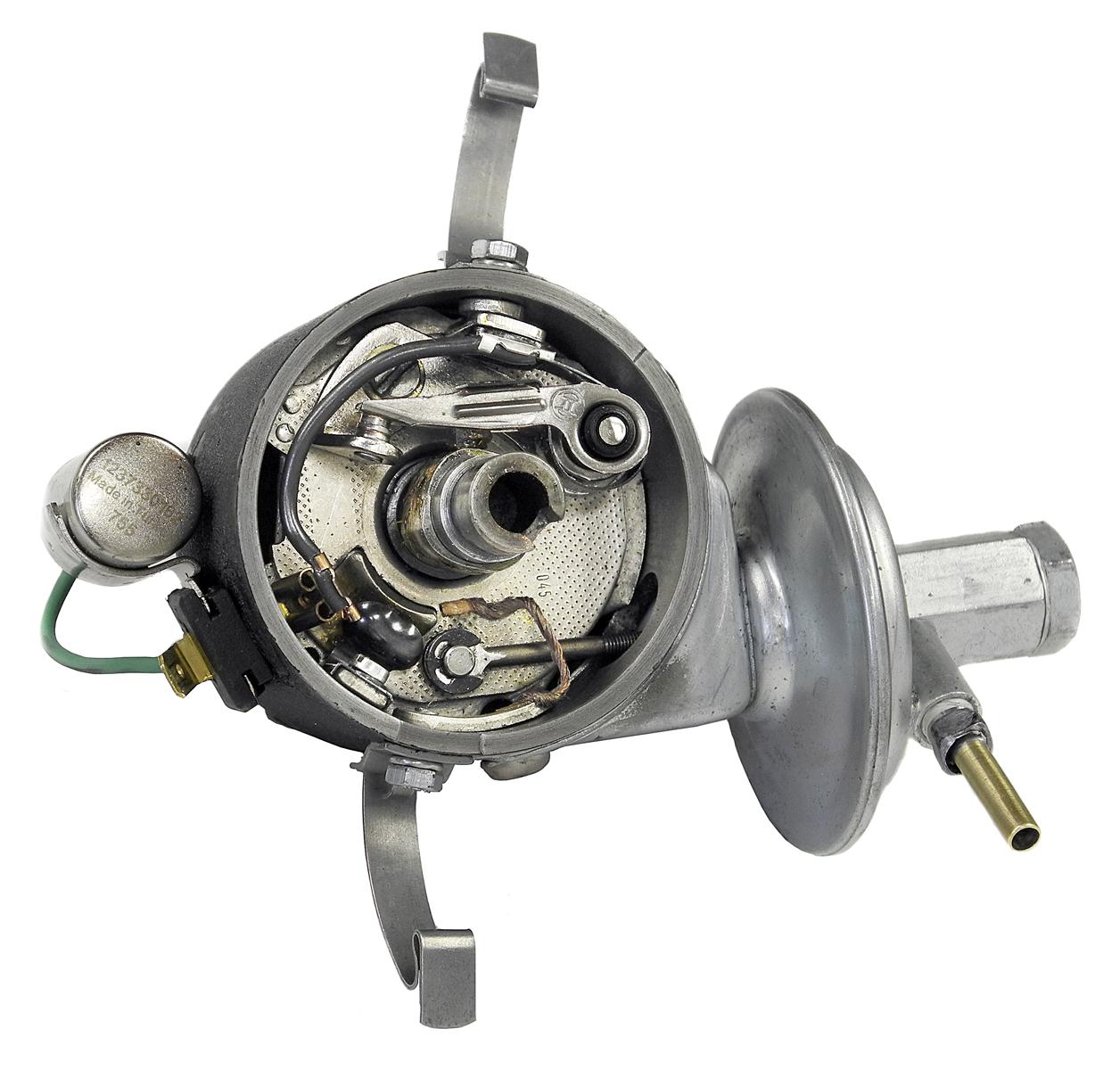

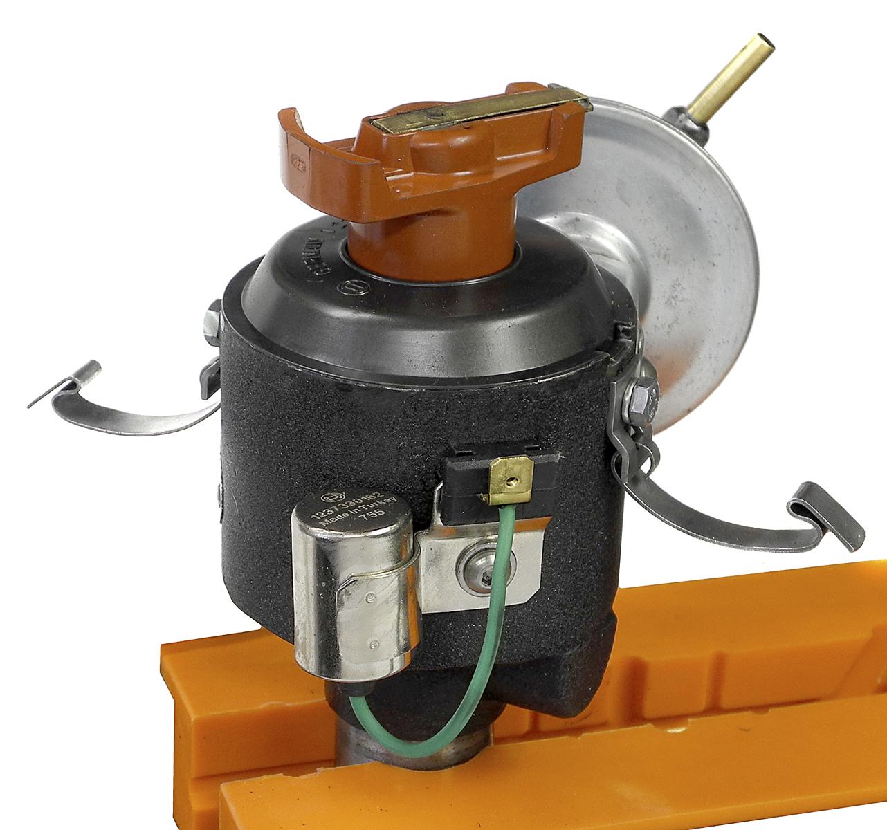

Here's a couple exploded views of the distributor, from Everett's Gallery-
Originally, these take the following Bosch parts, short numbers shown-
Rotor #: 04 008 (resistor style)
Cap #: 03 019 (same as the "010" and "019" distributors)
Points # 01 002 "dog-leg" or 01 003 "non dog-leg"
Condensor # 02 170
Vacuum can # 07 002
For reference, the port on the vacuum can is 8mm x 1.0mm thread.

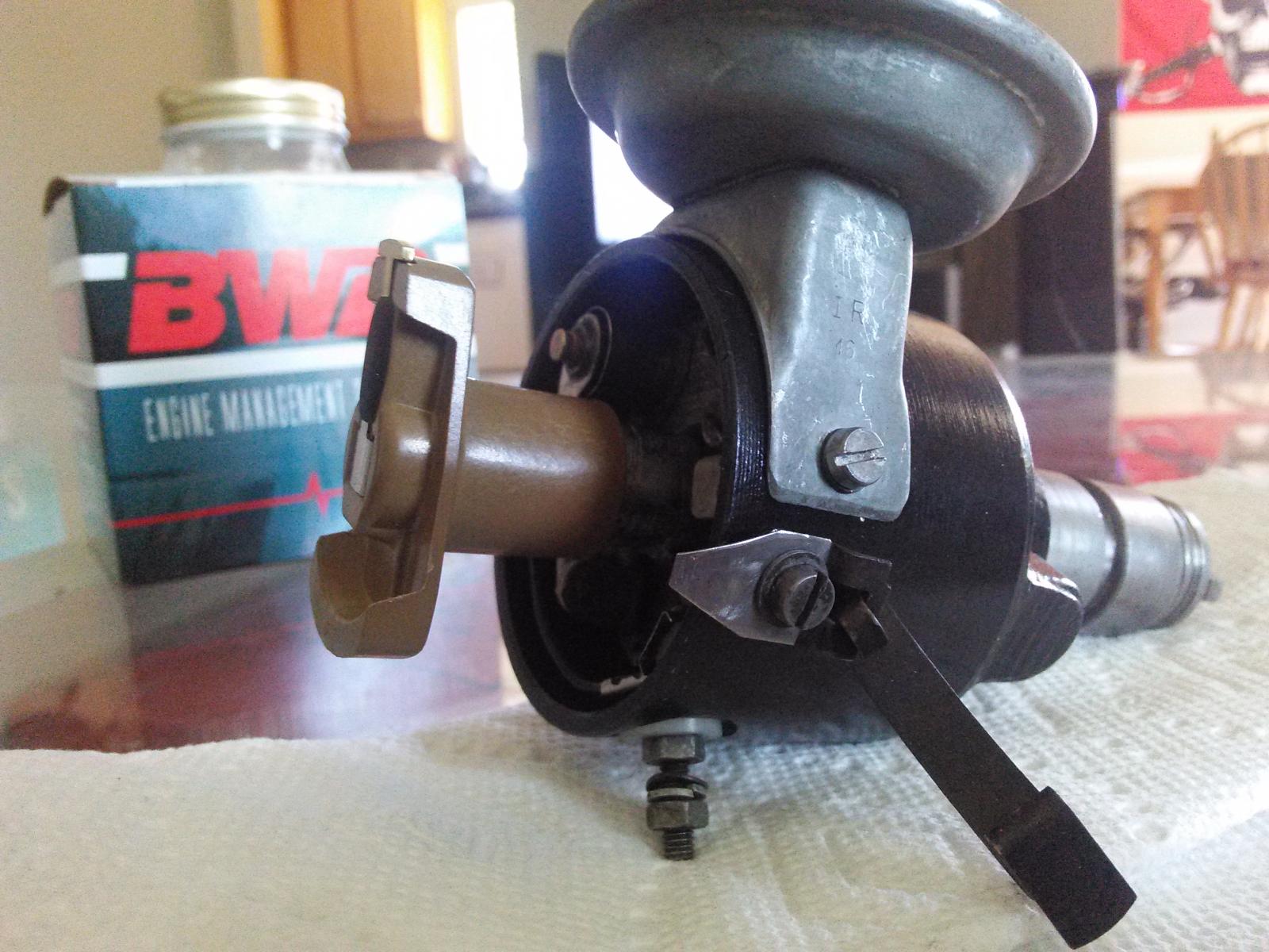

So, what the heck are "dogleg" points, anyway?
So, those unfamiliar with these distributors (or the late fifties, early sixties distributors in general) may be unsure what I mean when I mention "dogleg" style points. The original production of the VJU4BR8 featured two-piece points, that had a tab perpendicular to the mounting pivot, and there was captive under this tab an eccentric screw to aid in fine adjustment of the point gap-
You can see the small black slotted screw near the bosch logo on the point assembly, at about 8 o'clock on the picture.
The later production replacement for this distributor goes by the part number "0 231 115 040" using the later Bosch numbering scheme, and was introduced in the mid sixties. I'm unsure of the exact production dates and values, however. A change made to this version, was the addition of nubs near the rubbing block end of the points assembly, to aid in adjustment of the points. This version can still take the earlier "dogleg" style points assembly, but are also set up to use the later style two-piece points, that lack the provision for the eccentric adjuster. The difference between the two styles can be seen here, note that the eccentric screw is missing in this pic-
The early VJU4BR8 style on the left, and the later "040" style is on the right. You can note the adjustment nubs at about 1 o'clock on the right hand set, and these are lacking on the earlier style plates. It should be noted, that you can still use the later style points on the early style plate, but it will be a little trickier to adjust the points gap. Still pretty easily done, however. Other than the points arrangement, the distributors are functionally identical.
Is one better than the other? Not really, no. Once adjusted correctly and tightened, they will function the same. I like the uniqueness of the early style adjustment with the eccentric screw, but they are often missing if you buy your distributor "stripped, as they so often are when affordable.

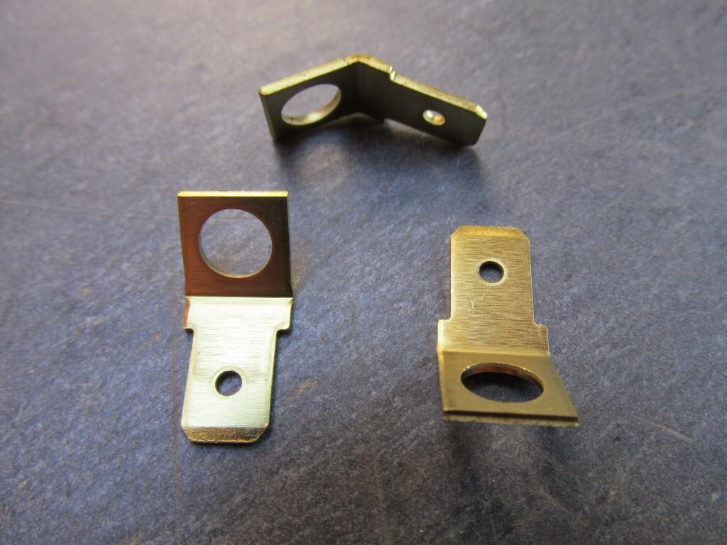

The wire for the points on these actually attaches to a stud in the body of the distributor, and this stud is insulated from the body with either a rubber, plastic, or fiber bushing. Care must be taken when attaching the points wire terminal to this stud that it does not contact the points plate, otherwise the wire will be grounded and not function correctly, if at all. This same bolt attaches the condenser lead on the outside of the distributor body, and must also be clean and free of anything that could short the lead to the body, or surrounding metallic items in the engine bay. For example, I helped set one of these up on a buddies car, and we found that the way his fuel hardline was bent caused it to nearly rest against the stud, so we bent the line out of the way and slipped some fuel hose over it for protection. If you are missing the insulating washers, there are nylon collared washers available at most hardware stores (in the little misc bins, most places have them) that will work very well.
note the "field expedient" tab added to the clip so that the cap can't pivot Very Happy
Also, make sure that the braided wire from the distributor vacuum can assembly is securely attached and bolted down to the points plate, otherwise the distributor will not ground properly.
A wire with a ring terminal on the distributor end, with a female terminal on the other end is a nice secure way to attach the points wire to the outside world, as is one of these, which will give you a easy quick-disconnect feature at the distributor-

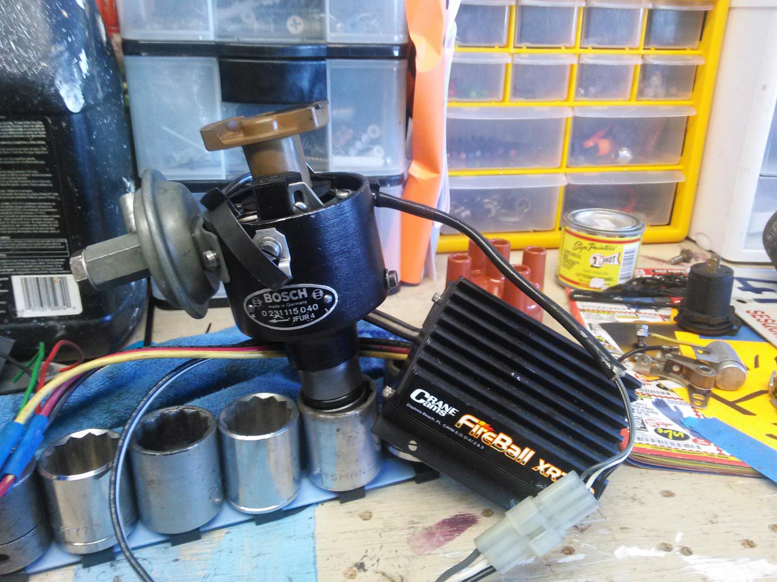

POINTS? I must have electronic!
As far as points replacement modules in these guys, they should be the same as any other installation, as the only true difference in most are the mounting plate throughout each product line. Care must be taken to ensure that the wires do not chafe or rub on the rotor, shaft, or internal components, as you would ensure when installing the module in any other modern distributor. Make sure there is enough slack that the points plate can pivot as vacuum pulls the can and rotates the plate, as well. If the module you are installing does not have a rubber grommet of some sort to pass the wires through the body of the distributor, install one. They're cheap and will prevent the wires becoming damaged over time.
As far as points replacement modules go, in general I'm not a huge fan due to spotty personal experience with their reliability, and will not go into them much further here. We have a large thread full of very helpful information on that matter here- https://www.thesamba.com/vw/forum/viewtopic.php?t=...mp;start=0
I will add, however, I really like to run points with a Ford TFI module! Here is the thread, if you are interested in looking into it further, check it out here-
And here's a look at what I'll be playing with soon on one of my 040 distributors-

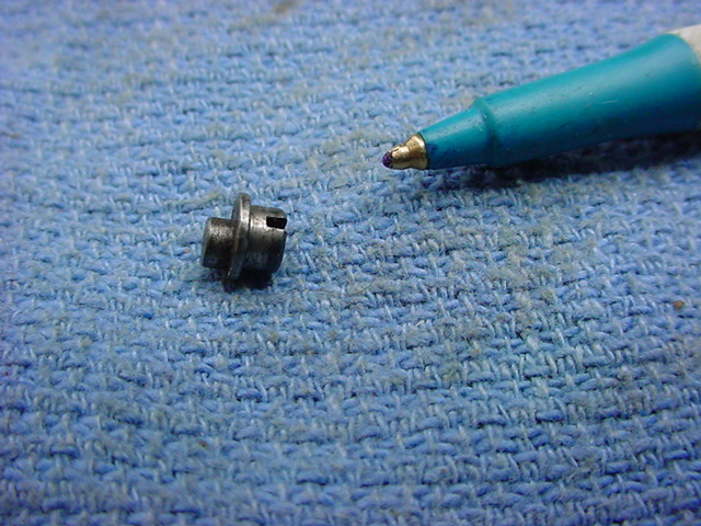

I have found that the dog leg points do not stay put real well without the accentric screw. If you don't have that fine adjustment screw use the updated points assembly.
Another detail in the same area is the little hair pin clip that aids in keeping the stationary part of the points assembly seated on the brass post.

Here's one to make Glenn cringe, but...
I made some modifications to a VJU4BR8 that I am pretty happy with.
I used the lower part of the shaft with the advance mechanism from an 019.
The upper part (where the rotor is attached is from a VJU4BR8.
I turned a plug for the hole in the distributor case where the bolt for electrical connection was, and silver brazed it to the cast iron case. Then the hole was re-located and re-sized to match that on later type distributors.
I substituted a later style breaker plate; the kind with 2 nubs for points adjustment.
I reduced the thickness of the "hole end" of the threaded actuating rod, so it could be held on the breaker plate post with a C clip.
Lastly, I filed a notch in the cast iron case, so I could use a later style cap.
Now, all of my ignition parts are easy to get:
Bosch 01-011 Ignition Points, 311-998-063
Bosch 02-031 Condenser, 1 237 330 162
Bosch 03-010 Distributor Cap, 113-905-207C
Bosch 04-033/04-110 Ignition Rotor, 043-905-225
Right now, it is set for 28* total centrifugal, with about 10* additional from vacuum starting at about 5" Hg.

Ling-
Here are a few more details:
This VJU4BR8 was pretty rusted and busted when I got it, with many stripped holes in the cast iron body. So most of the threaded holes have been re-tapped one size up from original. I was lucky enough to fine an NOS vacuum can for about $40 a couple of years ago.
This sketch illustrates the re-sized and re-located hole to accommodate the later style condenser.
I sized the "plug" to approximate the overall shape of the cast iron body.
Here's a view of the 02-031 condenser:
I like this type for its integral bracket, and simplified hookup.
Here's the inside.
You can see the later style breaker plate, and the modified actuator rod under the C clip.

Mondshine, that is impressive work! I love it! Nice pictures and write up too!
I also like the black wrinkle finish on the distributor. Looks like it came from the factory like that. All those details are really cool way to make one of these practical for daily use and easy replacement parts.
