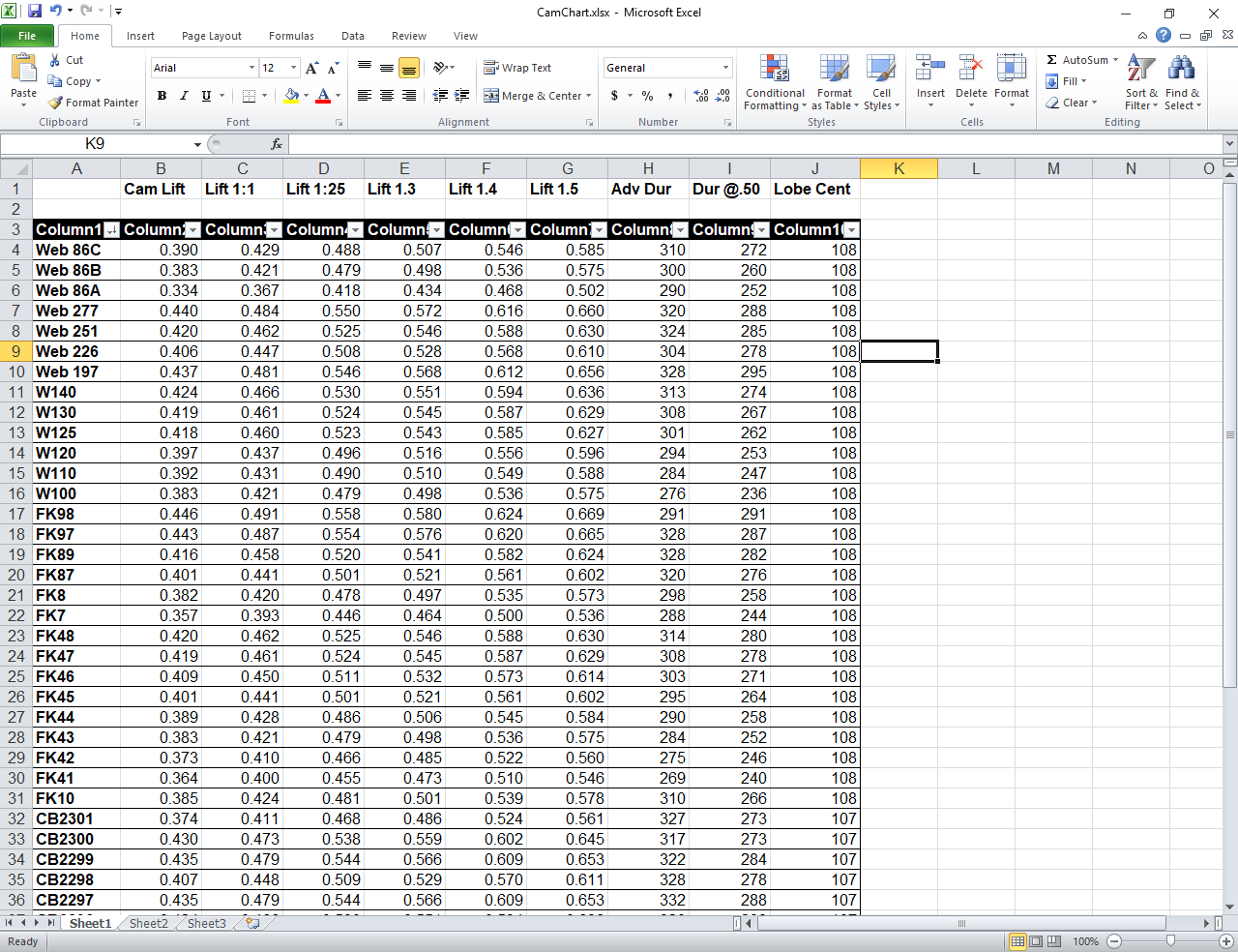

I started to do a Cam Chart in excel. You can sort by Cam lift, or any other drop down. I put in formulas to calculate all rocker sizes available based upon the cam lift. If anyone wants to finish and add all the cams, PM me and I can send the file.

That is genius jpaull. Exactly what is needed.
Click on the duration @ .05" and see all the cams available for your desired specs in one spot and compare them easily.
Well done.
Now someone with more time and computer smarts then me finish it for us!!

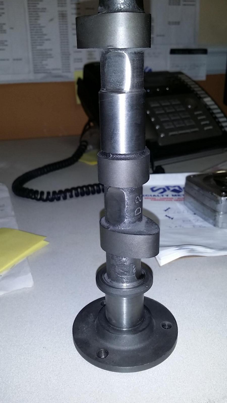

theKbStockpiler wrote:
norris wrote:
While in this cam discussion has anyone an idea of who ground this one? I've look everywhere!
I'm pretty sure it's a Schneider. There was a thread on that number a few weeks back if I'm not mistaken.
Could be, but I emailed it to Schneider and they said it wasn't theirs.
That looks like a Bob Walters Dial-in-Cam. I have one in my engine and I also couldn't find anything online about it. You can find Dial-in-Cam advertisements in Hot VWs or VW trends magazines from the mid to late eighties. The ad I remember was for inline-4 VW water-cooled engines and won't help you decode your cam.
norris
