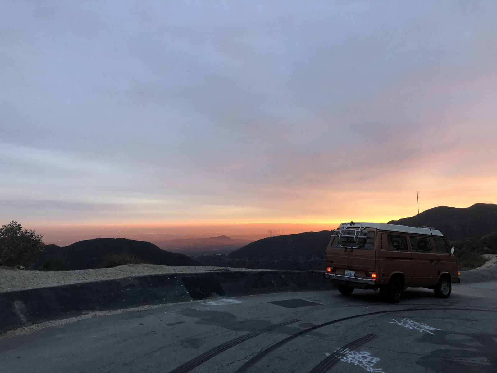

Rallied up the hill at a blistering 35-40 mph most of the way....made it to the top at exactly dark. One of my favorite times of day, while the sky has color but all earth bound objects are black shadows. So beautiful!
Bit of off lighting, but this is what I meant about the colored sky with black shadow stuff...:

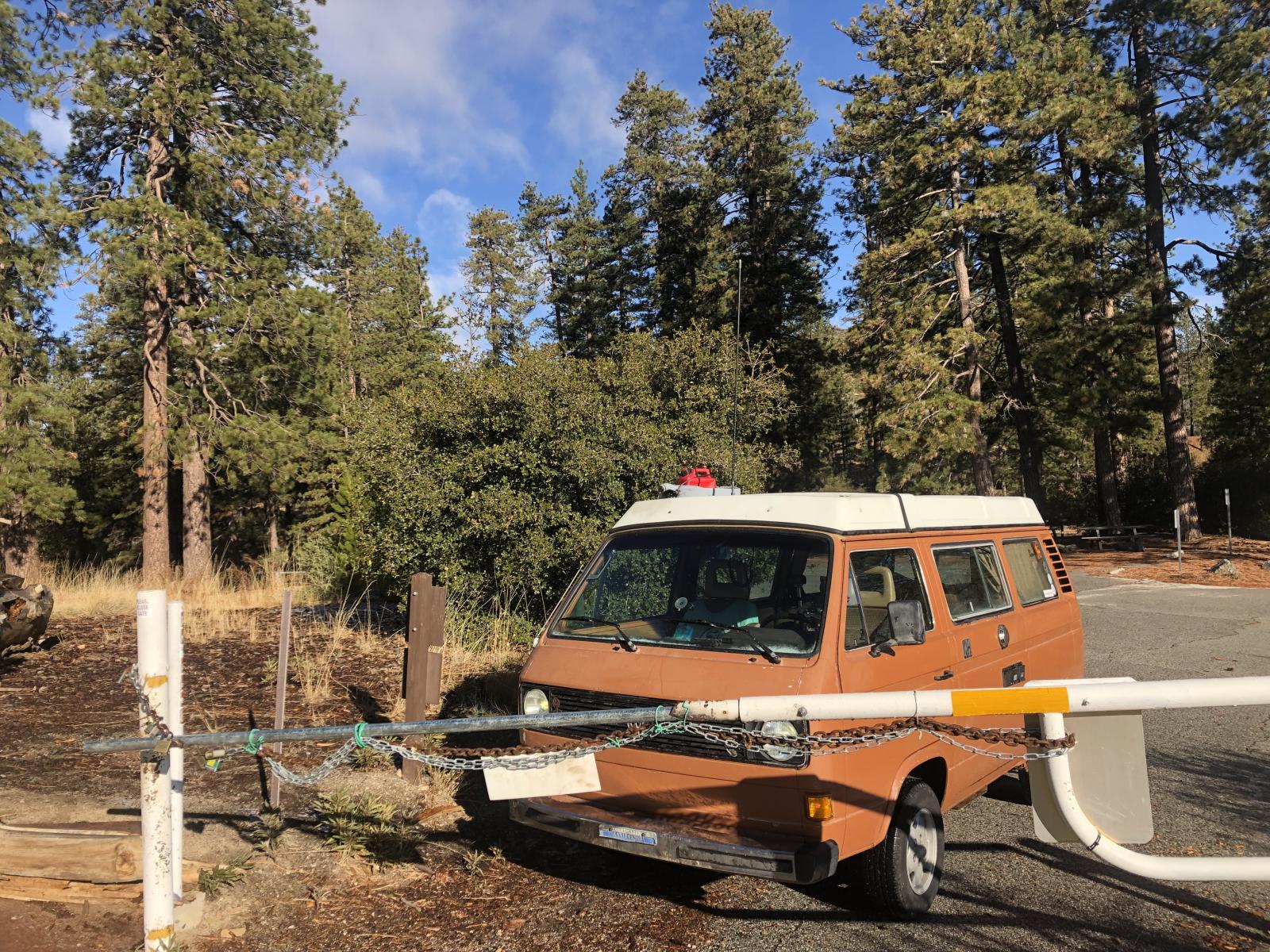

So I pull up to this sign...
Without knowing one person here.
A few minutes later we are now aquatinted and I offered to come up the following week to volunteer for a men’s group coming in. Free food from camp? Who can say no to that!?!

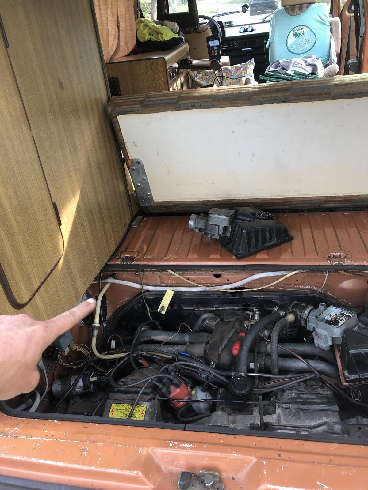

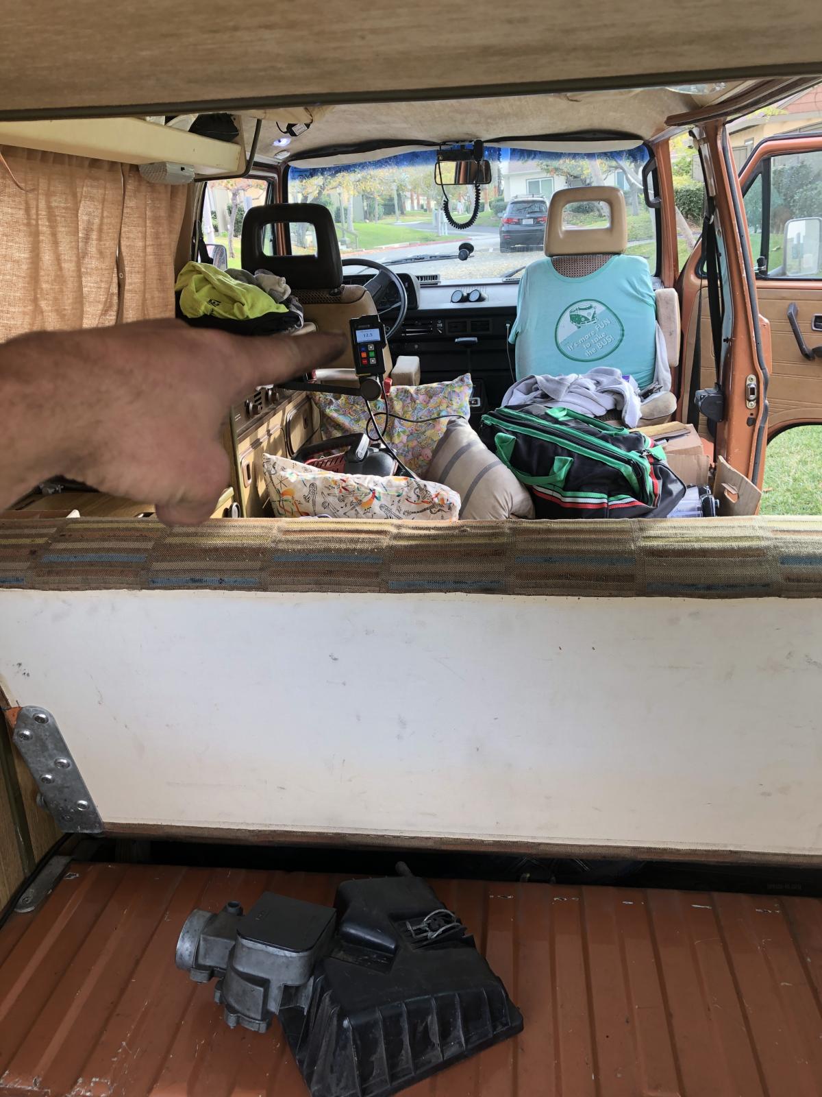

Go to leave and the van won’t start.
Really? 3000 miles perfect and suddenly a no start? After 25 minutes of cranking and finally a nudge firmly to lean on the afm wiper with my finger while cranking and it started. Funky. Didn’t shut it off till I got to Rialto...and didn’t think a thing of it.
Till it shut off on me completely merging onto the freeway with me thinking I was on fire with the fuel smell.
Three days later I thought I had solved it...
Not so much.
I did fix a few little things in the mean time while hunting around...
Kinked fuel line:
Tested everything and despite it being within spec, at full throttle or under a heavy load my ts2 was flooding out my engine! Long explanation but bypassing and then replacing it solved the problem. She’s happy again, new one installed and spares still in hand. Not a huge deal!

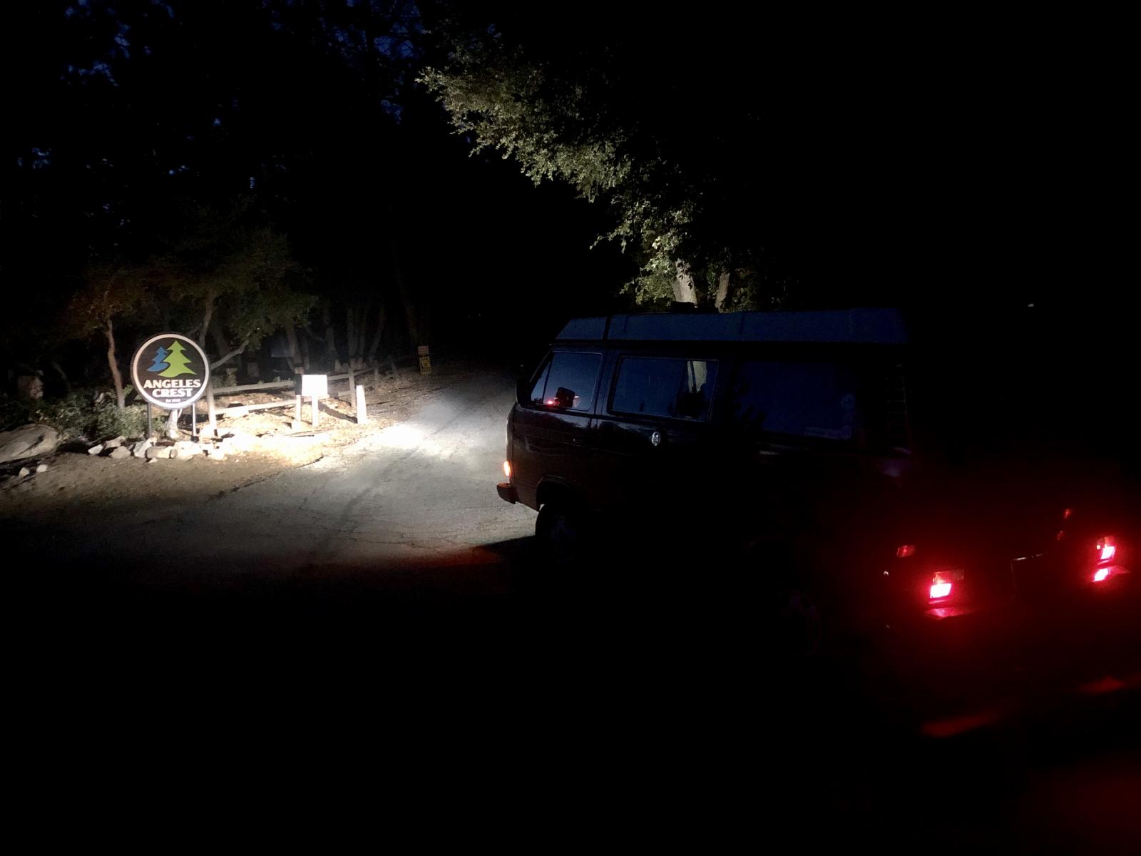

Back up at camp (Angeles Crest Christian Camp) I try to take a pic of my van and it got photobombed...
But I came back later for a retake Wink

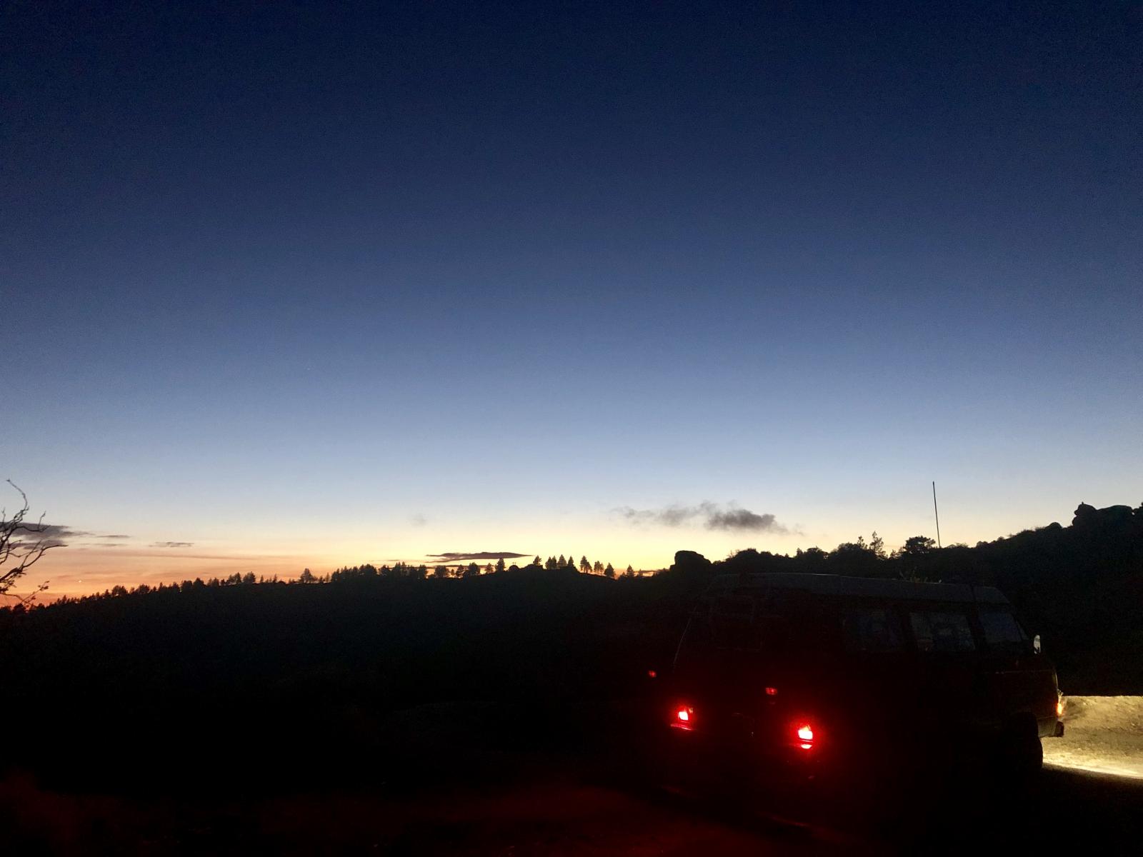

Went out and took some night pics and waiting to get copies from the junior photographer next time I see him Smile
Heading back to San Diego...this was in a hurry to get down the hill before closing time for a delivery I was making. Nearly rolled the van when my rear inside tire came off the ground under a hard brake and turn moment...I got lucky. Really really lucky.
Then I got this shot and kept going:

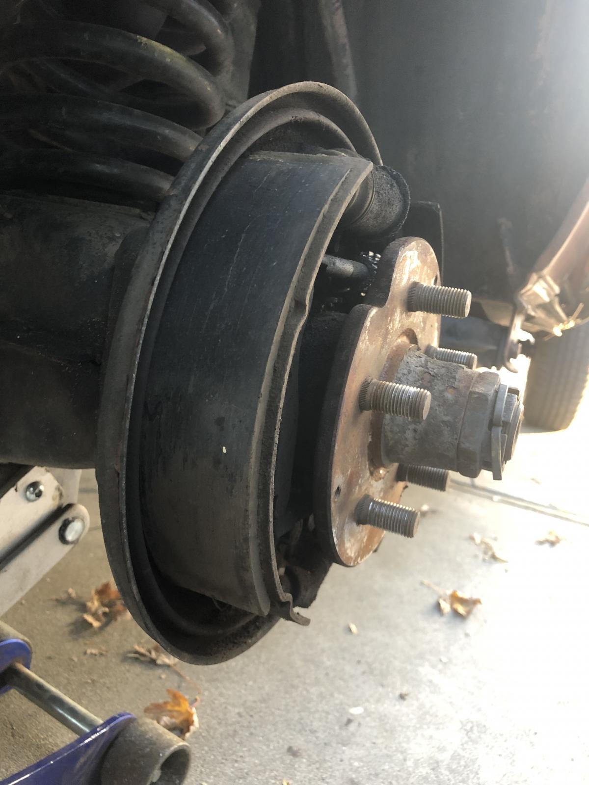

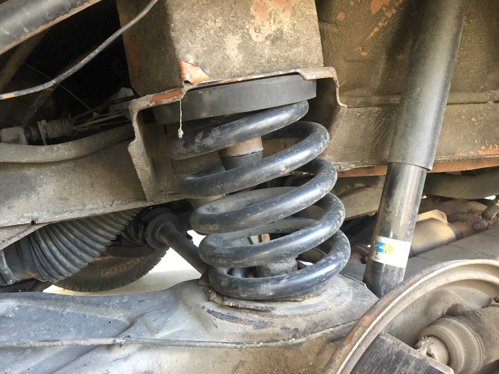

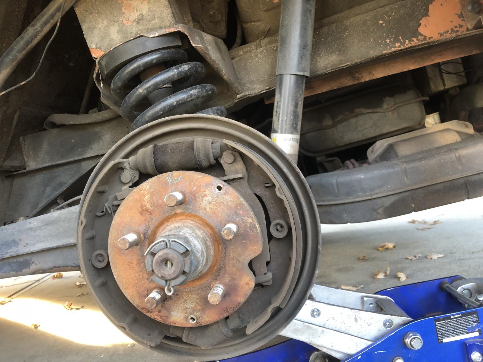

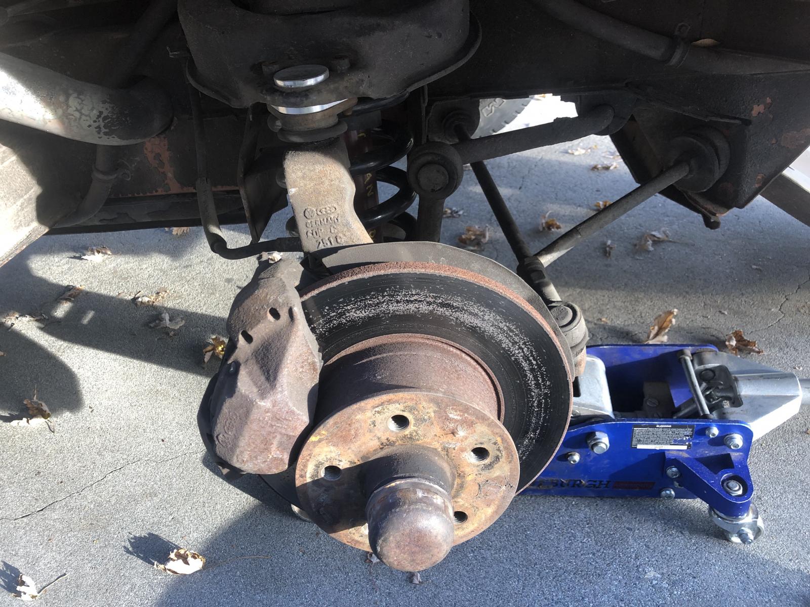

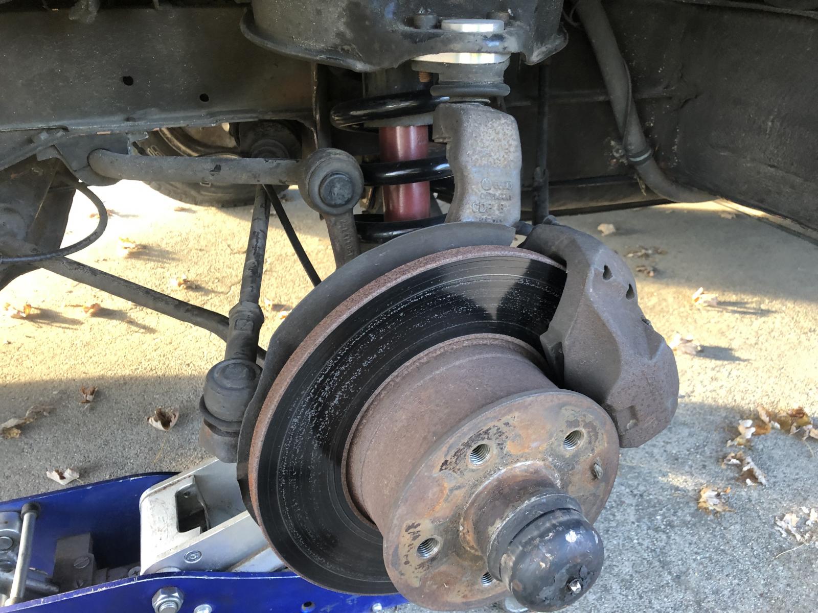

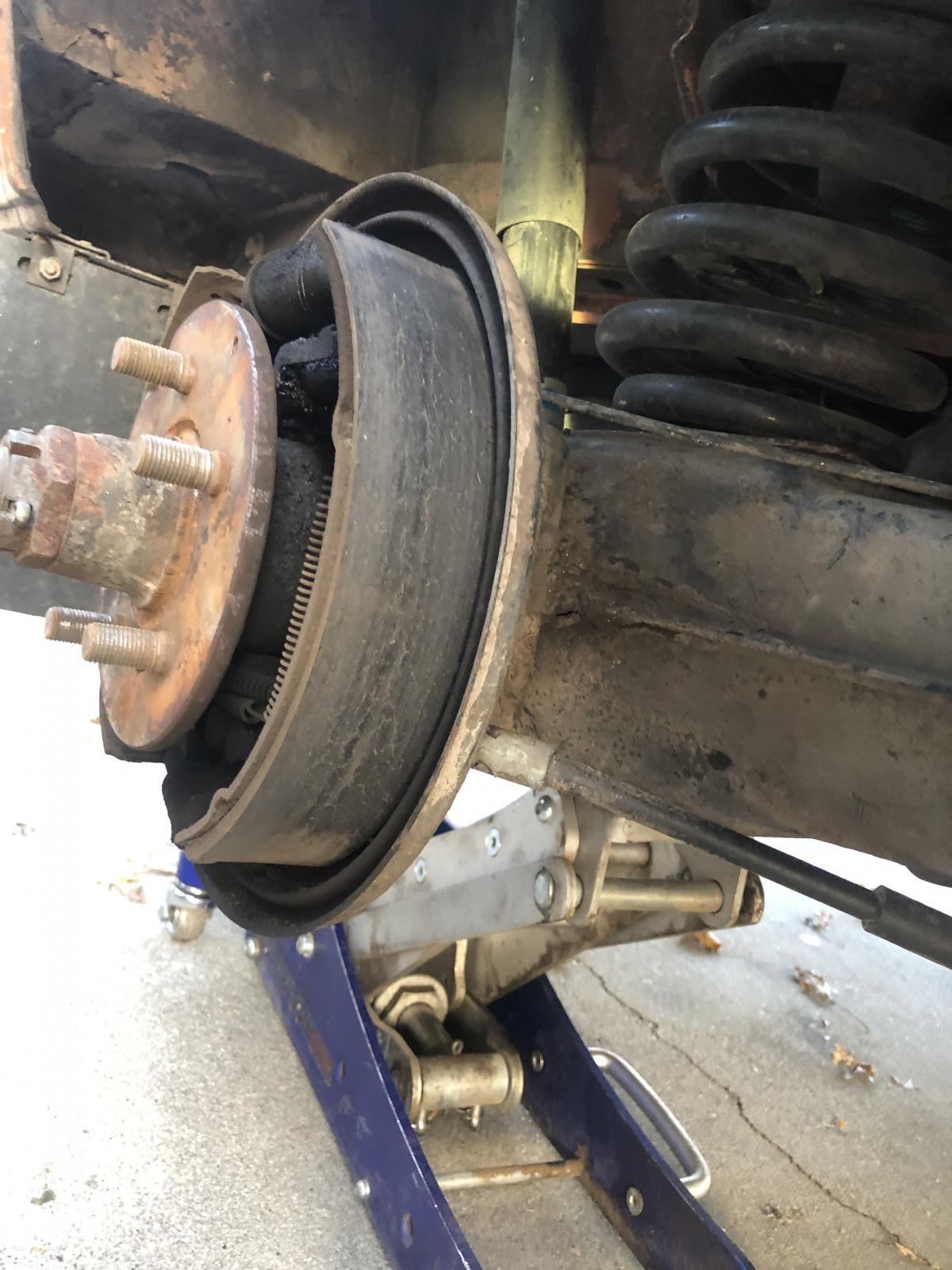

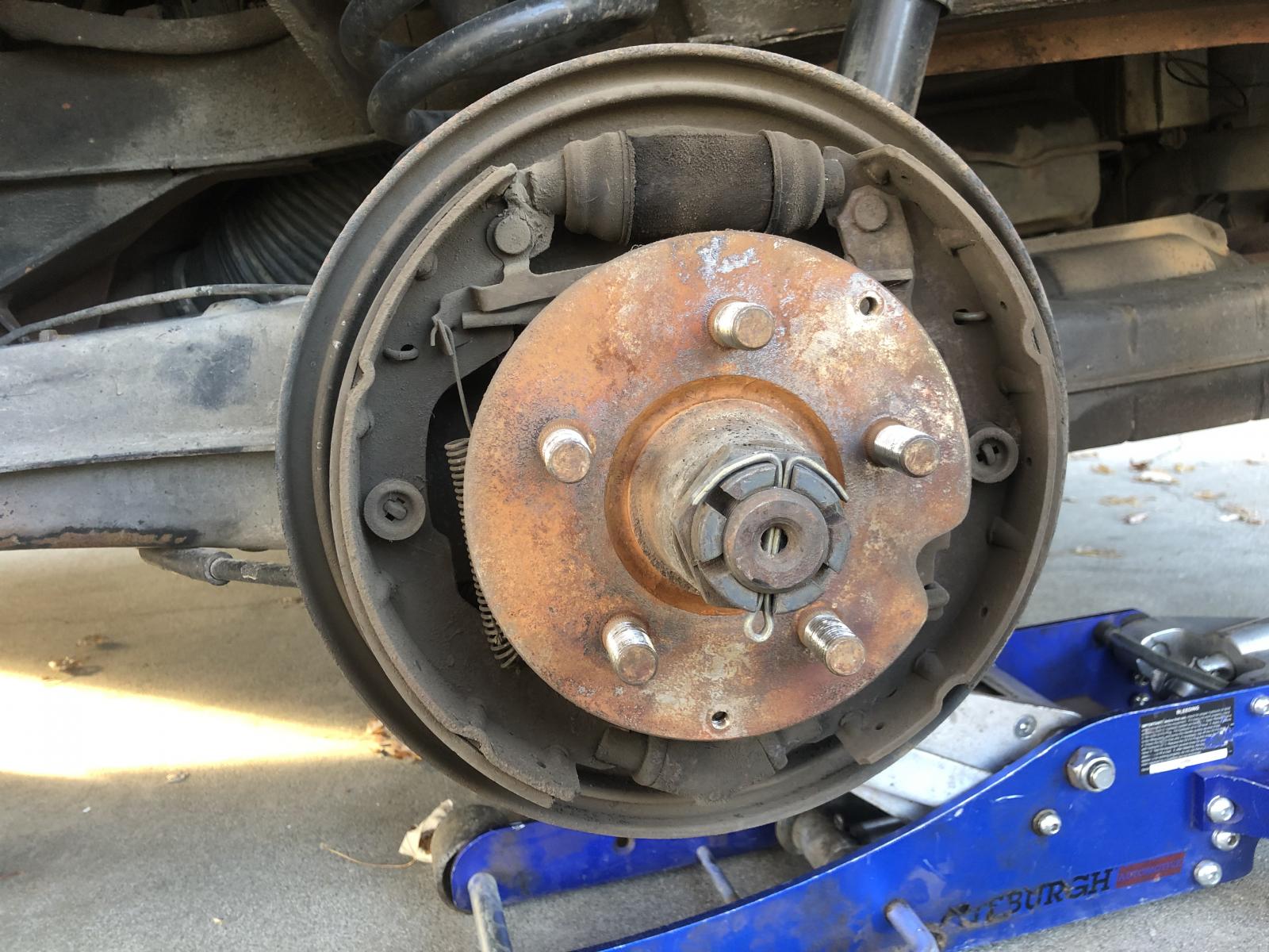

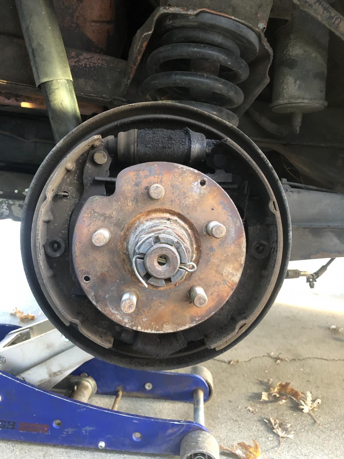

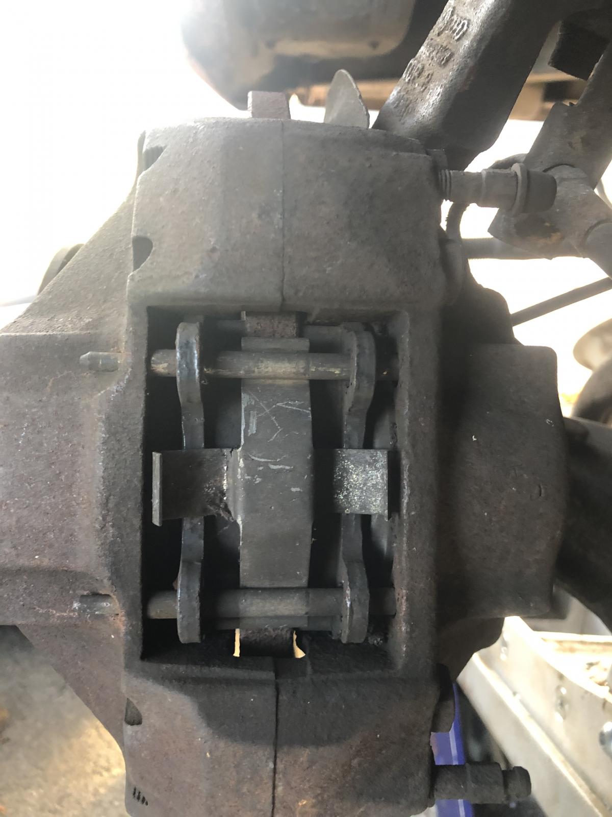

So decided to rotate my tires since my shot front tie rods have just about shredded my front tires in 8k miles. Found out why my brakes stink... can you see why?
And I was NOT under the vehicle so I didn’t worry about the normal jack stand. Just inspecting and rotating tires! (These pics are for a reference later personally)
And my rear spacers for later reference:
Passenger side:
Drivers side:

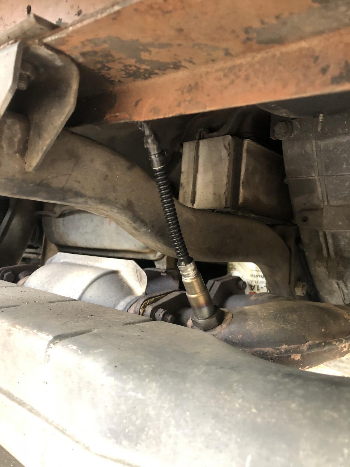

Also grabbed a O2 sensor LM2 tester from Gary, who was kind enough to allow me to use his.
Installed the sensor where the facility sensor goes:
Then ran the wiring up to my battery to power the tool and Heated O2 sensor:
Which also allowed me to watch it while driving.
Got my idle to 14.7, then 2500-3500 rpms to about 13.5, then full load in gear to 10.5 at the most rich but general acceleration around 11-12. Sorta happy with results. Have a second AFM to tweak and I may lighten it to 12 under full load, but for now at least I won’t be burning anything up. No vacuum leaks, timing is at 38-40 degrees at FULL advance, and the afm is dialed in. It’s a happy motor!

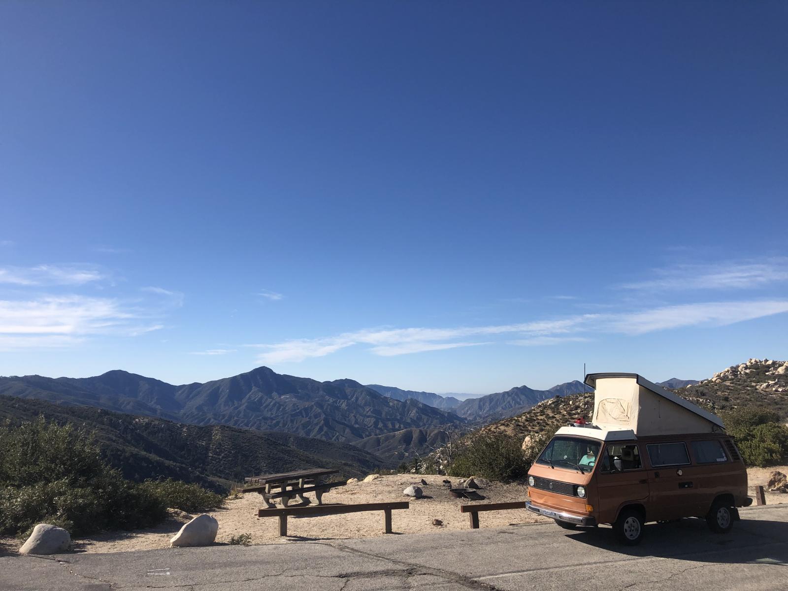

Went on a fun downhill ride and enjoyed the view of my van from a half a mile away...(can you see the pop top?)

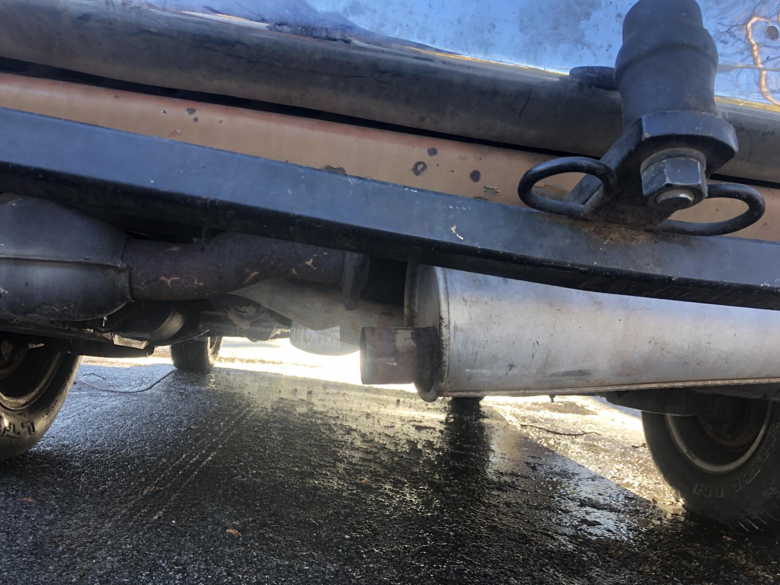

Came back to camp, and found out I had bumped my muffler on a turn around...
It slide right back into place Smile

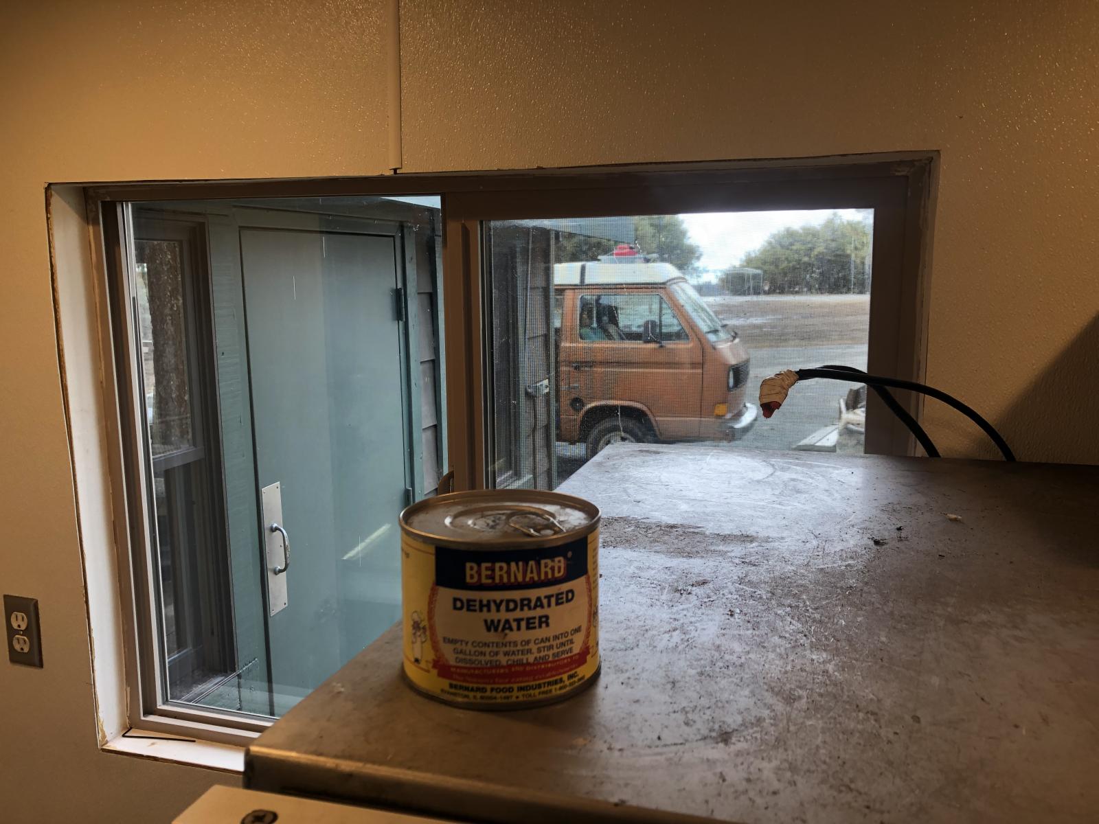

Oooooh too bad. Embarassed
You should have used organic dehydrated water, mo better for ya. Cool
Nice post, thanks.

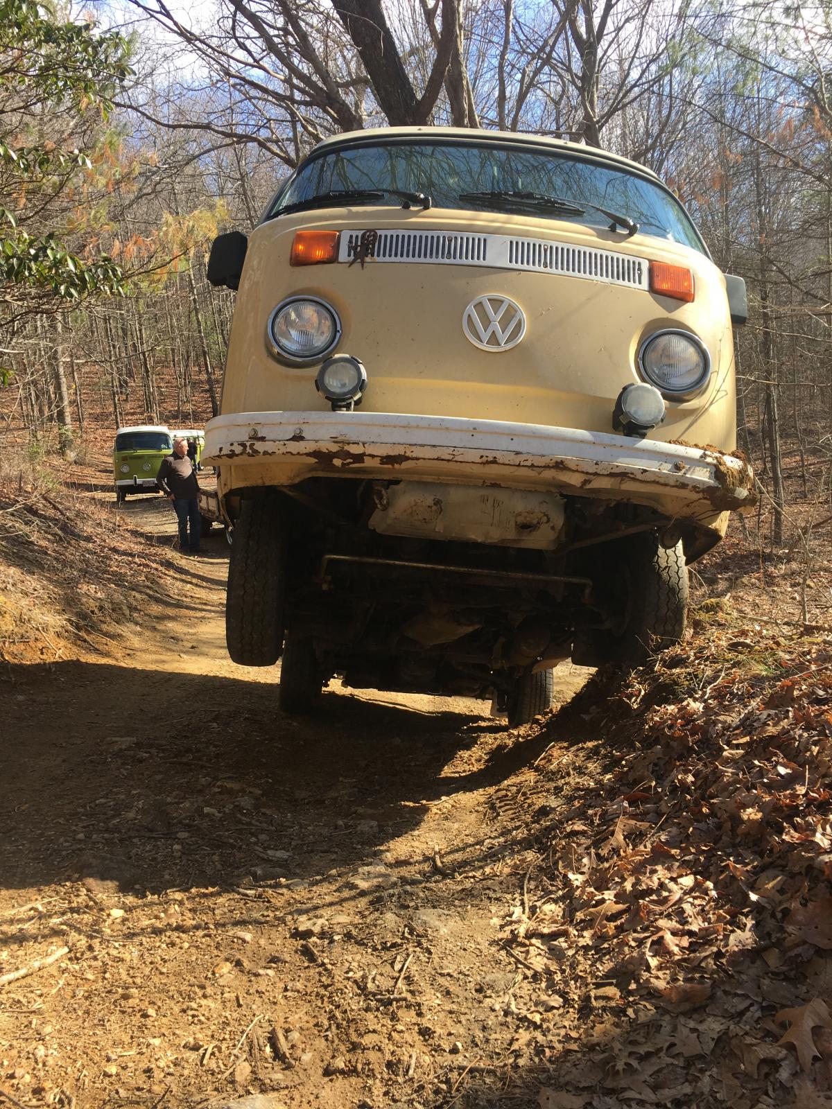

Looks like fun Stu. I cannot help but think on that pic with the rear end slightly in the air that Corkey is saying ‘Pull my finger.’ 😜

PostPosted: Sat Jan 19, 2019 3:13 pm    Post subject: Re: Corkey! The 1980 Westfalia Vanagon Reply with quote
Time Fly's! especially when you leave your watch on the plane!
I managed to get some time with the van to tweak and fiddle fart around.
Got the cold start valve dialed back in (removed and bypassed for testing) and checked my timing and such. Engine is still running a bit richer when cold then I would like but I can at least reliably make it start with minor tweaking prior to a stone cold elevated start (6k feet up above the sea)
in other news...the fridge works again, magically when you plug it in factory it all worked as it should Rolling Eyes 12v and 120v both work great, 12v only when the engine is running. my indicator panel is now working again too, which tells me the battery and water level. happy about that!
got the Oil temp gauge wired in, and ran the wire for the oil PSI as well, and will be putting the sender in as soon as this evening if things go smoothly getting back to Rialto.
also installed a set of hella Supertones. the horns were not getting good clean power and ground, and they work fine when bench tested, but i installed a relay and reliable power source, and now the horns TOOT nice and loud with a very slight touch of the button Very Happy the new horns are nice and pretty, and in the factory location for now, and are significantly louder then factory, so i dont get pushed around by the people not watching as they merge into my lane here in SoCal....Rolling Eyes now happy to be a nice instant 120 dB Cool
Ill upload a couple pics of all this later Smile
