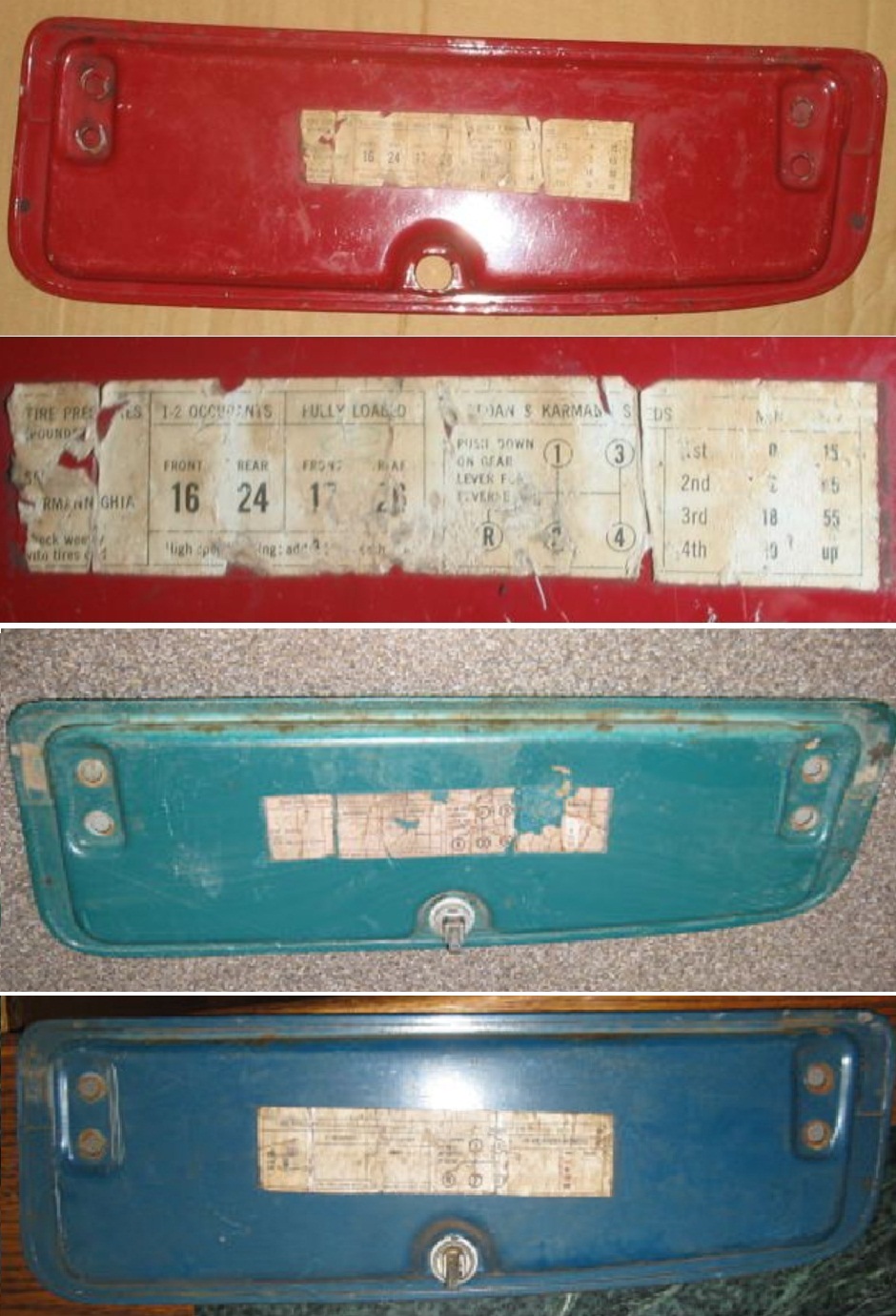

We're going through the details of our late-1964 Sea Blue Sedan and discovered a paper decal/sticker that has information about tire inflation values for the Sedan, Karmann Ghia & KG Convertible. Unfortunately, our sticker is only partially intact.
I found three other glovebox doors with the same paper sticker. A Ruby Red 1962, a green, & a Sea Blue. I've bought the red & blue ones so I can make a color scan to design a reproduction myself that's in better condition than the partial one on my 1964.
Is there a reproduction of this sticker available?
Does anyone know which years this sticker was fitted to?

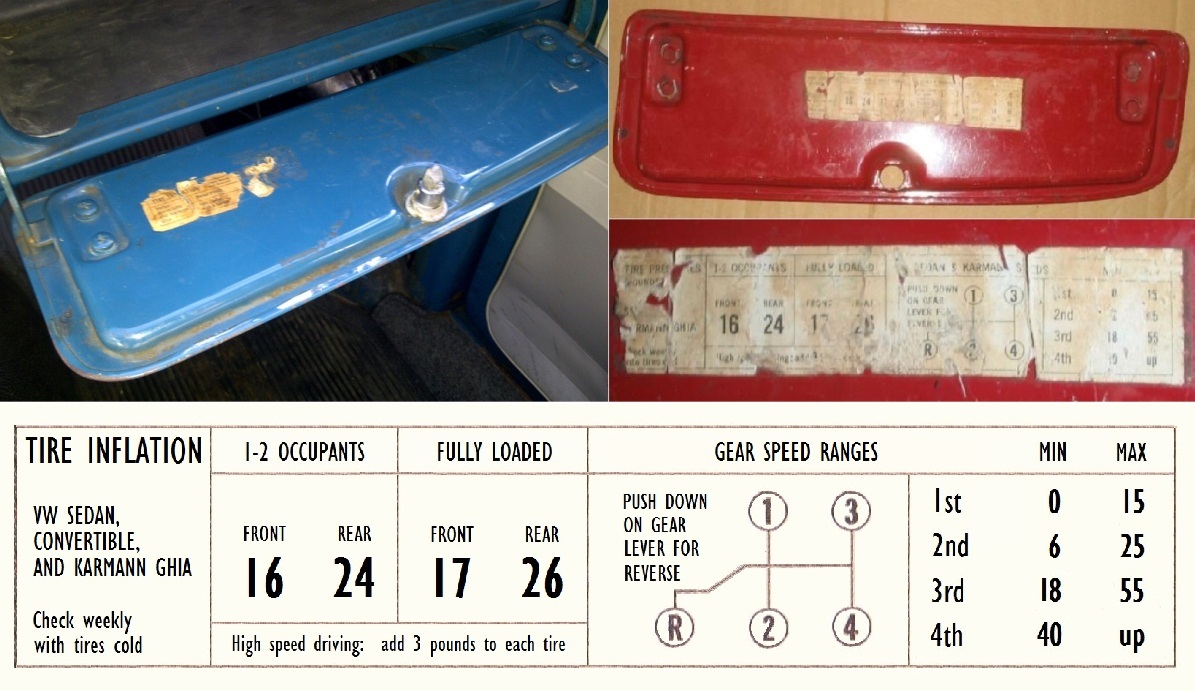

I bought the Ruby Red & Sea Blue glovebox doors and they were finally delivered. I scanned the stickers and noticed there were minor differences, so definitely two different stickers. Since the text wasn't salvageable, I rebuilt the sticker using the original lines & shift pattern but with new text. The repro sticker is 5.75" long and turned out pretty nice.
Here's the repro sticker. If you'd like one for yourself just email me your request and I'll send you the high-resolution JPG image.

The '60's were when the US Congress first stepped in and began regulating auto safety standards.
The full effects were not felt until 1968, and that is when 99% of the VW Beetles progressive refinements were aimed at meeting those standards.
There must have been some early requirements preceding 1968 though, as we see here Dealers were adding labels for tire pressures as well as shift patterns.
These are from an original '66 sold new in California.
Even though there is a tire pressure label on the gas tank, this was applied to the glove box...
And a shift pattern label on the dash...

Lee Hedges Samba Member
Joined: November 09, 2000 Posts: 813 Location: San Diego
Posted: Thu Aug 30, 2012 6:04 pm Post subject: |
Now that's interesting! Thanks for sharing the history & your theory.
Looking that the Sea Blue sticker it is divided into two separate sections, as shown on the red 1966. One sticker for the shift pattern & suggested speeds and one sticker for the air pressures. |

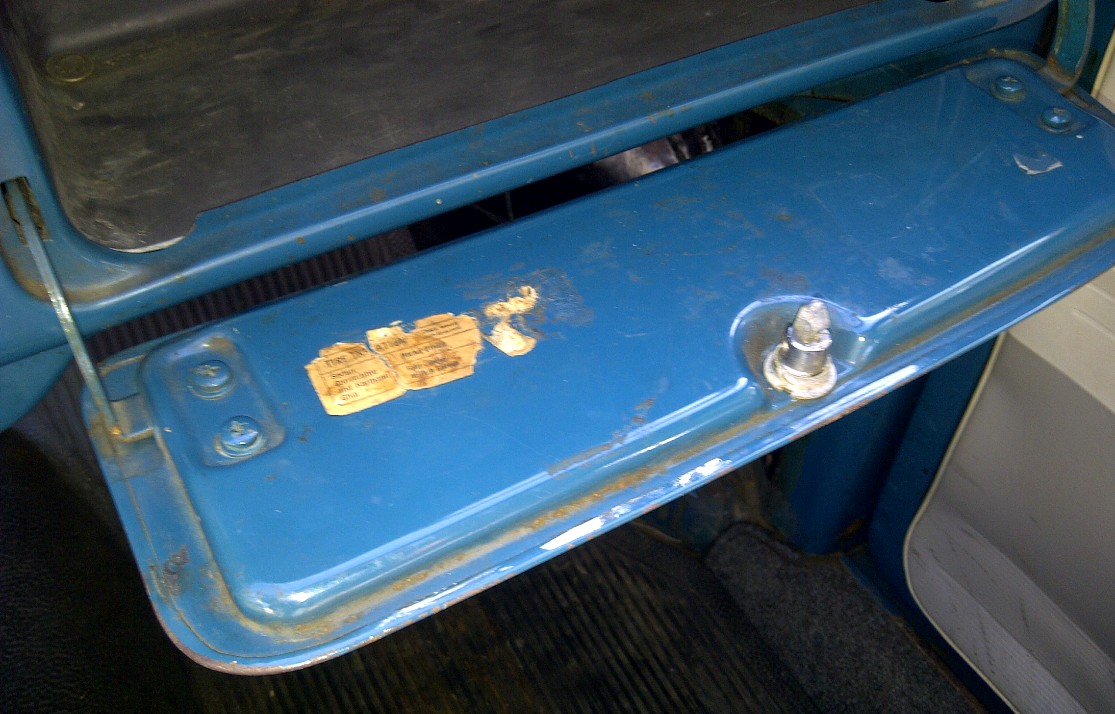

The glove box of my 67 Convertible has a sticker on it which looks potentially like the shift pattern sticker above, and I'm looking for a full version I can potentially reproduce. Does anyone have a complete original example?
- Thanks!! |
Back to top |
harrymarlin Samba Member
Joined: June 07, 2018 Posts: 782 Location: Washington, DC
Posted: Tue Jan 01, 2019 7:25 pm Post subject: Re: Info Sticker inside 1962-64 Glove Box Door? |
Wow - minutes later I found the following in the Gallery (looking for "shift sticker" rather than "glove box sticker"). Anyone happen to know where to find this sticker?
