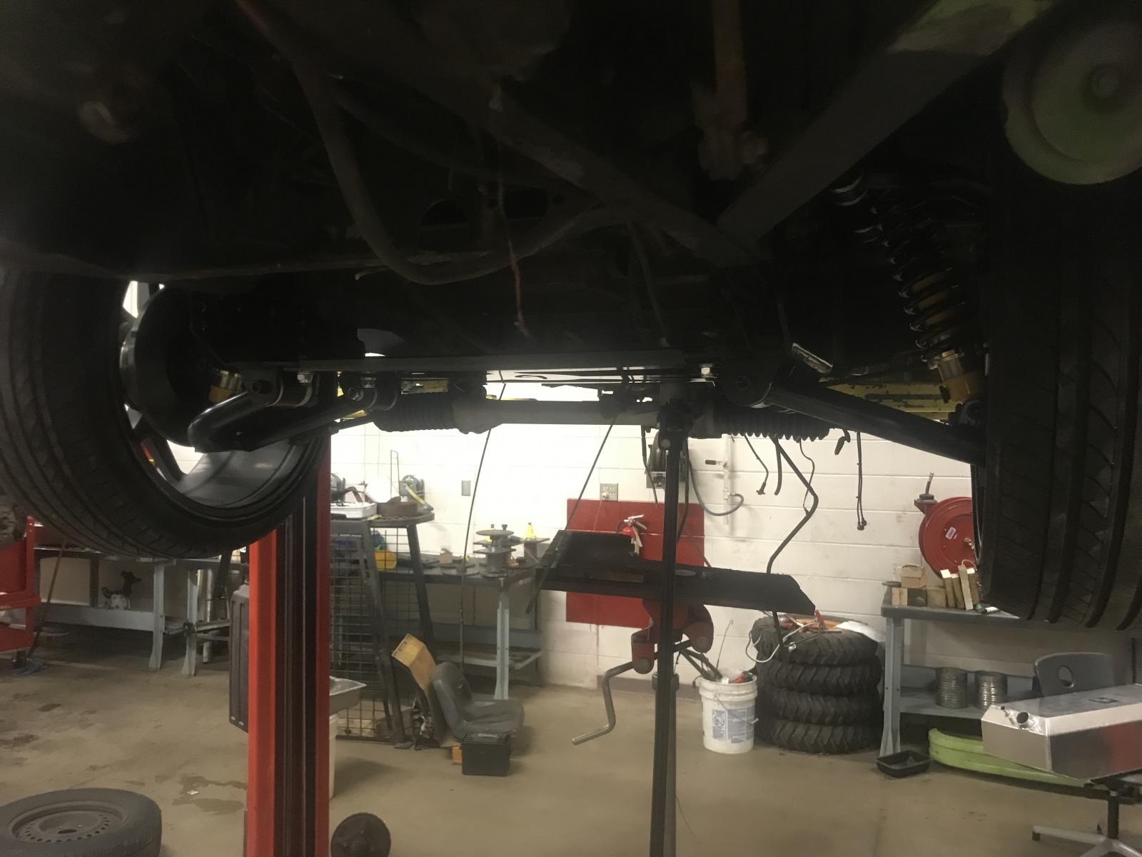

PostPosted: Fri Feb 08, 2019 4:14 pm    Post subject: Re: Green apple monster rebuild thread Reply with quote

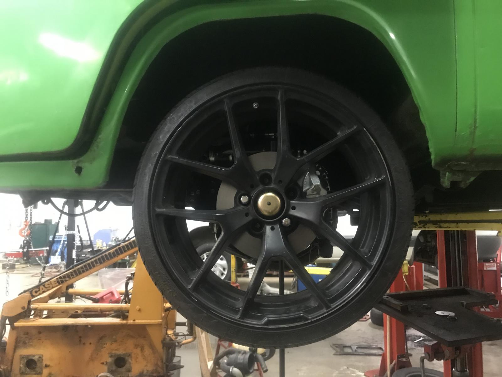

I’m really happy with the completeness of the kit and the engineering that went into it. It’s installing great so far! Brakes look dinky inside 19” wheels, I’m regretting not going with the full tilt upgrade purely on aesthetics there. The 4 wheel discs will be an improvement no matter what though.

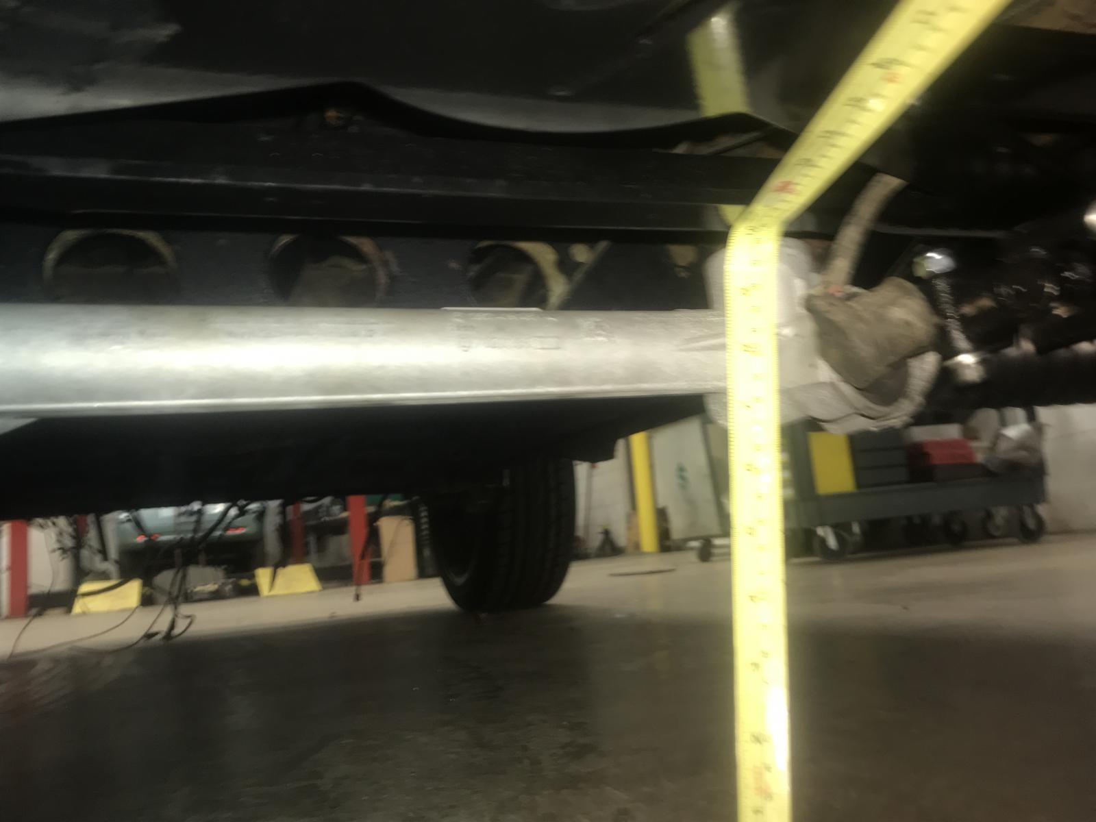

Any chance you could measure from the underside of the frame ahead of the beam to the bottom of the Red9 crosspiece and/or the lowest point of the suspension? I've been curious for some time what the ground clearance might be like with one of these front ends, especially when not mounted in the "lowered" position.
chazz79
Joined: August 15, 2008
Posts: 2268
Location: ohio
chazz79 is offline
PostPosted: Sat Feb 09, 2019 5:49 am    Post subject: Re: Green apple monster rebuild thread Reply with quote

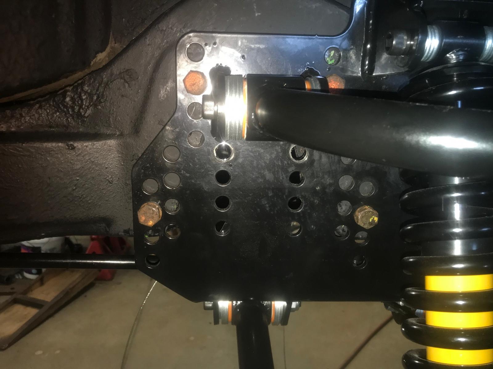

The lowest point will be the rack and pinion. The deciding factor on this vulnerability is how you set your coil overs. I intend on moving this around when I get it back on the ground to set it where I like it. I also may fab up a guard for this piece. I’m going to guess there’s at least 5” to spare and that won’t change no matter where it’s bolted to the body. More pics to come when my adjustable rear arms come in from vintage v-dubs. Tires should be in @ then too. It’ll be on some 245/40-19’s

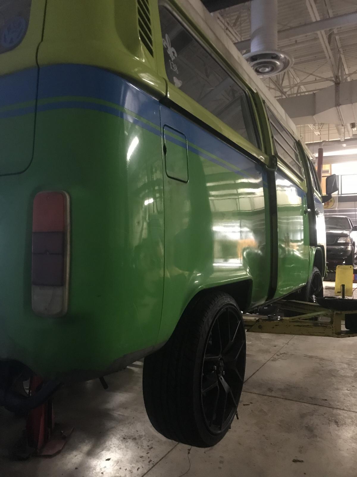

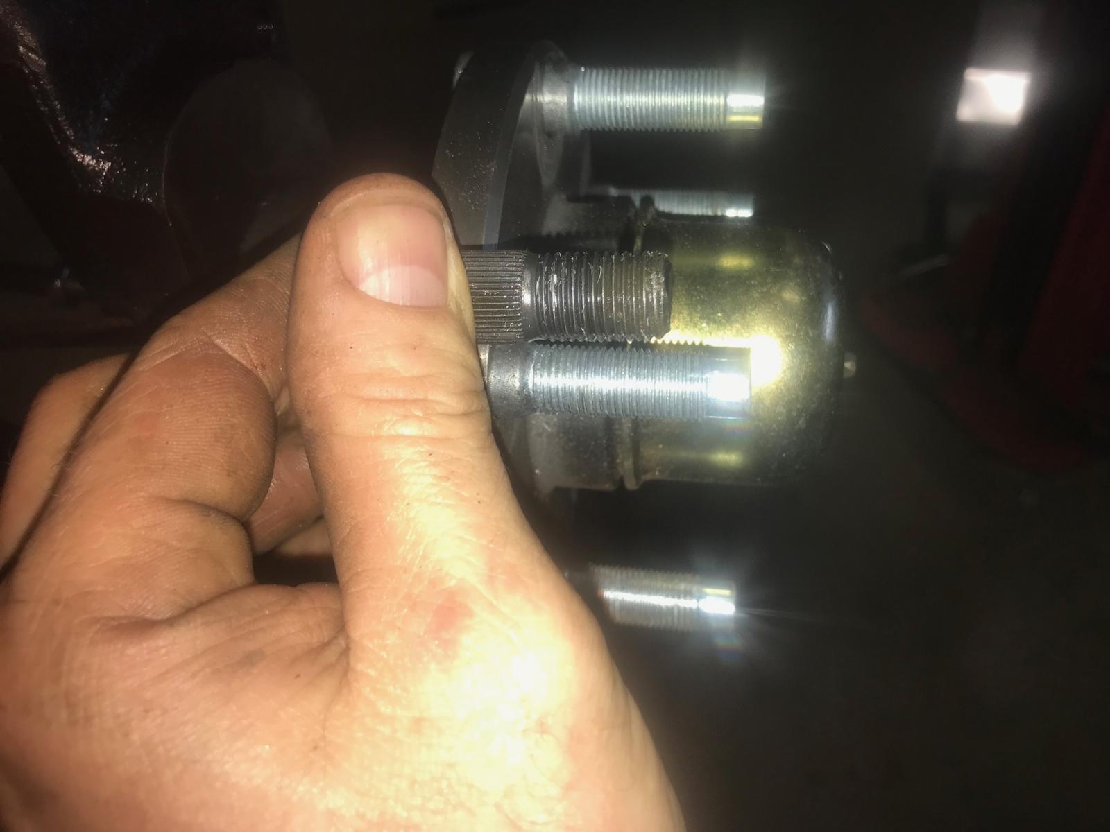

I'm on the fence with this mod... once you go jersey you don't go back. This was easier than narrowing the torsion tubes and relocating the rear shocks. These weren't really meant to hold a tire this wide without some heavy mods.
No going back now
The wheels are Mercedes c230 (I'm going by what the dude I bought them off of-who knows). Tires are 245/40-19. Studs front and rear were replaced with longer to fit the wheels. Dorman part #610-426 press fits as normal but is a reduction in thread diameter to 1/2-20. They're readily available and stock for a 98-06 crown Vic.
These pics are with the suspension set at the second highest bolt hole. The highest is still lower than stock and I couldn't imagine going lower with this tire combo.

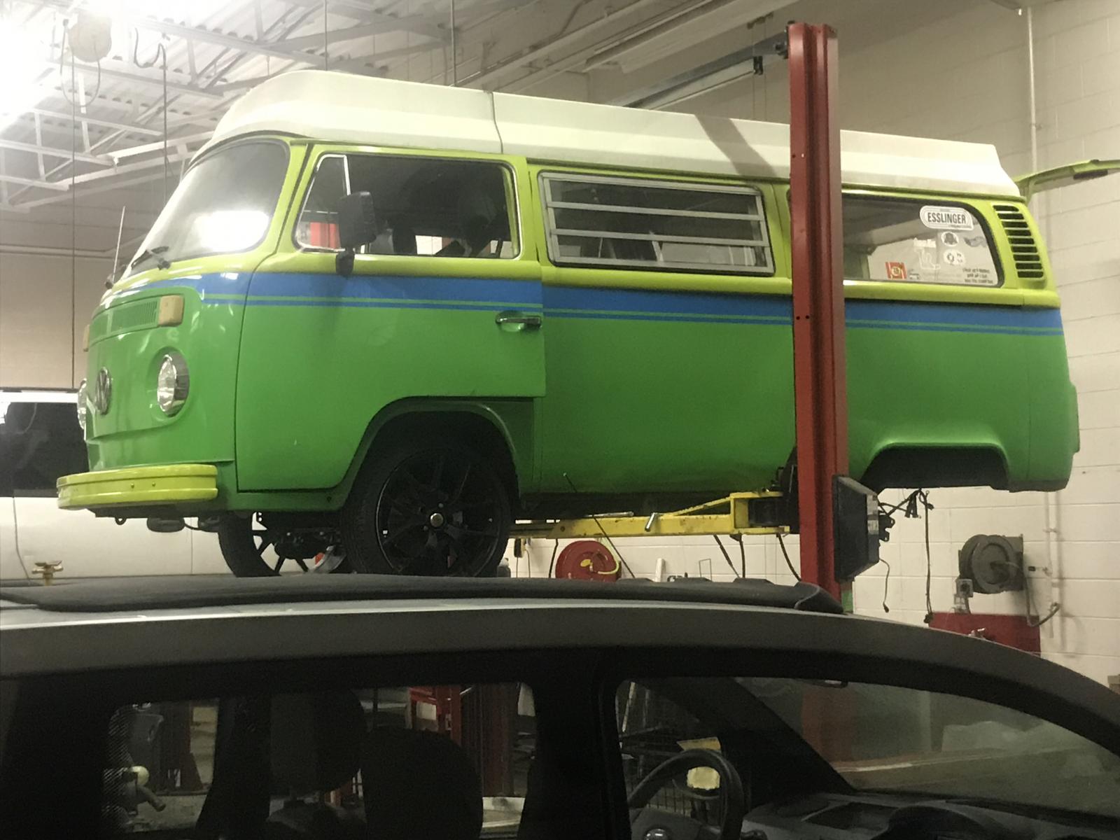

This is the adjusted ride height. It’s adjusted low enough to have travel without needing elevated seat pedestals. The front bumper is set at 13” and the rack rides 6.5” off the ground.

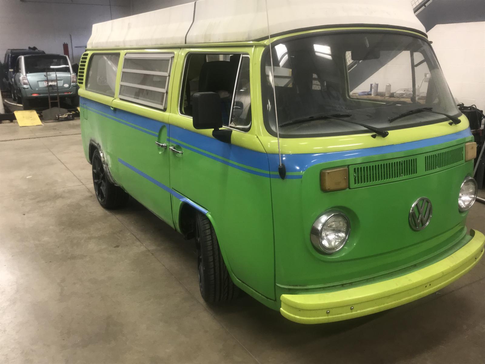

The first pic is with a 25.5” tire and the highest setting. Not much lower than stock

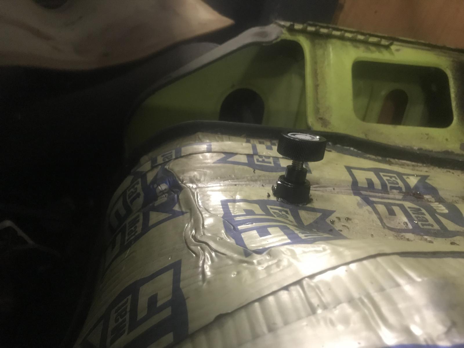

The stock proportioning valve can be reused but I went with a manual bias. It’ll be under the driver seat for quick adjustment.
