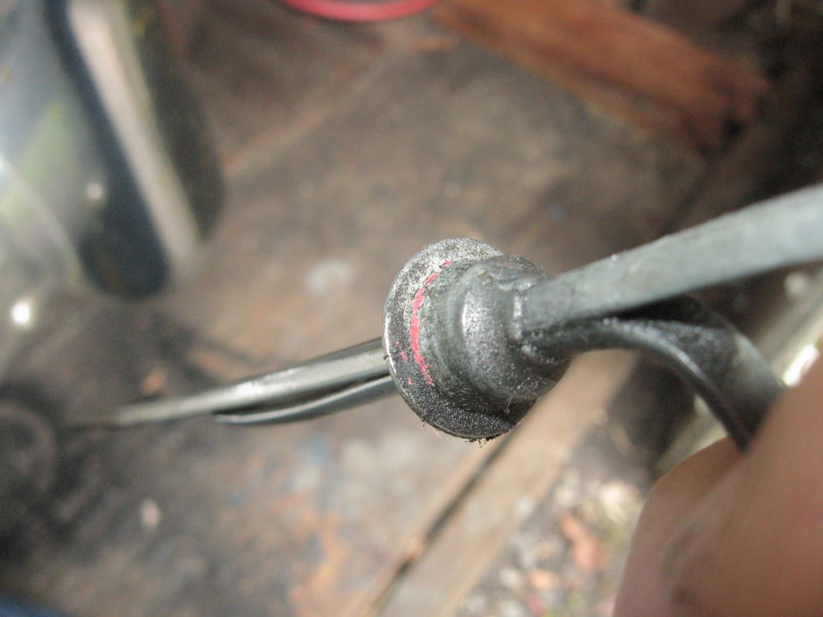

1960-only dipsticks had red-painted handles and usually have traces of red paint visible, even after almost 60 years. I don't see any red on your dipstick.
If you have the original transaxle, it is important to have the red dipstick, as the engine sits at a different angle than earlier 36hp engines and the oil level marks are different on the '60 stick.

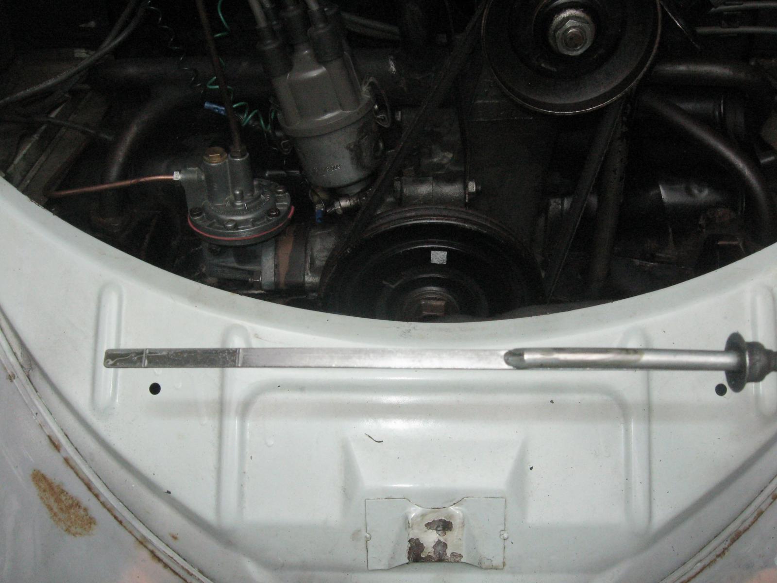

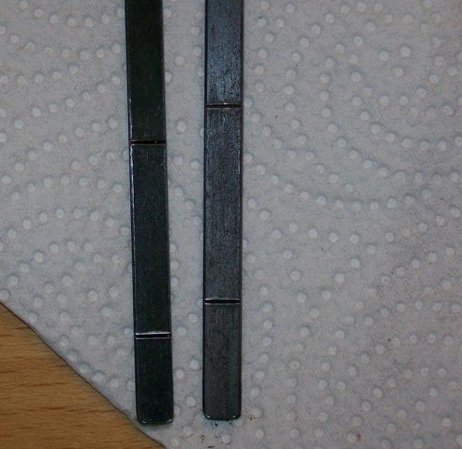

Pic from the gallery showing the '60 only dipstick on the left, standard 36hp dipstick on the right. The driveline angle was changed so the trans sat slightly nose low versus the previous setup where the driveline was level -- the dipstick marks were changed to account for the new angle. Using an earlier dipstick on a stock '60 will result in slightly overfilling the engine if you insist on taking the oil up to the full mark, maybe an extra cup to less than a pint worth.

This Beetle's dipstick has a touch of RED and has the lower marks too.
Hi Mukluk,
Thanks for the 60 vs 36hp dipstick oil level comparison. Do you know the measurements to the lines on each? I’m trying to find out what stick I have.
Also, what would be the correct fill line placements if I’m running a 1600 in my ‘60? Would I have the same drivetrain angle, and thus should I still have the ‘60 stick fill lines?
Regarding what level to fill your 1600-equipped '60 to, my best advice would be this: next time you change the oil in the car, preferably whilst the vehicle is on a level surface, fill the engine with as close as humanly possible to 2.53 quarts of oil and take note of where that level lies on the dipstick; that will be your full mark. Adjust the marks on your dipstick as required. Wink
