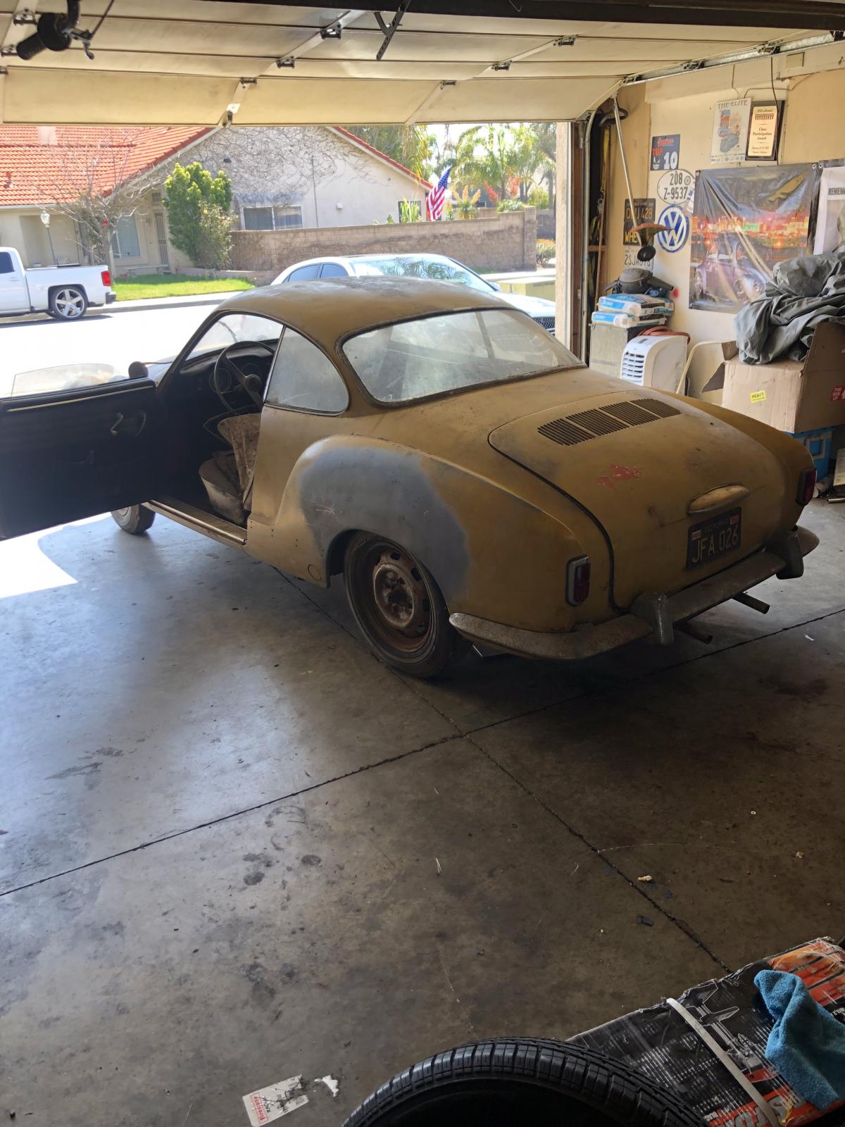

A few month back I was browsing thesamba classifieds thread on Facebook, and somebody had made a post that they were looking for a Ghia to buy, there was over 100 comments with pictures of ghias for sale and through the middle I saw this one posted for sale, I immediately messaged the guy asking how much and where he was located. Car was literally a few miles from me. So I went to check it out and bought it, guy even delivered it. PO stated Ghia belonged to his uncle since mid 70s, he lived in Fontana but worked in the high desert, and would use it for transportation when he would go to the desert. His uncle got sick so it sat since 83. Car is super solid no rust beside small spot under battery the size of a quarter, original 36 horse motor which I have got running now. Drivers fender was replaced at one point but luckily they used lowlight fender. Only thing missing was front bumper, front grill, and nose emblem. Had a type 3 long axle trans in it, but swapped it out for shortaxle full synchro trans I had laying around.

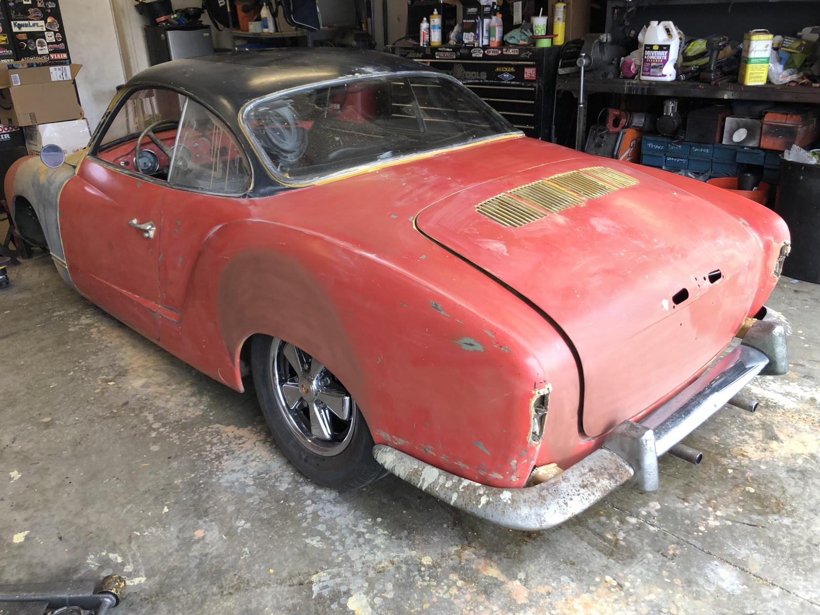

Decided to lower the car. Beam, spindles , disc brakes and drop spring plates with repro fuchs

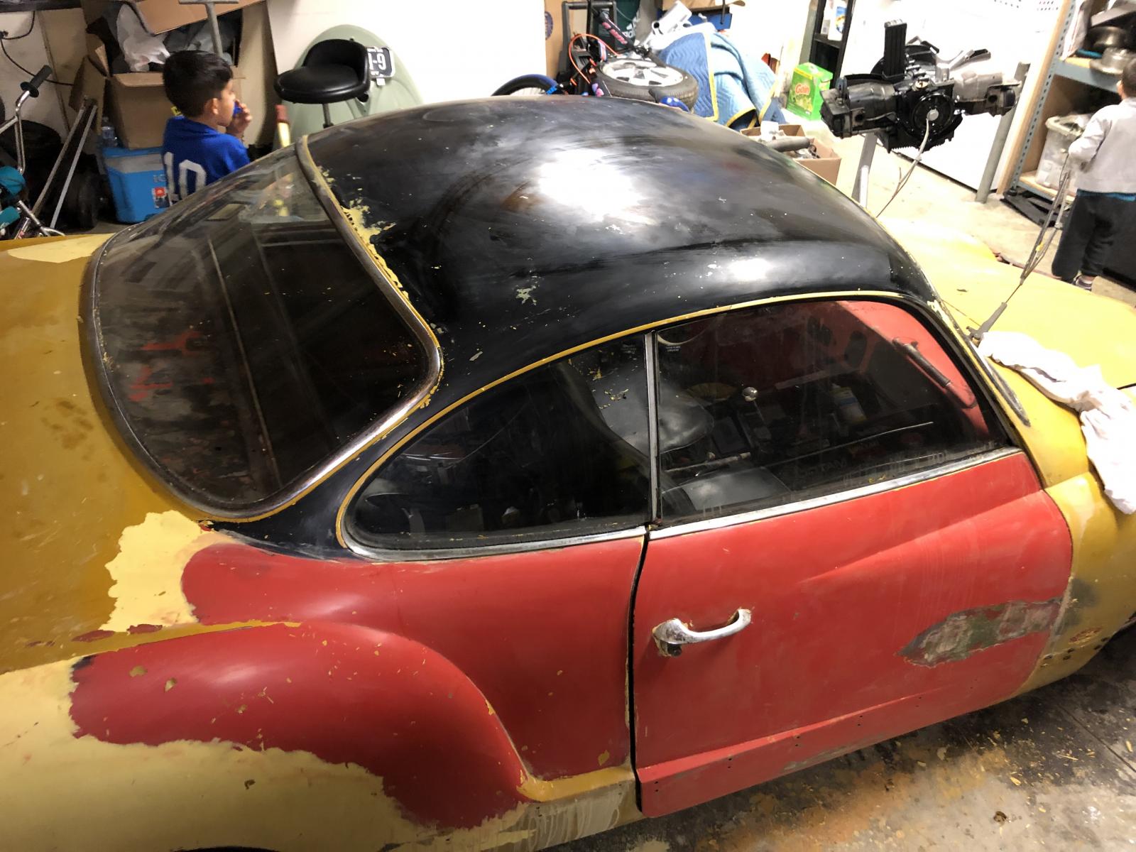

I hated the yellow it was painted and saw that og paint peeking through so we decided to do the tedious job of stripping the paint to reveal the original pelican red/ black roof, I will blend areas with paint I had matched.

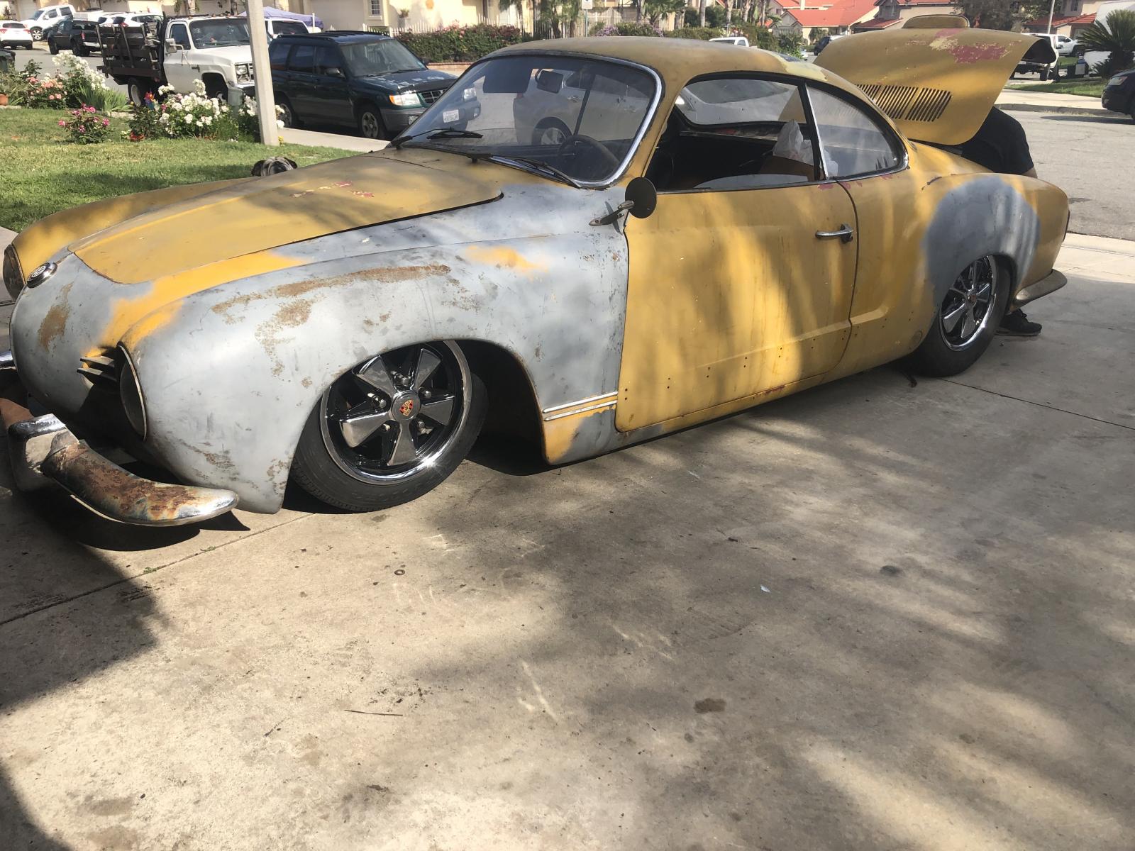

Was pretty happy the way paint was turning out, still have some details to work out
Got the car running pretty good with the original motor so I will be taking it to the upcoming Prado show

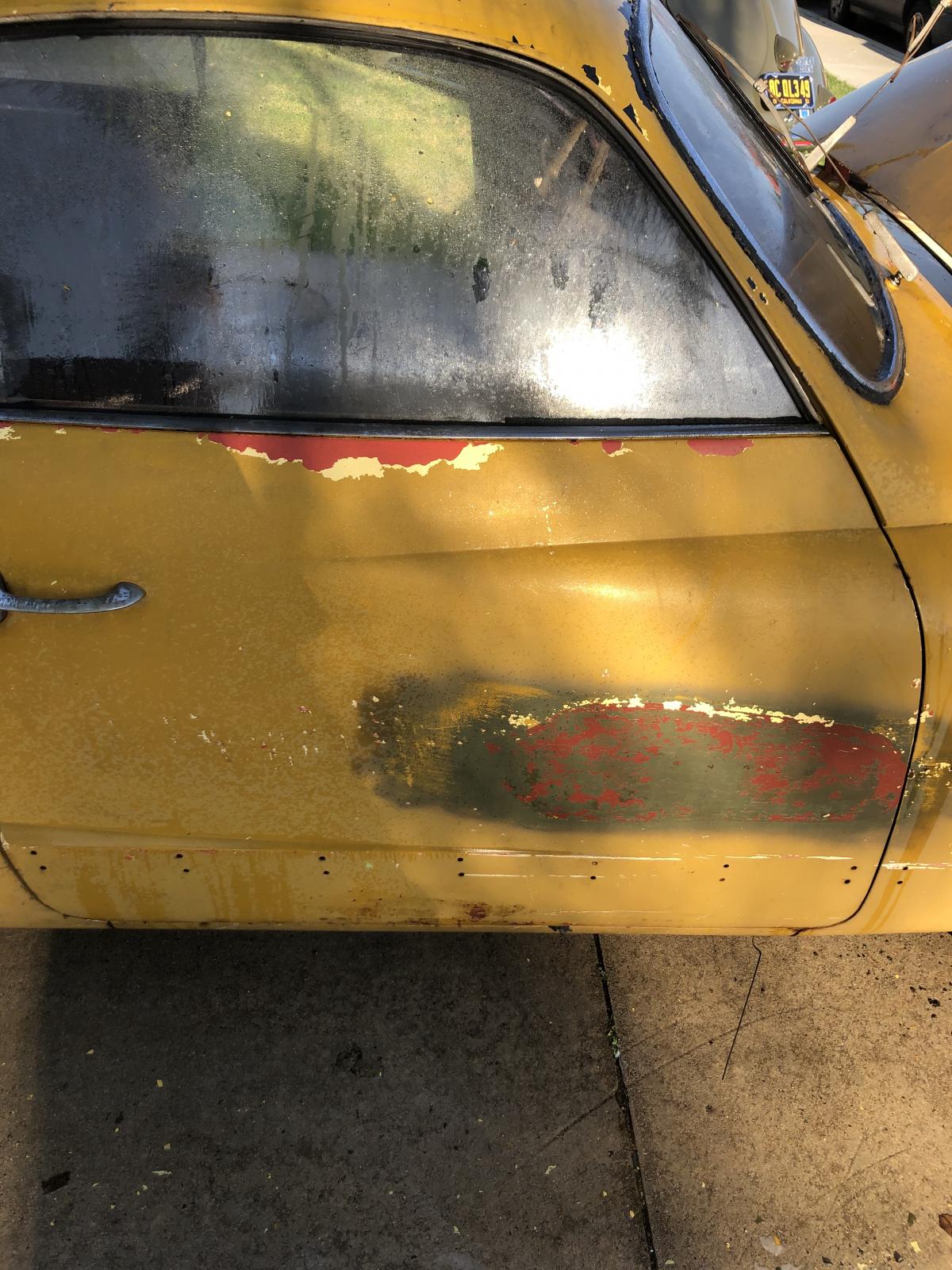

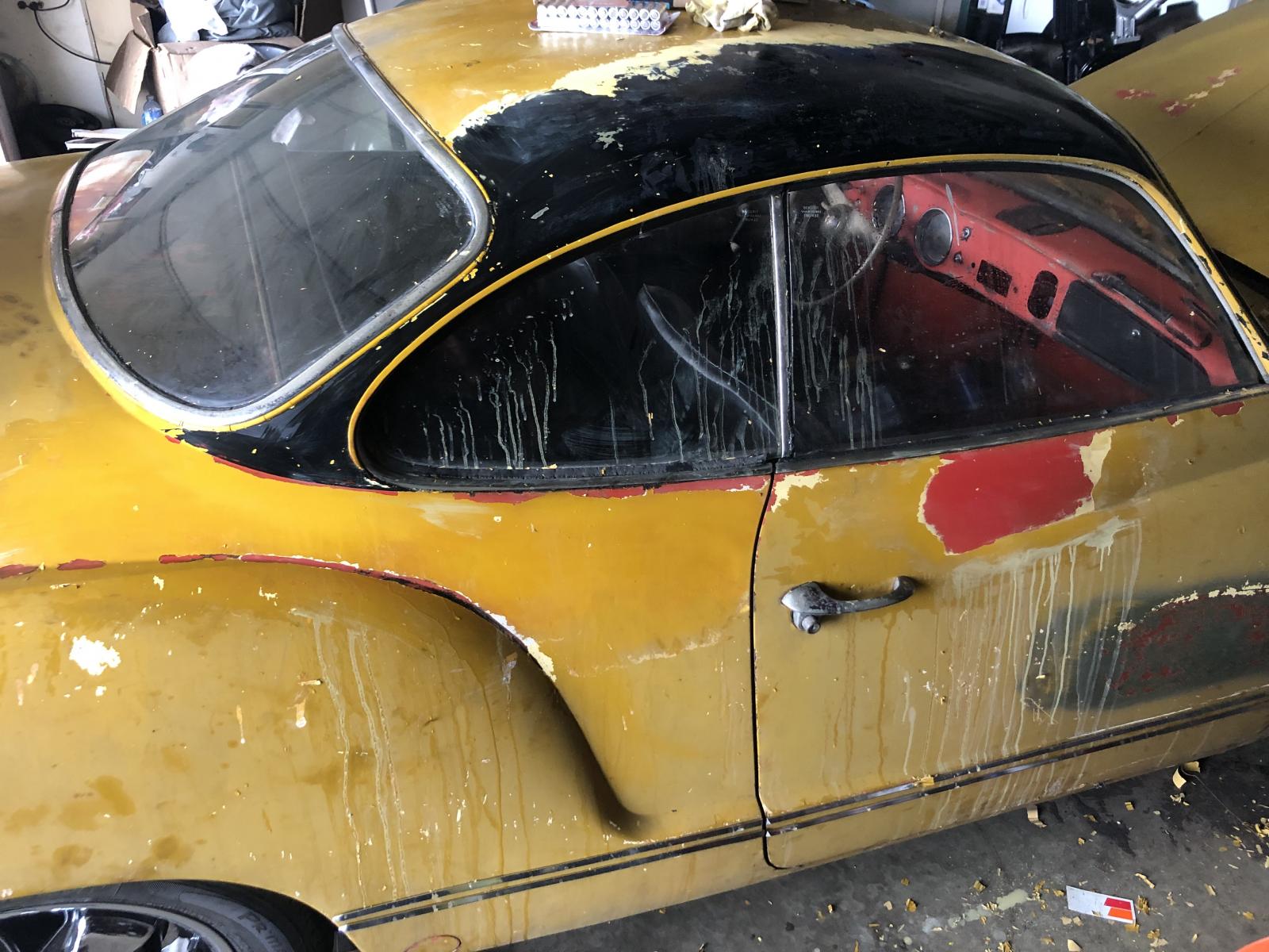

Thanks guys, as for stripping back the paint, luckily only has 2 layers, primer coat, then mustard color, the top mustard color came off easily with heat gun and scraper/razor. Lower parts of car was a little tougher, the primer were used laquer thinner and 00 steel wool, that part was rather messy and not too much pressure was applied being careful not to dig into the og paint
