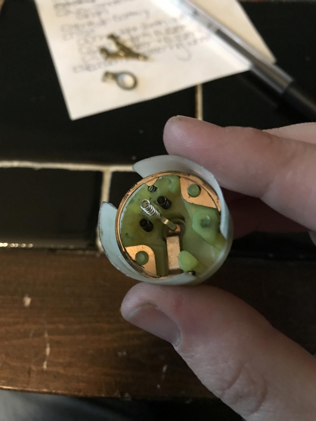

if you rebuild the switch, consider using dielectric electric contact grease upon reassembly. It will reduce wear, make parts move easy, which can reduce breakage.

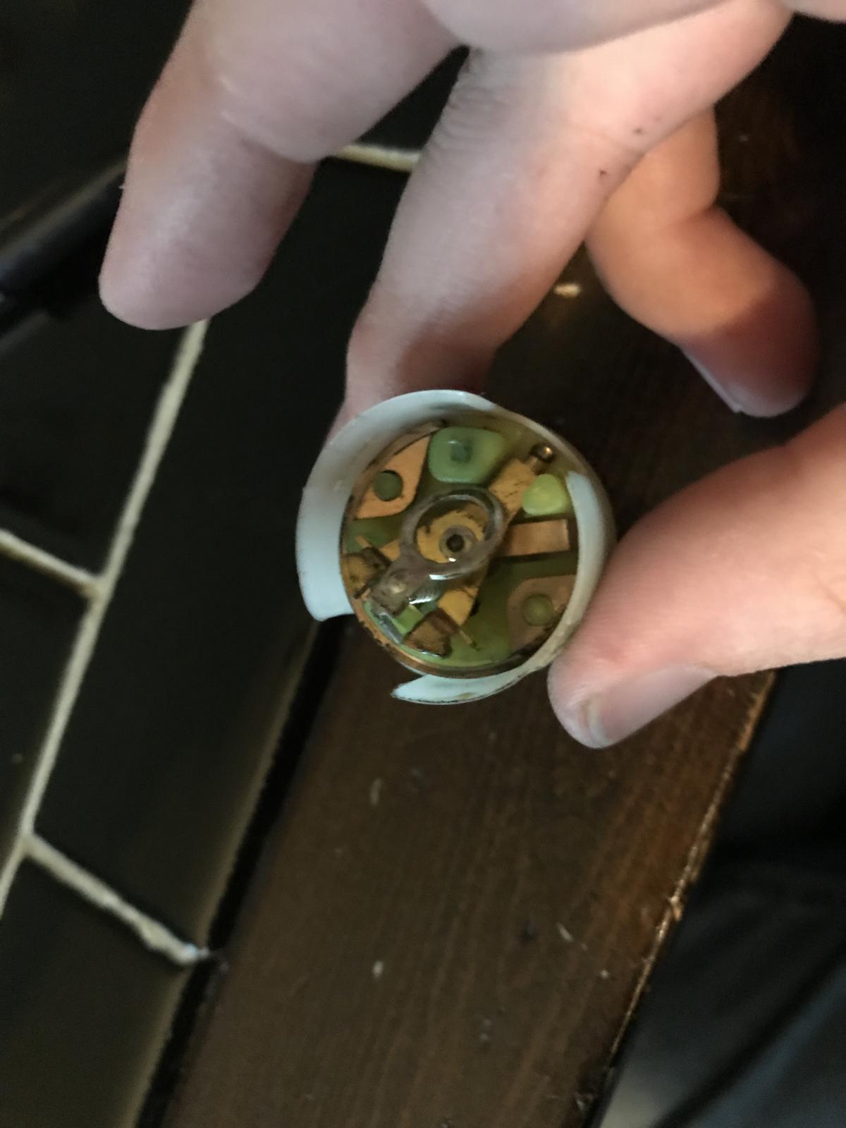

bnam wrote:
This is a great pic. It shows the LARGE rotating contact in the switch.
Do you happen to have the pic of the other side of the black backing of the switch? My OE switch, like yours, had LARGE electrical contacts in the base plate. This is a big step UP when compared to the more recent replacement switch contacts.

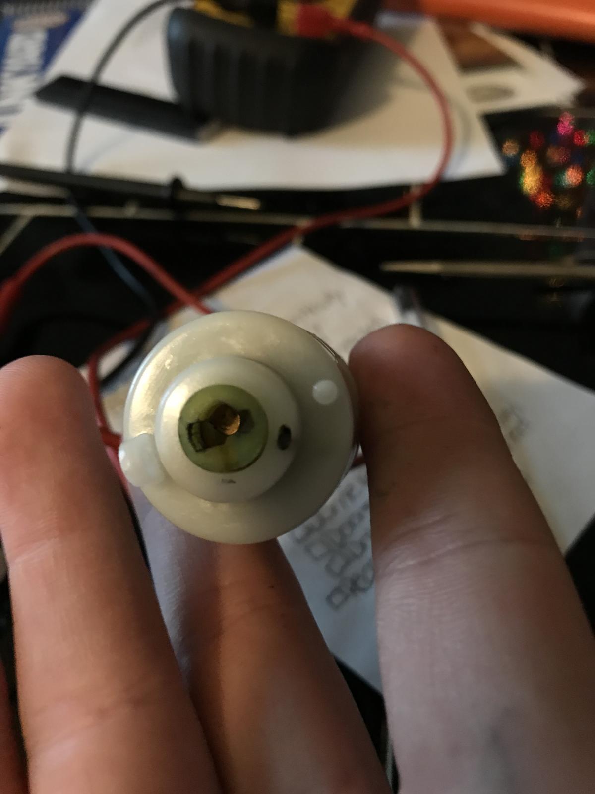

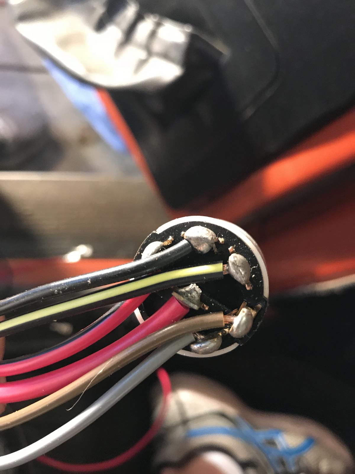

So after a hiatus, aka life, I’m back to trying to figure this situation out. I purchased what I thought was the correct ignition switch but has six wires as opposed to five. What am I missing?
Btw what is this HSR everyone says to buy? Sorry for my ignorance

As the ignition switch "evolved" more wires were added to provide more functionality. Some of the aftermarket replacement parts use the same later model switch for their earlier model replacements. This means you get additional functionality and more wires.
Basic wires since '68:
    red (30) - INPUT constant 12v source from battery
    black (15) - OUTPUT ignition switched 12v; power in ON/RUN and START positions
    red/black (50) - OUTPUT starter solenoid; power in START position
Additional wires since '68:
    black/yellow (X) - (added in '71) OUTPUT accessory switched 12v; power in ON/RUN only (powers headlights, wipers and blower)
    grey/black (SU) - OUTPUT to door switch/buzzer; ground while key is in the ignition
    grey - OUTPUT 12v while key is OFF
    *You should test the grey and grey/black (brown in your case?) wires to confirm their function.

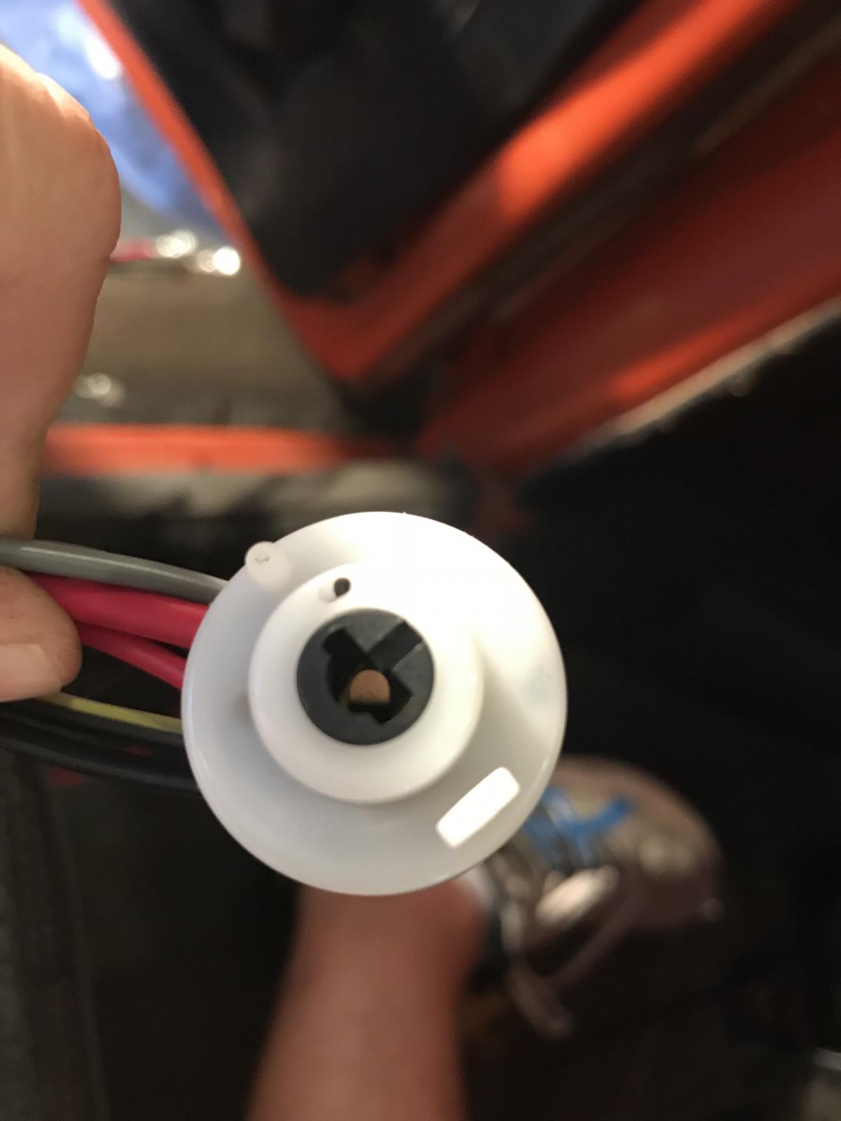

This thread was incredibly useful this afternoon, as I've been trying to get the buzzer circuitry working again on my (American) 1973 Super Beetle.
I have a later-style aftermarket ignition switch, and originally it was designed so that the key in the ignition would cause the S terminal to put out 12v. I did what Joel mentioned early in this thread and disassembled the switch, moving the plastic part from "outside" the buzzer circle contact to the inside, which left the buzzer circle contact exposed outside of the ignition switch. Now the system makes a ground like the original did.
This picture is from before I switched the plastic part and the buzzer ring.
Now the tab grounds on the outside!
