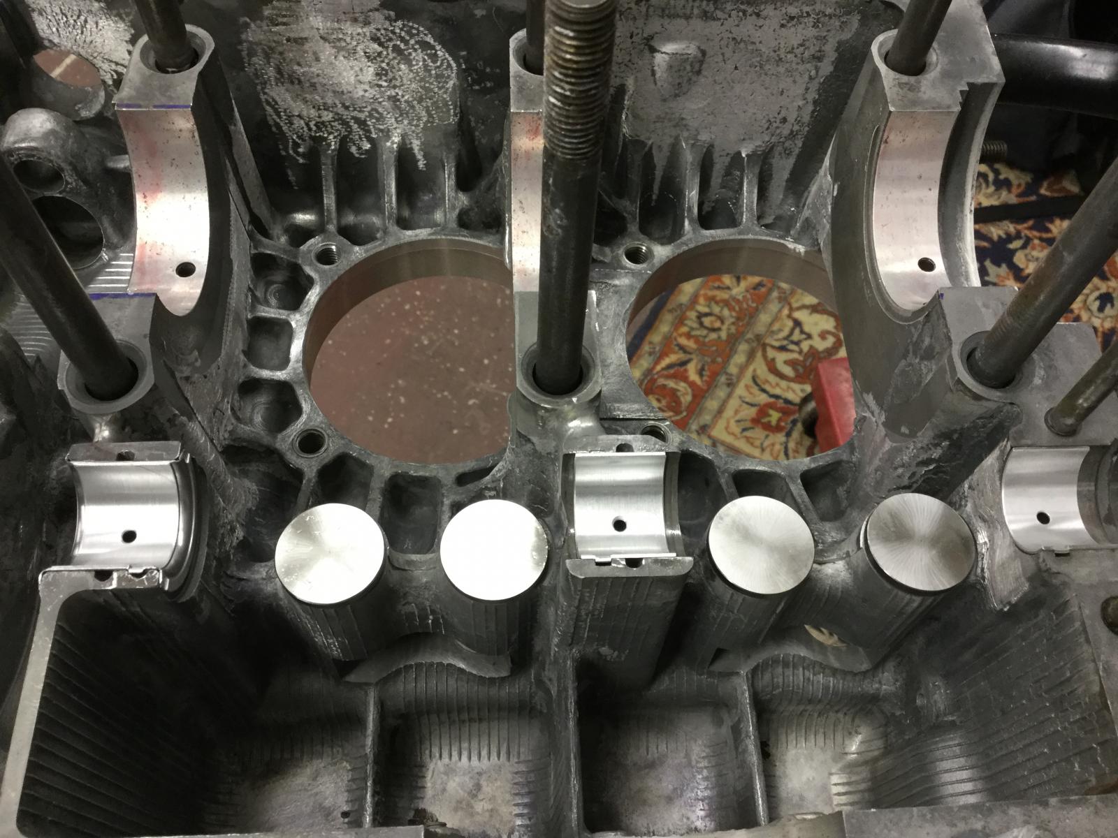

Ok tonight I went out and double checked the notching of the bearings, set the bearings in place, and marked them in relation to the dowel pins and checked for looseness in the dowel pin holes. All good!
I sat the cam bearings in place and had to notch the case for the double thrust bearings. They fit great.
When do you “set” the cam in place with the bearings? (Tap the cam on both sides to set the thrust?)
After the case is bolted up on mock up or while it’s open? I will also need to put the end bearings on the end of the crank.

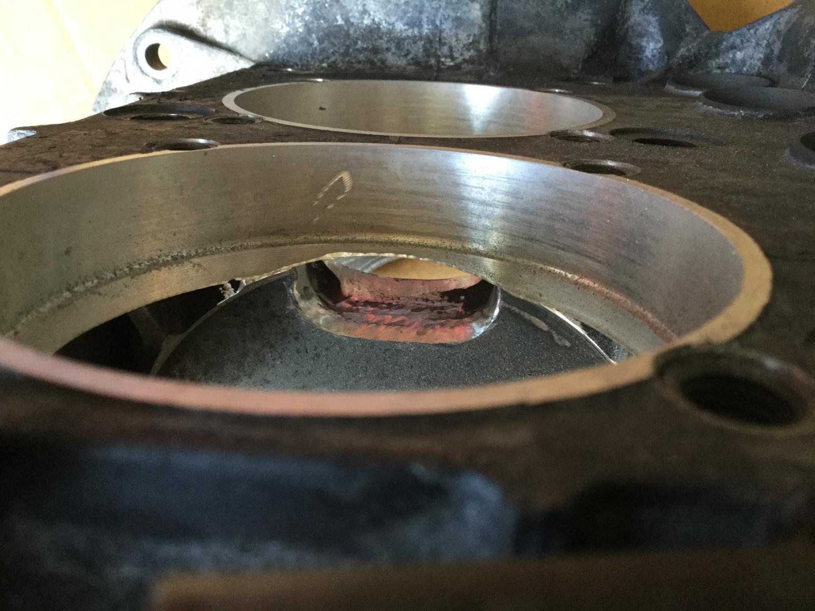

Ok today I opened the air transfer windows up to reduce turbulence.
The photos I’ve seen of people doing this seem to take the entire ledge down to being flat. It appears there is a “swoop” that directs the air toward the bottom of the pistons. I’ve taken pictures below that helps describe what I am talking about. I’ve left the angled metal in the case for now but will take it down flat if it’s better.

When I set the cam bearing thrust. I laid the cam and closed the case with the cam only in place. Torqued the case as well. I tapped the end of the cam through the cam plug hole rearward. Then tapped the other end of the cam through the oil pump opening. Opened the case up and checked the cam bearing thrust.
Super easy job.
Make sure to lube the bearing surfaces before setting the cam or crankshaft.
Keep your hands clean when working inside the case. It makes a difference.
Good Luck.

Yesterday I deburred the case, opened the windows up a little more, as well as opened up around the cam journals and top of case for airflow and cleaned the crap out of the case and the oil galleys ready for my first mock-up. Exciting!!!
Set the cam bearings in place and put some assembly lube on them. The cam didn’t exactly “drop” in place. The cam gear end “snapped” into place so I’m thinking it is a bit too snug-or is it because I haven’t “set” the cam yet? (Where people tap both ends to set the double thrust bearing into place)
I tapped both sides but it still feels a bit snug....let me put it this way-it doesn’t turn easily and I’m guessing that isn’t what I want.
Also, I dropped the lifters into place with some assembly lube and most move up and down nicely but 2 are a bit snug as well. Question is: do I sand the lifter bores or the lifters themselves? I would think a lifter could be replaced and the bore cannot.

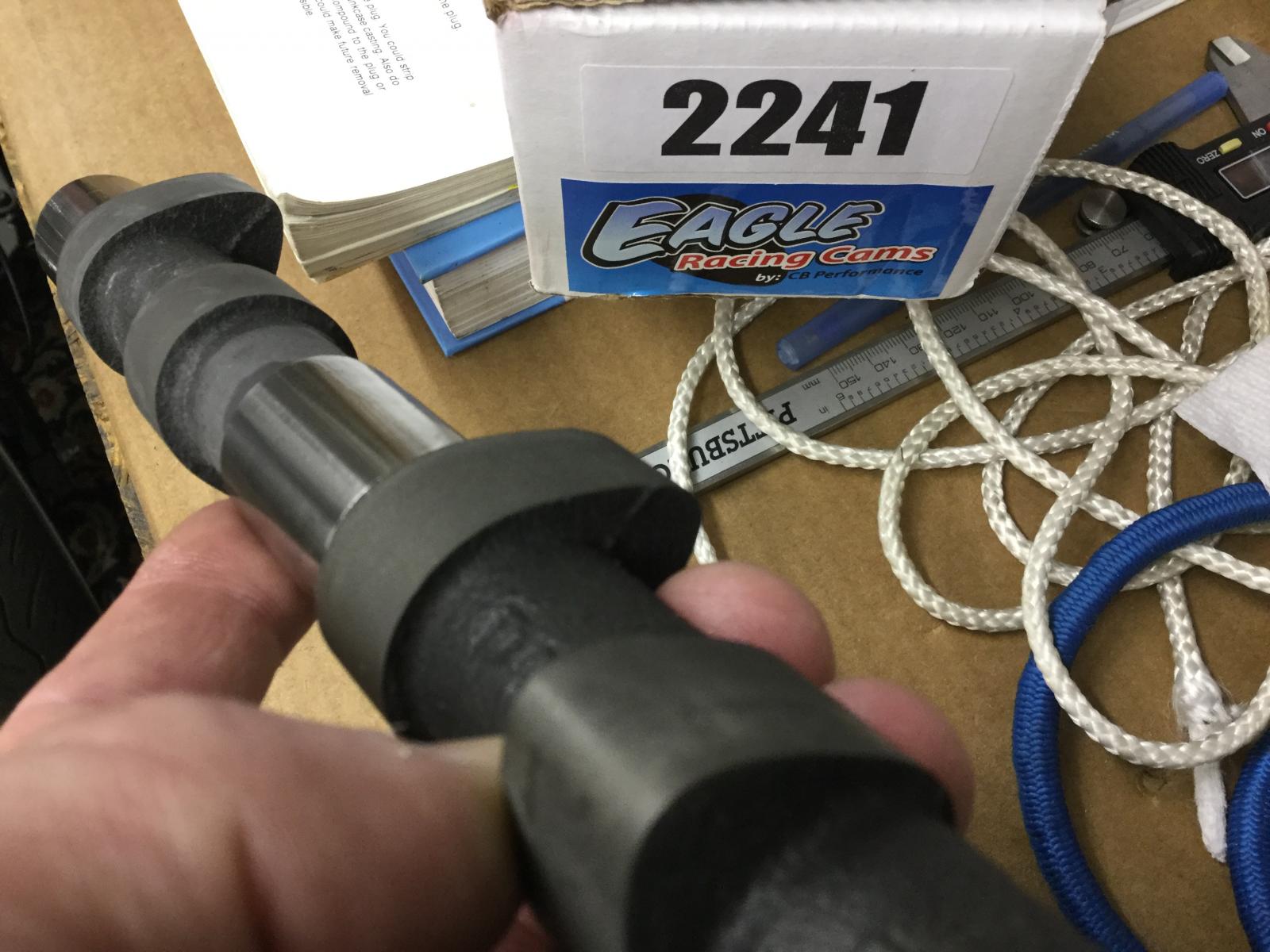

Also, do people deburr the cam? I was thinking a slight bevel on the CORNERS?
I had read that the factory did it on the stock cam and it might be a good idea...

The CB cam I got was very sharp at the lobes. deburr for sure. I used a Dremel tool with a stone to knock down the edge all the way around.

Just did. I sat reallllly still on the ground and cradled it like a baby. Haha
Turned out good. Got to go to work.
I used some scotch brite red in the lifter bores and they are great now without any wobbling

Try putting one of your cylinders into a hole to check what the bottom of the cylinder looks like in place.
Sometimes you can open up the window only so far before the bottom of the cylinder is blocking the flow anyways..
GOOD POINT MAN! My machinist left the lip so the sphigot? the cylinders slip in had a little more strength-I never thought of that. Any thoughts on this lip in the windows? I’ve seen them ground flat but it angles up like it’s there for a “reason”?

I'd just be looking and thinking about how the air moves under the pistons..
Adjacent pistons on the same side of the motor move opposite of one another.
The volume of oil/air underneath the piston has to either compress, or go somewhere else when the piston goes 'down'.
Because there is an adjacent piston next to the other on the same side going the opposite way.. The windows are there..
Unfortunately,
On the opposite side of the motor, one would hope that there was a piston going the opposite way.
I.E. #1 would see a rising piston at #3 cross the case from it when it was dropping,
But,
Alas,
The opposite side of the motor has a piston dropping as well,
And the windows are the only way to move the air under the pistons as they move..
So,
You basically just make sure that the flow from adjacent cylinders is as free/easy as possible.
You'll want to open up and smooth the windows, and any other places, as much as you can, without weakening the case.
Unlike porting a head, there's not the consideration of velocity at work.
You basically just want to hog it out as big as is practical and polish it up..

I was unable to get the cam to turn by playing wack-a-mole on the sides of the cam so I had to sand the faces of the bearings down a tad.
I got some wet/dry and a piece of glass and gave each bearing 10 free rides on the bumpy stuff. Cleaned them up and put them back in the case. Torqued the case down and guess what?
It still didn’t turn!
Just kidding.
It turned freely but has like very little endplay? It spins fine though!?

Ok, I dug the crank out and decided to double check my main bearings.
Ok here is where things start to go weird.
I laid the bearings in their journals and they fit perfectly so I marked the dowel pin hole and the sides with a marker. I checked the dowel pins for looseness and they are good.
I had already notched the bearings for better oil flow and they all looked good.
I decided to test fit the thrust bearing? on the end of the crank and ..........
It doesn’t fit.
In fact I tested all of my bearings and none of them fit.
I chamfered the edges on the cam. Should I do more or is that enough? I also dropped the lifters in their bores and made sure each one fit. Once I had each one moving smooth as butter inscribed the bore and lifter to keep them in order and not mix them up. I also checked the clearance between the cam lobes and lifters. The cam is very mild so didn’t have to worry about clearance issues there.

What does the bearing box size say?
What size is the crank?
What size is the case bored out to?
Jimbo

The case was bored .020.
111-198-475T is on the box.
M1-4904TP 020 (probably .020)?
I realized I’m gonna have to sand some more off of the cam bearings to allow for expansion. The cam gear is aluminum and the bearings are steel. I believe I need .004-.005 clearance?

Potential mistake! Putting the cam gear on...dot goes up top and the last lobe must point down. Gotta check on that one. That would suck for sure.
Whew! Got lucky! I’m good.

Ok, I received the new main bearings and they fit! Yeah!
I also (based on others recommendations) purchased new cam bearings. They haven’t had much luck with the Silverline ones.
I notched the mains last night and installed the Mahle cam bearings. They felt “beefier”. Not sure why.
I DID have to sand the thrust a tiny bit. Cam spins free and I have clearance in the thrust now.
