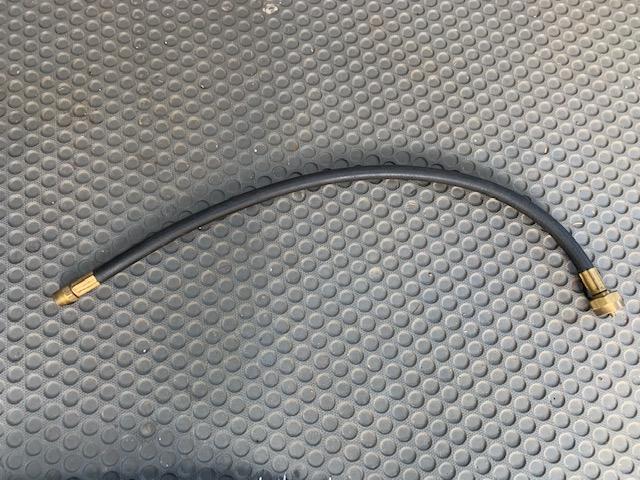

I had a local propane company make me a short "rescue" hose for connecting 1lb bottles. It's long enough when attached, to let a 1lb propane bottle lay on the ground next to the van. I think it cost me around $15. (I call it a "rescue" hose because it rescued my breakfast one time when I ran out of propane right in the middle of cooking breakfast.)
The large fitting connects to the 1lb bottle and the small fitting connects to a "T" that is plumbed into the system BEFORE the van's propane regulator (2nd photo)The square thing in the middle of the photo is the plug that lives in the t-fitting when the rescue hose is not in use. I don't remember what size the small fitting on the hose is, but when you go to the propane place and ask them for a t-fitting that will fit "in-line" on your van, you can also have them match the t-fitting female port to the male fitting on the rescue hose.
Hope that all makes sense.
