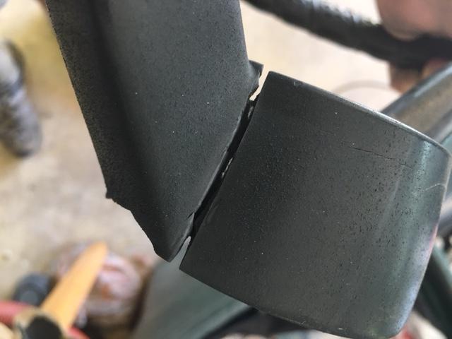

As you can see in the various pics, stress cracks in the usual places where the arms connect to the base, as well as damage I had around the ring or hub connecting areas. Before filling with epoxy, at the advice of C21Darrel, I took my Dremel tool and opened up the cracks wider, in order to push in more epoxy, as well as trying to terminate the cracks from spreading further.

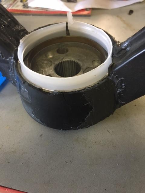

For the areas where the wheel joins against the hub and the chrome horn ring, where I was missing one side of the lip, I fashioned a plastic form using a piece of flexible plastic I cut from the lid of a Bondo can. Because I had to repair both sides, this went over a couple of days, doing each side at a time, allowing one side to dry before flipping it over:
Hub side:
Top or chrome horn ring side:
I wasn't sure if the epoxy would stick to my form ring, so I waited a few hours to let the epoxy harden a bit, without deforming the edge I made when removing the form. I checked the hardness by lightly touching the outside while curing, and moving the form slightly to ensure it wouldn't collapse the edge I was setting up.

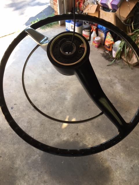

And a few coats of black semi gloss paint, allowing a good dry time between coats. And Vuola! Finished product:
May not be the perfect professional job, but again, I know I did it and can only blame myself for any screw ups, knowing I can fix any further damage.
