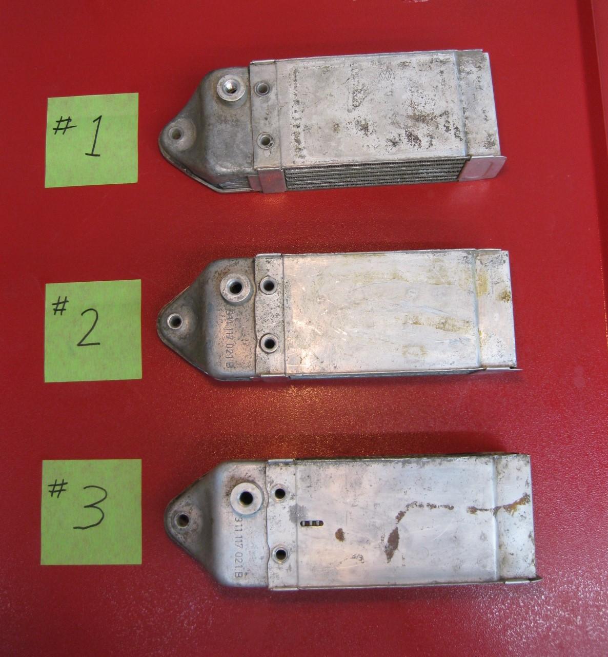

Here are three oil coolers:
#1 is date coded 9/68 with no part number stamped on it
#2 is date coded 4/70 with part number 311 117 021B
#3 is date coded 11/70 with part number 311 117 021B

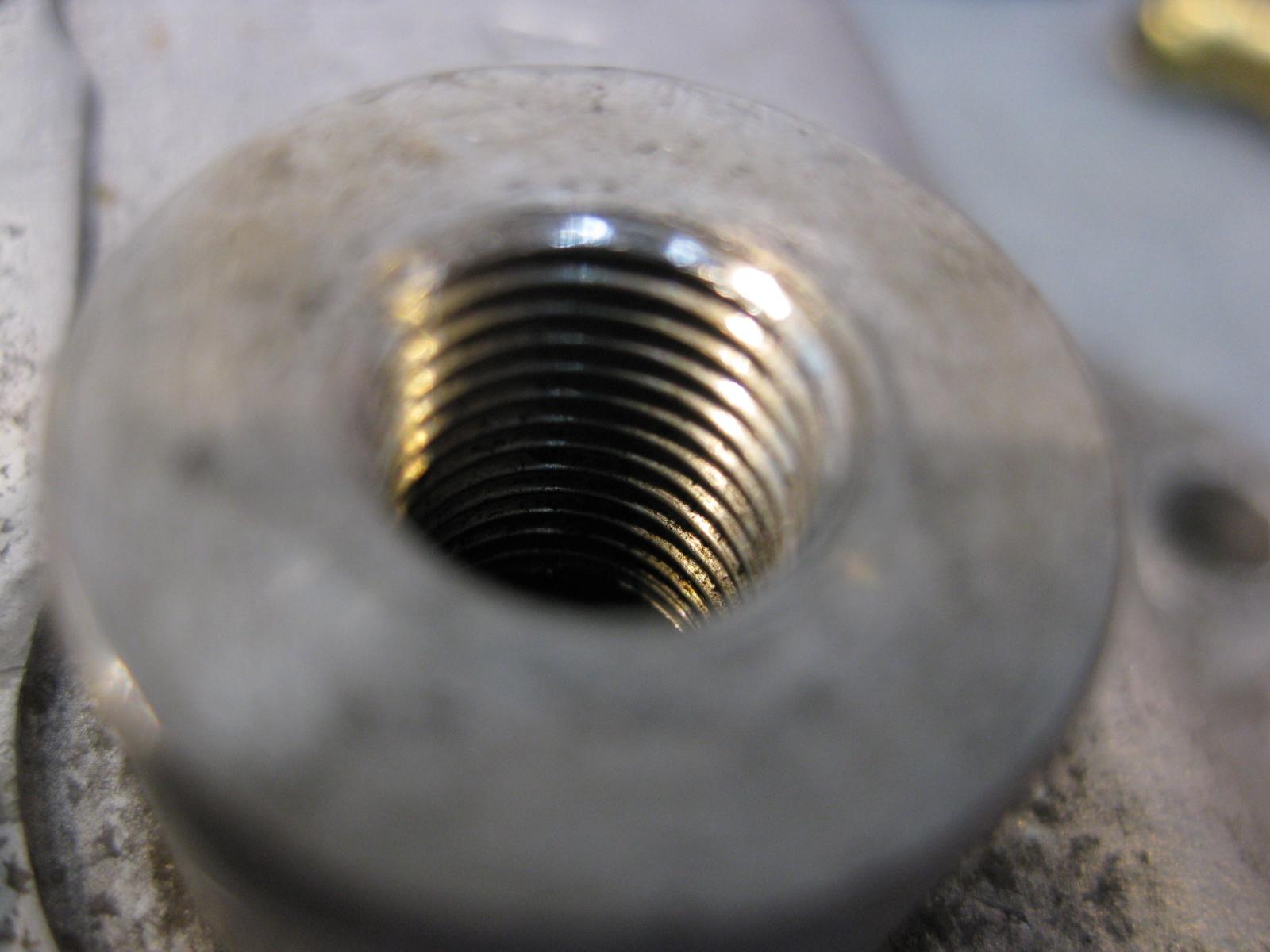

So #1 has 8mm holes, and #2 and #3 have 10mm holes; as expected.
Here is a close up of the difference in hole size:
Looking at the side view, I noticed something that I had not seen documented:
Lets look closely at a difference between #2 and #3:
It seems that he number of fins changed from 76 to 58 starting with the '71 model year.
With no change in part number suffix.
So earlier coolers had 76 fins even through the change in hole size, and then they changed to 58 fins.
I can attest that it is easier to clean the dirt and grease out of a 58 fin unit. Smile
And note that the larger "type 4" coolers also have 58 fins.

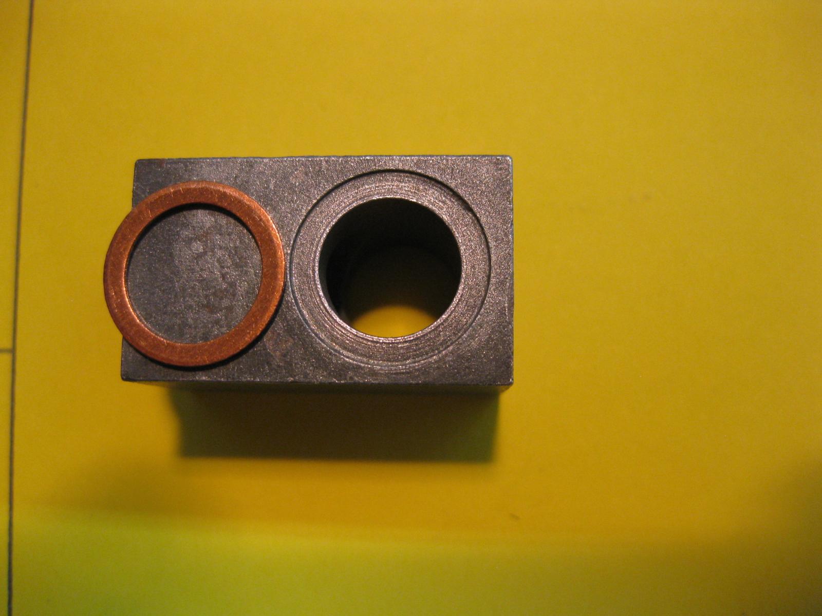

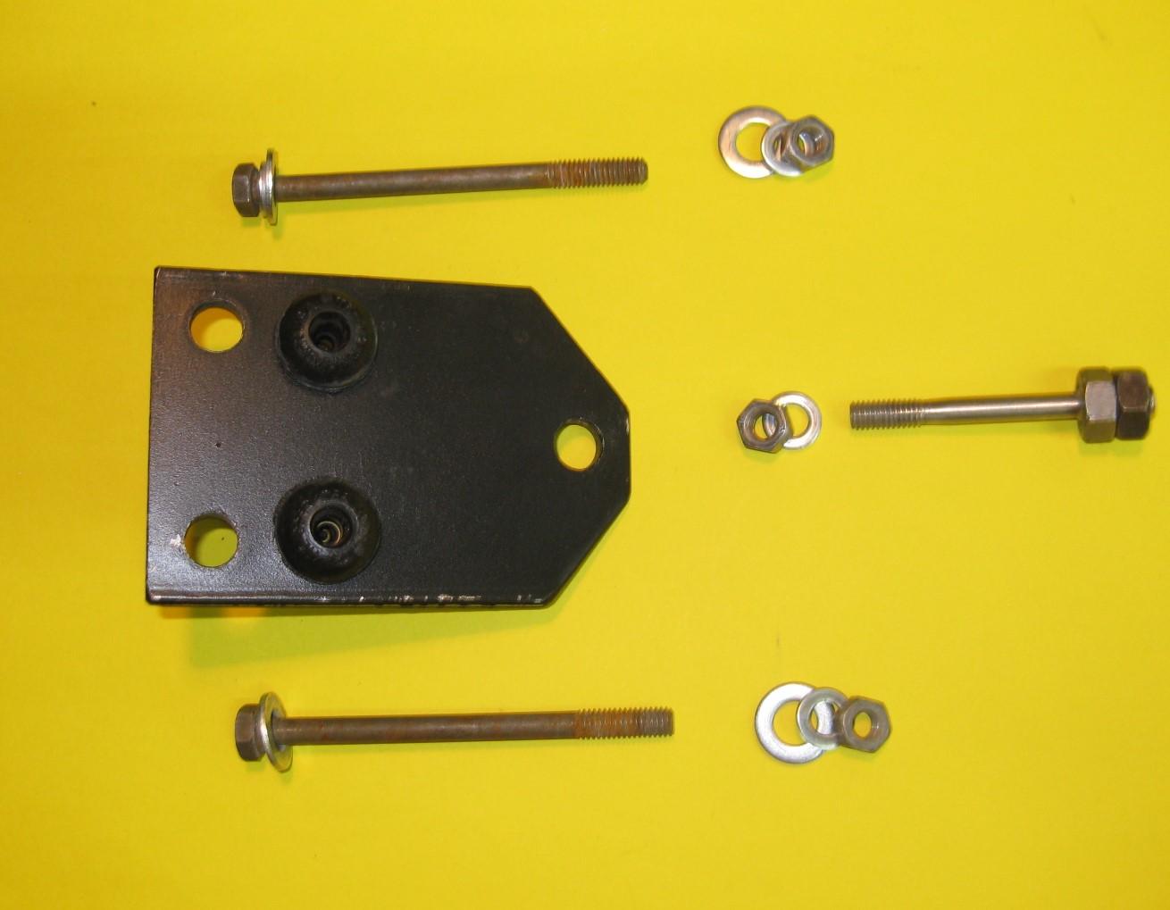

Here are the rest of the misc parts that are involved.
And some details about thread pitch:
And how the Adapter Block is stacked:

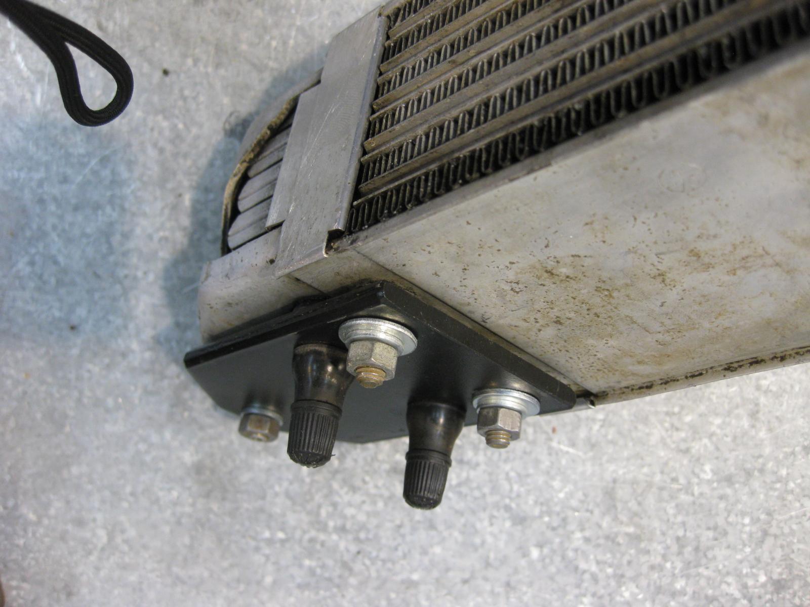

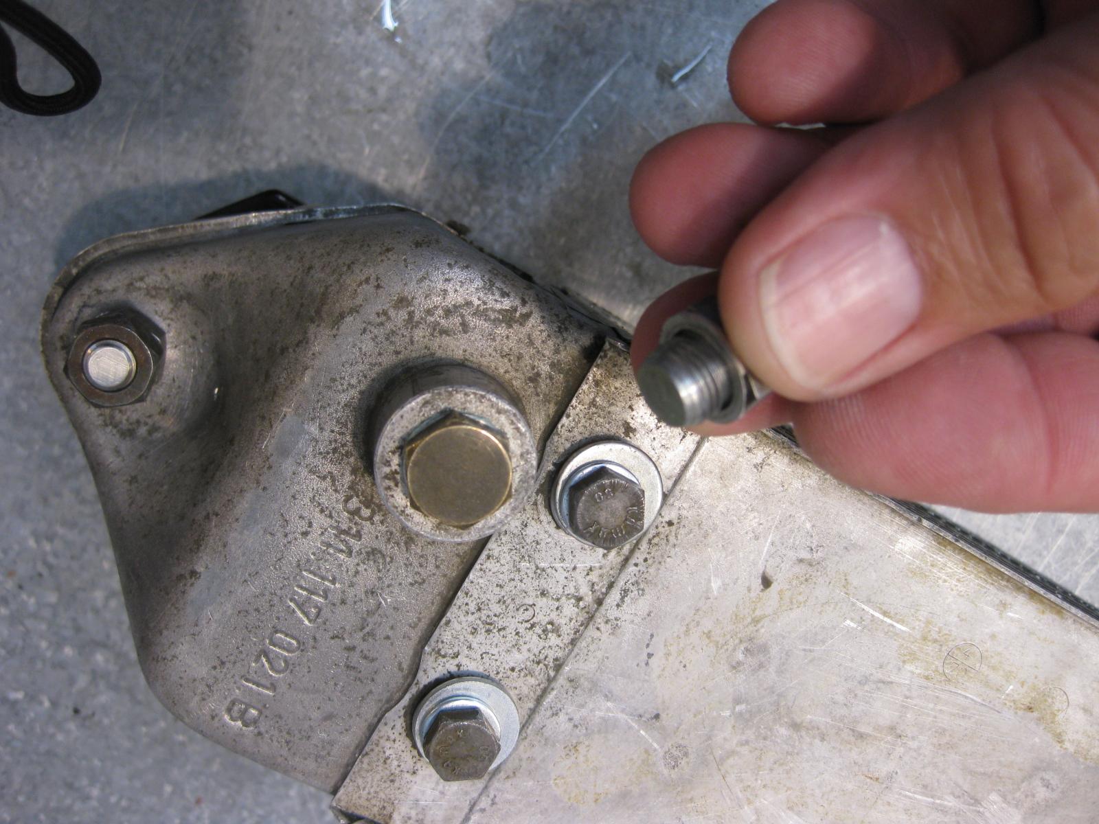

This is the process I used to test my collection of Type 3 Oil Coolers:
I used my tap to clean up the boss threads:
I used a small 10mm x 1.00mm pitch plug to plug the boss. You can find this plug in your pile of parts left from taking some solex carburetors apart:
I used a dab (end of a q-tip amount) of Gasoila on the threads, along with a used 10mm sealing washer.
I gathered up the bolts and washers need to attached the pressure testing plate:
Attached the testing plate:
A bit of liquid dishwashing type soap where the schrader valves contact the aluminum to help that interface seal.
The Blue Bentley indicates a test pressure of 85psi. I figured 60psi was good enough. So pressured up the unit and set it down underwater in the sink. Swished it around to get any trapped air out of the fins. After several minutes with no evidence of air streaming from the unit, I felt it was good:

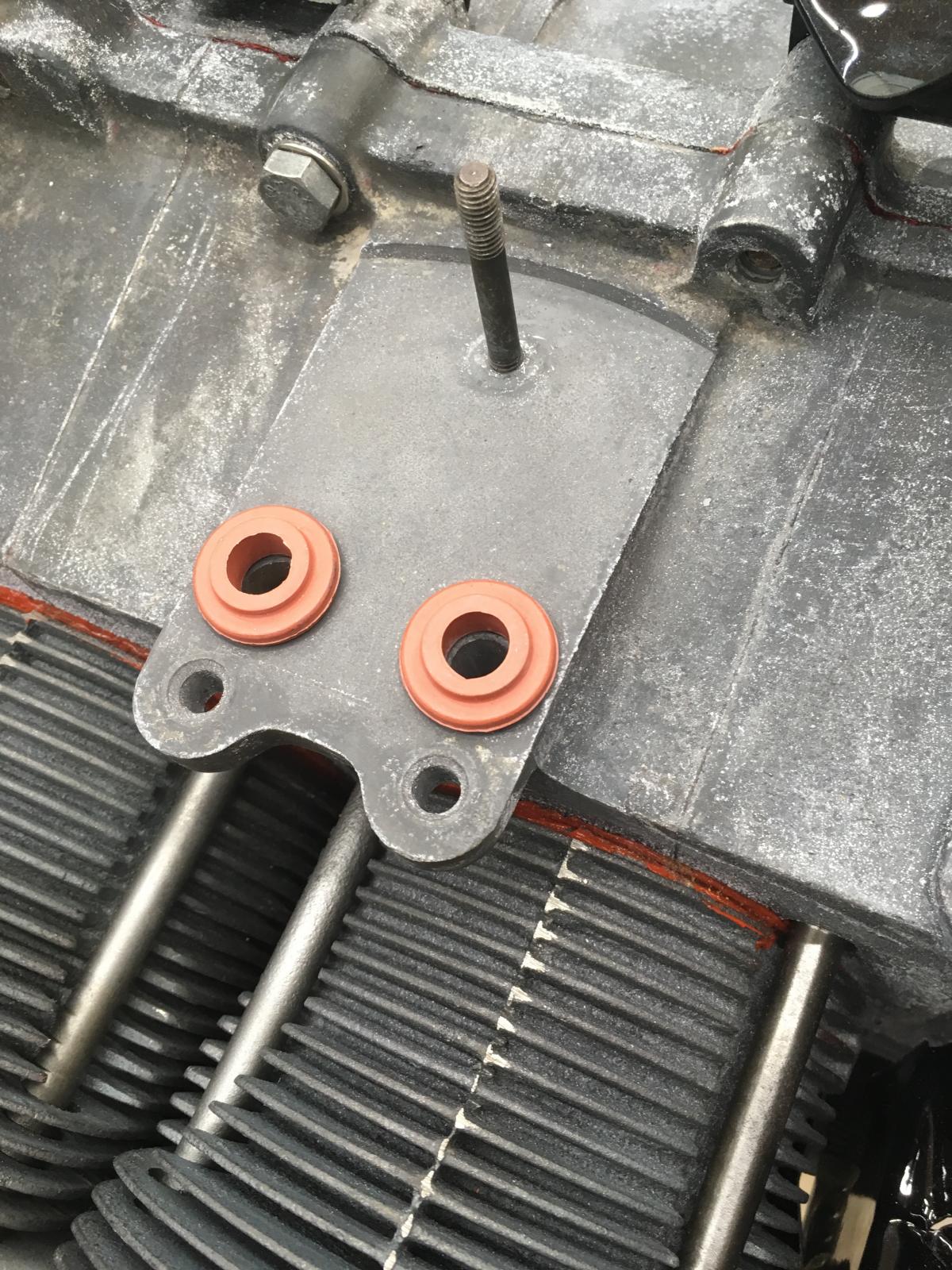

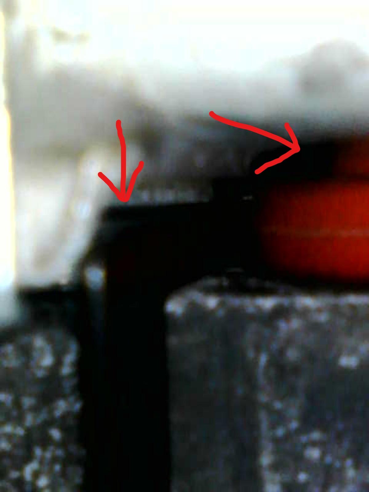

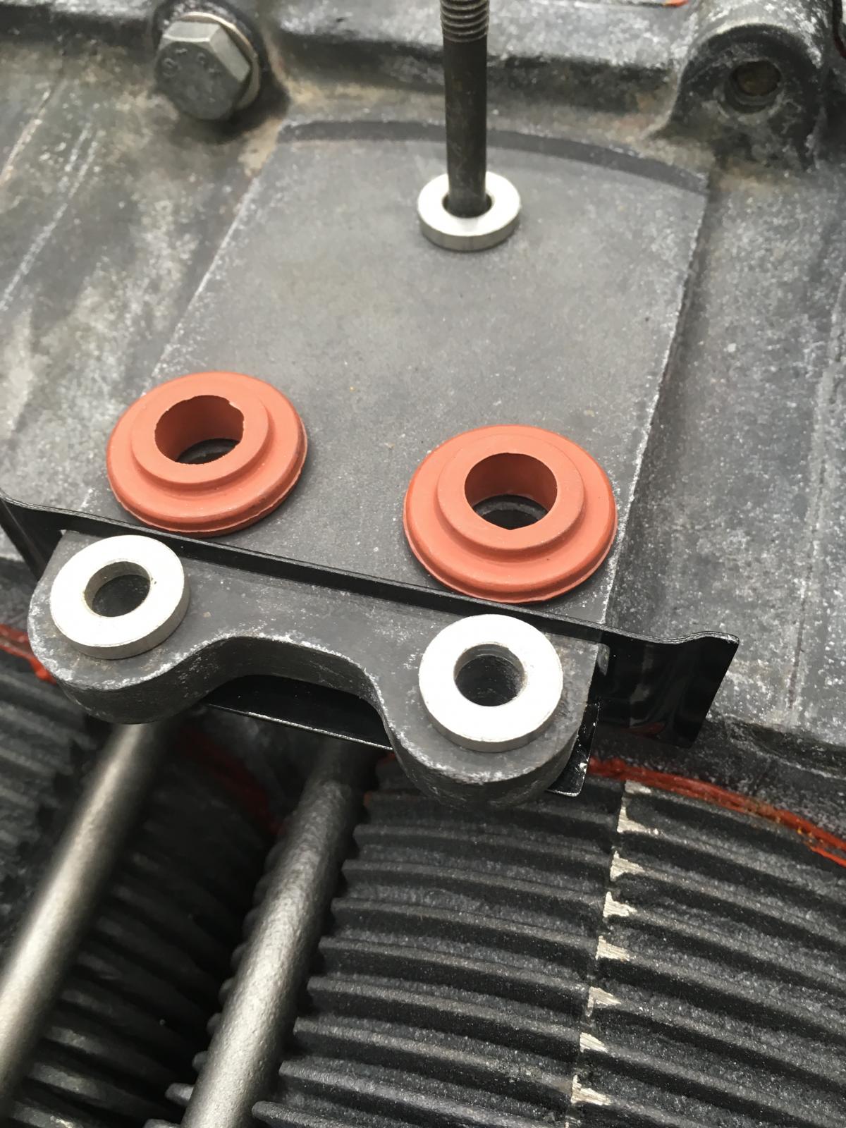

Installation:
From the FAQ regarding Oil Seals; I know what the correct combination answer is. But, I'll go through 4 different scenarios to demonstrate.
The Blue Bentley, the Brown Bentley, the Haynes, and the Clymer manuals can all lead you down a bad installation path if you are not aware of the details in the Oil Seal FAQ and what is shown below. All of these manuals make a point that you should install the oil cooler Spacer Rings and the Deflector Plate.
I have a later model case (U50304920) that has 10mm oil passages in the case, with a 58 fin, 10mm oil passage oil cooler. From the Oil Seal FAQ we know that I should use the thin red 021 115 171A seals, omit the spacer rings, and I add-omit the deflector plate. Here's why:
Four scenarios:
Scenario #1 has the deflector shield and the spacer rings:
Installing the oil cooler we see that the deflector plate is holding the oil cooler up off the seal. The thin top piece of the deflector plate that is above the flange is just slightly thicker than the spacer rings:
(Sorry for the out of focus picture, by the time I realized it was too late and I had moved on.)
Maybe there is a deflector shield that doesn't have the top section? I don't have, nor have seen one made that way; and a third style deflector plate isn't documented in any of the literature I have access to.
Well, that's not going to work.

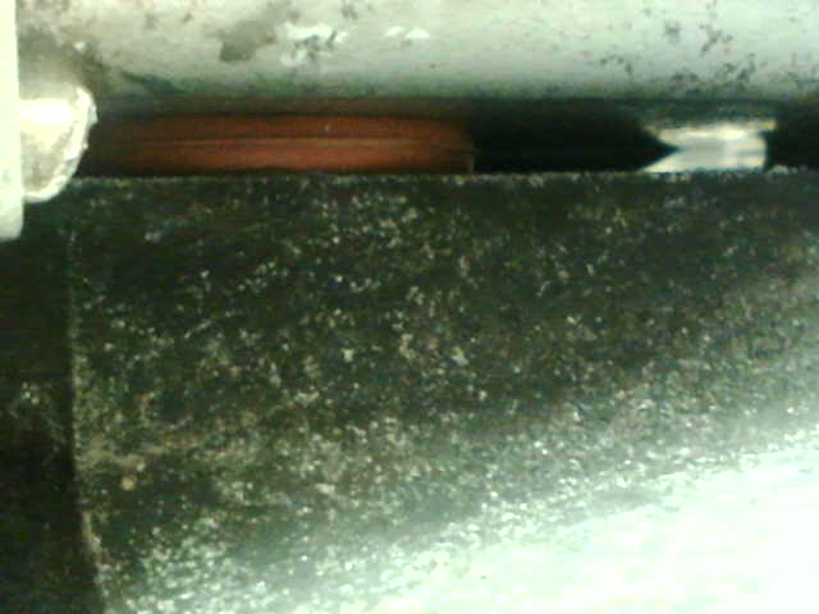

Scenario #2 has the spacer rings, but no deflector plate:
We see that the rings hold the oil cooler up off the seal:
This scenario isn't going to work.
Scenario #3 has no spacer rings and no deflector plate:

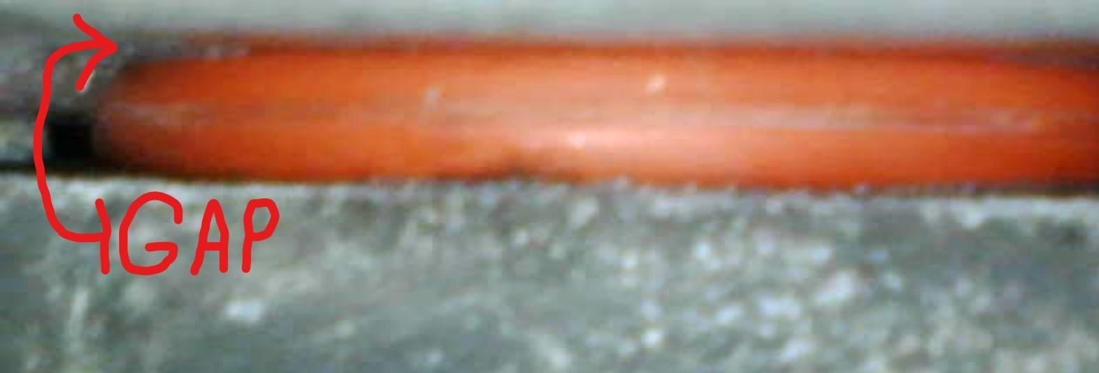

However, there is a slight tilt to the cooler to seal interface with just a hint of gap:
That might work, but seems less than ideal.

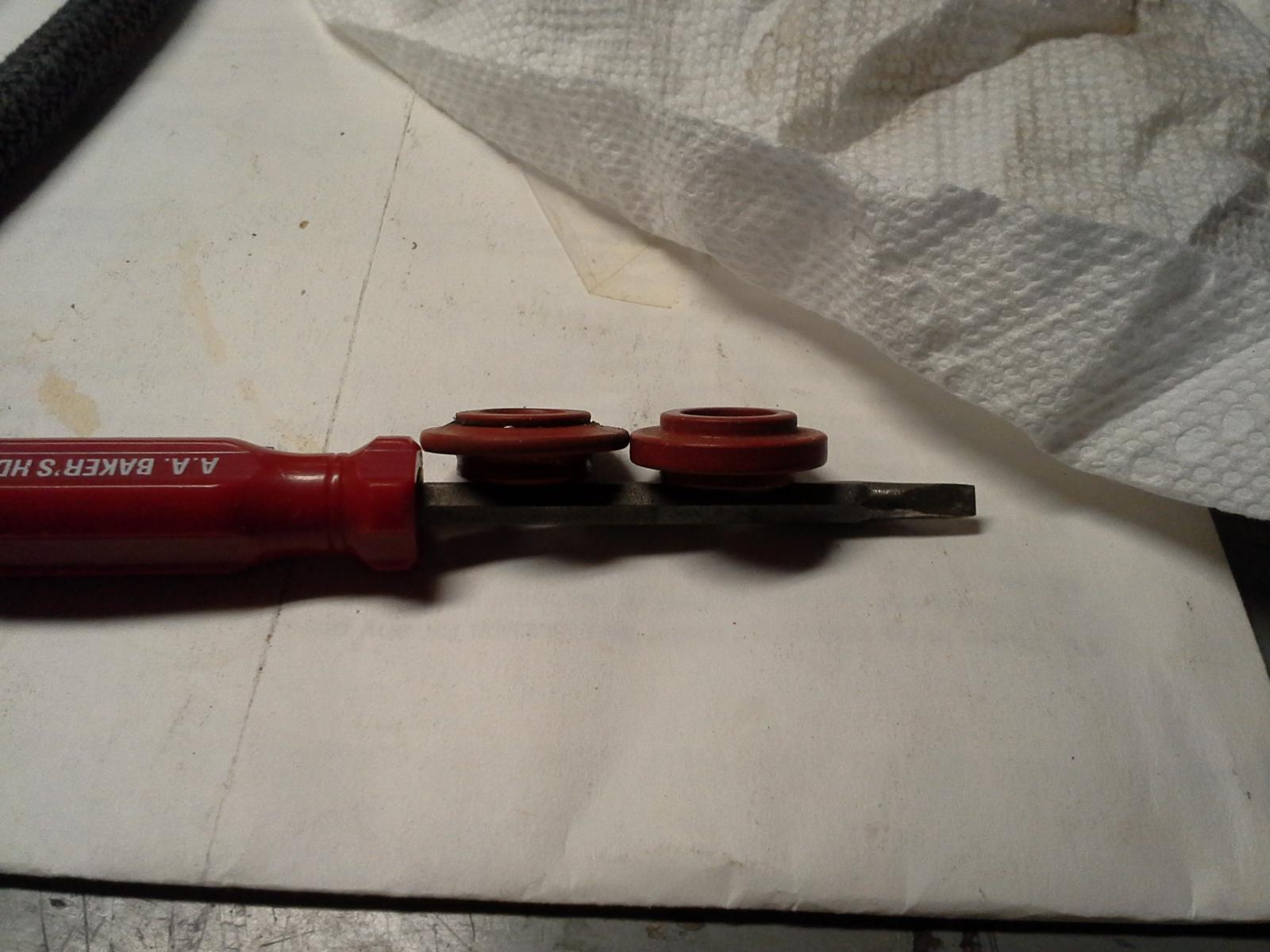

Scenario #4 has a standard thickness 6mm washer on the stud that passes through the nose of the oil cooler:
This results in a nice even compression of the seal:
The oil cooler is down tight against the flange:
The main bolts are stacked with a washer on top, a washer on the bottom, a spring washer on the bottom and a self locking nut (not one with plastic insert):
The nose of the oil cooler is down snug on the washer:
The gap between the case and the oil cooler seems consistent:
I note that the bottom side of the oil cooler nose boss is chewed up from previous installations. If I had a perfect cooler; maybe the washer would not have been needed.
For now, I'm satisfied with the installation. I'll report back if issues occur.
As always, comments and/or questions are welcome.

This issue.....this question of "spacer" or washer....between case and cooler...or on the outside under the nut.....has been rattling around for ages. It also not just a type 1/type 3 thing. It a type 4 thing too.
I have seen both type 3's and type 4's that came ...KNOWN to be un-disturbed from the factory with the spacer (and it IS a spacer) between oil cooler and case...and on the outside of the oil cooler....and both were correct and neither leaked.
Here is the same thread and discussion on type 4 engines. If you want to see my pictures and analysis...drop to the last page...where I think this link takes you.
Anyone who tells you ...authoritatively....that its ONLY correct...when installed one way...is full of sh*t. Wink
Too many differences in coolers and cases. I believe the factory included these spacers in the install kit to be used as the cooler and case dimensions required upon assembly.

Yep....as I noted in the thread in that link I posted.....its about both the cooler dimensions and sometimes (at least on type 4) about the case dimensions as well. You can end up witn a cooler that needs the spacers between itself and the case....and it can need them on "virtually" every case you attache it to. It means the cooler isbuilt ib a specific way.
Then one day you put it on a case....and it cant seal the seals.....and needs the spacers taken out. Its probably the case thats different. Ray
