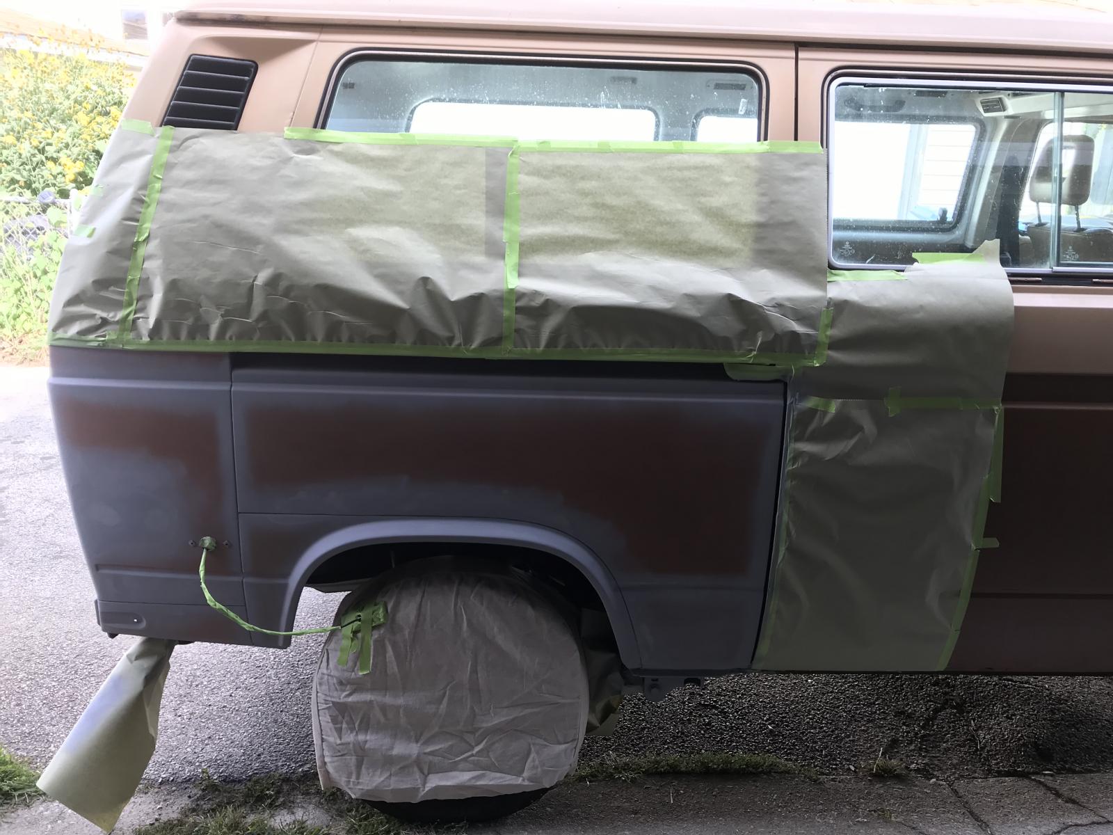

Replaced Seam Sealer on all my remaining exterior seams. Sanded and repaired my R/R panel, primed and painted it.
Worked a dent out as best I could that was above and behind the side marker light. It was nice to see that dent gone finally.
The sliding door is still a different shade of brown than the rest of the Assuan Brown ( previous work from the past), but that can wait since the Drivers Side of the body needs work much like the Passenger Rear quarter did. Winter is Coming..... Razz

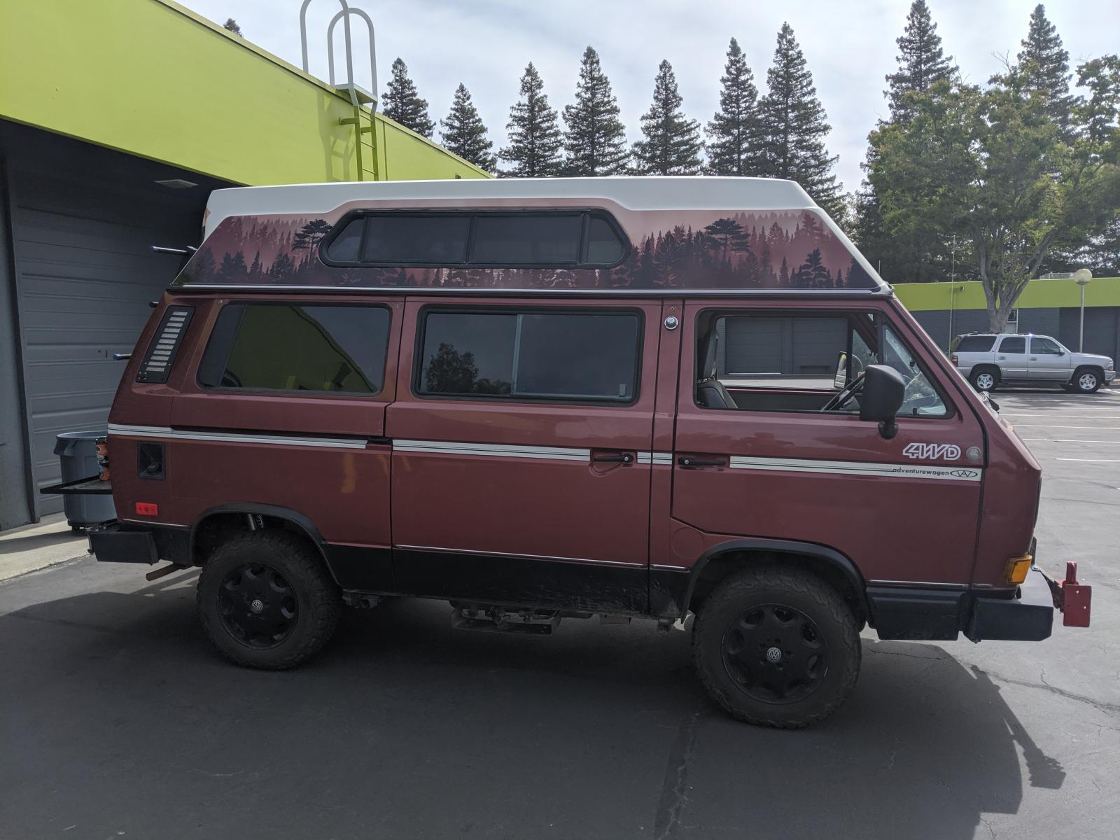

Put a "wrap" or large decal on the hightop of the Adventurewagen.

(above)....COOL wrap! Nice!

Damn, that's gorgeous - well done!!

that wrap on the high top looks awesome.

That hightop wrap looks amazing!

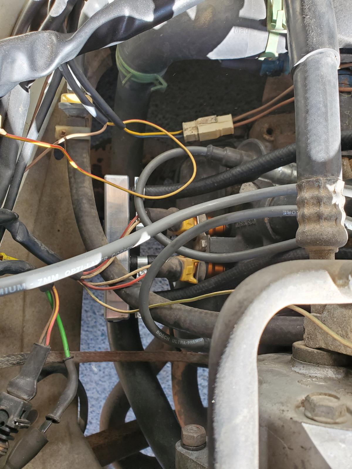

Replaced the fuel lines, added Marco injectors and Van Café fuel rails on my Syncro
