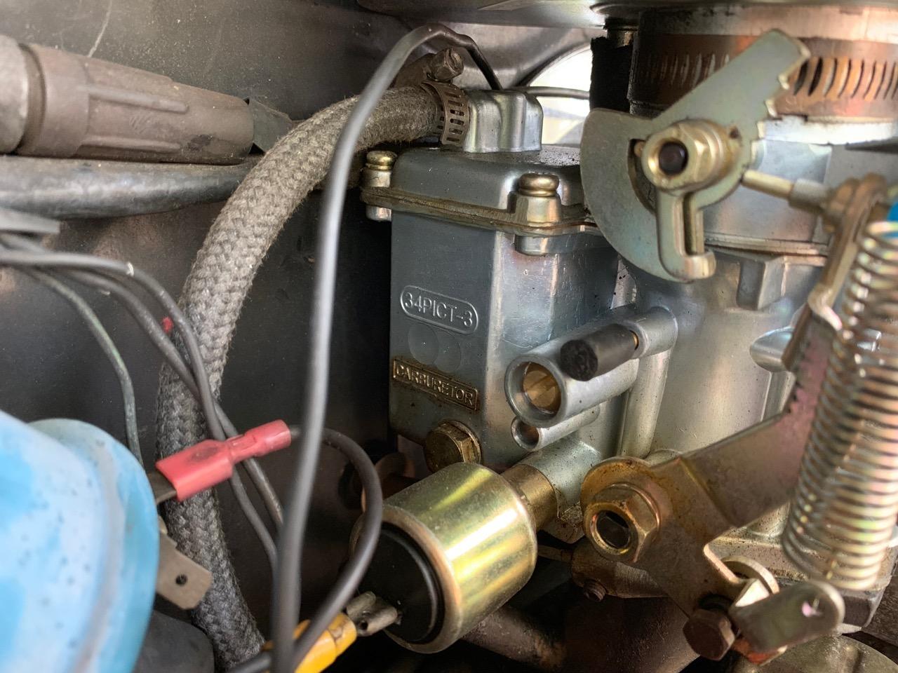

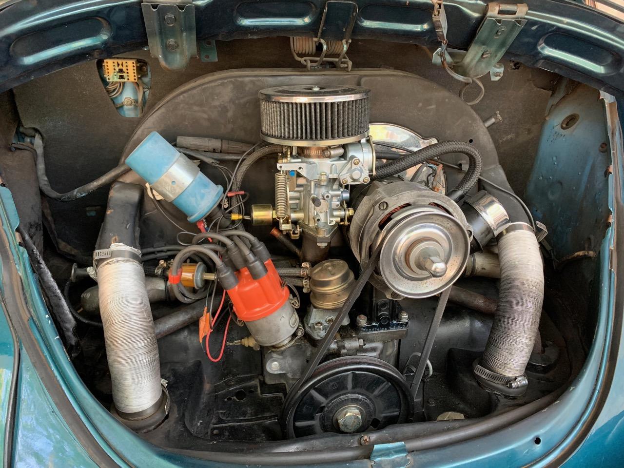

Well I picked up June Bug yesterday and have had fun driving her around town for the last two days.
Observations and questions:
1) She starts poorly when cold. Have to crank quite a while and feather the gas. For the first few minutes after starting, she idles very rough and there is a strong odor of unburnt fuel. Once warm, the idle is stable. But acceleration seems hesitant, and I smell a lot of unburnt fuel coming out the tail pipes.
2) Parking her in my garage, there is a strong smell of fuel in there after less than an hour. I cannot find any obvious leaks, but I do know that the PO recently had a crappy undercarriage-mounted fuel line replaced with one inside the frame tunnel where it belongs. There are two fuel filters, one under the tank visible near the right front suspension members, and one in the engine compartment. The smell seems concentrated at the front of the vehicle, in or near the frunk. Engine compartment itself does not smell of fuel.
3) The PO claims he bought the bug with a FI conversion already installed, and that he put a new Empi 34PICT-3 carb on it. The carb is marked 34PICT-3 but not stamped Empi anywhere, so I think it is an off brand. He gave me the old carb, which is a Brosol Solex.
4) The distributor is simply labeled "Bosch", I believe an 009.
5) Shakes like it's going to disintegrate at highway speed. I'm getting the front end looked at by a VW specialist shop tomorrow morning.
6) There is no engine serial number, so I believe this is a replacement brazilian engine. Is this a problem?
7) The flex pipe leading down to the heat exchanger isn't attached to anything. It can just be pulled up out of the holes.
8) There is an open hole in the engine tin on the right side that just goes straight to the ground. What went here? Car used to have factory AC.
Where should I start to get her running well? I'm going to do the obvious--change oil, transmission oil, check valve clearance, check compression.
Engine compartment pics below...does anything stand out as blatantly incorrect? Thanks for your help!

PostPosted: Sun Oct 06, 2019 6:56 pm    Post subject: Re: Questions on 1976 convertible repairs Reply with quote
Nice going to pursue your dream car, even if it's a few years off your ideal choice.
Do you mean one of the two large silver foil hoses coming off the fan shroud? If so, it must be connected to the heat exchanger (HE) inlet! The HE must have a constant supply of air blowing into them from the hoses. The HE retains the heat coming off the front 2 cylinders' exhaust pipe. If the heat lever inside the car is closed (lever down), the heat inside the HE gets vented out at the upper top front of the housings. If that heat from the exhaust is kept in the HE because the pressurized air is absent, the intense heat from the exhaust can rise up to the underside of the head and the 2 cylinders. Component overheat.
Depending on the type of muffler on your '76 engine, the silver foil hose can often be stretched enough up top so that it leads into the HE inlet.
Cool There is an open hole in the engine tin on the right side that just goes straight to the ground. What went here? Car used to have factory AC.
Another foil hose like the two silver ones on each side of the fan shroud. The 3rd hose was attached to the factory oil bath air cleaner, routing warmed air coming off the right cylinders into the air cleaner and then into the carb to help prevent intake manifold condensation in low temp humid conditions. Your aftermarket air filter does not have a fitting for that warm air source. If you don't plan on retrofitting a stock style air cleaner, you should close off that hole. You can use something as simple as some aluminum flashing cut to a slightly larger diameter, use 2 or 3 pop rivets, and painted black to blend in with the engine tin.
Here's a shot of a stock oil bath air cleaner with the large hose. This is my own engine in my '77 Beetle sedan. The air cleaner is from a '70. Later Beetles ('73, '74) used a rectangular paper element air cleaner, but still used the same large hose.
