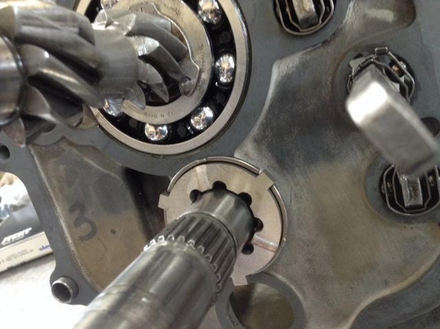

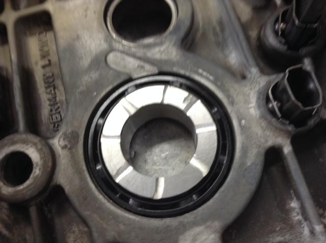

nmerrill wrote:
Most seem to be pulling oil out drain hole, or drain hole area, and returning to the front gear case, etc.
So, y'all arn't starving the ring and pinion of oil level are you?
That is, pull 1-2 GPM out the drain plug... does it flow back into there at the same rate?
Sorry I missed this.
The passageways between the transmission case and diff area are large.
Steve Arndt Ill take a pic of how I cut around my drain.
