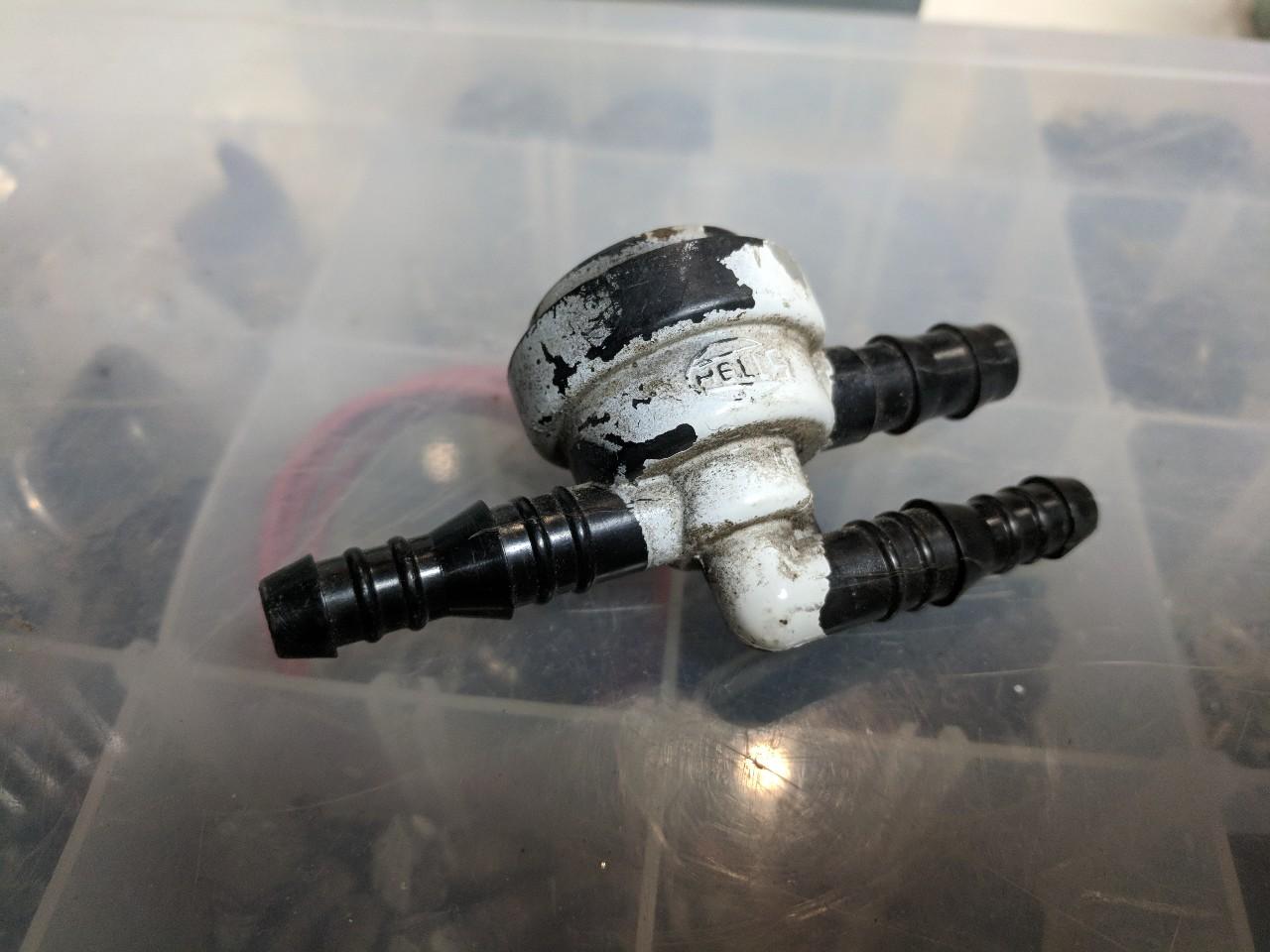

PostPosted: Mon Nov 06, 2017 7:41 pm    Post subject: Re: factory headlight washer system? Reply with quote
notchboy wrote:
Did you get it all working and squirting? I was only able to get one to squirt. I bought some other pumps and might go with one pump per squirter like modern cars do.
The Vanagon headlight washer has a valved splitter that equalizes the pressure between the two nozzles. Did you get this sorted?
If not, I have a spare of the T3 part that could solve it.

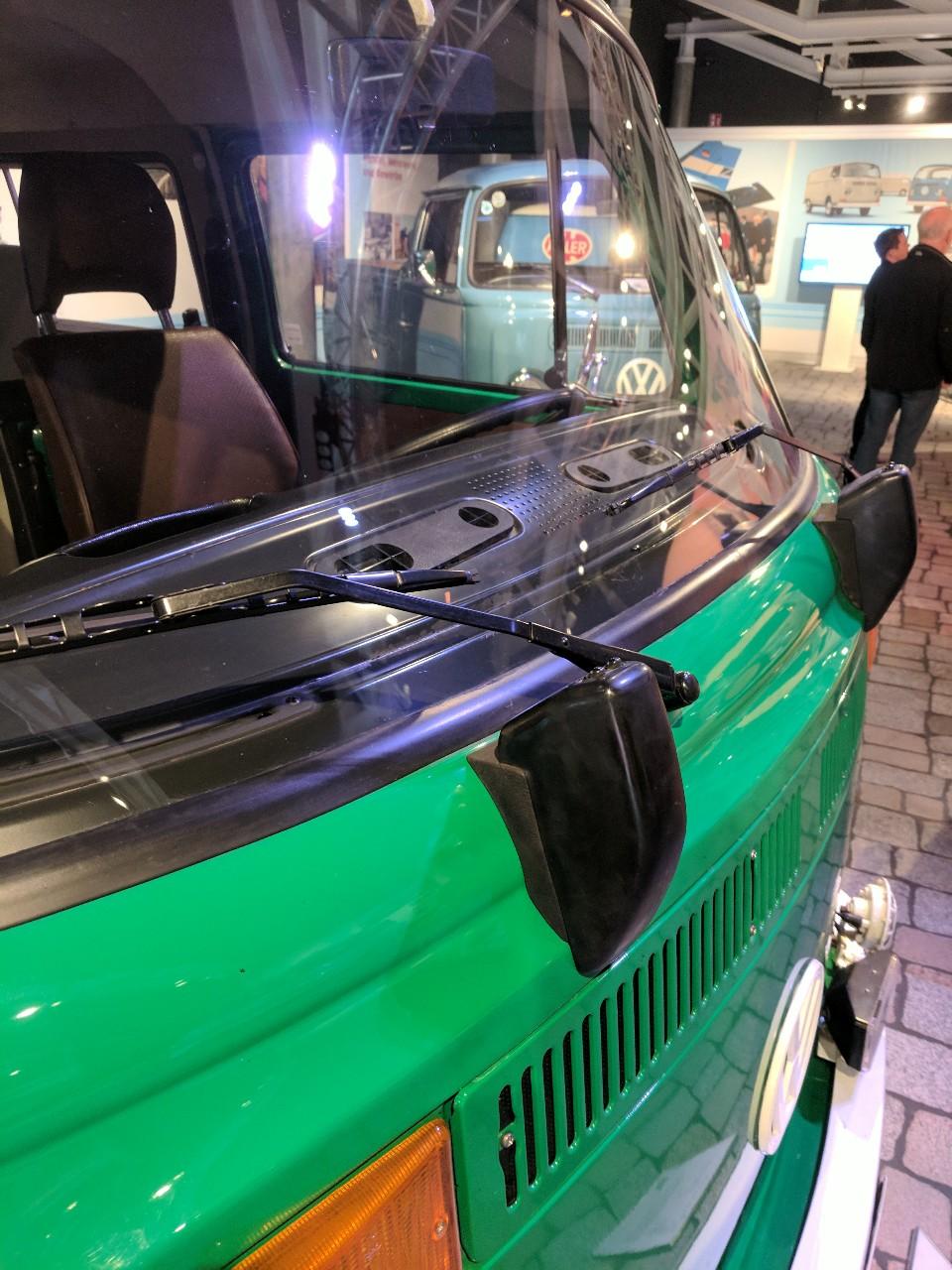

PostPosted: Wed Nov 08, 2017 8:07 pm    Post subject: Re: M-288 Factory headlight washer system? Reply with quote
I have a spare of the big head light squirter as well, never used it and not planning on drilling the front. Untested though, but was sold as a working unit.
Here are pics of the T3 washer fluid splitter, The fluid will take the path of least resistance without an equalizer valve.

PostPosted: Wed Nov 08, 2017 8:19 pm    Post subject: Re: M-288 Factory headlight washer system? Reply with quote
A little off topic, but I was at the PS Speicher Museum in Einbeck last month. https://ps-speicher.de/en/ They have an exhibition on the 50 years of the Type 2 VW Kombi. I noticed one of the busses there that was a Police Bus had a very unusual windshield washer set up that I had not seen before.

Here is the headlamp-washer pump with which I was supplied. It looks good, but if it doesn't pump water I will be livid!
The small spigot which connects to the large spigot, had a shortened length of small-bore transparent tubing (would originally been 200 mm long I believe) attached to it, which I think would have connected to the inlet of the electric windscreen-washer pump.
These are the damaged windscreen-washer jets with which I was supplied; one of which has a retaining barb ripped off.

PostPosted: Sat Jan 11, 2020 4:14 pm    Post subject: Re: M-288 Factory headlight washer system? Reply with quote
You will be lucky if the pump works. Mine worked for a day, then pooped out. Ive since bought two modern ones to fit inline to replace it. Id toss those windshield squirters in the bin. They are cheap to buy new with the two or thee holes. Same with the original pump for the windscreen. Its an old early Golf type pump. Loud as shit and takes a minute to pump up. Ive since bought a replacement for that as well.
The only value in your purchase is the tank, column switch, relays, wiring harness & overriders, the rest is rubbish or will be soon.
