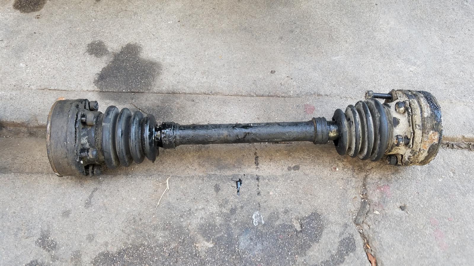

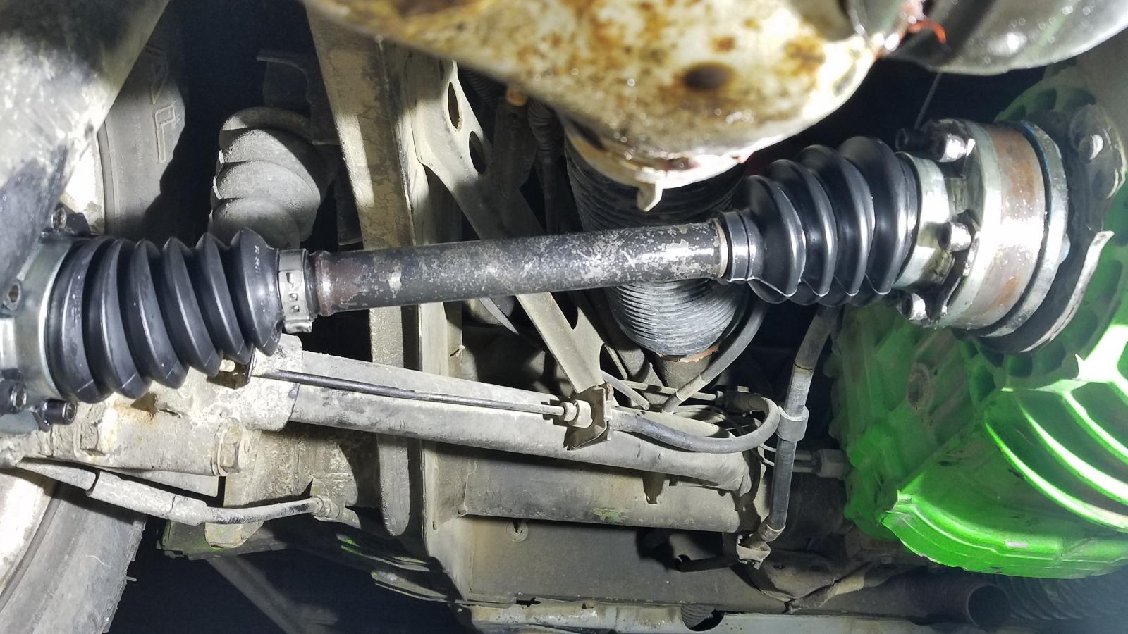

Got it all put together tonight.
In early 2016, installed an 091 trans with fresh seals and such. I am sure I didn't put on old boots at that time, though I don't remember for sure if I ever replaced them, or perhaps they were the ones that came on the Bus and I just never changed them because they weren't cracked. They did have hex-head bolts rather than triple-square.
I had used those Nord-Lock washers as recommended by someone in the past. I was glad to see that, because otherwise I would have had to dig around to find the little baggy that I'd ordered who knows when.
So now I have 3 "new" Bus boots from Bus Depot, and the one OEM VW boot that was sent to me. (I ordered them all in fall of 2018, thinking I'd just replace all 12 boots on my old VWs in one greasy, nasty day. That didn't turn out happening; '78 got it's new boots last spring, the Thing still has decent boots.)
All 4 boots had expired--three at the axle end, one at the CV end. Luckily all the CVs looked good when cleaned up.
I did notice that the new VW boot's inner diameter was slightly loose on the shaft when installed. I was able to clamp it down no problem. I didn't clamp the other three boots.
New boot didn't come with bolts, so I had to reuse 6.
Question: I clamped the new boot between the two ridges on the axle that are intended for this purpose. However, it more naturally wants to sit just outside the further out ridge-meaning I had to stretch it a little bit to get it in between. I felt that clamping it in between the ridges assisted with getting it more sealed up. However, would stretching it a few mm to clamp potentially cause an issue that wouldn't otherwise be present? Should I loosen the clamp, let it get to it's natural resting position, and reclamp?
Old boots:
As installed:
Brand I bought from Bus Depot:
Current mileage on the odometer is 82,785.
Let the experiment begin!
