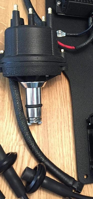

My contribution to the Hi-Po distributor/ignition "for the best price" option.
The MSD copy, (if it doesn't break in half) combined with a High output CDI would be the most reliable and highest performing combo for a very reasonable cost. My Genuine MSD distributor replacement mag pickup that came in a MSD package is indeed made in China. But the stlye of Mag pickup is super reliable. The Huge reluctor is the same as what comes in OEM mag pickup distributors, and even when weak and old, these things still work. (unlike points replacements that have small surface area and weaker magnets.)
https://www.ebay.com/itm/Volkswagen-H4-1954-79-Rac...2749.l2649
The bright red cap doesn't exactly "blend" in a vintage look, so just throwing a idea out there, this is what I did to my MSD to calm down the boy racer look some.

Damn, that looks so cool! VHT wrinckle paint? I used that om my engine tin, but never thought of using it in the dist. Leads looks cool to!
Yes VHT Wrinkle black,
I did the coil and cdi also:

In anything other than a desert climate, that wrinkle paint on the cap and insulators is asking for trouble. Slightest bit of moisture along with dust and there will be shorting. Fred

Fred, appreciate the warning. I think your thinking this wrinkle finish is raised up abit more then it actually is. The plug wire boots fit tight and no moisture is getting by. It made it through the winter sitting outside and the terminals are nice and dry, plus runs without issue.

No, that's not the issue. High voltage insulating surfaces are glass smooth on purpose to repel water and reduce the amount of dirt collected which makes the condition much worse. Look at any power line with glass insulators if you need an example. In a real winter with snow melt or wet climate, that cap would be shorting to ground all over the place. Same with the coil tower. Relying solely on the integrity of tight fitting boots doesn't leave much margin. Fred

I am using a Crane LX92 that has 910 ohms of secondary resistance/.23 primary resistance combined with one of the few CDI boxes that can drive it, so I could see where less then perfect connections are a concern. I like the thinking that my spark plug wires are like 40+kv transmission lines!
jpaull wrote:
