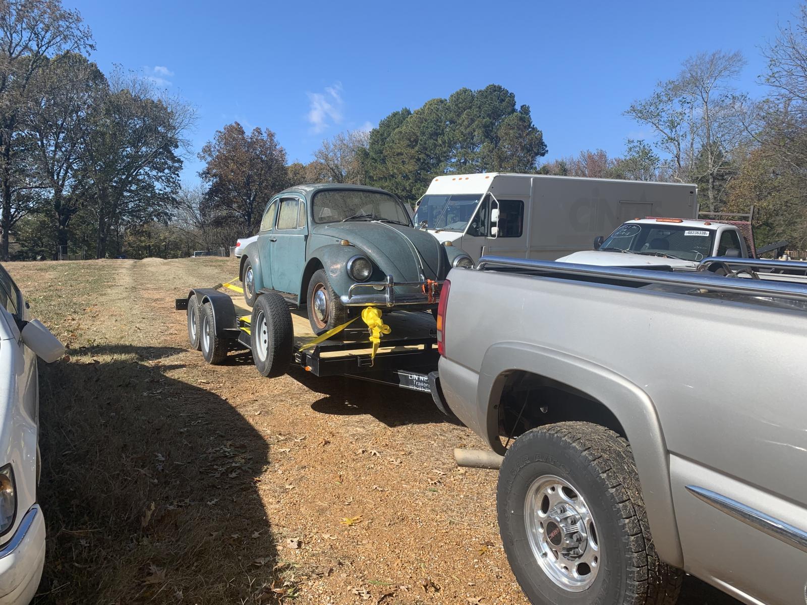

A few weeks ago I was looking through local Craigslist postings for tools and stuff, and I saw an ad for this 1967 sunroof bug:
I didn't have much to go on but several things immediately jumped out to me.. almost all of the trim was still on the car, the tires looked extremely old, and there was an absence of rust bubbles on the rockers. I went to look at it right after I got off work that day, even though it was almost dark when I got there.
Sure enough, it was an original paint car, with a complete engine, and even had the original bias ply spare up front.
I came back up after the weekend and trailered it back with a buddy and my two boys:

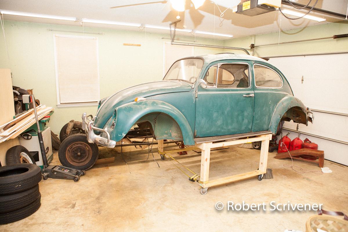

I got it home and started cleaning and evaluating what was there, and what needed work. First thing is the floor pans - both sides are gone, most likely from the sunroof being open to the weather at some point. The heater channels are good!
Judging from the VIN and engine serial number, the engine looks original to the car!

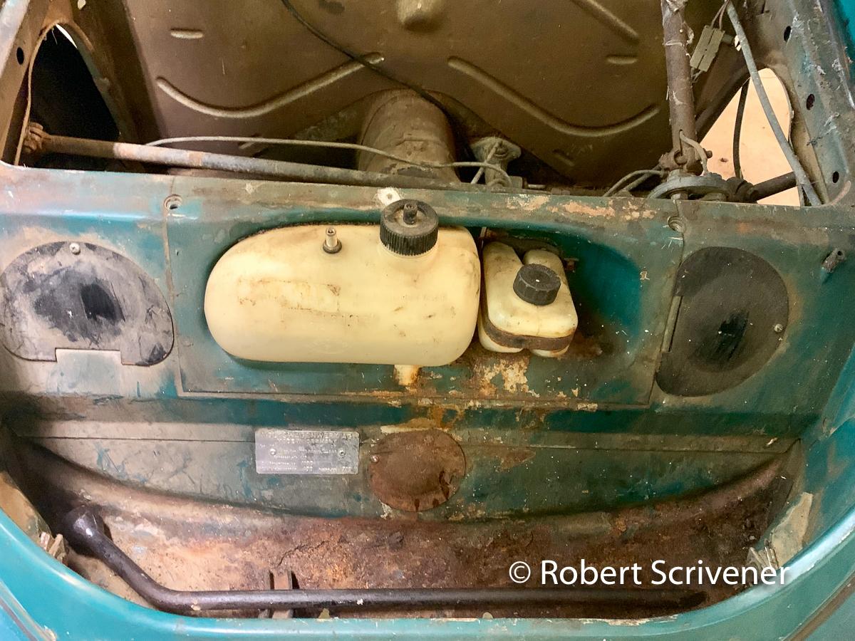

There was a rat in the front that rusted the spare tire well out and filled the engine bay up with trash...
Call me a pessimist, but after mechanicing for so long, I don't trust anyone else's work on a new-to-me car until I've gone through it myself. So the engine came out:
The engine is in ok shape externally; all the tins (even the pulley tin!) are present, the carburetor is stock, and everything is covered in a thick layer of old oil and dirt. The oil cooler was seeping in its past life.. most of the oil cake underneath seems to be from the transmission, but I'm not sure yet.
Everything under the fuel tank looks stock and accounted for.

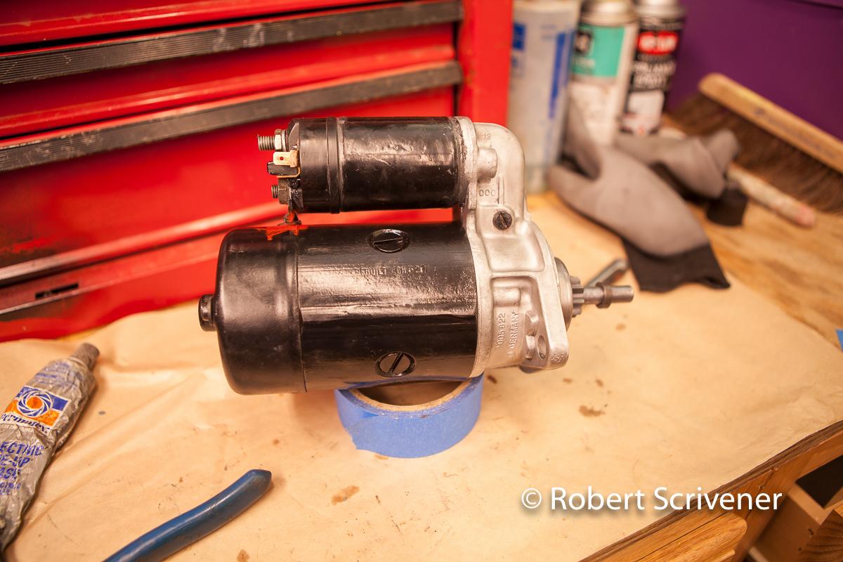

That catches us up to today.. an easy afternoon project, the starter. I went a little extra on this starter but as i said about the engine, RELIABLE is the key.
That being said, I took it all apart, cleaned up the commutator on a lathe, sandblasted the case parts, and cleaned cleaned cleaned. I accidentally picked up the wrong degreaser spray for the armature, and I wasn't sure if I broke down the winding insulation.. so I got some motor varnish to CYA.
I took the solenoid apart and cleaned up & rotated the bar, lubed up the plunger, and reassembled with grey RTV around the crimps. Molykote 321R on the bendix and helix, Redline CV for the rear shaft bushing, blue loctite on all the screws, and appliance epoxy black for the steel parts. It ran and sounded good on my bellhousing fixture but I don't have an ammeter that goes up full range for the current draw to see how healthy the windings are.

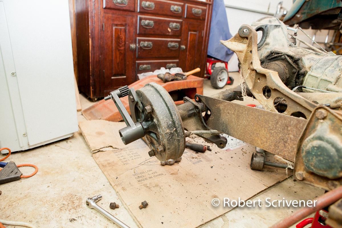

If I'm putting in new floor pans, better do it once and cry once, so let's get the Wolfsburg West pans. If the pans are out, better replace the brake line there since we're there anyway. Oh, since I'm replacing the brake line, lets do all the brake lines, and hey stainless is only a few bucks more! Let's do the brakes once and forget about it. So new drums shoes and hardware all around. While I'm there, lets change the ball joints. Hey the ball joints are off, let's bead blast and paint the spindles.
Oh the beam is apart, let's go ahead and remove it and clean it up.
Hey the suspension is all off. Let's take the whole pan down to the powdercoat shop!

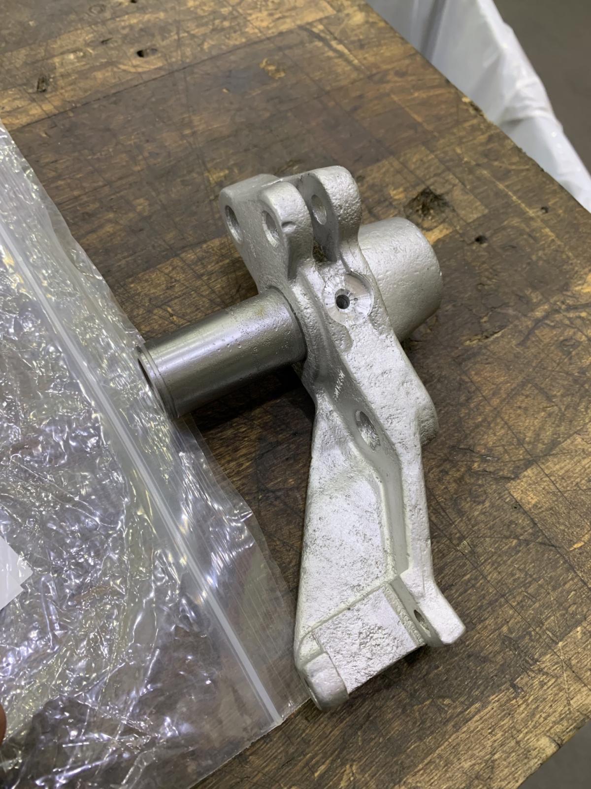

The pedal cluster looked like it could use a little cleanup... so I pulled it out.

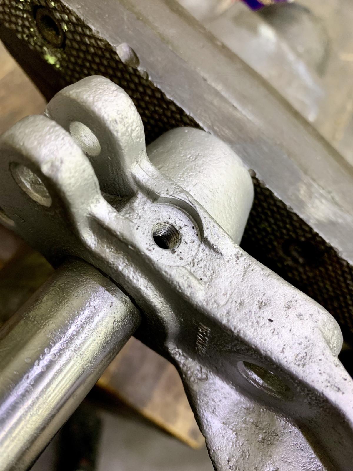

Unfortunately after sandblasting I found a lot of pitting corrosion on the aluminum casting. It's still useable.. but it doesn't look pretty. Since everything was apart I went ahead and welded up a stiffener on the clutch pedal arm, welded some of the brake pedal, and converted the clutch pedal shaft to a bolt-on style. Don't ask for photos of the shaft, let's just say I saved a small amount of money but made a large leap in learning how to TIG Laughing
Here's the grease fitting modification.. I went with a standard 1/4-28 threaded zerk vs metric, don't shoot me for the witchcraft. Although I was able to cleanly drill the initial hole, and get very good thread engagement, I didn't do a great job setting up the drill press for the end mill I used to clearance the casting. Ended up with some chatter marks... they disappeared during final sandblasting though.
The accelerator pedal had a thin area on the little roller arch thingy underneath, and when I went to build it back up with the tig, I accidentally blew right through it on the first arc. Ultimately it seemed like the best option was to get a new pedal from Wolfsburg West when I put in my order for the bushing kit.. I dropped everything (even the old accel pedal) off for a semigloss black powdercoat.

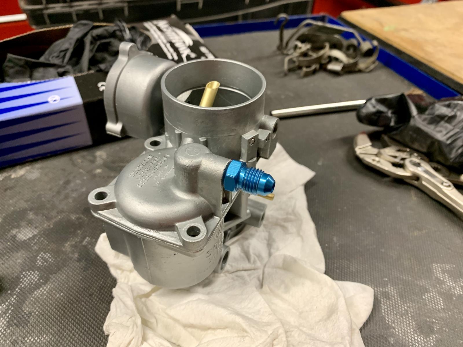

Although I do like stock, I think VW under-engineered the fuel system. I drilled, taper reamed, and tapped the fuel inlet for a 1/16" NPT to AN4 fitting. I've got some teflon 1/4" stainless braided tubing and fittings to go with it but I'll wait until I get the engine together to decide for sure how I want to finish the plumbing.
I cleaned all the aluminum parts with isopropyl alcohol after glass beading .. the parts started sweating in our 100% humidity, and white powder corrosion formed everywhere. After a second round of glass beading, I brushed on some Alodine 1132 from an expired touchup pen I have.. Alodine is a chemical conversion film that passivates the top layer of aluminum alloy, making it highly resistant to corrosion. I used it all over, inside and out, in the fuel bowl, throat, and on the new fuel inlet threads I cut.

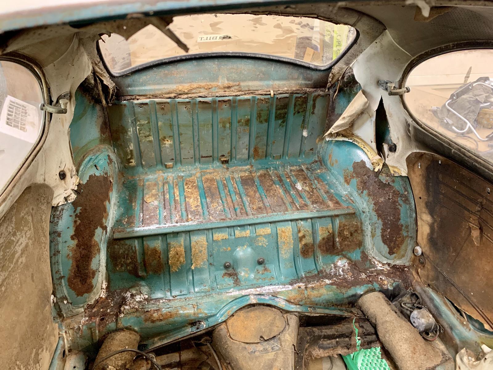

The interior is out, all the bolts are off, and the body is ready to come off the pan. I did find a bit more rust in the package tray and wheel wells but most of it seems to be surface rust. The lower crossmembers will need to be repaired for sure, and the left rear pan support looks like it was cut almost in half with a saw at some point. All the brown stuff on the wheel wells is that compressed felt insulation junk, don't know if the metal's soft underneath or not!

I would hazard to guess most folks here unfamiliar with alodine and what it can do. No doubt you’ve seen it followed by a zinc chromate primer. It worked well but both the alodine and the primer contain hexavalent chromium so watch out.

You're right, at work we use a green zinc chromate primer after prepping the bare aluminum with Alodine. The thing I really like about the Alodine touchup pen I have is that it's not corrosive to ferrous metals and doesn't require a water wash after application!
https://www.aircraftspruce.com/catalog/cspages/touchprep.php?clickkey=7130504
I looked up that gallon of 1201 in your photo and it's half the price of the pen.. if I were doing much aluminum work at the house I'd probably get what you have. In the past I've used Moeller zinc phosphate primer since we can't really get chromate stuff. It works ok but needs to be topcoated or corrosion WILL form.

PostPosted: Sat Aug 01, 2020 10:57 pm    Post subject: Teardown day Reply with quote
Y'all, I can't tell you how great the torquemeister tool is! I got out of sequence tonight while I was getting the transmission down, and needed to remove the drums with the mount bolts and spring arms all unbolted. It took about 5 minutes to get both drums off with this tool!!
I've only got a small handful of VW specific tools and this one was well worth the price of admission.
Tonight after sunset I jimmied the body on to a crummy wooden 2x dolly I made this week. It's awful, and I don't know how so many people are able to use wood to make a body dolly with.
Then I got all the loose ends out - spraying all the bolts and nuts with aero kroil, and loosening up everything by hand all over the pan. The entire brake system was replaced at some point in the past, with Varga wheel and master cylinders, some new steel lines, and looks like a couple brake hoses. The brake hose clips were mostly missing, but at least both master cylinder bolt spacers were present and accounted for!
Took the transmission out (that's when I noticed the e-brake cables and realized I had missed a step haha) and then called it a night. Most everything is in decent shape and looks rebuildable at a glance. There were nice oil filled shocks front and back, and a COFAP damper still on.
Only thing still bolted up to the pan are the spring plates and the front beam. Looking forward to getting new pans welded in!
