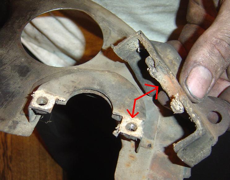

If that wrap is the same as on the large heat exchangers, it isn't asbestos.
I only know of three possible asbestos seals:
1) On a Type 1/early 2 engine, those white seals around the heat riser, embedded in the tin (lower left):
2) On a Type 3 (and maybe Types 1&2), on the rear of the large heat exchangers, the extra seal at the meeting of the sheet metal jacket and the exhaust pipe (just ahead of the main clamp/donut seal). There should be a seal and clamp at the red arrow:
You can see the proper clamp/seal here:
3) Those sealing "rings" at each connection of the large heater flex hoses under the car, usually covered by a sheet metal ring, seen here:
The inside of the accordion tubes is usually a batting type material that is cloth-based, not asbestos:
In this thread the late Russ Wolfe says the large HE wrap is definitely not asbestos:
https://www.thesamba.com/vw/forum/viewtopic.php?t=374954
It looks like identical material to that on the heater thermostat housings.
And then there is brake shoe material, but most of the is gone unless you find OEM replacement shoe linings.
