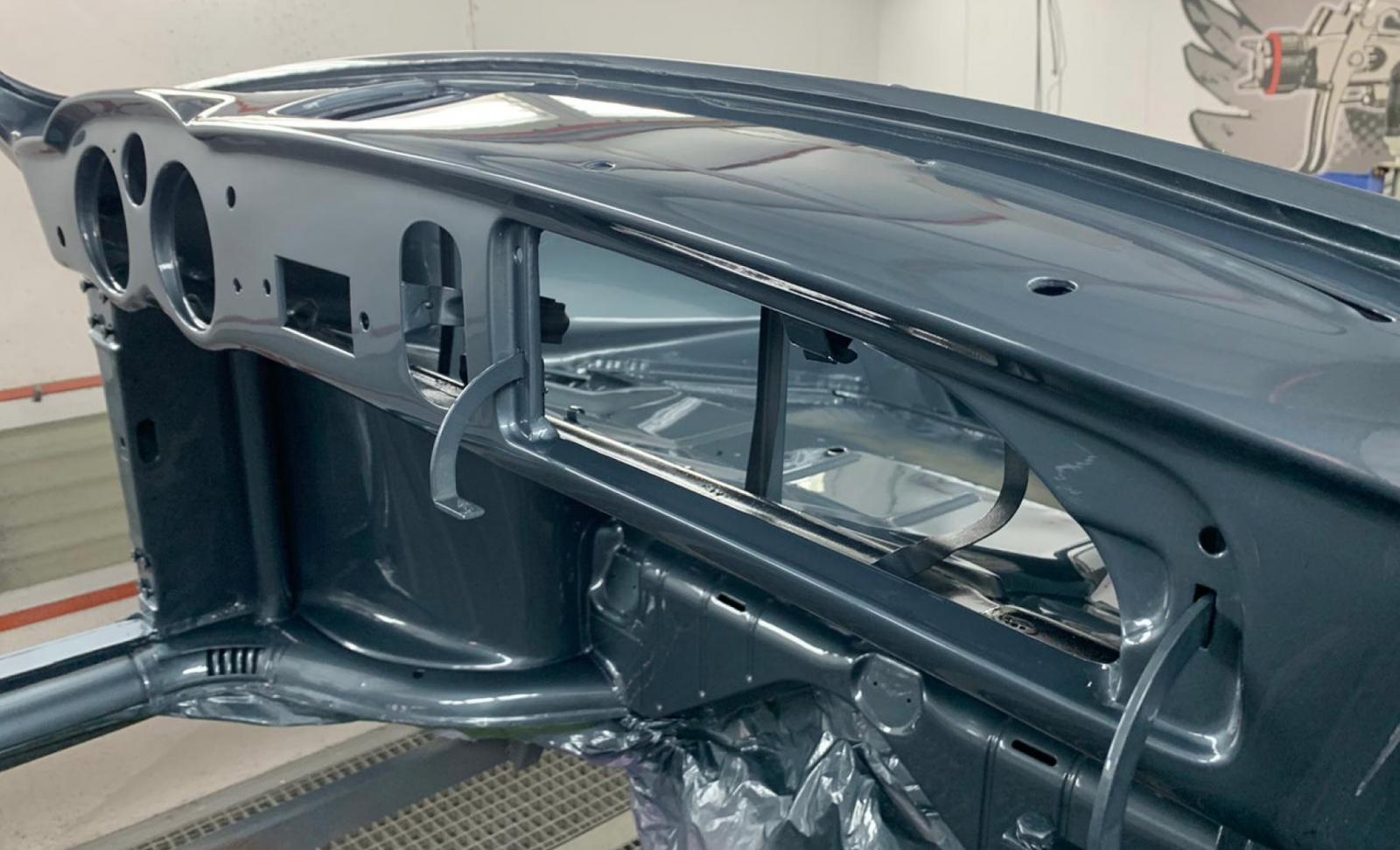

@Nicholas - I will do my very best. At the moment I used some "thick" blankets and I have also ordered a "family box" of masking tape. Very Happy
I started with the air mixers and instruments. Driver side fit quite good but the passenger is a nightmare. I think I have to cut the downtube and weld it back together after having it in place. I hope I am not the only one asking himselfs who designed this part Laughing
Anyway its so good to take parts from the stack of boxes an getting them into their final place. Next step is the electrics...as soon as this is done I can put the body back on the pan.

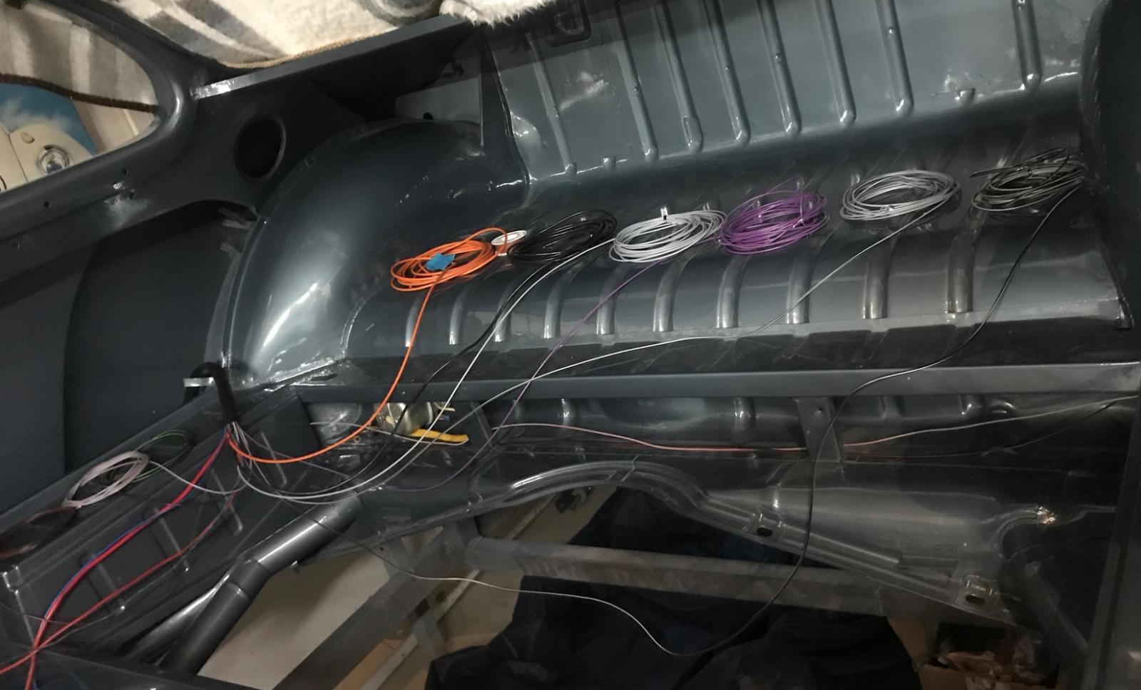

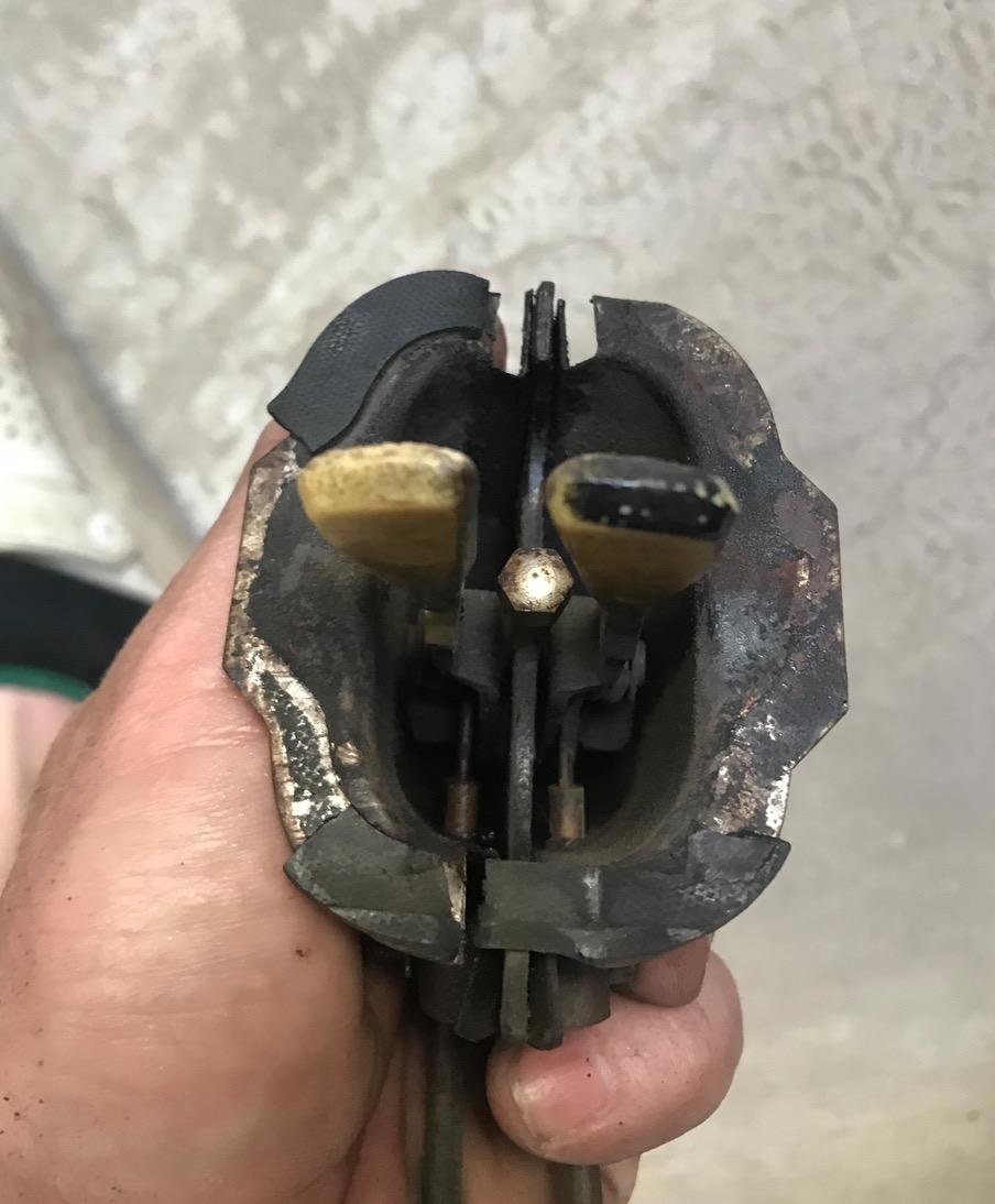

Unfortunately I didn´t find the time I really wanted to use on the Ghia but at least I made some progress in the "trunk".
I rebuild the fresh air controls with new control arms from Airhead Parts:
Now everything is in place and I hope that I never have to remove them in my entire life. Laughing
Furthermore I wanted to finish the wiring before putting it back on the pan just to have a - lets say - ergonomic workplace by standing in the tank cutout instead of leaning over the freshly painted fenders about 1000 times.
Except of the wire for the battery and the starter I used completely new wires with the correct coloring. I also added some spare wires - you never know.

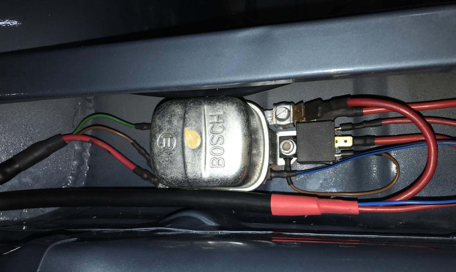

I placed the regulator in the "black hole" under the backseat and added an additional relay to relieve the ignition lock contacts:
Thats the status quo...
I think I am 85% done.I decided to build a 66/67 harness due to the hazard warning lights that have to work here in Germany. I used the Wolfsbürg West relay to have everything in one box and for being able to use a 66/67 emergency switch.
