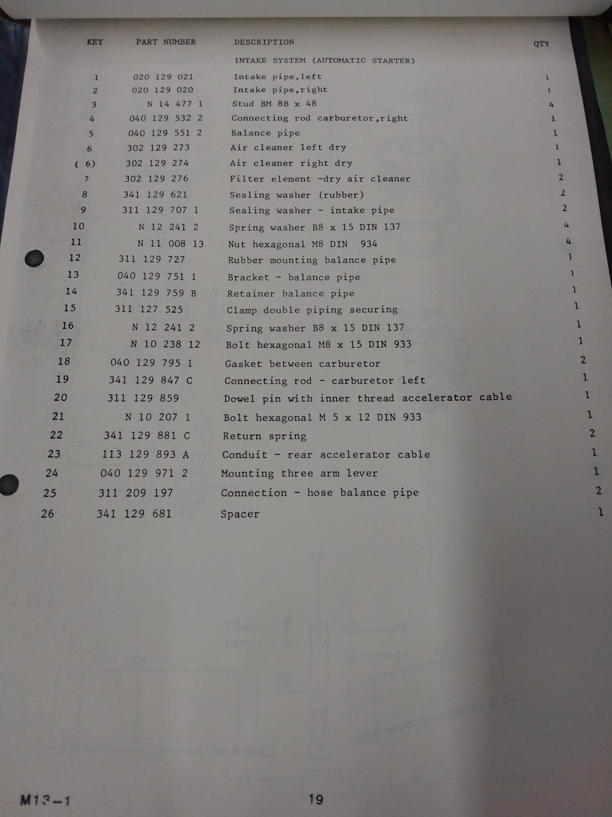

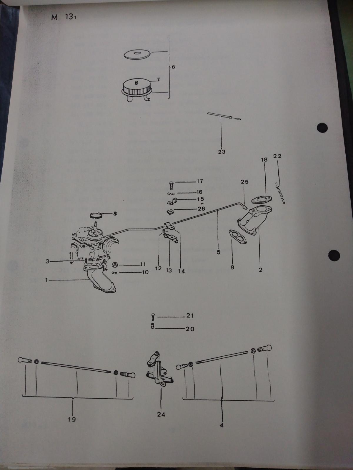

Buggeee
Joined: December 22, 2016
Posts: 4921
Location: Stuck in Ohio
Buggeee is offline
PostPosted: Thu May 19, 2022 5:56 pm    Post subject: Re: Tell me all about the Puma Reply with quote
[quote="VWFIXER"]
Buggeee wrote:
I had two complete sets with oil bath upgrades... with parts almost to build another set. Can you please give me the part numbers on the side of the manifolds?
Very Happy
I can't read numbers on what I can see from the engine compartment. Doing one better, here are the parts diagrams and lists of part numbers for the carburetors and related fixings. If my maker is willing I'll scan the whole book one day and send it to Everett for the archives.
