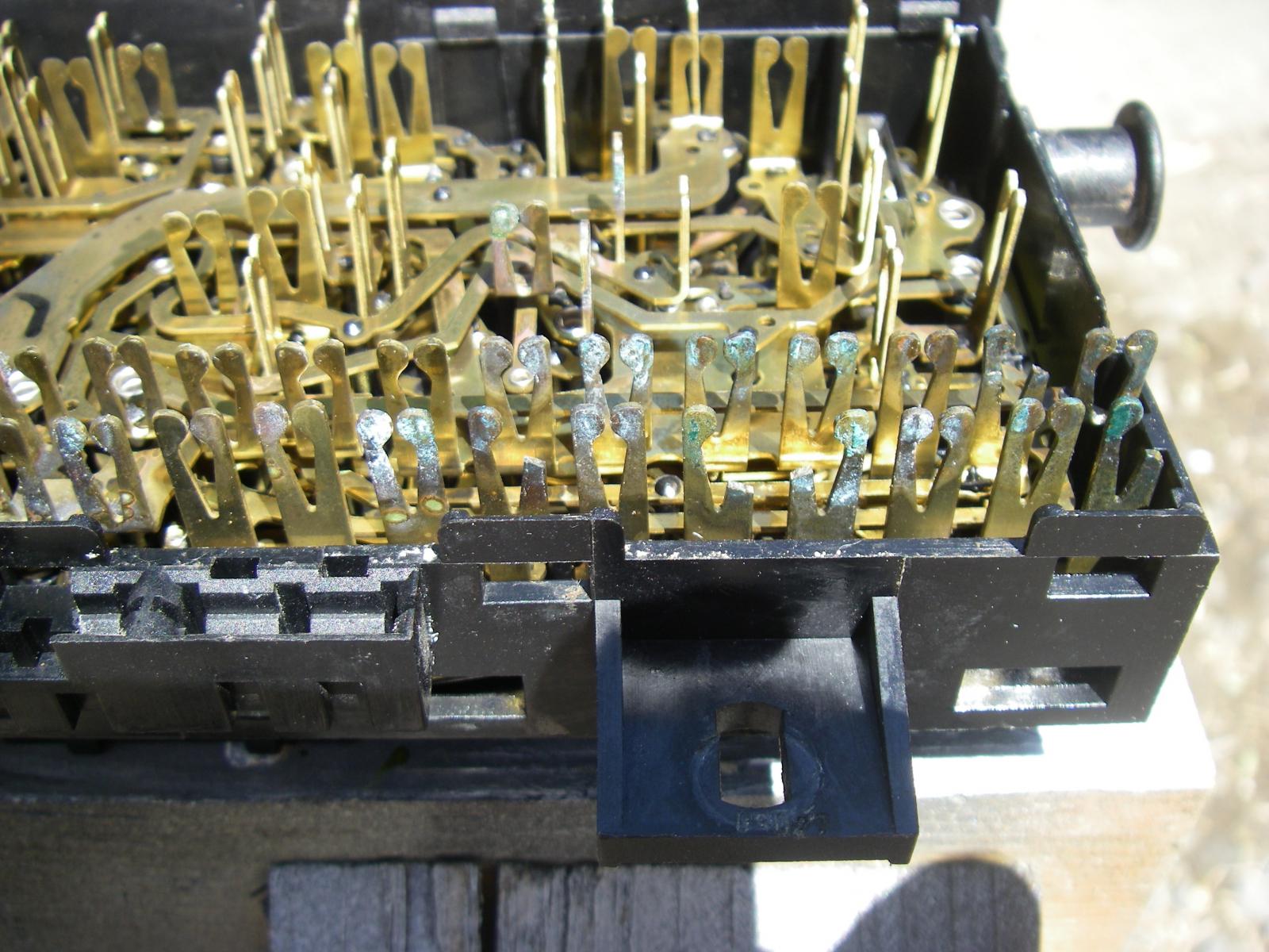

Well as usual life got in the way of getting Vino finished. I lost my electric helper to illness, so that slowed me down. So after finishing some house remodel projects I finally got to it. The wiring had me scared to be sure, but I decided I would just take it one wire at a time. It went well, and after looking at the Sub and VW wiring diagrams repeatedly, I've come to a greater understanding of things I may need to work on in the future. There are still some issues, No tack, I do have continuity from computer to main gauge plug. I replaced the blue foil with the solid-state black box a wire setup from SA, I think. Also my low antifreeze level light is flashing. Flashes as normal at startup and stops, then after 5 or 6 seconds starts flashing again and doesn't stop. I have the aluminum tank and I ran a ground to body from tank mount bolt, not sure what's up with that.Tank is full and overflow bottle is up to line. I installed an oil pressure gauge, works great. At startup I have 70 psi, once up to temp and at idle, around 30 psi, running 10-30 mobile 1 synthetic. But I have not hooked up the idiot light, but it's on. Can I ground it to turn it off? both warning lites are inaccurate, but it's hard to look at while driving. All other electrical systems are working as they should. I found that my speedometer cable top clipon was broken and it was the old two piece, so I ordered the long replacement and new wheel Grommet, install was no issue, speedo and odometer works great. So I have Vino licensed, insured and ready to roll. Only short trips so far, first was to the alignment shop, on the drive home I had the top engine coolant hose almost come off,I adjusted it and got it good and tight. That could have been way worse. I'm running Evans waterless permanent antifreeze, in an attempt to stop corrosion, $36 a gallon,I don't want to spill much of that. Back to driving, my general impression so far is, it's sweet! Smooth, solid and powerful, what more could a guy want. I'll revue all my mods in the future, plus pics. Thanks again to all those who contribute to making The Samba the awesome resource it is. It's great to finally be back on the road! Going somewhere. Mark. latest cost- Evans antifreeze $36 x6 $216.00.-speedo cable $56.83-allinment $90.00.-SA gauge pod wiring $150.00 Total $512.83. RT $24260.67

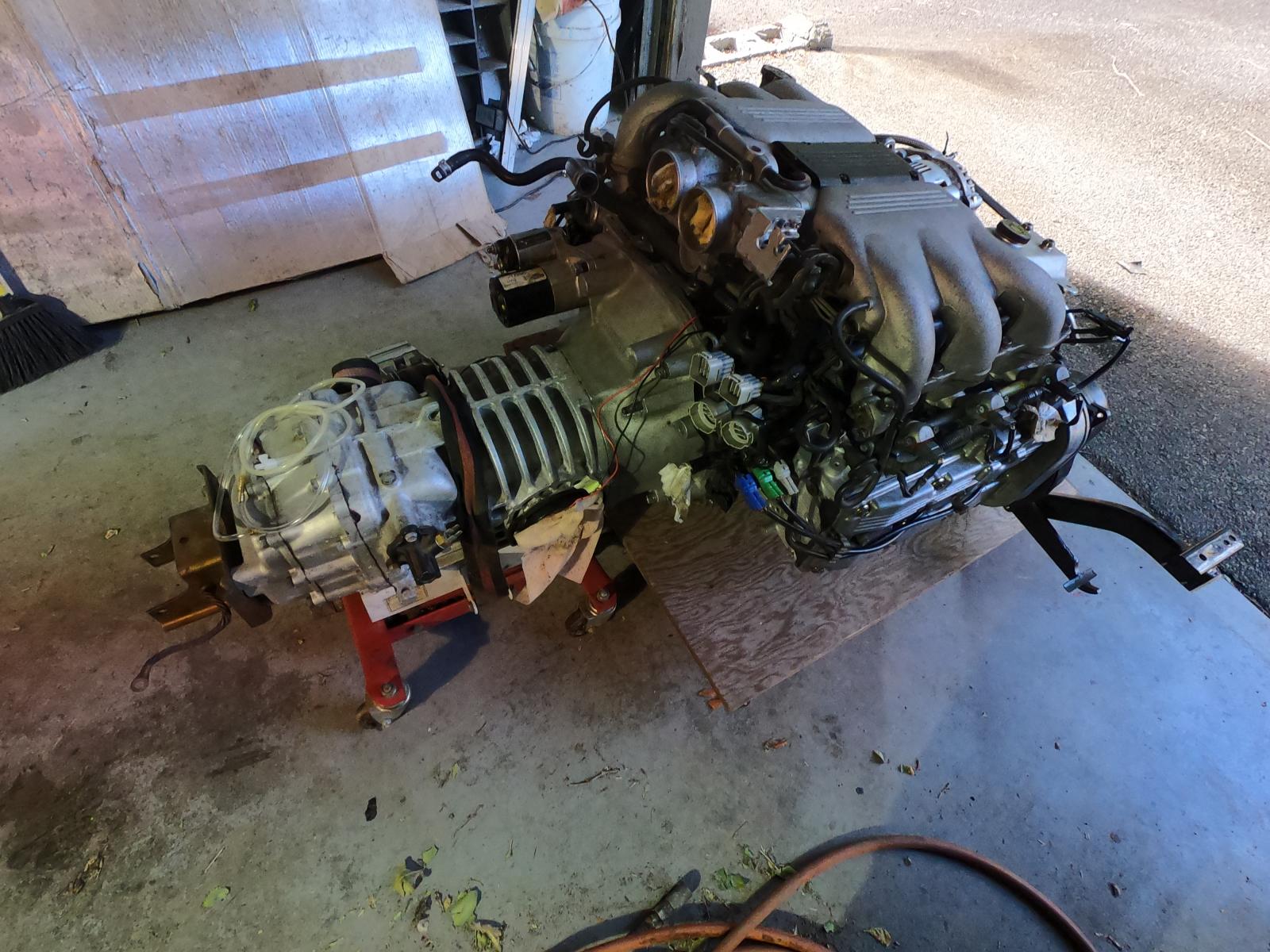

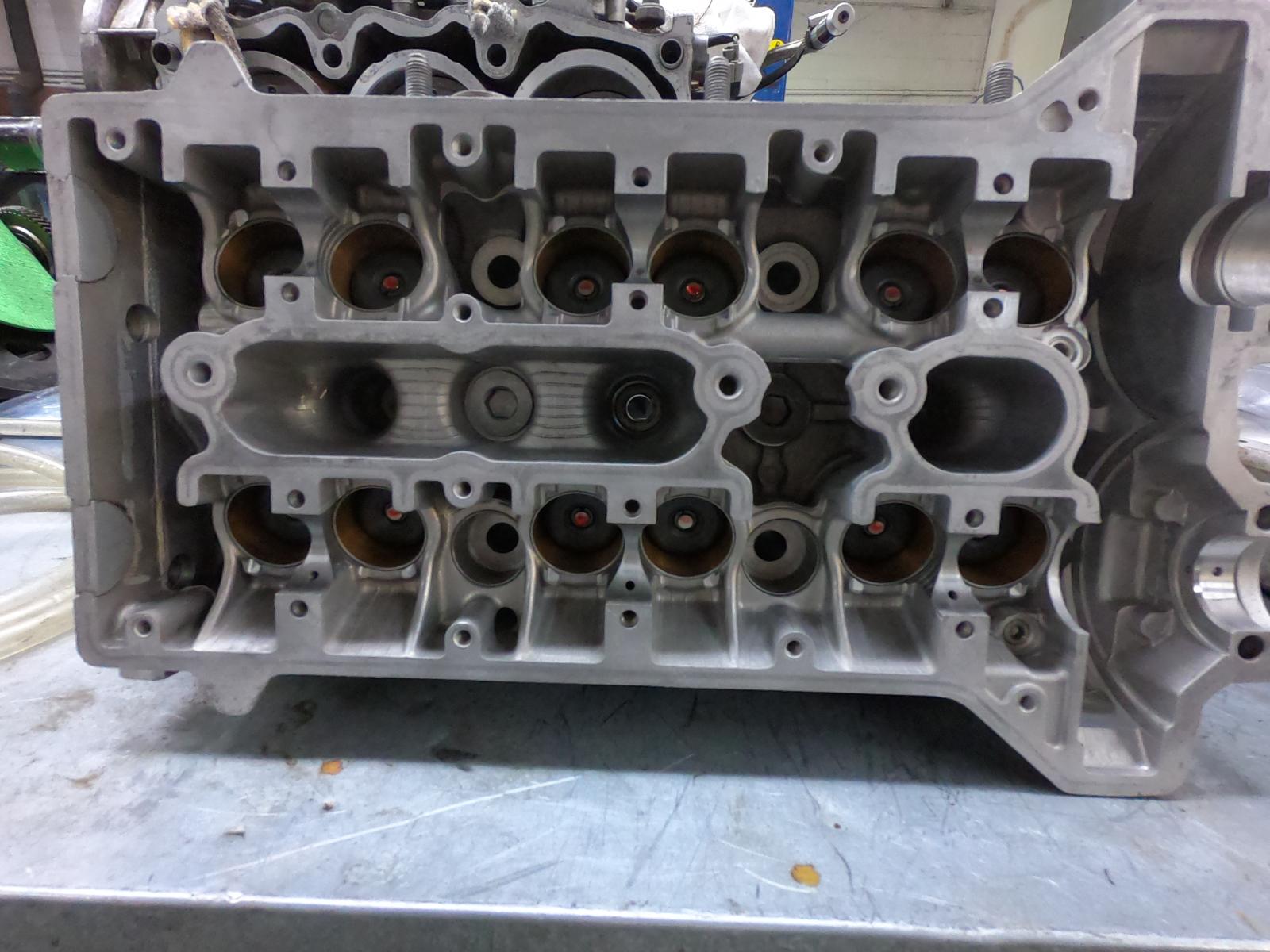

Well folks last summers joy didn't last long. After just a few short drives I was to realize I had a leaky head gasket. When I preped engine I did all the seals, water pump and timing belt. I didn't feel up to pulling heads and went ahead with my install. Turned out to be false economy. So pulled the engine and took it to my local Subaru mechanic late last fall. I made the mistake of telling him no rush, get to it when you slow down this winter. Well things didn't slow down and then along came Carona. After proding him every week or two, I asked him if I could come in and do most of the hands on with his guidance when needed. To my surprise he agreed. I had tried to find piston rings and failed, but my mechanic figured he could, and did. Hastings piston rings. So we took it down all the way except splitting the case or removing the con rods from the crank. All felt great and all bearing surfices look really good so we left it alone. I made a small disk from thin plastic with a center hole to hold the rods centered and honed the barrels. The pistons cleaned up to looking like new, oil rings were completely stuck with old cooked oil. Heads were sent off to be skim cut and fully rebuilt. All went back together without to many challenges, there were a few. Got it home and reinstalled in under two days, I was quite pleased with myself. Fired right up and I did the ring break-in procedure, Ocalating the throttle up and down staying above 1500 RPM, tell warmed up completely, Then a pull through the gear at 50% throttle.then75%and then 100%. Boy this bus flies now. After a few short trips to town and checking things over, We took our first big trip in vino 380 miles in two days to the Oregon Pacific beaches. Great trip no problems, saw 7 or 8 Vanagons almost every one flashed or waved. God its great to be a part of this Wonderfull and remarkable family. Best Health to all. Mark Very Happy rebuild time and parts $1700 he gave me a killer deal. Should have been more like $3000 RT $25960.67

Dobryan I'm glad it makes you happy. I am enjoying fallowing your build very much, I wish mine was taking a trip to Europe. O-well maybe Baja. Slomoracing Thanks for the enthusiasm and your welcome. Well when I had to remove my engine+trans I took the opportunity to do a trans vent line. The amount of dust stuck to area around the vent was a lot for only 500 miles. No oil leaking from vent so it just atomized oil in the air from the vent causing dust to stick. Installing the vent line was easy with the trans out, One thing to be careful of is you want to drill only the outer case, the drill will pop through and drop only an 1/8 inch before contacting the inner case, do not drill into inner case. For glue I used JB weld. Vent run into top of top hat stiffener on driver side fire wall. For only $15 your vent stays clear. RT $26505.67
