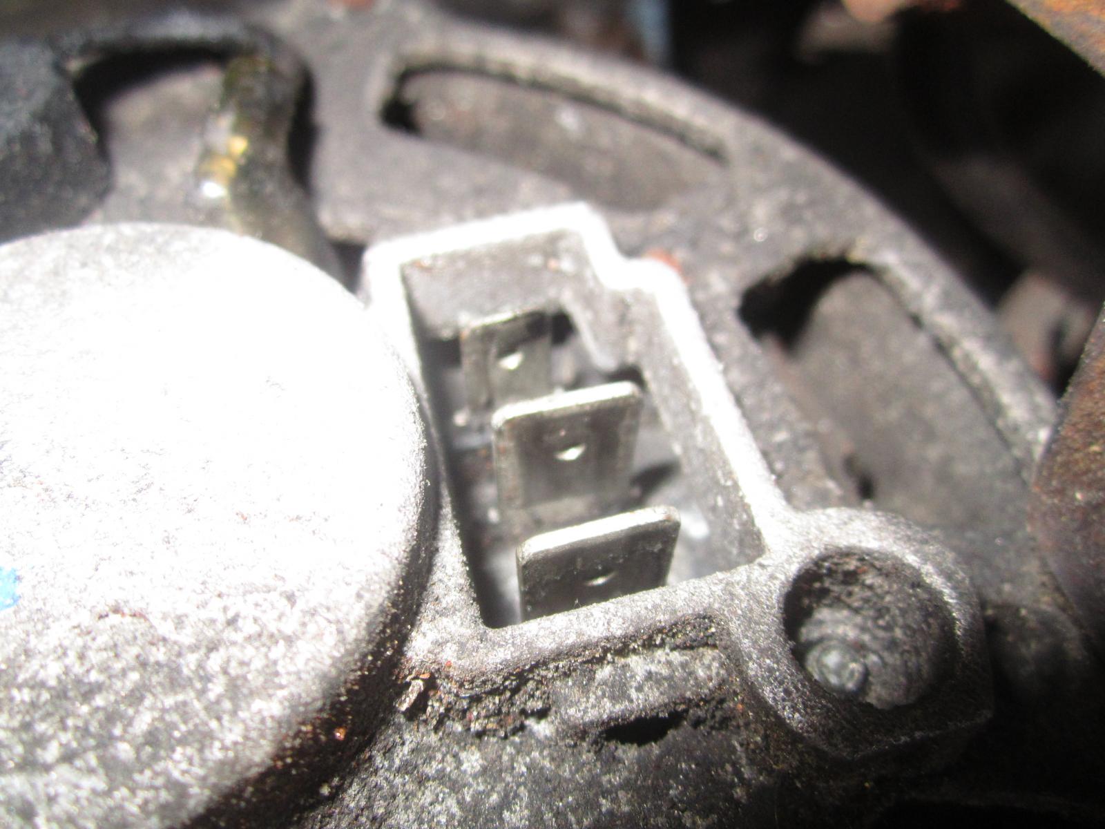

By "module" do you mean the voltage regulator? OK I will remove it again, and test for OHMs. I guess if I find a definite problem with it, then there is a good chance that it is only the V.reg. that needs replacing.
First off.... is the ALT supposed to be grounded to engine block? I don't notice any wire coming from the ALT to the engine block, or to the NEG BATT terminal.... is this normal?
Next... here are some fotos of what is happening under that ugly black tape. The whole plug seems pretty oily... I did my best to clean it up > reinstall, but still no BATT LIGHT at dash. And V.Reg is still heating up.

The alternator grounds through the case to the block. No problem on a diesel to add a ground between the battery and alternator case.

Mounting bolts are rusty, but I hooked up a wire from the ALT case to the NEG BATT terminal, and not change Sad
I'm stumped.
Must be a bad V.REG.... at least.

Just went out to replace that volt.reg. on the ALT, and the van started up instantly... BUT STILL THE BATTERY LIGHT WILL NOT COME ON WITH "KEY-ON".
However with the engine running the battery voltages goes up to 14.3V so obviously that means that the battery is now charging- so that means the ALT. is still good. Smile
But I am still wondering why the batt.light is not coming ON with "KEY-ON".
But...... there is a lot of corrosion on the bolt which holds the alt. to the engine - I am suspecting that maybe this is causing a grounding issue.
So next step I guess is to clean up all of these still rusty connection.
PS - Just checked again after 20min.
The same problem is still occurring - which is that the VOLT.REG. is heating up with the battery connected. And this is draining the battery.
So with the new VOLT.REG. the ALT is now properly charging the battery, but still there is some sort of short or something which is causing the volt.reg. to drain battery energy and heat up.
I don't understand this... if the ALT is now charging the battery then maybe the ALT is still good - maybe the problem is elsewhere?
Could it be that the rusty housing bolts are preventing grounding and causing this "short"?
