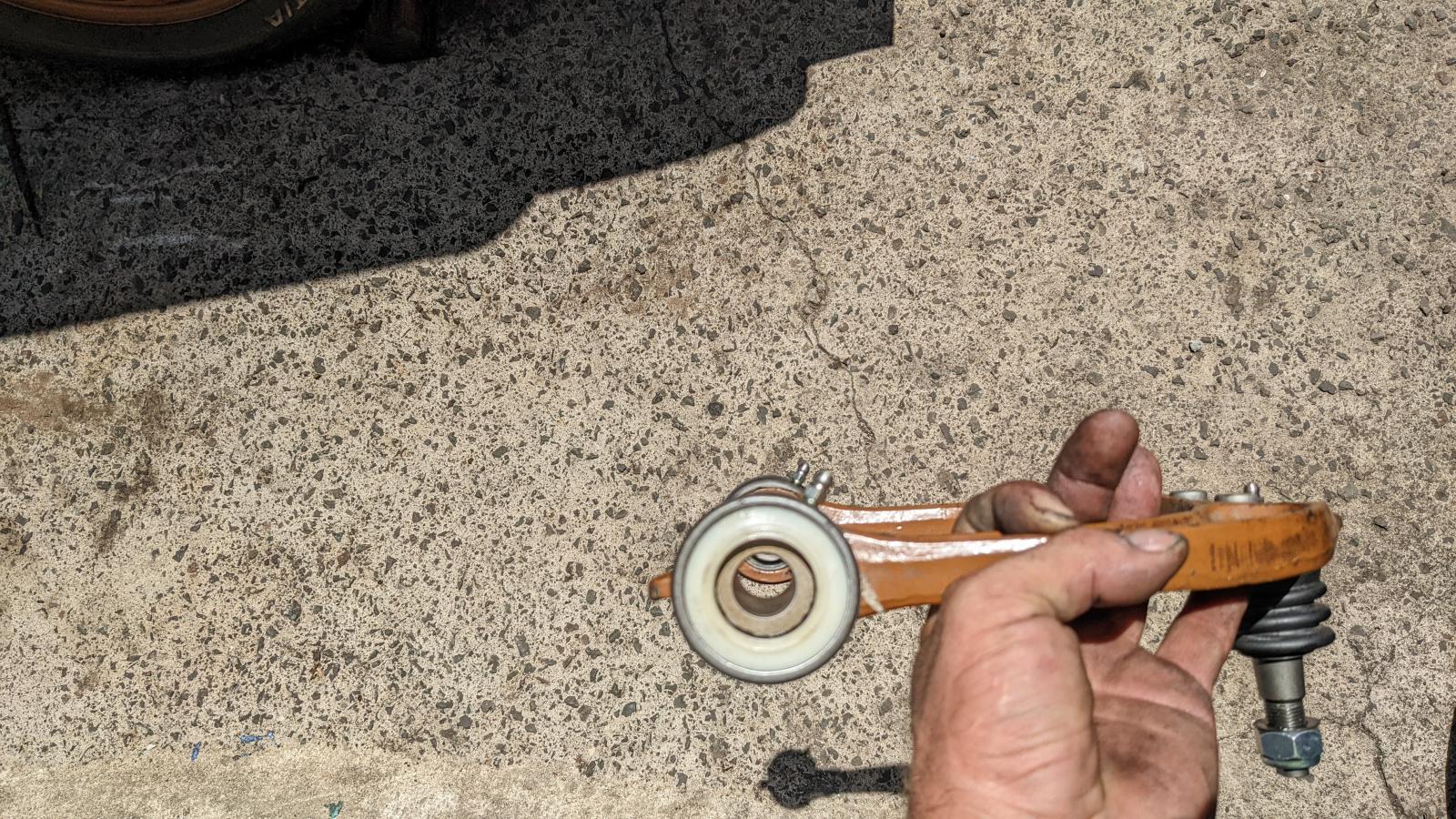

ALIKA T3
Joined: July 30, 2009
Posts: 7146
ALIKA T3 is offline
PostPosted: Tue May 31, 2022 11:11 am    Post subject: Re: Upper control arm bushing failure (pictures) Reply with quote
No it's lack of greasing inside.
I added zerk fittings.
People have had good success with them in France on the forum.
Notice how the grease shot out the front side of the bushing here on above picture, it wasn't built properly....
I installed Meyle bushings recently, not my preferred choice as I hate this brand but they were free.
Dimensionally similar to stock ones, I don't understand why I had a
13 to 14mm gap to solve with eccentric washers. My UCA are straight, parallel, well lined up. ( I actually had to straighten one a bit)
I'm puzzled by this but made it work with 1 eccentric washer on one side and 2 one the other. The chassis width is 153mm here, it's constant on every van. My gap was 165mm at the Syncro UCA which I find a lot but it matched a stock 2WD arm.

ZsZ
Joined: December 11, 2010
Posts: 1733
Location: Budapest Hungary, Europe
ZsZ is offline
PostPosted: Tue Sep 27, 2022 12:33 am    Post subject: Re: Upper control arm bushing failure (pictures) Reply with quote
MrCarpy wrote:
I went through pretty much all the pages. So what is the consensus?
Which brand hold up the best?
Febi
Meyle
Lemforder
other?
And where do we find Zerk fittings?
The main problem is some brands are just boxing ones made somewhere unknown, then change supplier with time. Others who are manufacturing themself, change manufacturing plants with time.
And they have different suppliers/plants on different markets.
Like Lemforders were the best as they had the VW-Audi logo hand grinded and were made in Germany. Now they have no logo and are made in Turkey.
Meyle was good, then changed supplier, now it is crap.
The old OEM Lemforders lasted ~100k Kms, then I got Febi, lasted ~50k, Meyle ~2k, Now new Lemforders.
The spot weld did not penetrate into the bushing on the right side as the sleeve has some coating and made from some special steel recipe. Had welded in situ but they are still squeaking.
Zoltan

ALIKA T3 wrote:
the only reason I went with stock style is to be able to grease them without touching the alignment.
ok your greasing them using the Zerk fitting correct?
ALIKA T3 wrote:
They're all cheaply made anyway...
It sadly seems so. Im on my second set in one year with very low millage.
